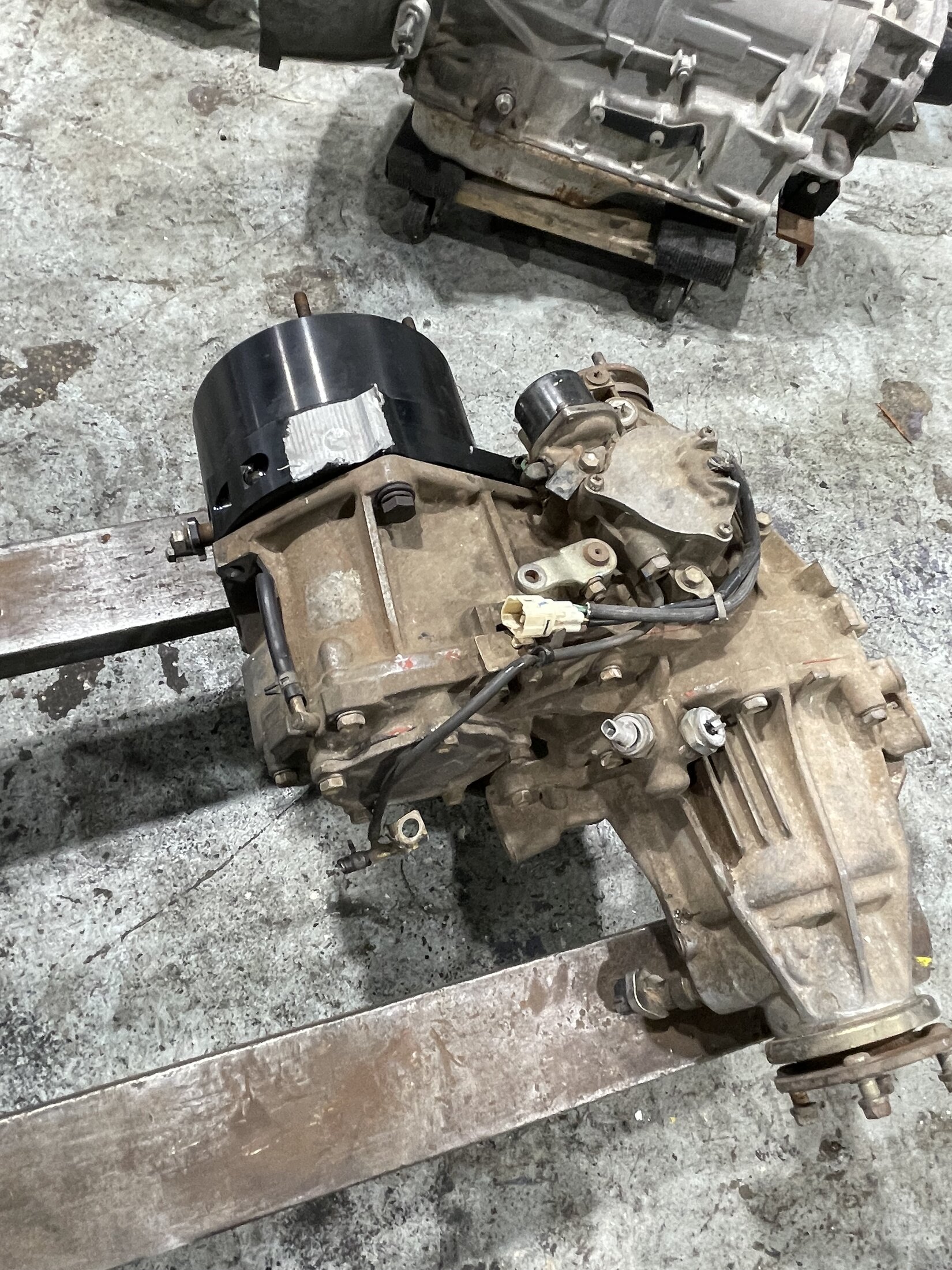

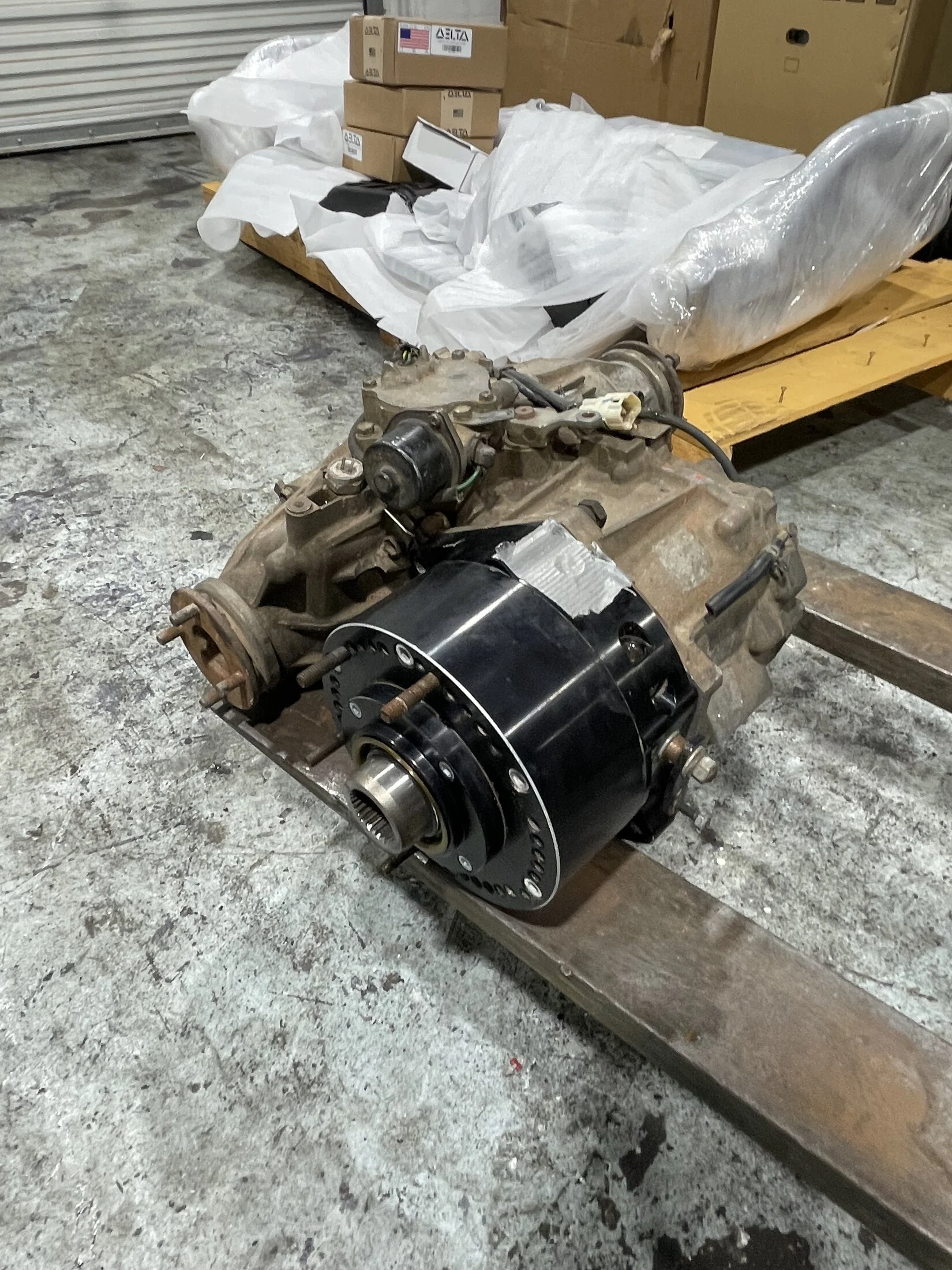

-find permanent fix for NP203 snap ring issue (not sure what I am going to do here yet)
-install my splitcase VSS kit I make so I can lose the wire going to rear axle
-I am CONSIDERING adding oil coolers and fluid pumps for the NP203 and transfer case. My plan is to put GM temp sensors in both and make extension harnesses up to the engine bay so I can use my scan gauge off my CTS to do some testing before I commit to this project.
I’ve been wanting to ditch the NP203 for awhile now but if I can get it to run cool, not leak and not wear out every 20k I will re consider
