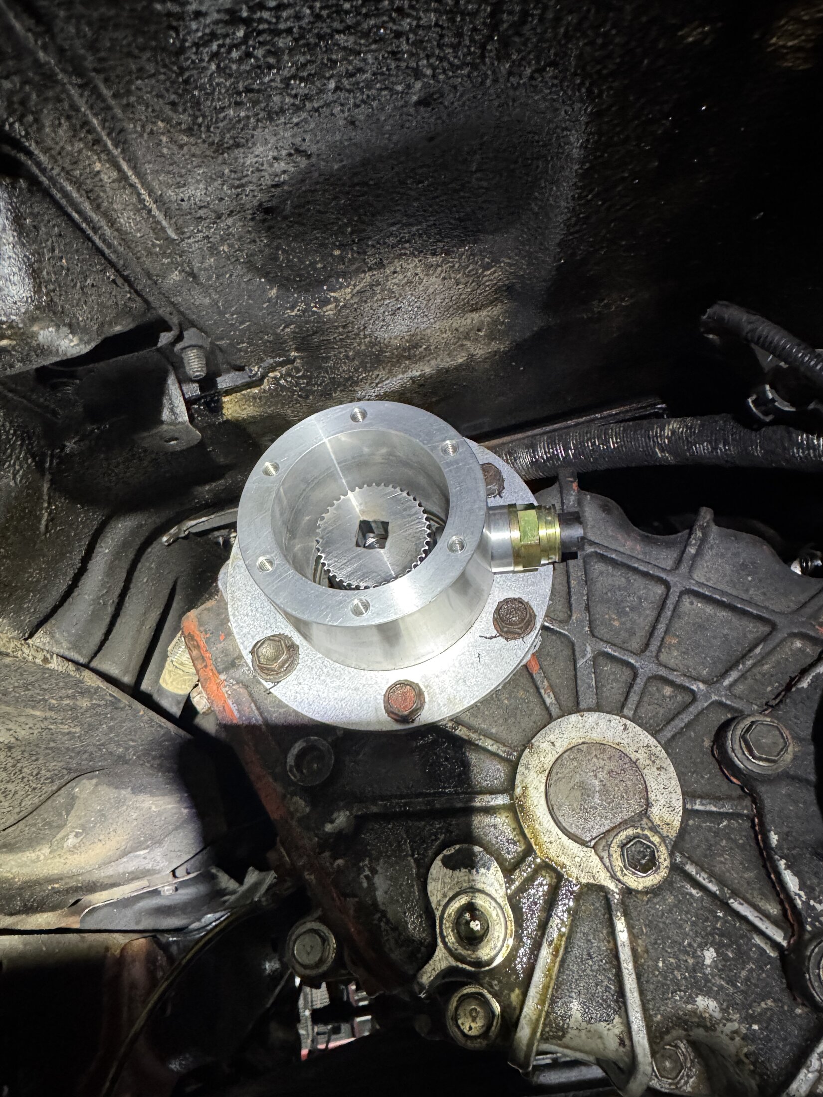

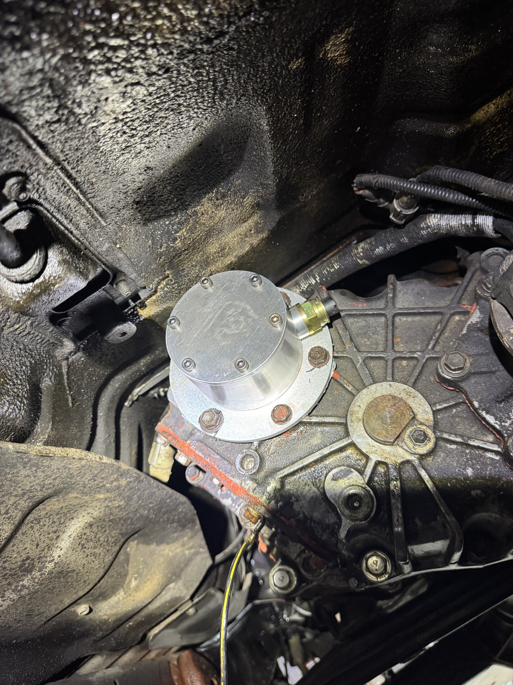

I also bought the JTR Speed sensor...Probably something that is a little on the pricey side and not really necessary, but I am planning to run all of the Chevy senders and speedometer to make the OBD2 data and logging more useful. So I installed that today.
I am eventually planning to install the 10% overdrive, and I have noticed the transfer case starting to drip, so I plan to pull the transfer case and clean it up in the future. It has been coated with some version rhino lining and I will clean it up and make it look a little better in the future.

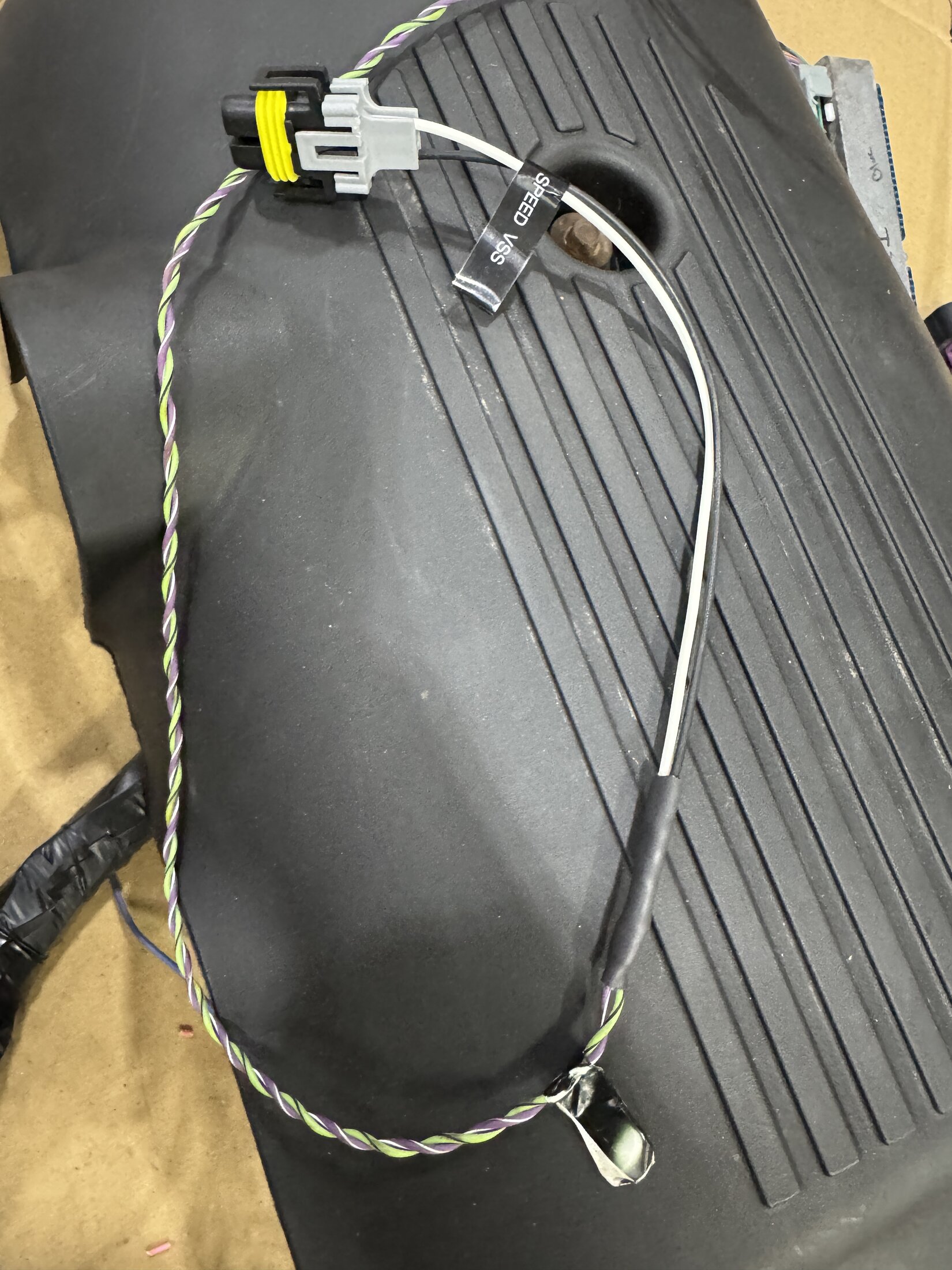

I soldered in the new pigtail for the VSS as well, so now I think I can start to wrap the harness back up entirely.

Good call on the VSS, without it you’ll have idle issues and other weird glitches. I’m running the JTR setup and it’s been great.
Wish you had asked me, I make a VSS setup that’s like 1/2 the cost! :D
Let me know when you’re ready for the 10% OD gears!

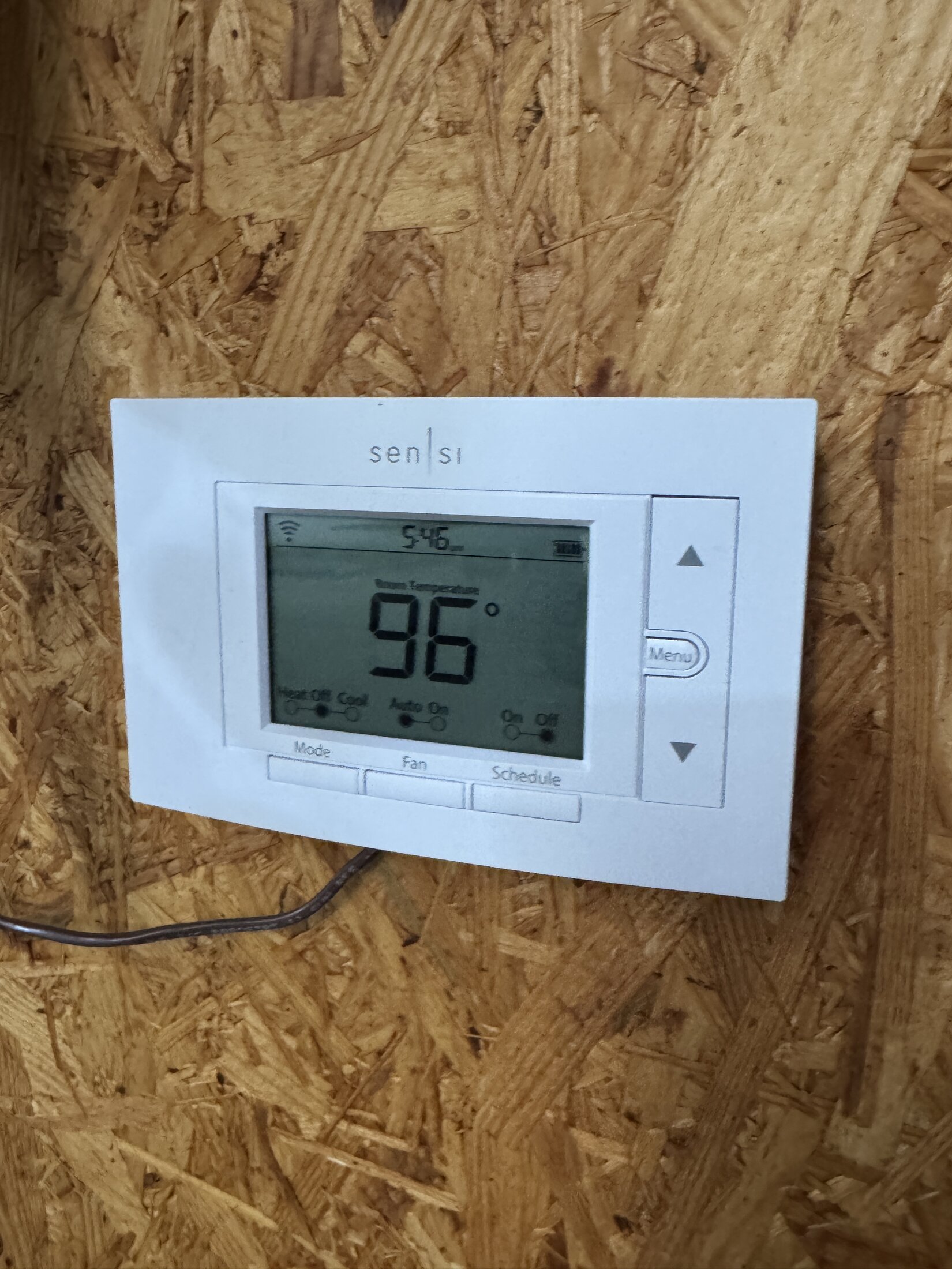

Yea, my A-coil froze over on the central A/C the house… last spring I added 2.5lbs to it, so It may need to be topped off again…changed a filter and defrosted it for now. its 20 years old, just another thing to spend money on :bang::bang:

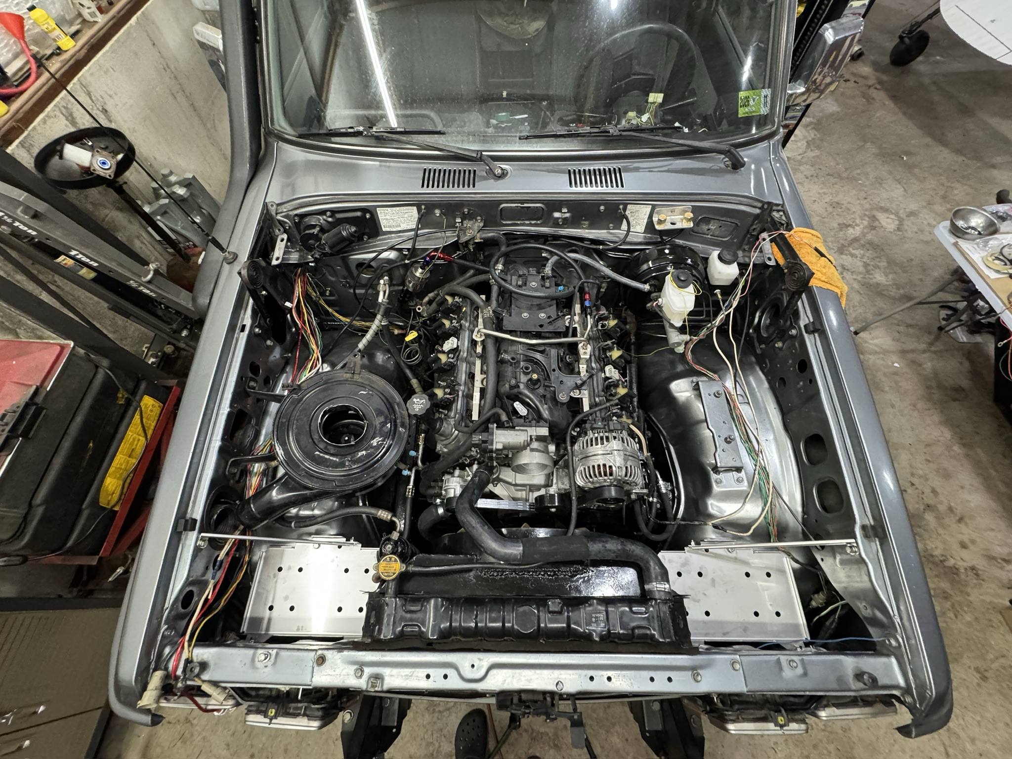

The past week has been very productive, I have knocked out a lot of little things. I cut the fuel line to length and tightened it down for the last time, I put some heat loom on it to keep it cool.

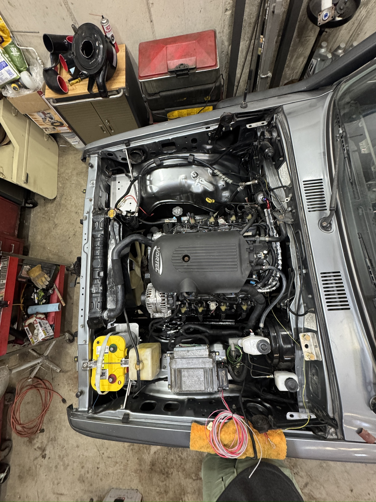

I finished the exhaust, I put one flex joint in the Y-pipe, I have a second to possibly add in between the Y and the resonator....
I started to piece together the intake, you can see my chopped up air box and some silicone 90, 45, and other pieces off in the background of the next picture, that is really the final piece.
Today I spent a good amount of time re wrapping the Land Cruiser wire harnesses and the LS Wire harness, got things covered back up and in place.
I finalized my ECM and Power distribution mount on the fender bracket. It is painted to match the land cruiser but its so covered up it doesn't matter.
I got dual stainless steel battery trays with the coolant tank relocation bracket. Currenly I am planning to just run a Drivers side main start battery ( to keep the LS SARVC Happy). I will just use a main battery cable to run over to the Passenger side to tie in the fusible links.... This will allow me to use an automatic charging circuit for the second battery.
LS Wire harness is mostly in, I need to tie in the wires that integrate to the Land Cruiser Harness and extend my VSS a few feet.

Also you can see i still hadn't wrapped the wire harnesses but mocked up the intake to take measurements. (you can see how long that fuel supply lone was before I trimmed it down also)
I redid the hose ends on the A/C to adapt it to the Denso Compressor. Still a few O-rings and things to get sorted there, but its mostly done. The condenser and rad support are back in. The lower valence is back on and the turn signals are installed....
Radiator hoses are also installed.

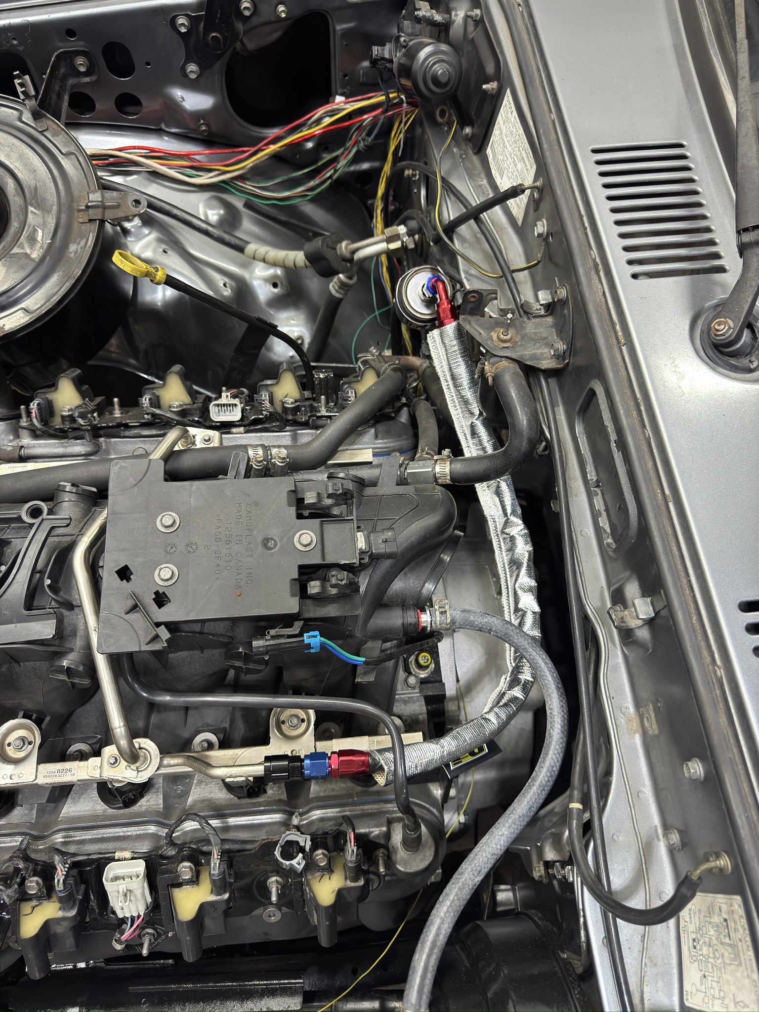

I got the charcoal canister & Evap purge solenoid mounted… canister mounting is probably the one temp thing I’ve done so far. I just zip tied it in the fender, but plan to use the aluminum I have to clamp it and make a rigid mount.

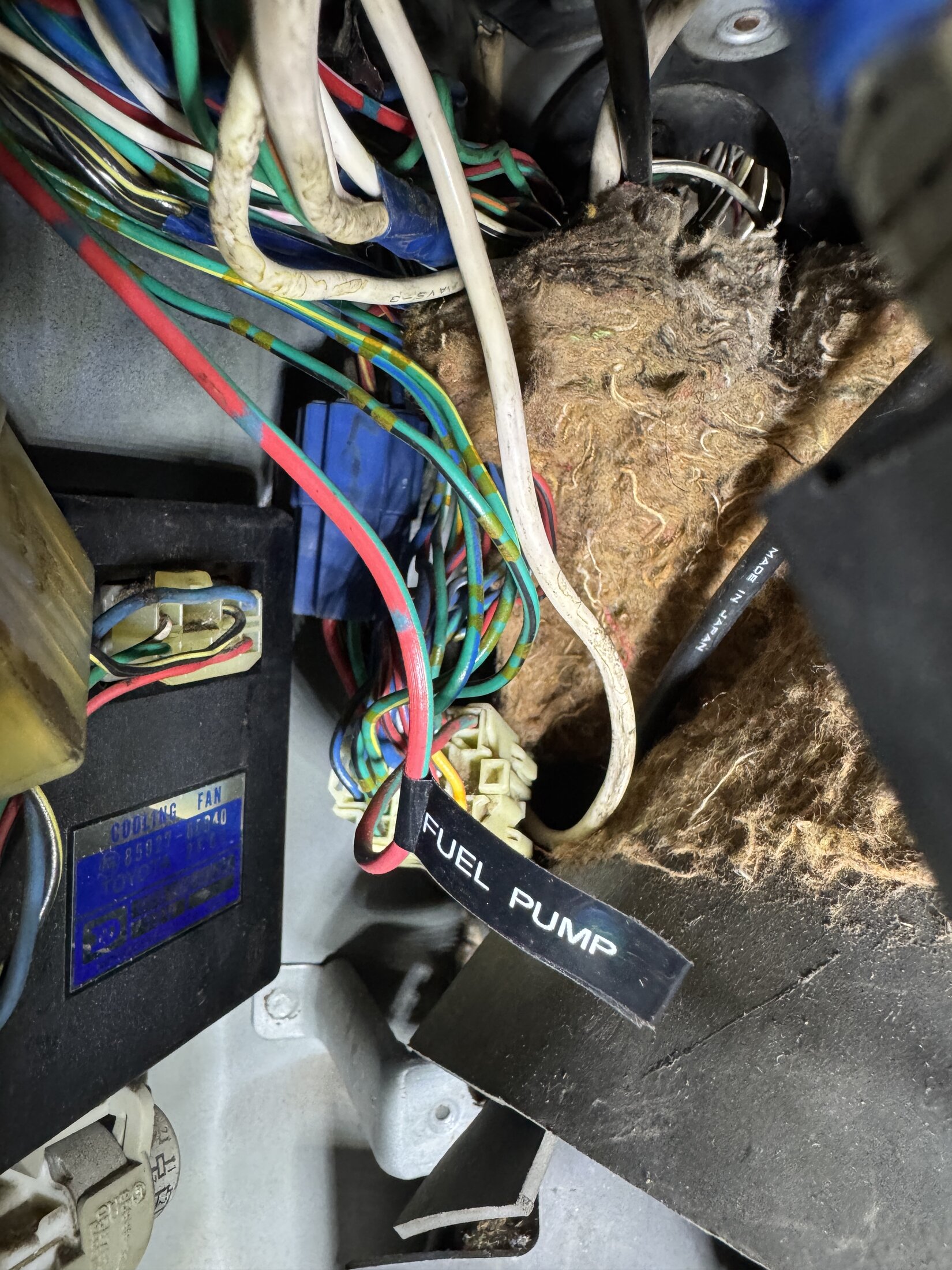

Next, I removed the carb cooling fan controller…… hear me out… I know it’s useless, I have no carb, but I kept the wiring, sensor, & fan to keep it operational…. One of those useless Landcruiser features that I wanted to keep, but I mounted the PCM in the way of the fan.
I’ll keep the wiring, in the event that I find a purpose for the fan, but it’s all in a box.
I’m going to use that space in the drivers kick panel (where the fan cooler control box used to live) to mount the Dakota Digital SGI-100BT & the AUX lighting fuse panel!
