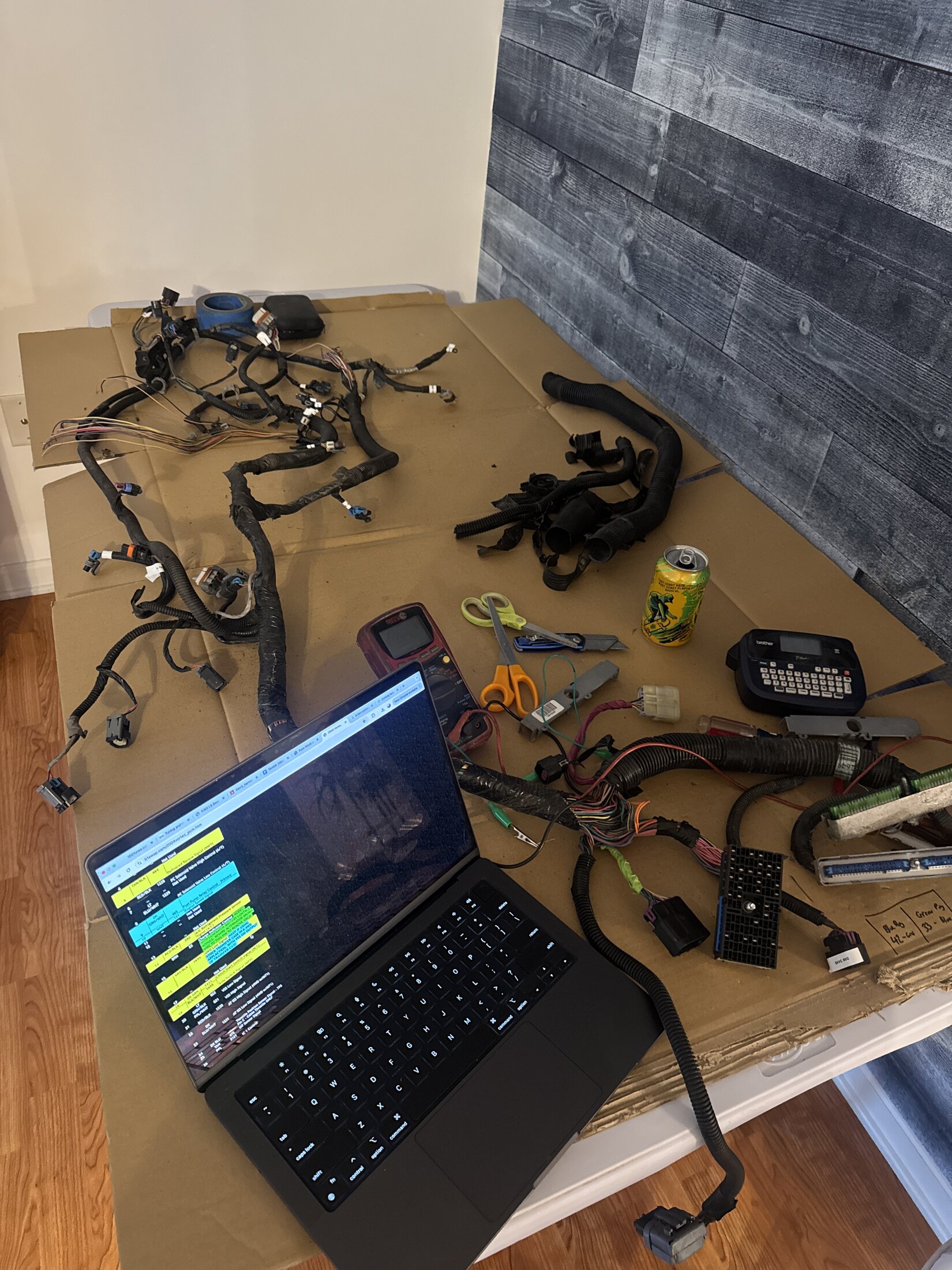

On to the fun stuff, getting the wiring harness started, I have been honestly just avoiding it saving it for last. A lot of this I have done before and even the frustrating stuff has been fun today. I moved a table into the living room to not be out in the garage for hours on end.
So far, I separated the OEM fuse/relay box, removed most of the automatic transmission wiring and used a few different diagrams to get there.... the wiring for the Trans, O2 sensors (both banks) and the MAF sensor connectors were all cut off, so some of it wsa just blindly checking continuity until I confirmed wire color and ECM Pin and connector number....
Early on it was alot of continuity checks and marking wiring, labeled all the connectors and confirmed a few wires to make sure I had a solid start to the process. LT1swap.com has been my goto for all of the LS and LS1 swap stuff I have done, such a huge resource!! Also useful are Beer, and a cheap label maker, cant go wrong with those...
Todays stopping point was here, most of the tape, wire loom and everything has been striped down from the C1 C2 connectors to the transmission connectors, and you can see all of the wires I depinned and removed that are balled up by the wall. about 20 wires total depinned and removed from the harness, all trans wiring, next will be down stream o2 sensors, but thats a good start for tonight.

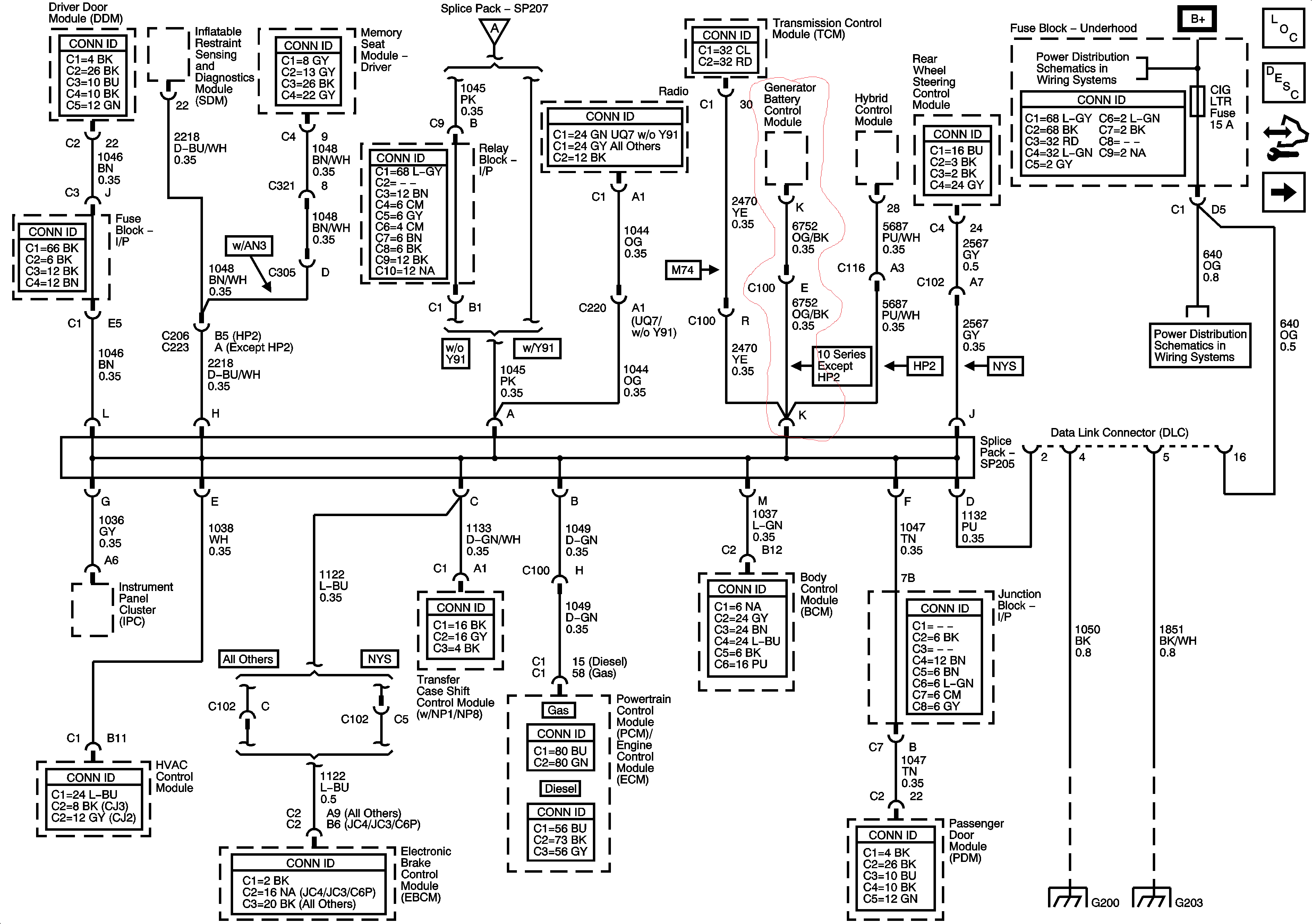

Looking at this I will need to recreate a splice pack for class 2 data that ties the GBCM, DLC, to pin 58 on the ECM..... but I am not sure how the HVAC control having class 2 data is working, I am assuming in the original GM Vehicle the HVAC controls communicate to turn on the A/C on via the class 2 data... my compressor has the high pressure switch integrated into the back of it and all the wiring is here and going to the ECM like in the diagram below.
Serial Data Diagram and splice pack
I have all the wiring in the Green Box below, and plan to keep it and do a little more digging.... I am guessing this is where I either find a ECM that can accept 12V on pin 17 and run the toyota AMP Wiring...... or run it without the idle up command.... I know there are more threads than I have found on mud, more info to look at on LT1swap, and more threads on LS1tech, but I am just trying to clean up the harness and not have to reinstall stuff

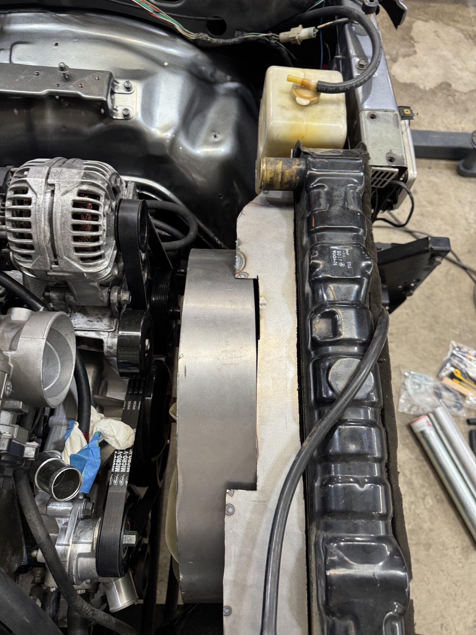

I feel like I wasted several hours yesterday and today on the radiator shroud, but I guess either way its progress and I have a good plan to move forward with.....

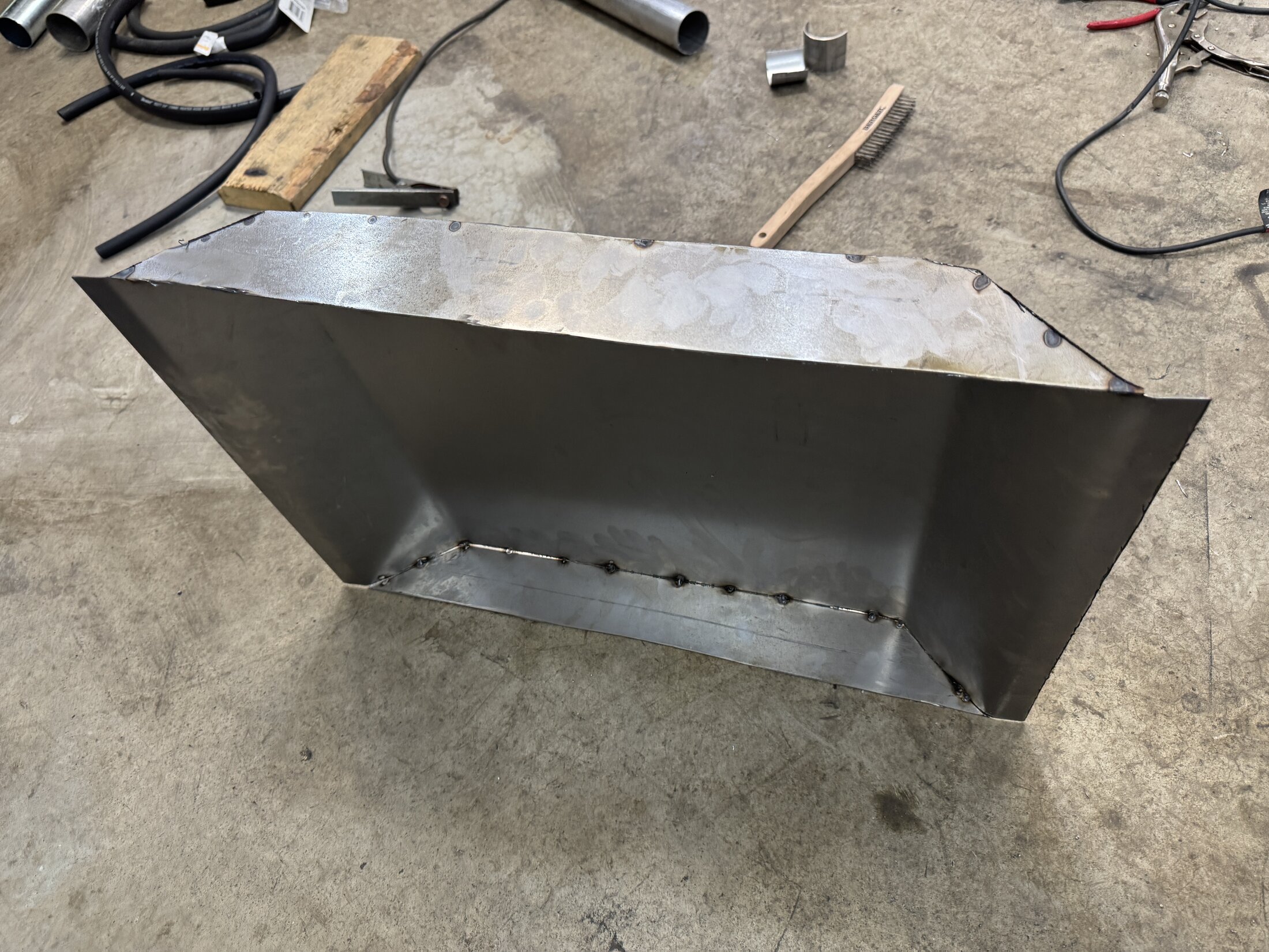

I used CAD to work out the initial plan...Cardboard Aided Design
After taking measurements, and getting the template mocked up, I figured I could move forward with some metal, my buddy had some scraps of aluminum left over and offered them up for free.... I planned on tacking them with my Spool gun and borrowing a better TIG setup to finish it up...but once I go the metal and started working it, I realized how thin it was, and that it probably wasnt going to work....
It was a good practice of transfering what I had made with cardboard over to metal, but the spool gun just couldn't get a good weld without burning through the aluminum.... I am thinking I will just go pickup some steel and make it a little easier on myself...It felt like a few hours wasted, but I guess it only cost me time, and once I get some steel I should be good to go.

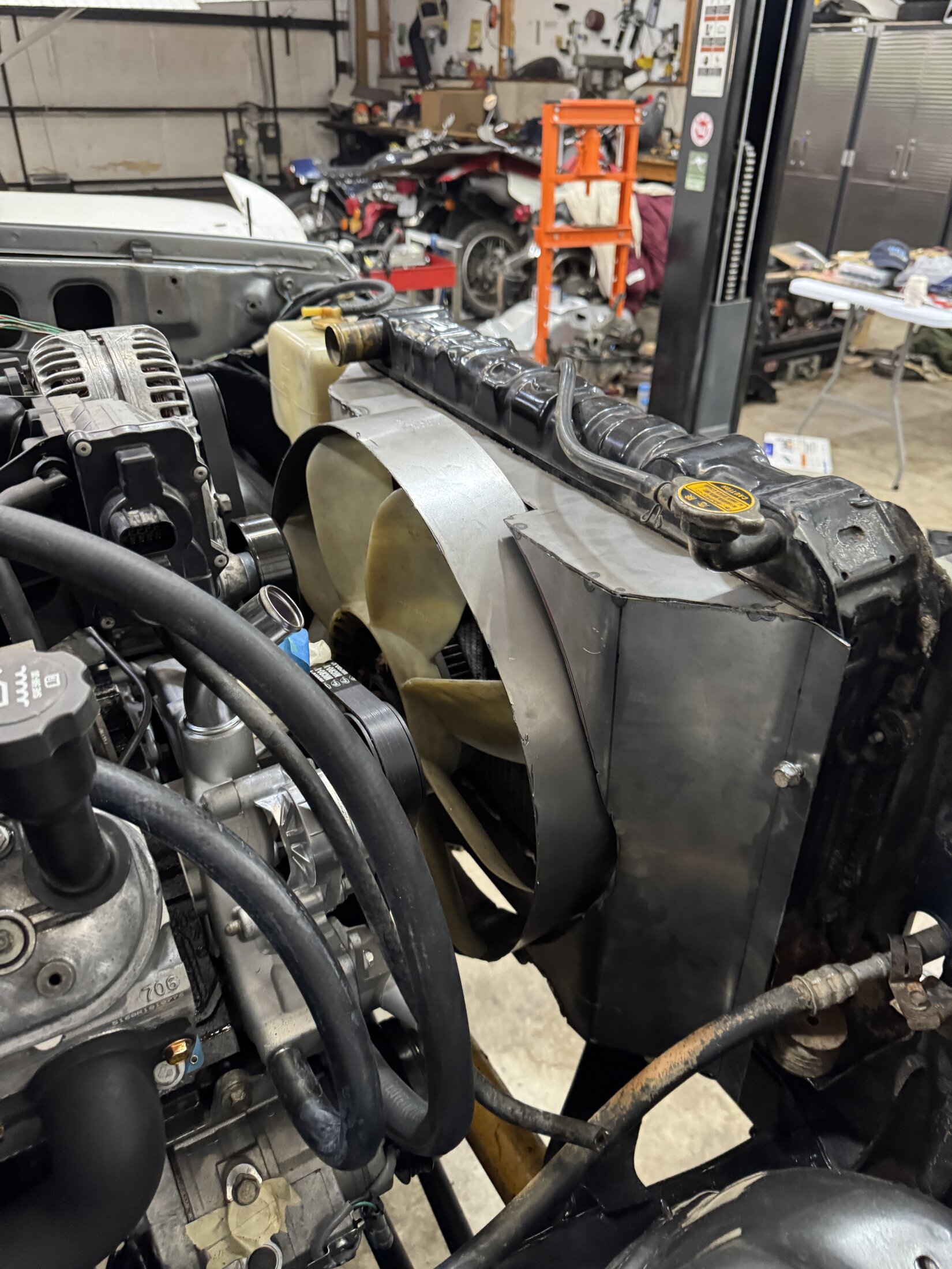

Well I moved on to 18ga steel, much easier to work with (with the mig I have). I got everything cut, bent & tacked up. Checked the fitment & got it ready to weld.
Glad I spent the time, plan to be driving this a lot & using A/C in the summer, so I want to have a radiator and fan that will keep everything cool! Should be able to weld & maybe get some paint in this tomorrow.

Before you bolt this in, would it be easier to cut into two halves to have easier access later??? Just trying to be helpful, not a criticism,
Ty!
Ty!
I appreciate it, I have thought about it... a lot of early 90's GM stuff was split in half (top and bottom) before they went to one-piece molded plastic ones. It definitely makes it easier to get to the fan clutch, fan, and water pump without draining and removing the radiator. Part of me just wants to leave it one-piece for now and if I have to remove it down the road I can cut it and weld on tabs and nutplates.....
