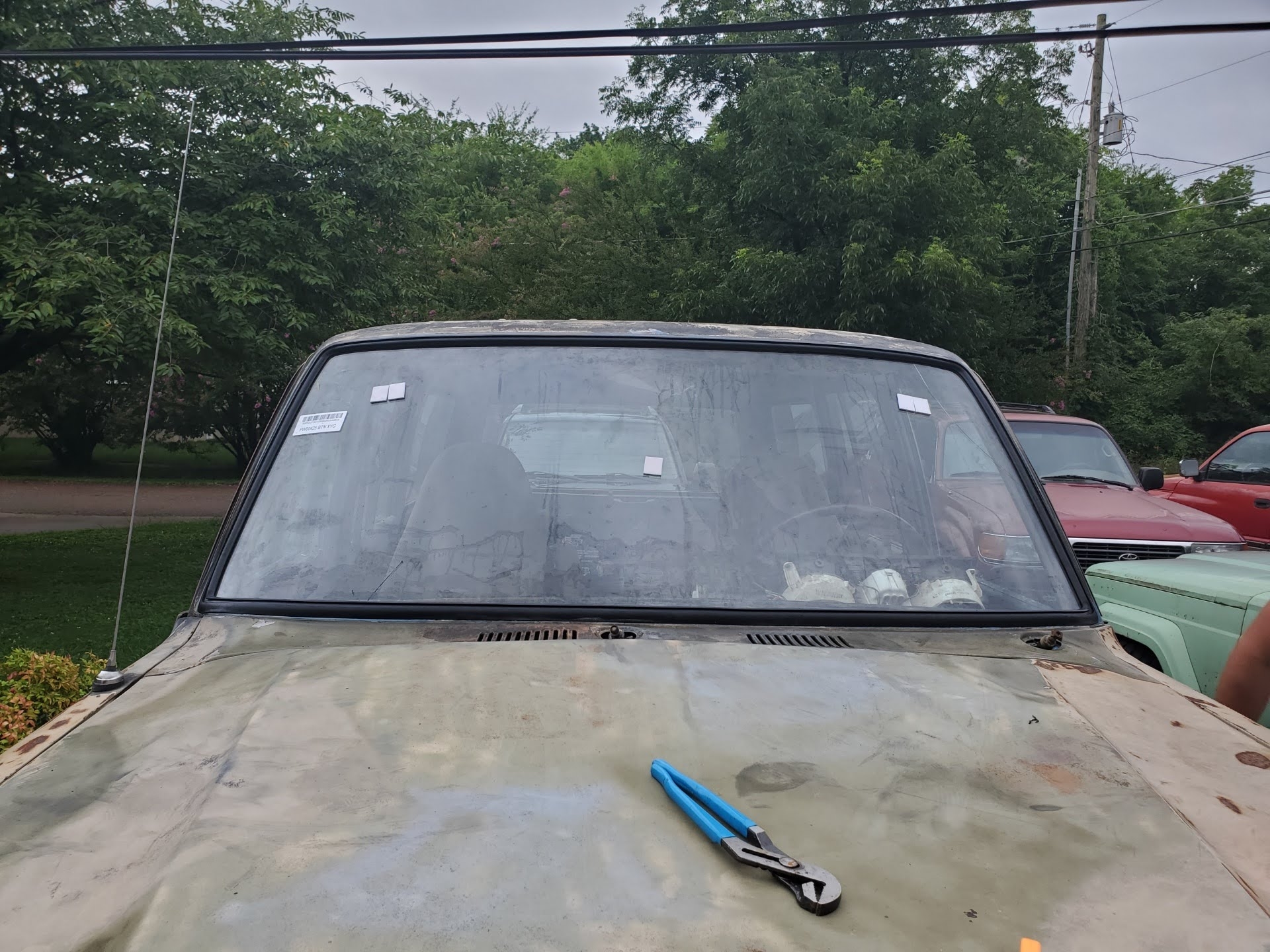

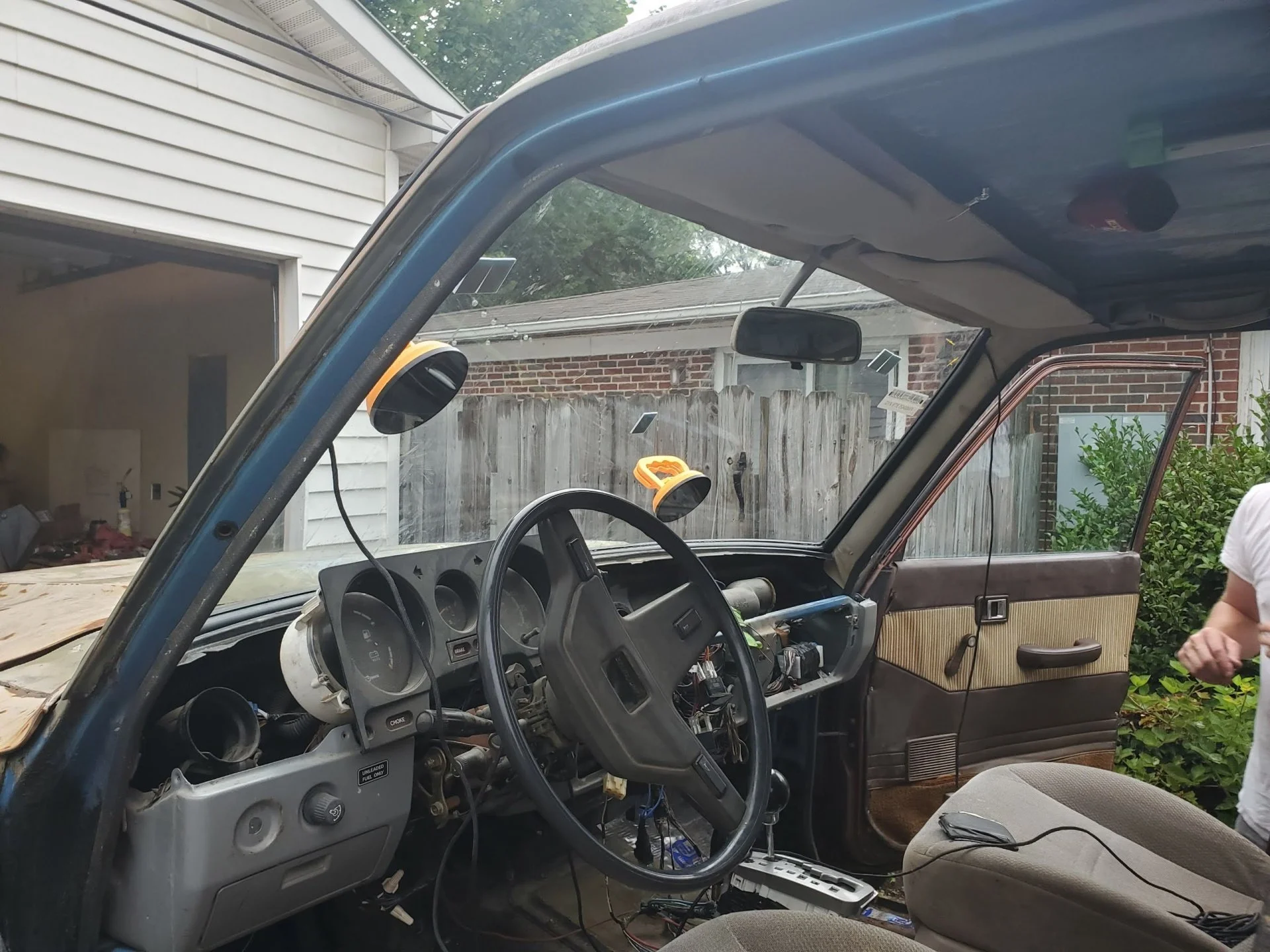

The "pros" threw in the towel after 4 failed install attempts, so @bush and I gave it a go. I grabbed a few pointers from youtube, $20 at harbor freight bought all the needed tools, and then we exercised a little give-a-damn.
I'm not going to go into detail about how we did it as youtube glass guys do a great job of explaining, but I'll add a few things that I felt were under-stressed:
  • Use a quality gasket. I heard this from several installers, and I see what they mean now. Toyota was much more affordable than Precision (the often suggested higher-end aftermarket vendor), so it was a no brainer. The "pros" were using some other vendor and the gasket was pretty stiff exactly where it needed to be more flexible.
  • Use a stout, slippery rope, and soak it in soapy water before loading it into the gasket. We used some paracord and it did great. Having it soaped up would have made pulling the corners easier. For those that are concerned with high end details, this trick would also avoid some rope burn that I see on the surface of the interior lip.
  • Careful with the last leg at the top. The glass has to bind up once you're down to a couple feet of gasket remaining. This makes the lip have to ride on less of the pinch weld when it flops over than it does anywhere else in the install. Just make sure the gasket stays over the pinch for the whole run. You can work it down to final position once it's fully flopped over.
  • Apply only enough pressure to keep the gasket from rolling. We got a little heavy handed towards the end and cracked at a corner. This is one of those things that is 100% learned OTJ. Pay attention as you go and that part in bold will become apparent.
All up, I say this was on the low side of a :banana::banana::banana: job. The potential to wreck a $150-200 part with a crack bumped it up from a :banana::banana: job.

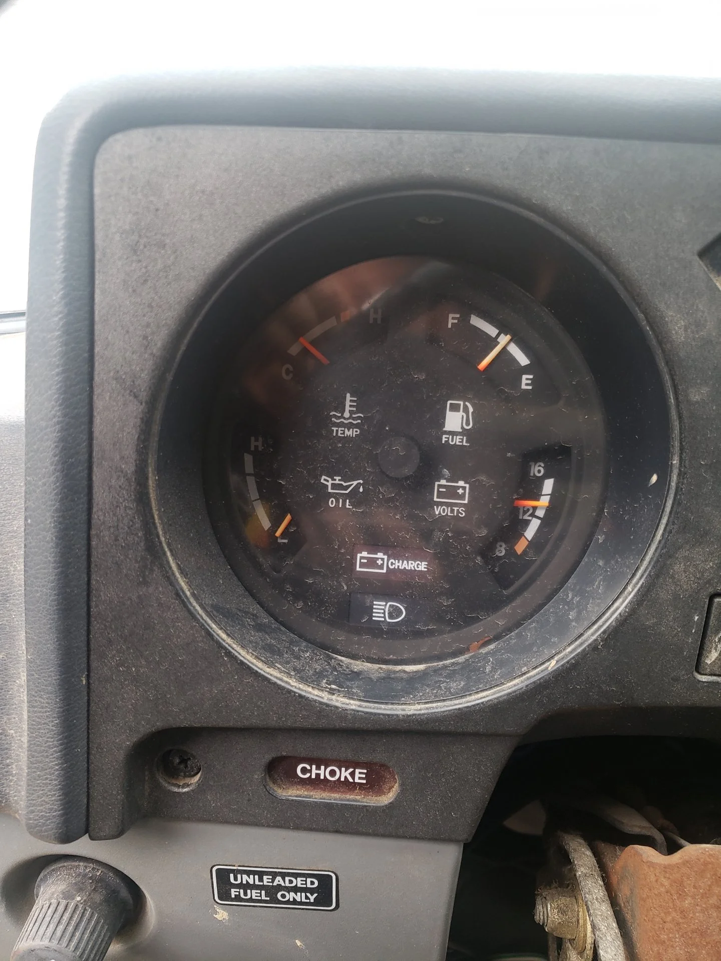

Measured the oil pressure with a mechanical gauge just for grins before replacing the sender and numbers are OK. 60psi cold idle, 20psi op temp idle. Min spec is 4 psi at op temp idle (shocked it was that low).
Here's what hot idle correlates to on the 60 gage:
Annoying. Registers, but just barely. Gonna have to fix that. Time will tell how stable it is.
Clearly an idiot gauge. Excuse for Redhut gauges😊?
that’s the way.
I’m not one for modifying factory geometry; but you’re past that and it’s glorious.
Doesn’t sound like it is the direction to consider but a front 80 sway bar supposedly works on the 80 rear axle on a 60 frame.
Somethings wrong with your gauge or sender. Should sit right in the middle of the gauge with those numbers.
I’d throw a new gauge at it while they’re available
Tried to get one ordered today. Our button pusher says it's NLA.
You attached the oem 60 oil pressure to the peg on top of the sender, not the tab, right?
Used a 100 sender. It has a single pin connector.
