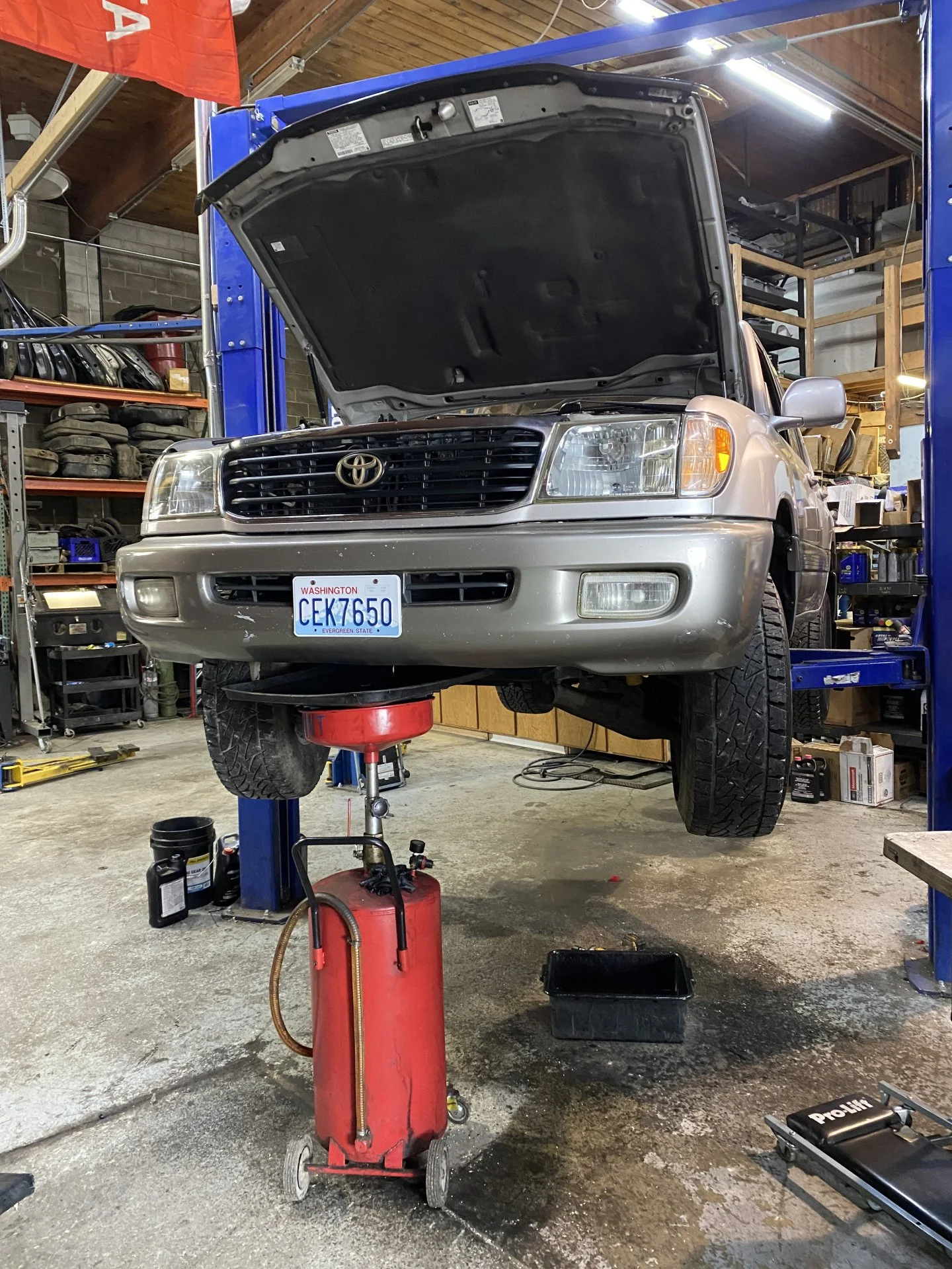

Got Steve on the lift tonight and went over him with one of the shop techs.
Overall good buy and Steve is in great shape. We do have a 90k service to take care of.

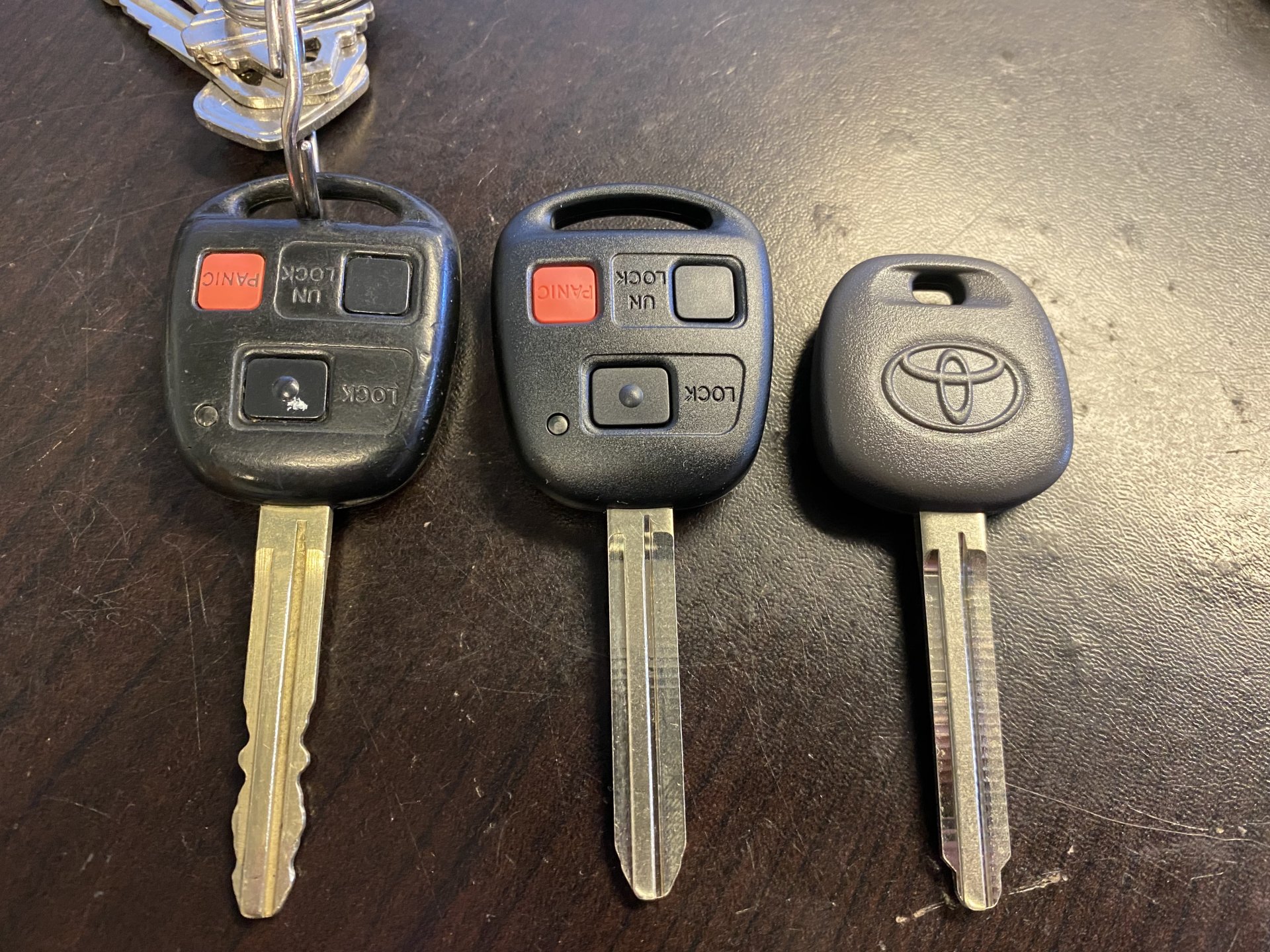

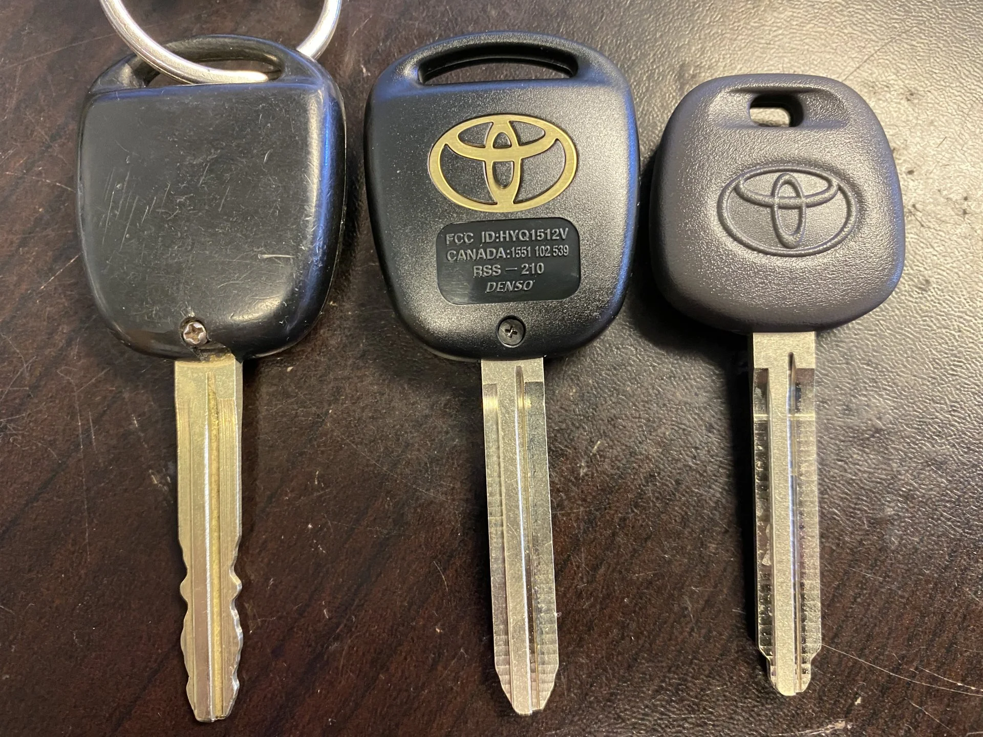

*Order and program Extra master key 🔑 & spare.

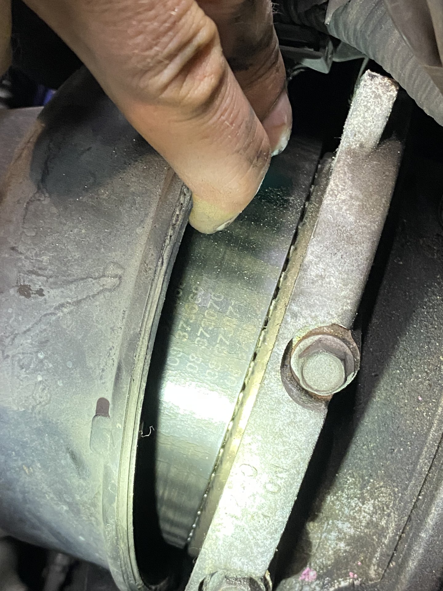

We found below the air intake tube that someone wrote 90k service.
Due to that we dug into the inspection cover and looked at how the belt looked.
With Steve sitting at 236k and the last timing belt service at 90k we have a belt that has 147k approx or 57k over due for a change.
Zoom in on the belt and you can see surface cracks on the outside of the belt.

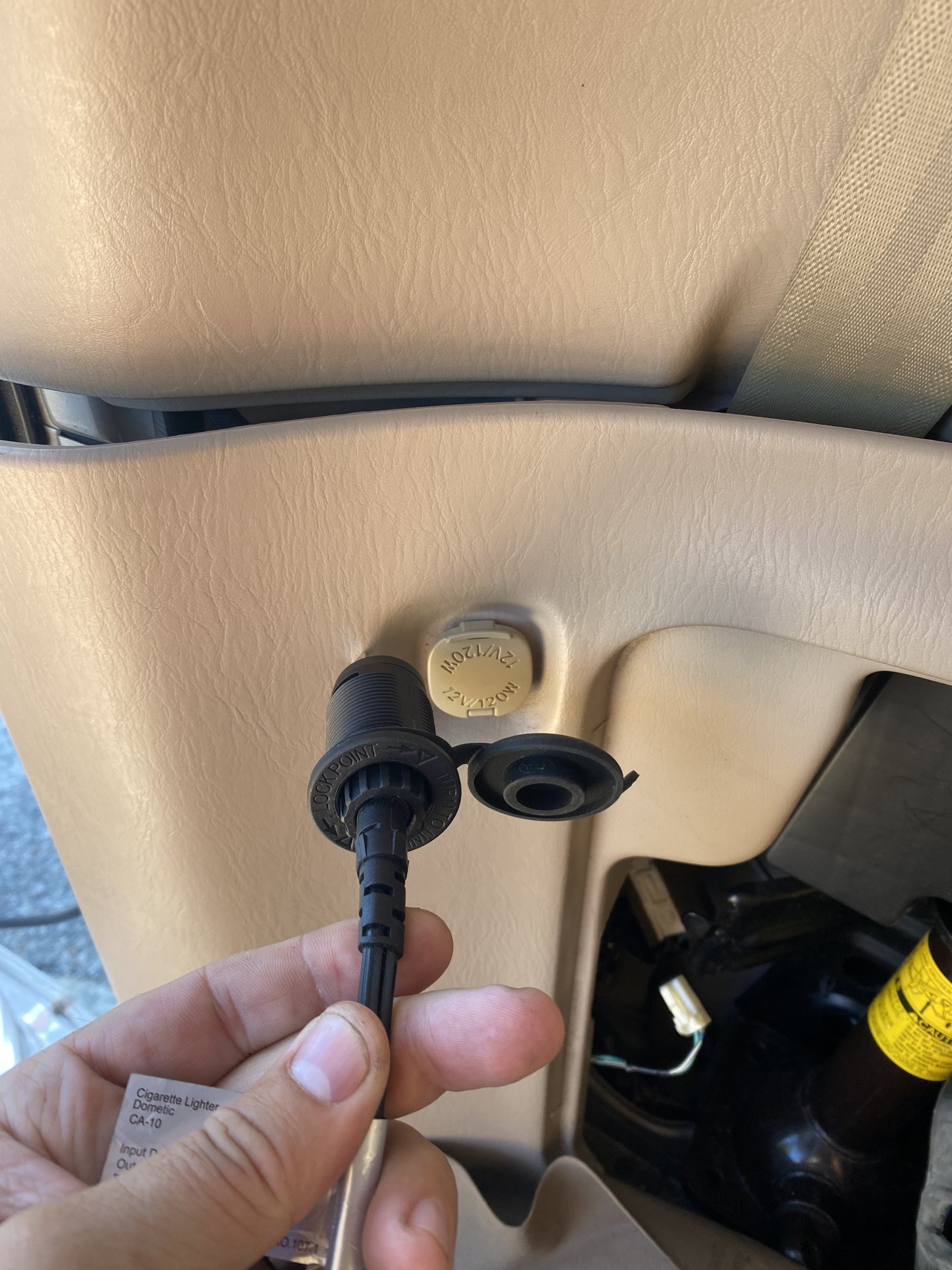

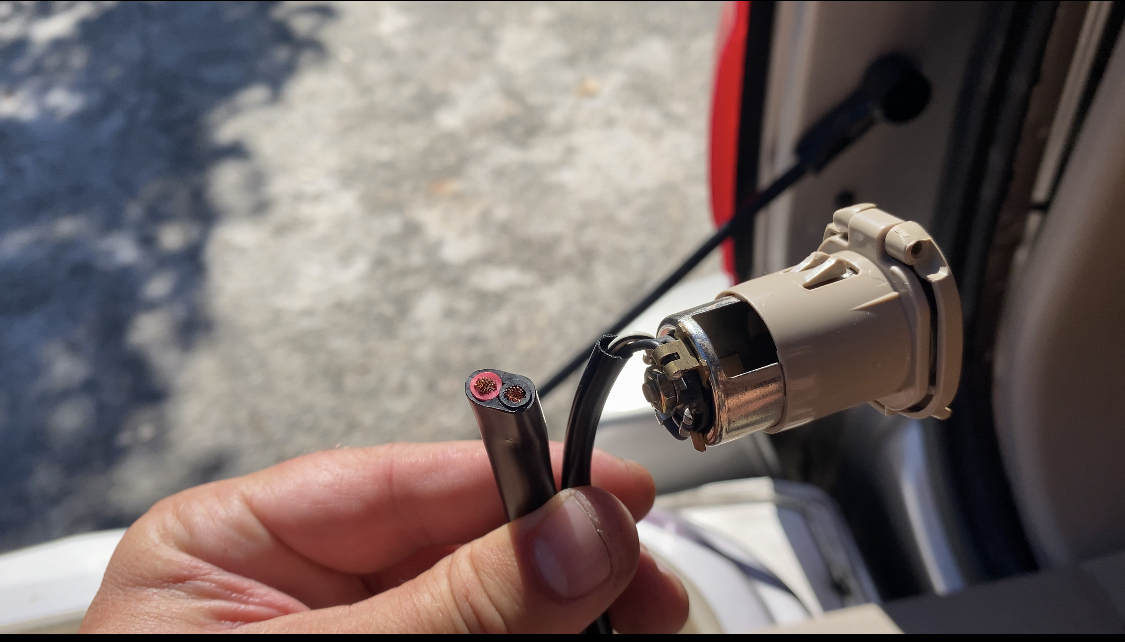

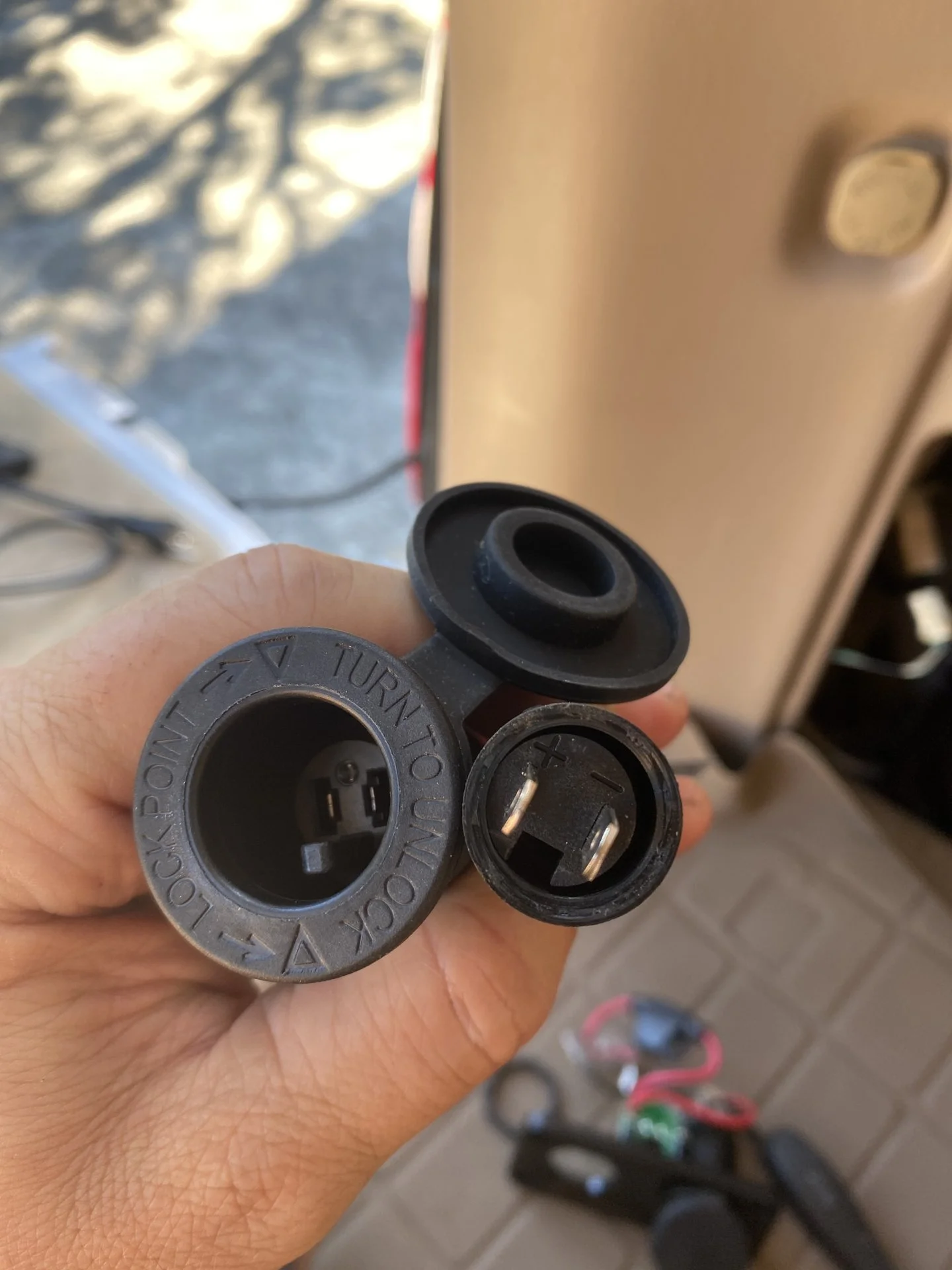

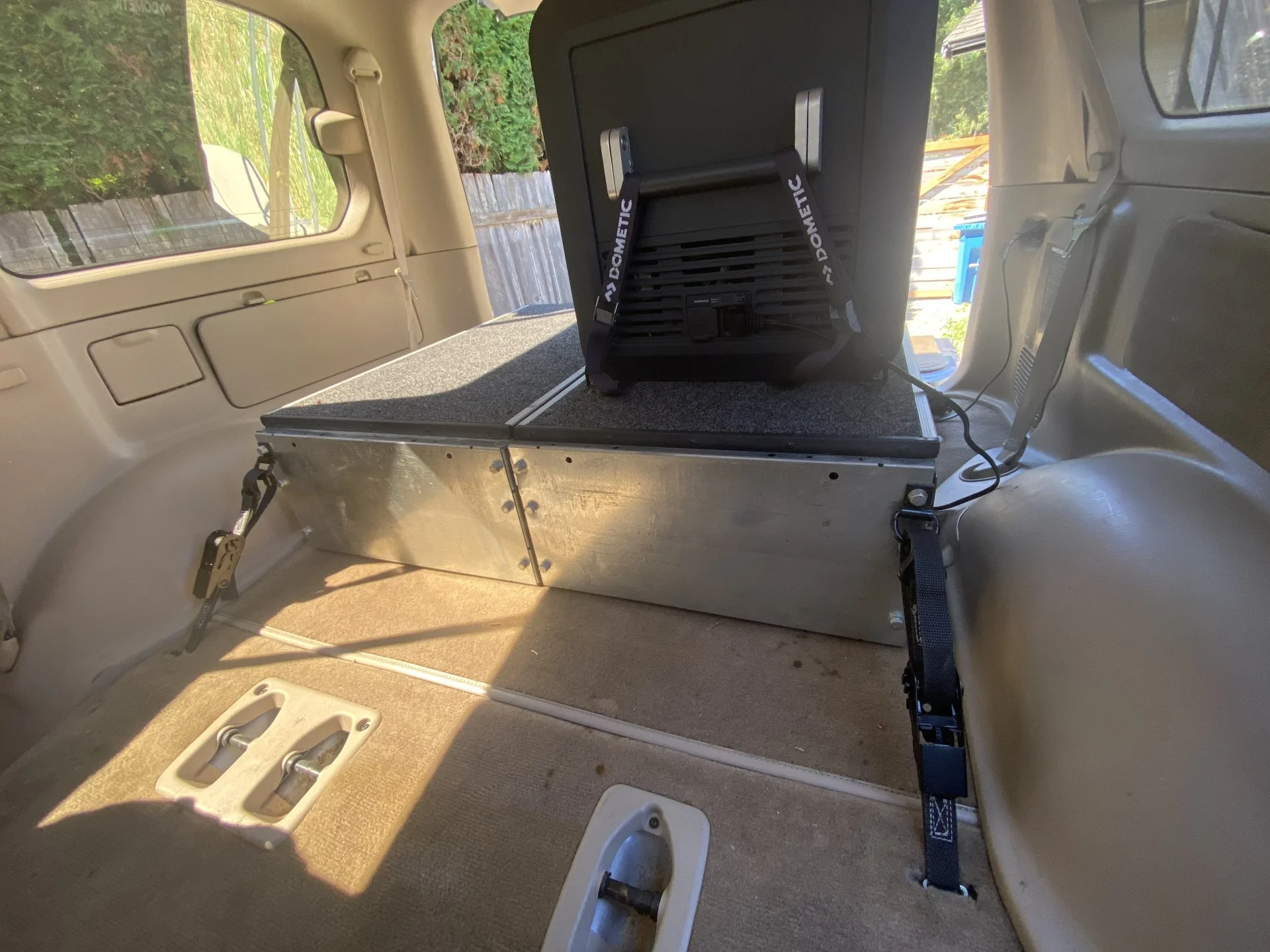

Decided to jump into prep for camping next week. I Started by running dedicated power to the back left side quarter panel. There is already power routed there. But it wouldn’t be up to the task of keeping up with the fridge draw. Take a look at the wire size difference and you’ll get it.
Dometic kit comes with a nice locking (threaded) plug. I’m not sure if the fridge connectors are universal or this would be an option for everyone. That fact that it threads into the plug is awesome because it can’t come out on bumpy roads or when you put camp chairs in the space next to the fridge.

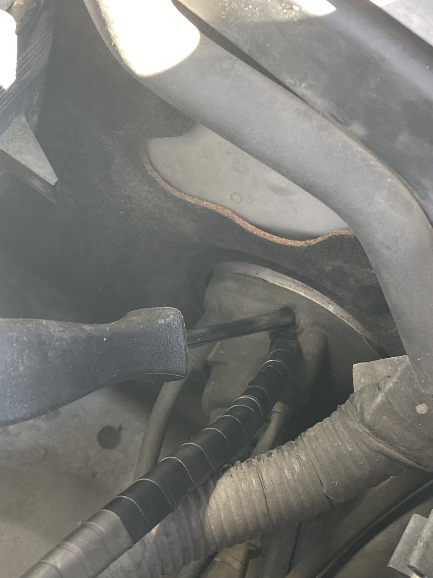

I removed all the interior panels, and was able to get the line from the battery back to the rear corner pretty easily. Toughest party was going through the firewall grommet.
I’ll put together a video of the rest of the install at some point.
Other than the battery needing to get changed out for something with more capacity this should be good for now.
I’ll see about adding a second battery for capacity and an easy solar attachment for trips.

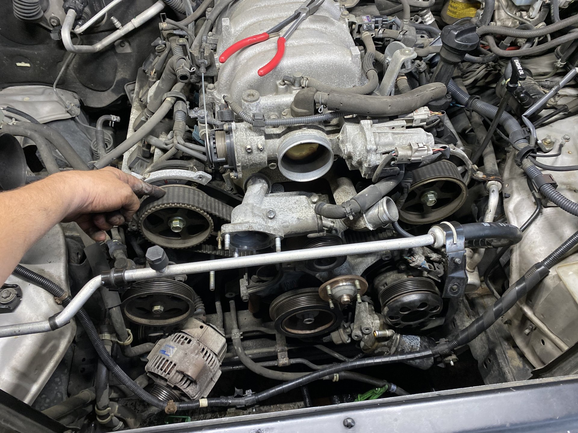

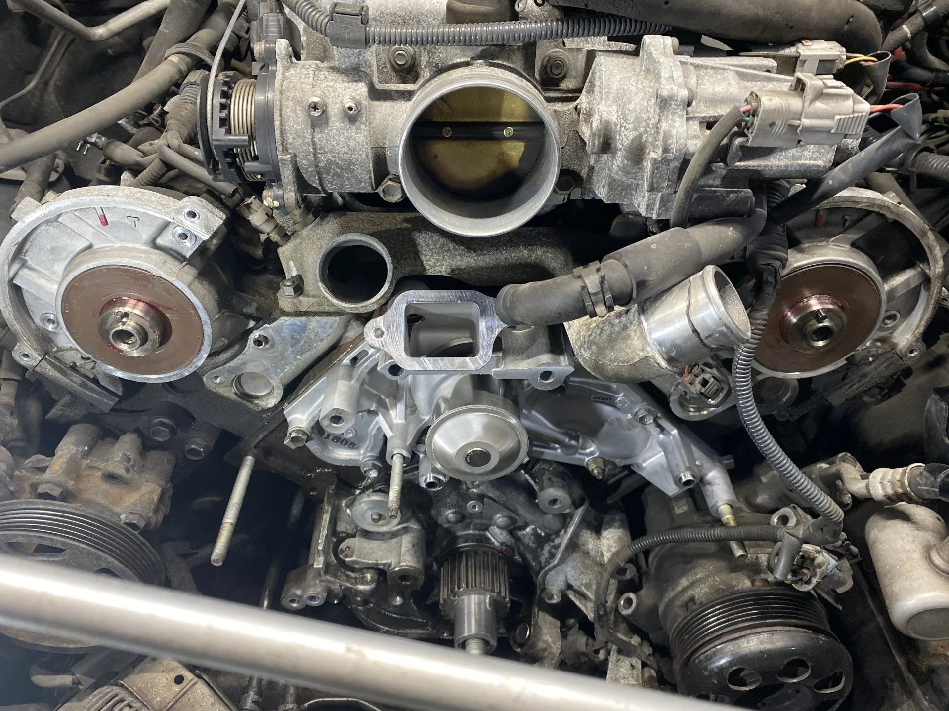

Saturday was a long day. Did the timing belt and Waterpump, idlers, new radiator fan clutch and drive belt.
Reason for the struggle.
New water pump and fan assembly. Check out that (right) Driverside cam seal. Needed to redo that one.
No other photos past this point. Had to put the camera down and wrap up.
