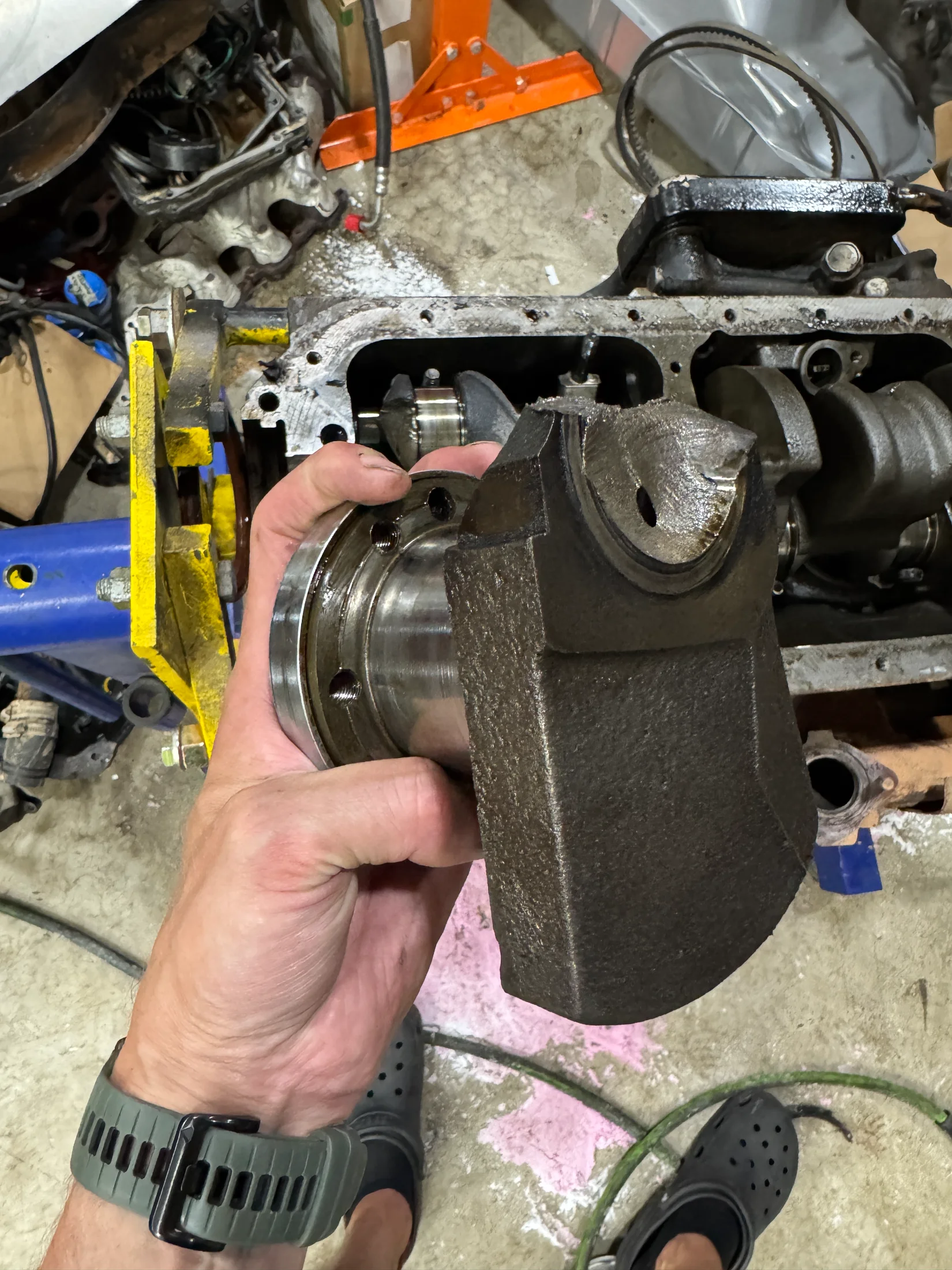

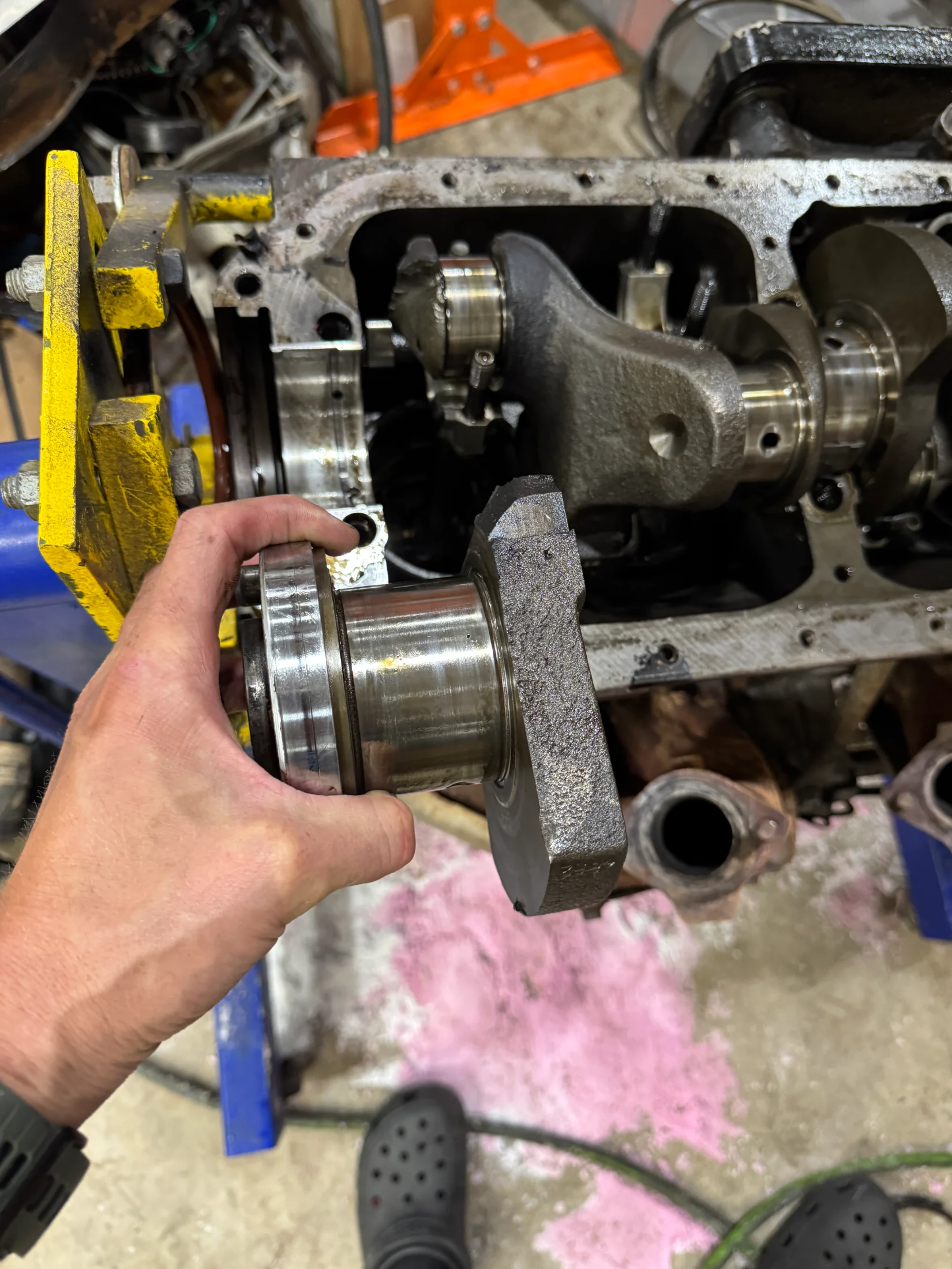

I still need to see if my dad has a 46mm socket in his shop, I started to tear into the 3F-E to see exactly how it looks. Heres one of the pieces of my crankshaft...need to pull the harmonic balancer, timing gears, and backing plate to get the other part of the crankshaft out. Most of the bearings look good, but the 1st and last main bearing look a little rough, I am assuming that was from the crank snapping but who knows....

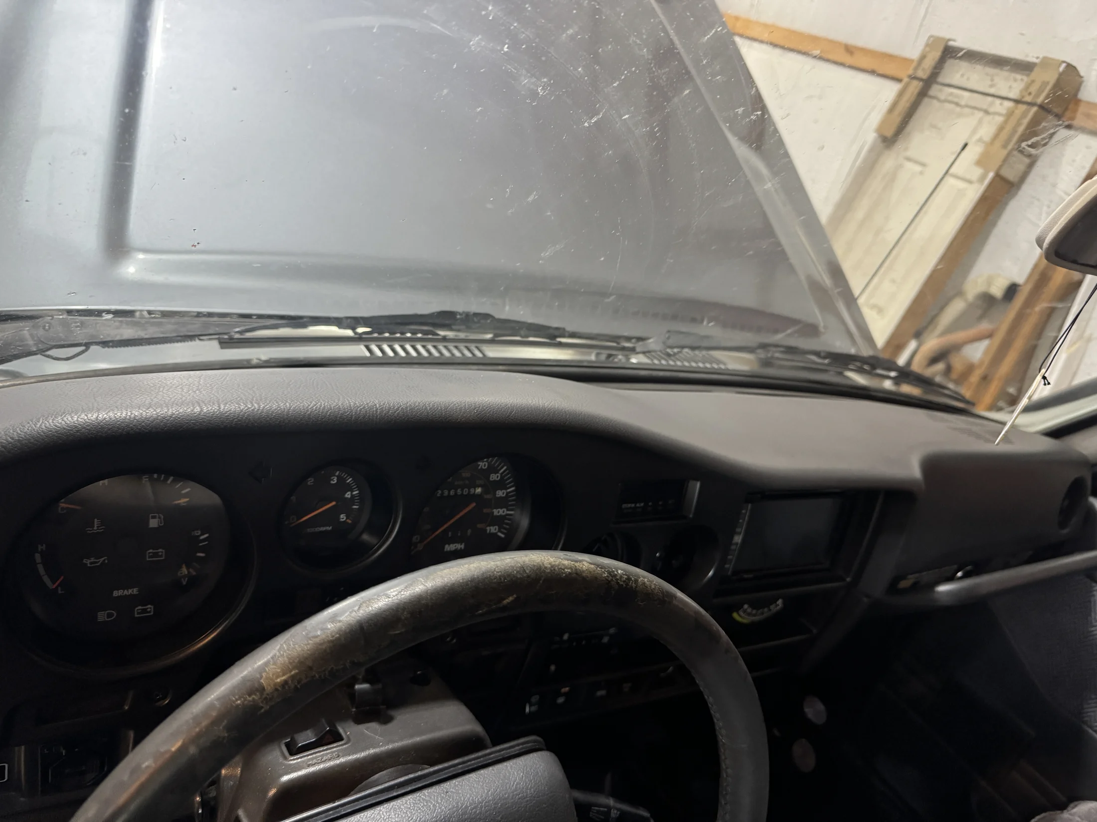

Today I figured I would go ahead and install it and it was pretty quick considering I had just pulled the old one for the swap. I had it out and the new one in in about an hour, just in time for dinner.
Its difficult to tell which one is the old one, but it is the one on the right :rofl:
Now I just need to find a decent place to recover my steering wheel. Not really something I am in a hurry to do, but it just looks hideous! But I am more than happy to have a decent dash with no cracks, and it was nice to buy it from another mud member and save a little $$$$ in the process!
I also straightened out my steering wheel. I had tried before and failed because someone installed the steering shaft 180 degrees out, so the bolts aren't accessible when the wheel and tires are centered. Today I pulled the steering shaft cover, steering shaft, aligned the box and steeringwheel, then put everything back together.

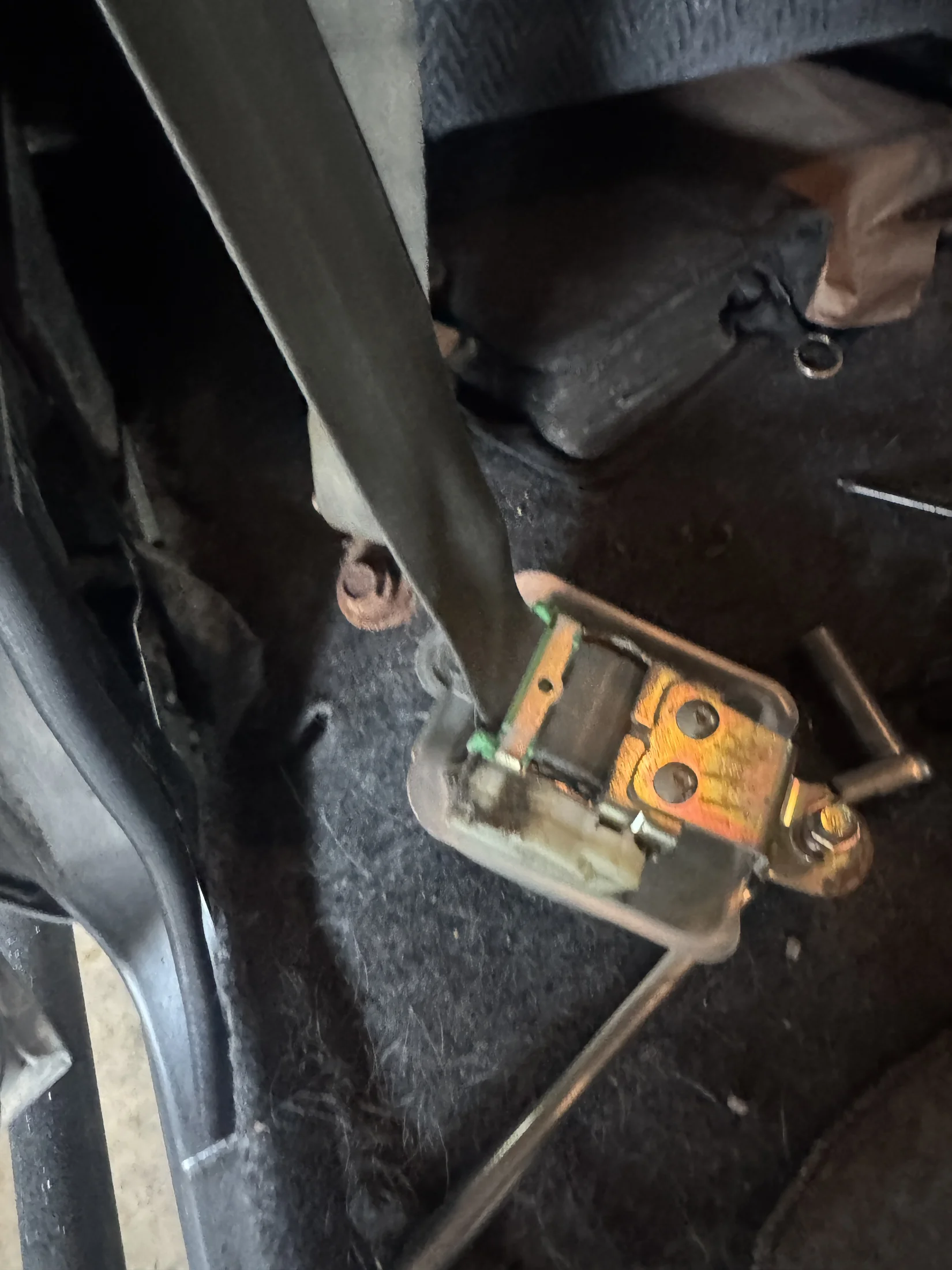

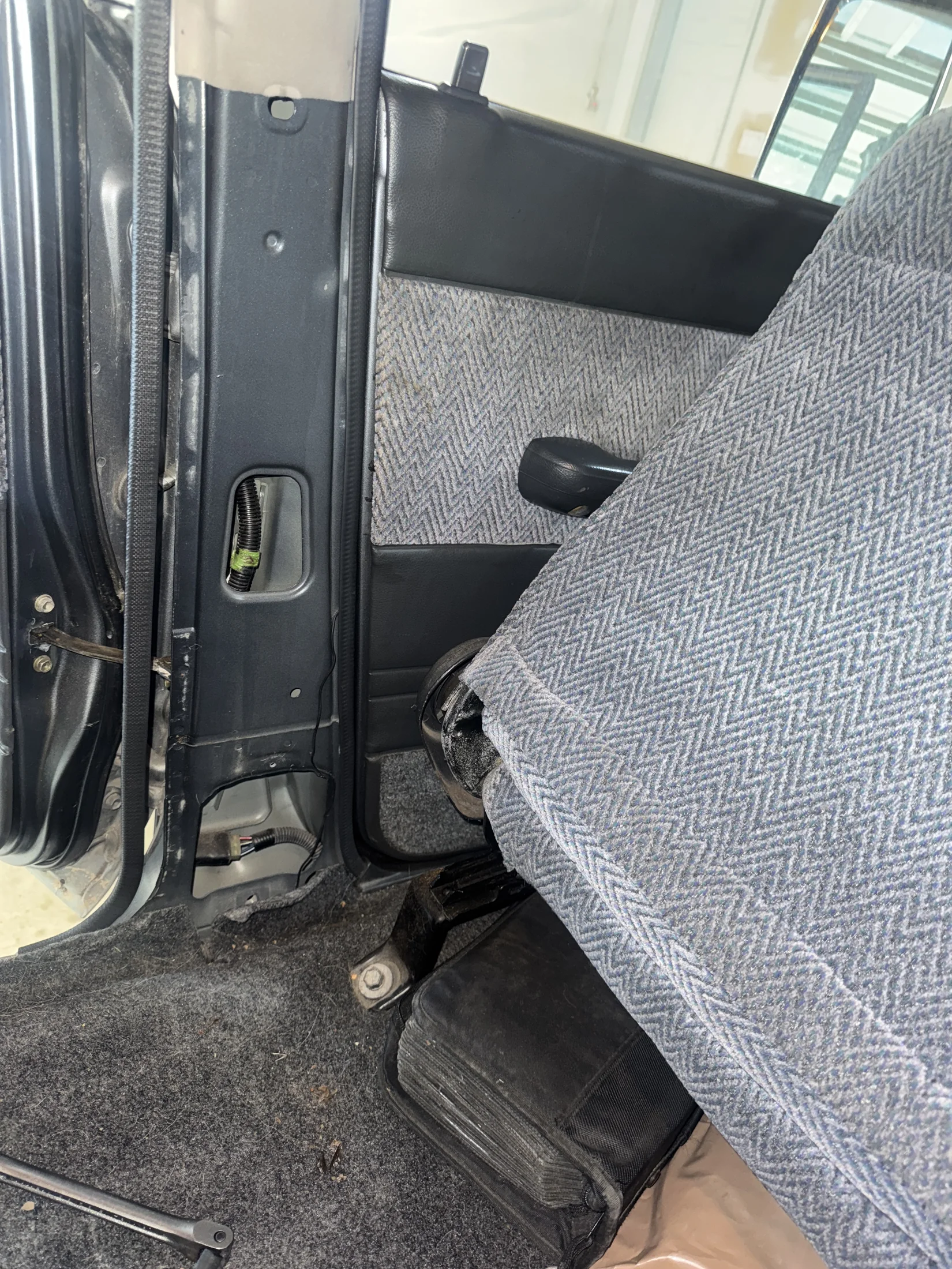

I bought some used front seatbelts from Jonas at Barnyard cruisers back in May. My passenger side seatbelt didn’t have the stop on it & was crushed by the door, so it would fall down to the floor every time soneone got out…. Turns out my drivers side was a different style (possibly wrong) so I swapped them both out tonight.
The set I got from @jkdur728 were in great shape & the buckles aren’t broken, the belts had the plastic stop on them still….good as new. The wife will be happy now!
So incredible. That swap looks incredible! Nice work. Glad I could help with the belts
Thanks, I love the belts glad I got them appreciate it! I’ll have to drive down your way sometime soon.

I've never seen a 3fe (or 2f for that matter) crank split like that. Impressive.
Cool truck, love the build.
I have no idea how it happened...kinda wondering if the crank was dropped or knocked over during the recent rebuild or just a defect that lasted 30 years..... I am stumped.... I drove it nice and easy for the 3K miles I had it.... but I am very happy with where it is now.
