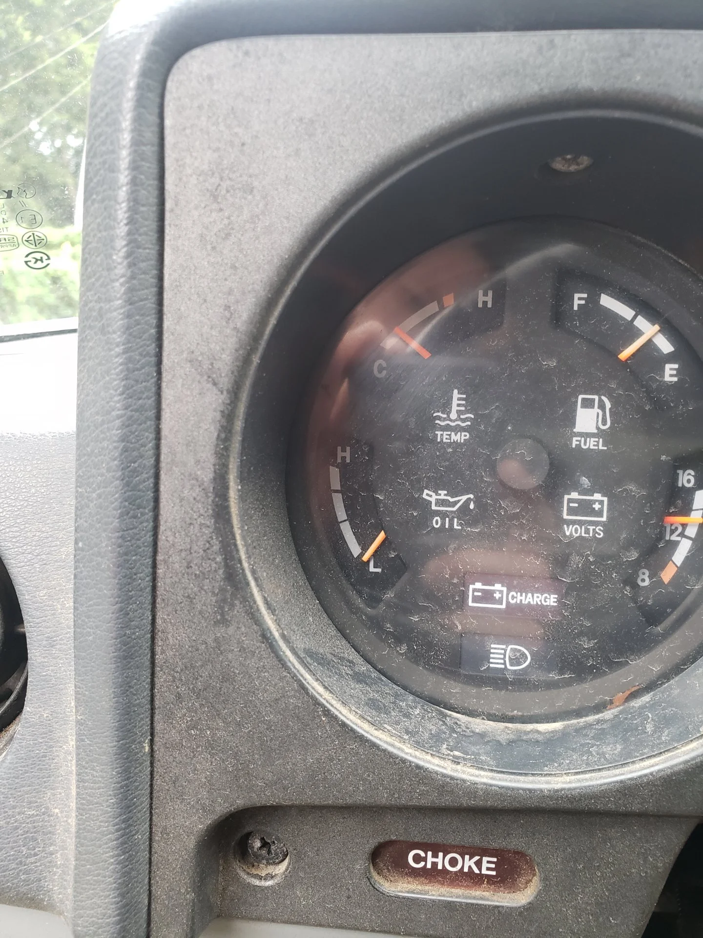

I'm not sure if the 100 sender has the same range that the 60 sender does. That might be an easy test, swap out for the 60 sender.
Something about the 100 sender definitely isn't playing as well. I'll snag a 60 sender and connector.
With a new OE 60 sender:
Thats the same 20psi hot idle. Looks like I'm tracking down a gauge.
62 gauge is available and fits right in.
Made a couple calls and found a few spares locally. Cruiserheads for the win
IIRC the OEM gauge will burn out if it's connected to the tab on the OEM sender instead of the stud on the top.
Correct, that'll send the gage direct to ground and blow the circuit. The 100's gage only has one termination available, and I avoided that little tab on the 60 unit. I'm thinking something has been up with camo's gage for a while. The old 2F is now in my gray 60, and the displayed oil pressure is higher there. We're pulling a spare from the shop's parts pile to see what the deal is.
83246-90A05 GAUGE, OIL PRESSURE RECEIVER is what I found for the 62. Add that one to the list of NLA parts.

FYI: If your gauge still goes up at all - it's electrically fine. I just had this same issue with my 62 oil pressure gauge. Basically I had connected it to the wrong terminal on the sending unit, which pegged the gauge out. When you do that, it mechanically over-travels the gauge and bends the mechanism. I took the whole gauge housing out of the cluster, removed the two corresponding nuts on the back and removed the oil pressure gauge unit. I then took a pair of needle nose pliers and carefully bent the back of the bi-metallic strip (where the upper and lower portions join) so the needle rested perfectly at "L" when un-powered. I put it all back together. and the gauge goes up to mid-point with the engine running now.
