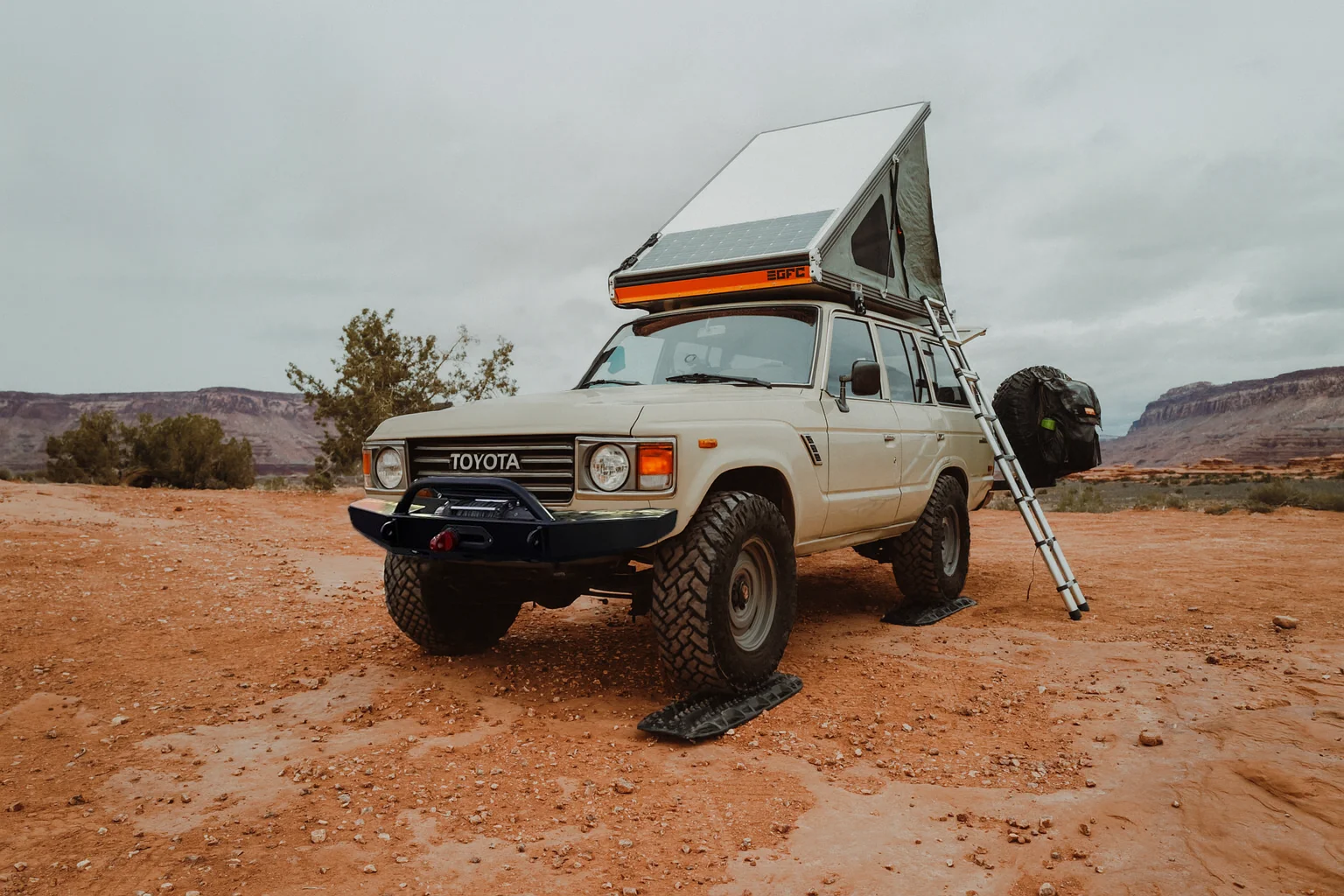

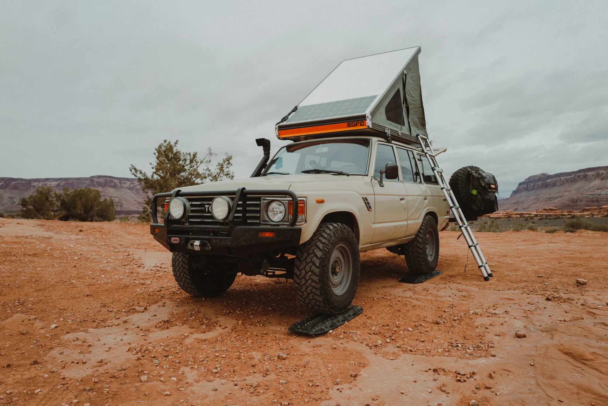

This is how the truck is sitting now, minus the ARB aux lights on the front bumper.
This is mock up of the low pro bumper and snorkel removed.

I prefere the low bumper , but I would keep the snorkel :)
that tent is very nice too (a bit jealous ahah ) , gutters should be able to hande it been taken on and off.. still depends how clean they are
I should also mention the snorkel is not in use. With the V8, it was restricting the airflow too much. And agree on the low pro bumper!
When I installed my GFc to my 60 using the gfc mounts it pulled quite a bit on the aluminum of the rtt, almost damaging the tent. I think the gutters will be fine with on off tho.
I know front runner has ha quick attach system for tents and their racks are pretty unobtrusive.
Nice. Looks like you might have used a pic of my front bumper for the mock-up, the red thimble being the clue. That bumper is for sale in the Classified section btw.
I happen to like grey rims, I wouldn't change those out unless there's a fitment issue... just IMO. Looks great with the tan!
Haha, yea I think I did. Would totally grab it from you but I am in Louisiana. Bit far…
