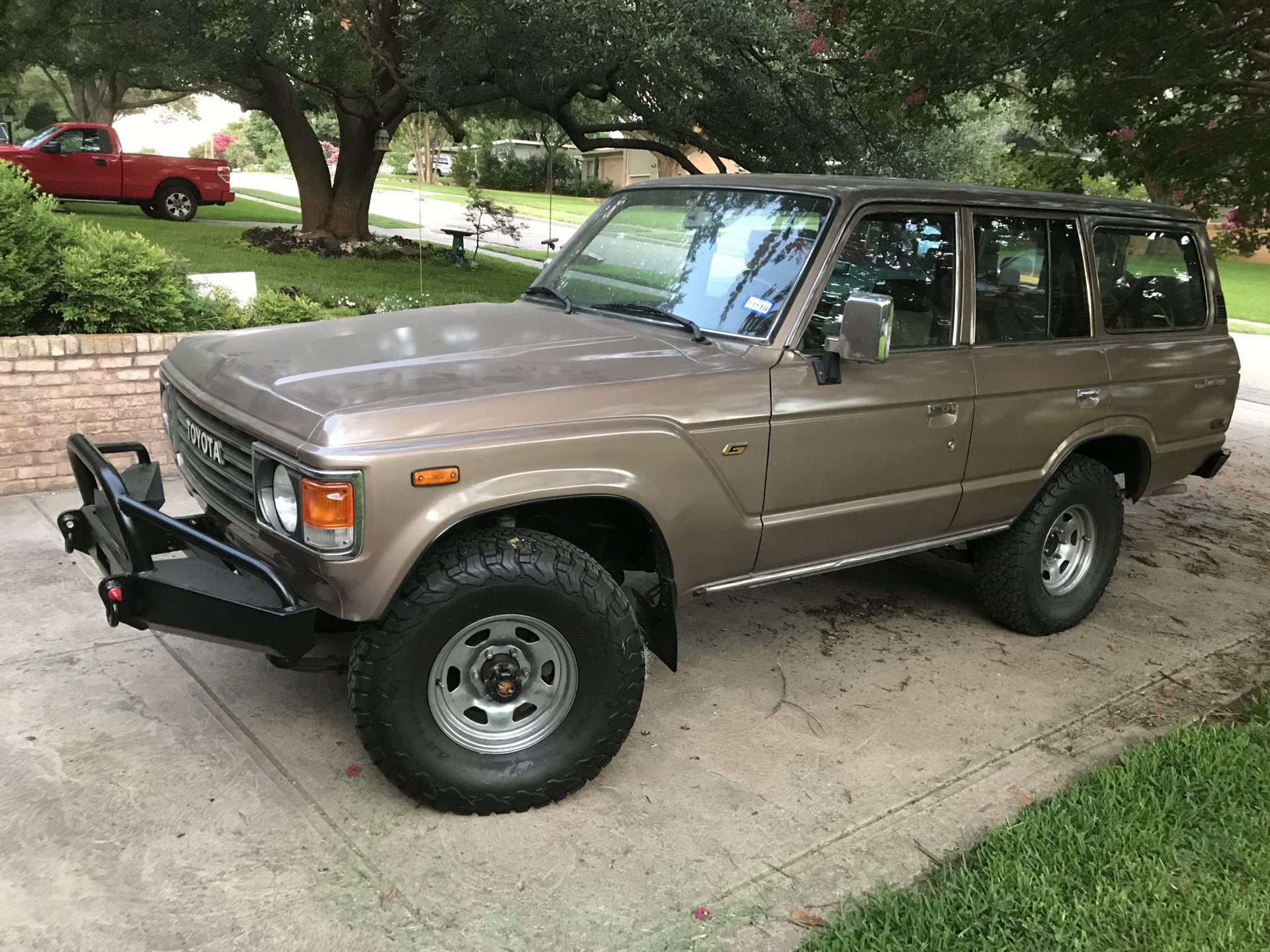

I have been meaning to start a build thread since 2017 when we got her. There have been a few distractions with my boys projects that have slowed the start.

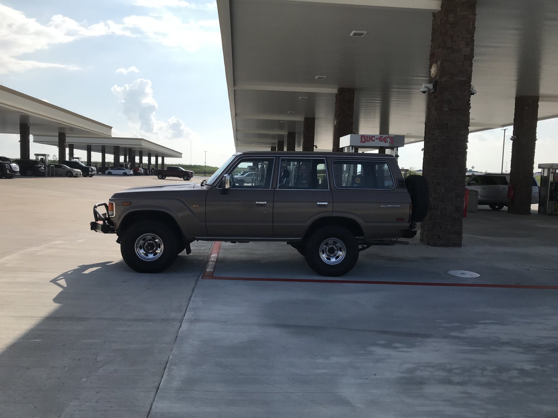

The fam made an adventure out of it to fly to Nanaimo, BC to pick it up and drive it back to Texas. We drove in the winter through Yellowstone and made it to TX with a water pump glitch that was sorted out in Missoula Montana.
Details:
1986 build date
2H diesel LHD
A440 automatic
Splitcase
Semi float rear
OME lift
BFG all terrain 33X10.5x15
I added 4Plus 8274 winch front bumper and rear bumper (3 gas can capacity)
I can’t take credit for the current name. That goes to @thatcabledude. Original name was Rootbeer. It is getting a full float 80 series as you read later on. Hence Rootbeer float.

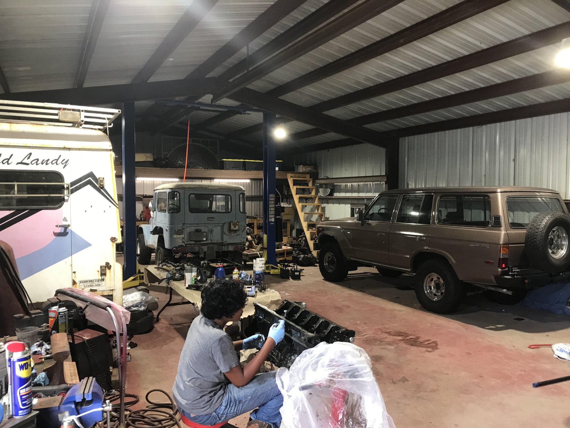

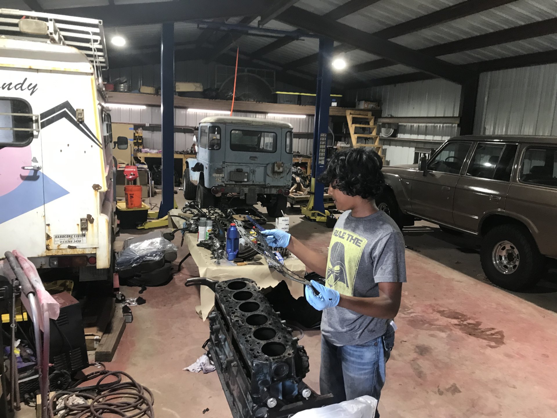

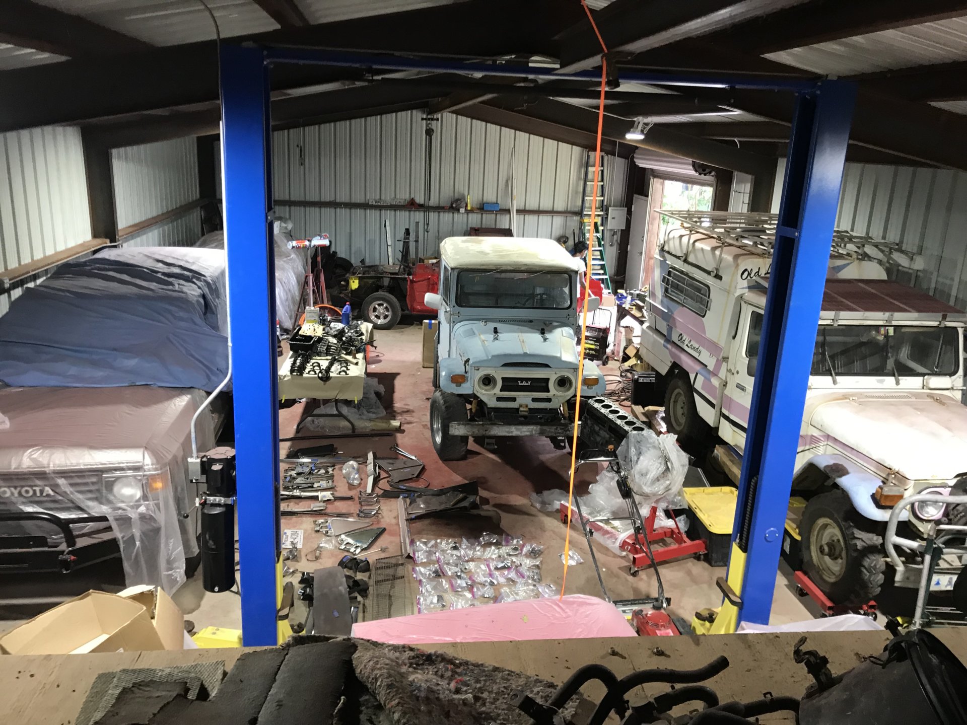

Rootbeer float sat waiting while we got through some of the boys projects.

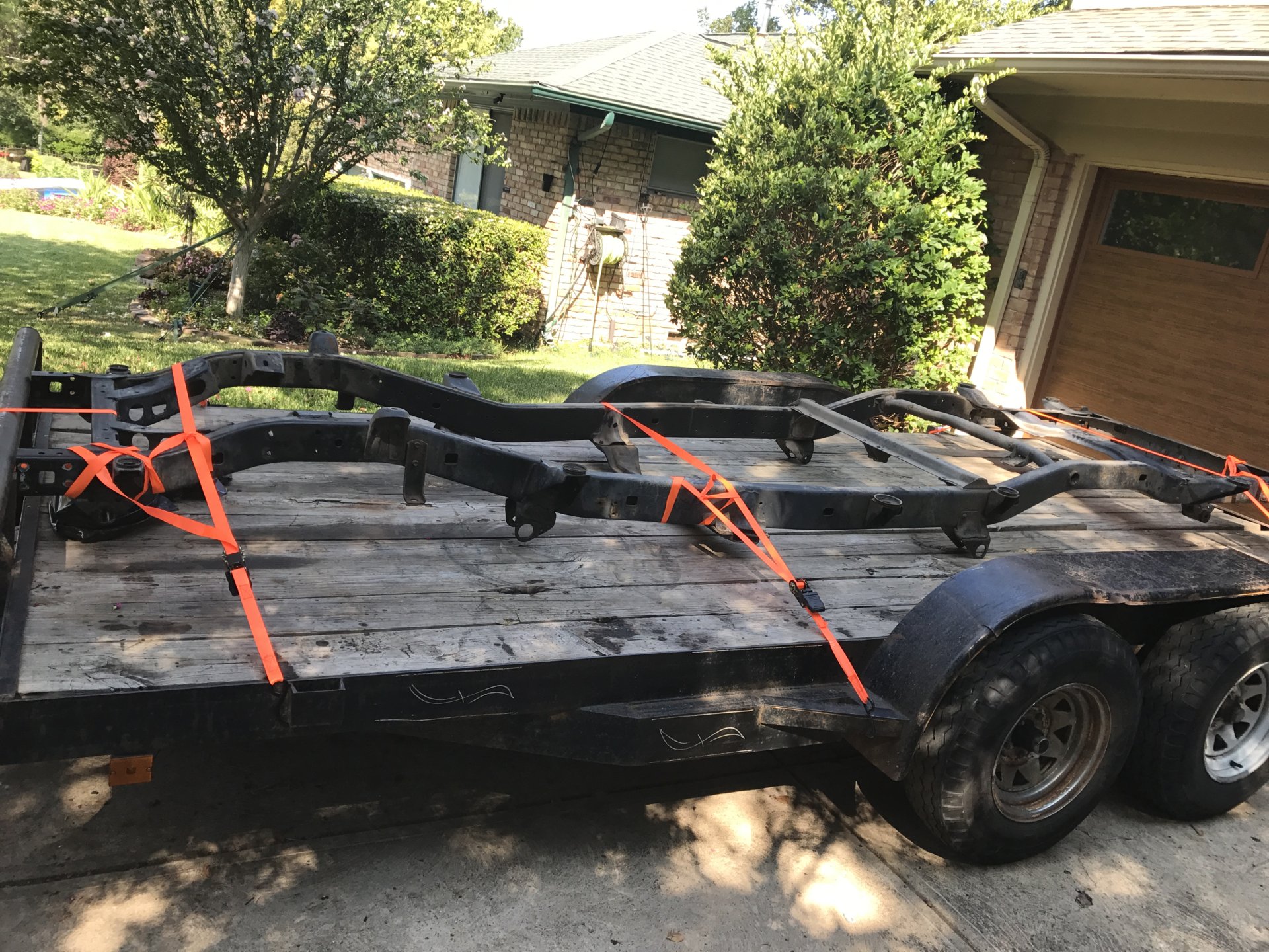

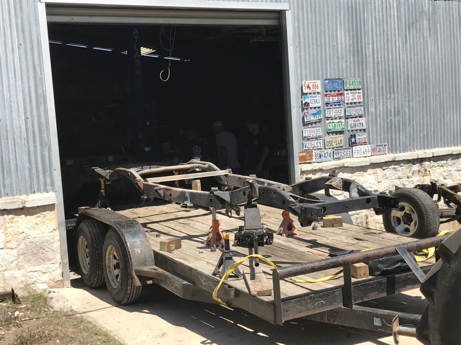

It’s been driven while waiting it’s turn. It’s got an crusty rear frame. @4Cruisers was selling a fj62 body and frame. @CenTXFJ60 wanted the body. I wanted the frame. We did that in @CenTXFJ60’s magic barn in 2018!!!!!
@Cowboy45 was daily driving Rootbeer float to school for over a year. One evening his feedback to me was he was hearing a “thud thud” noise. Look to see that rear shock tower had separated from the frame. Nothing to weld on but Swiss cheese. This accelerated the need to get on it.

Not all Canadian cruisers came with semi floats. Some did have full floats. Especially HJ61s.
More rigid frame. Fits FJ60 bodies with minor tweaks. Rear cross member mainly. I will be taking this out to put the 4 plus bumper.

1. All US spec fj60/62 came with semi float rears. Some foreign market specs received FF option and Canadian Hj61.
2. 62 frame is a bit beefier as far as shock and spring mounts are concerned. Trans crossmember is set farther back for the auto. Also different offset for 3fe engine mounts.

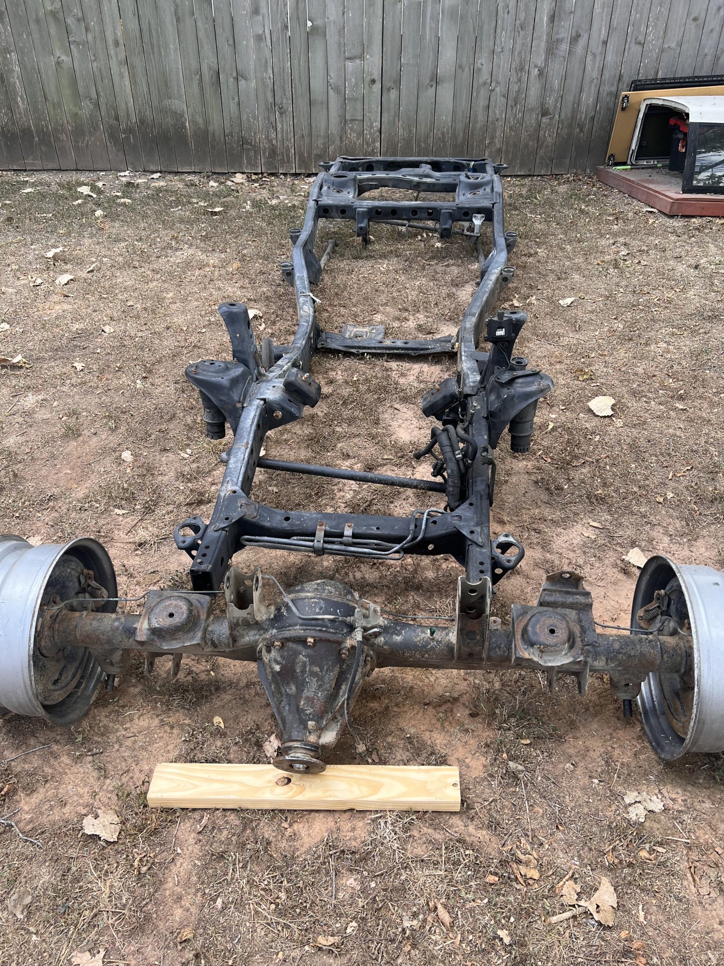

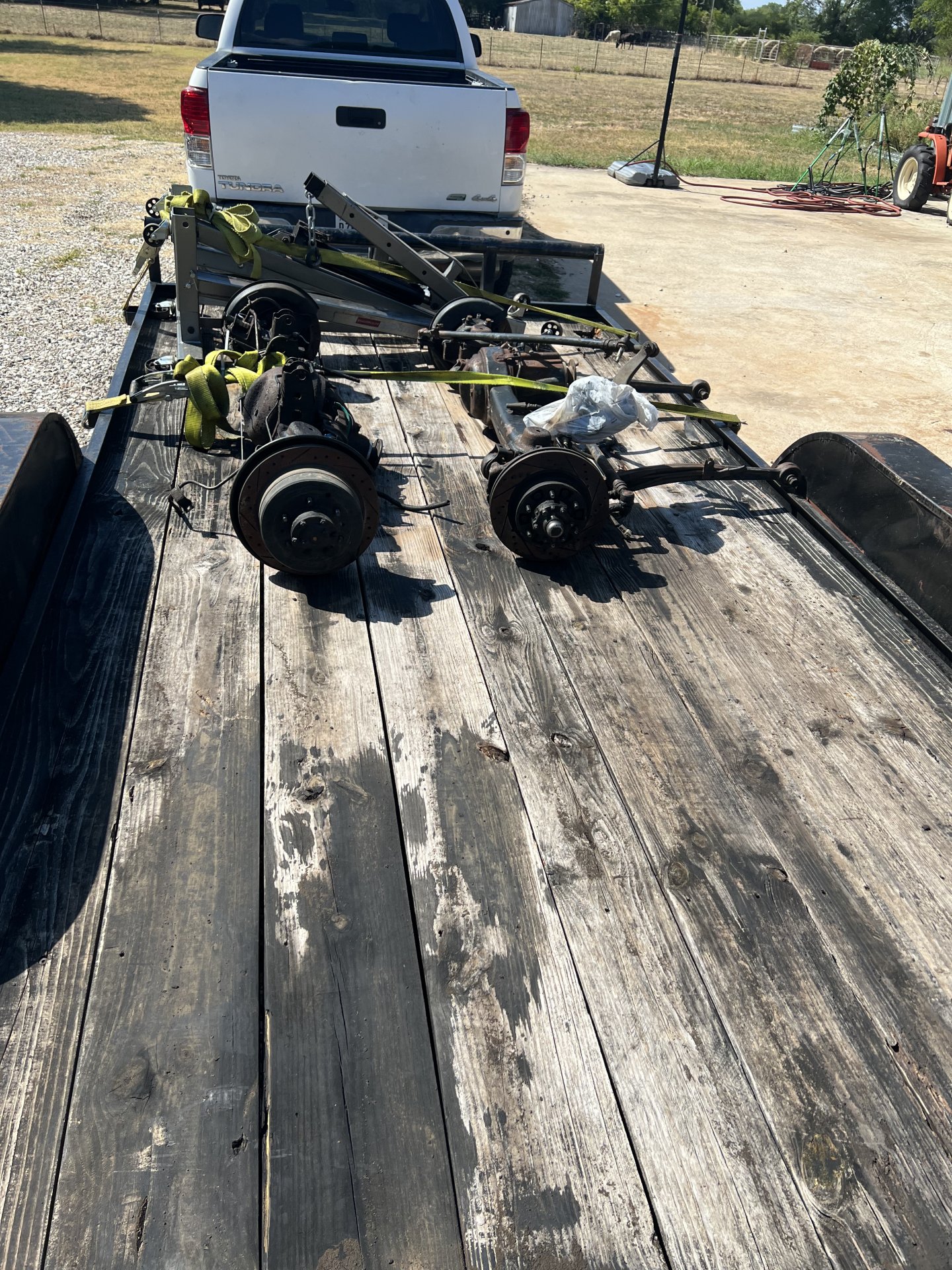

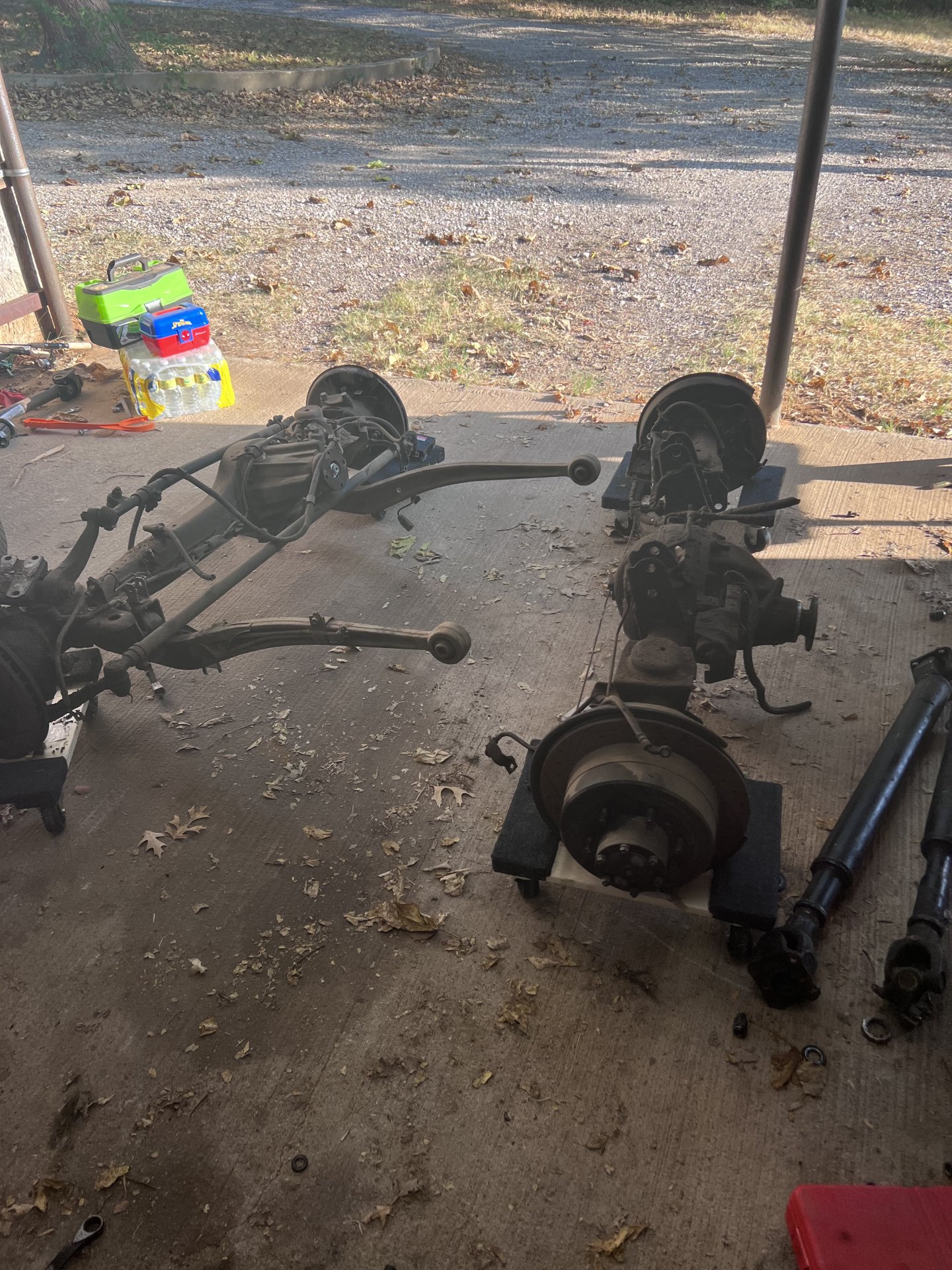

Picking this up tomorrow. 1997 fzj80 frame. Decided to take a different direction. Shortening this to go under Rootbeer.
That’s going to be a lot of work. Are you going to use the coils too?
It’s going to be either way. Using all coils. In it for a challenge and learning. Want an upgrade with TEQ parts. The 80 frame is stout. It would be a whole lot more work if I had body work and other resto which I don’t. Prefer the 80 rear coil option compared to what else is out there. I also like keeping the keeping 80 rear axle as is and using the factory uppers and lowers. Most say 80% of benefit of this mod is got from the front coil conversion. I get that. I like the rear coils. Got a free full float rear axle in the deal which gets me the frame for free.
