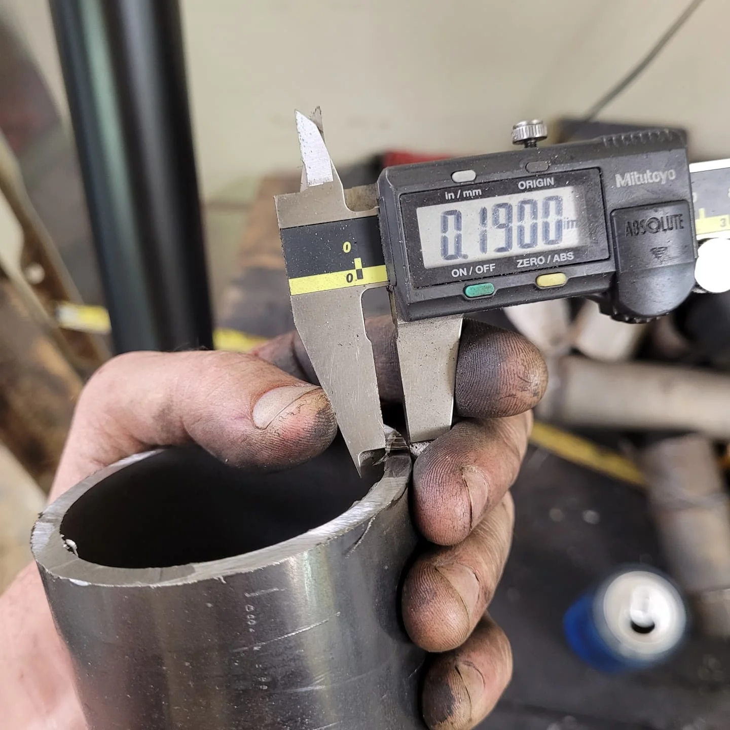

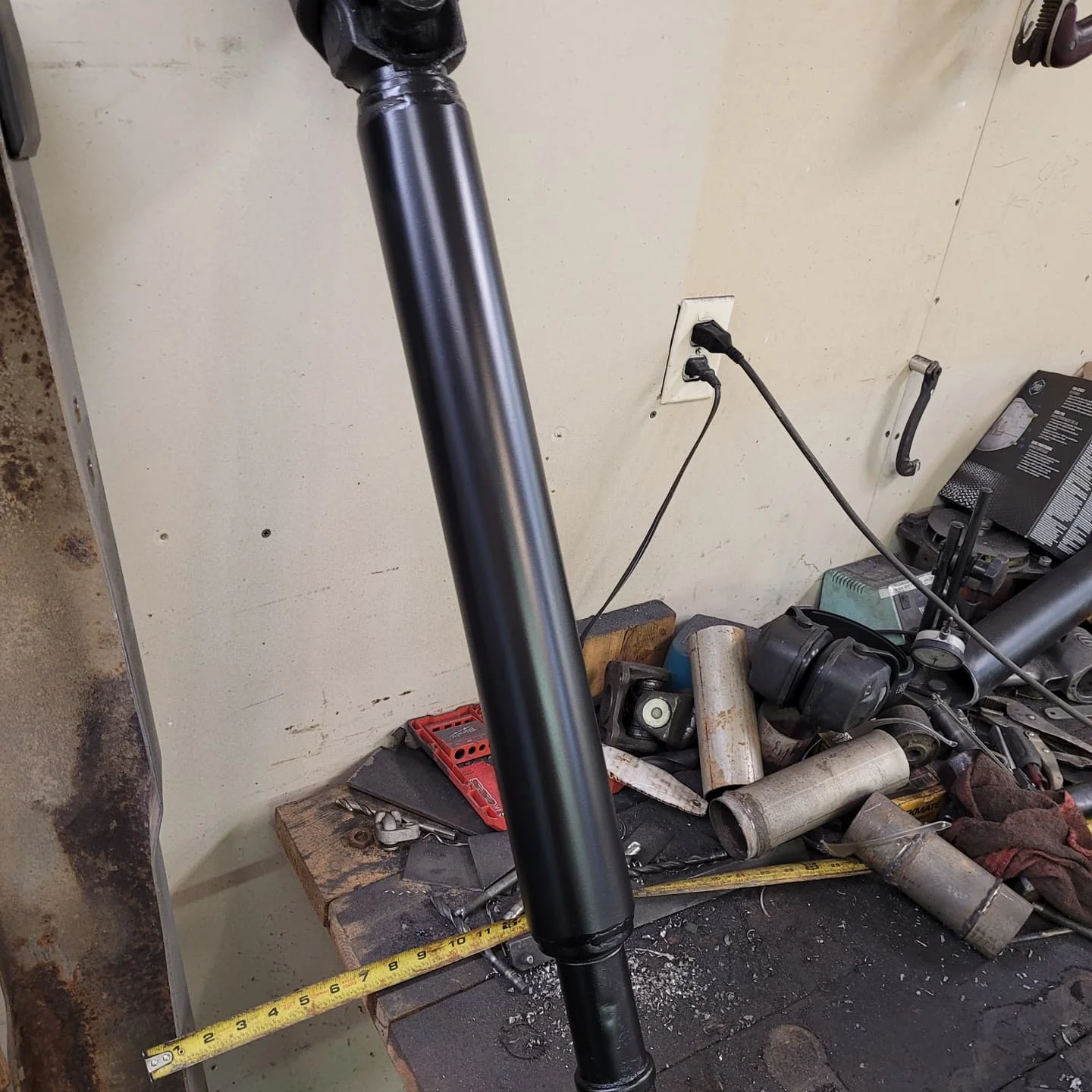

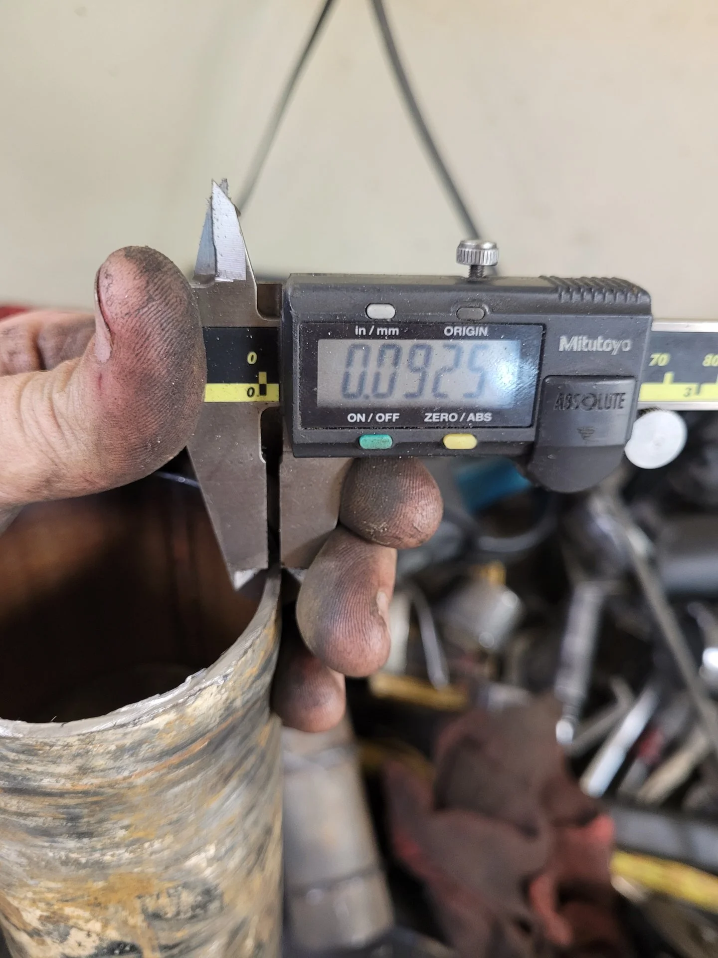

I banana'd the rear .085 wall driveshaft back in August thanks to a little bit of whiskey throttle in the rocks and limped it home at the one speed that didn't shake the truck apart. The new one runs dead true and is made from 3/16" tube - still running Toyota CV up front and LC rear joints.

Rear drive shaft runs true but kicks up a slight vibration around 53-55mph. I might get it balanced one day. The shaft tube took a whack at some point last weekend. Looks like the rock lost and the bearings and joints are still tight. :cool:

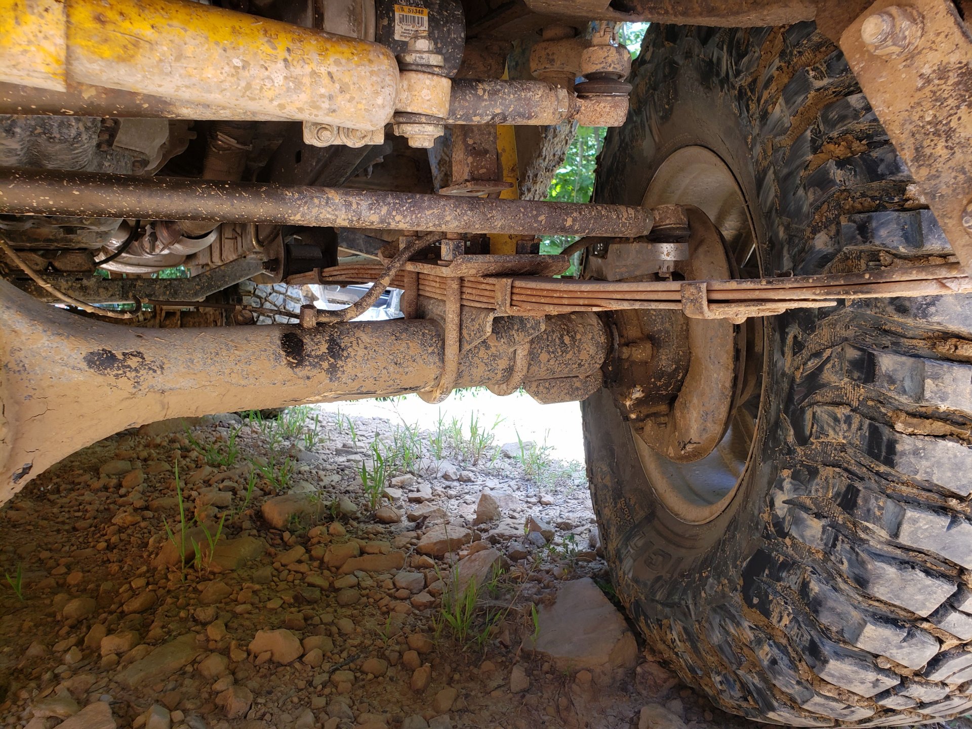

I replaced the rear shocks with the 380-rebound M7100s. That sorted out the rocking shown in the video above. Feels safe now. Well, felt safe. Until I wrecked the front springs last weekend:
I've jammed in some used 2" 60-springs, but they've got enough life in 'em that the nose is too high for my liking. That leaves me kicking ideas around for what to do next.

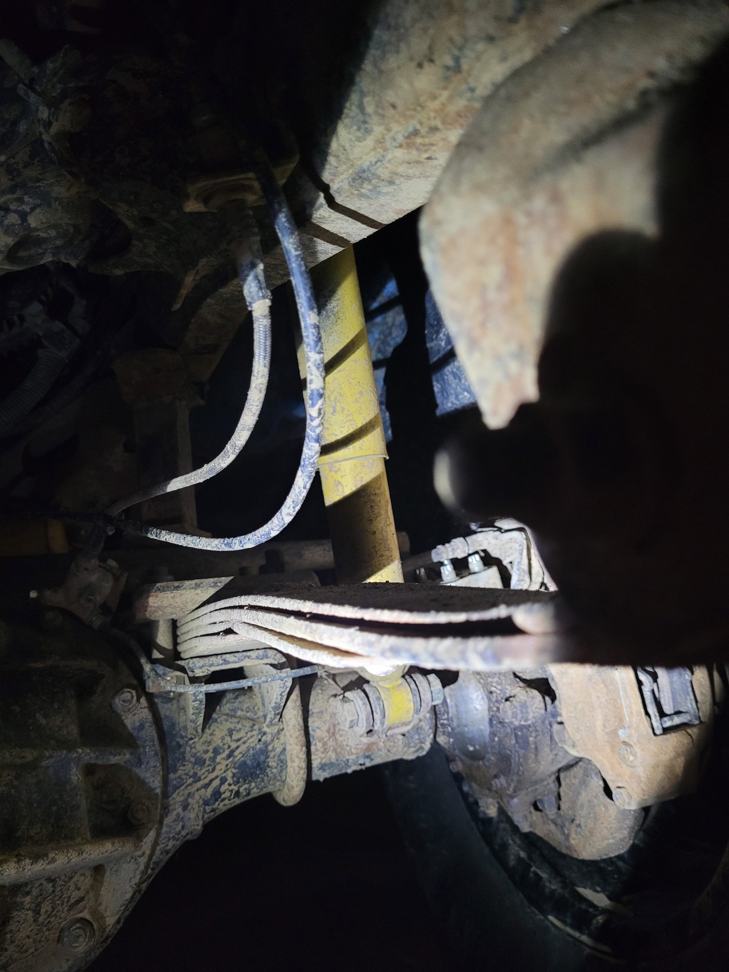

I poked around several catalogs and had some discussions around this project and some other stuff that will be coming as a result. The best packaged solution for what I've got in mind is to stick with the tried and tested 60/62 packs up front with AAL. Cost, parts availability, performance, and durability all come together best with this option so far. End goal is to get back to my previous height so the hangers will all land in new places. This will drive new shocks, but they needed to go anyway - they were limiting droop.

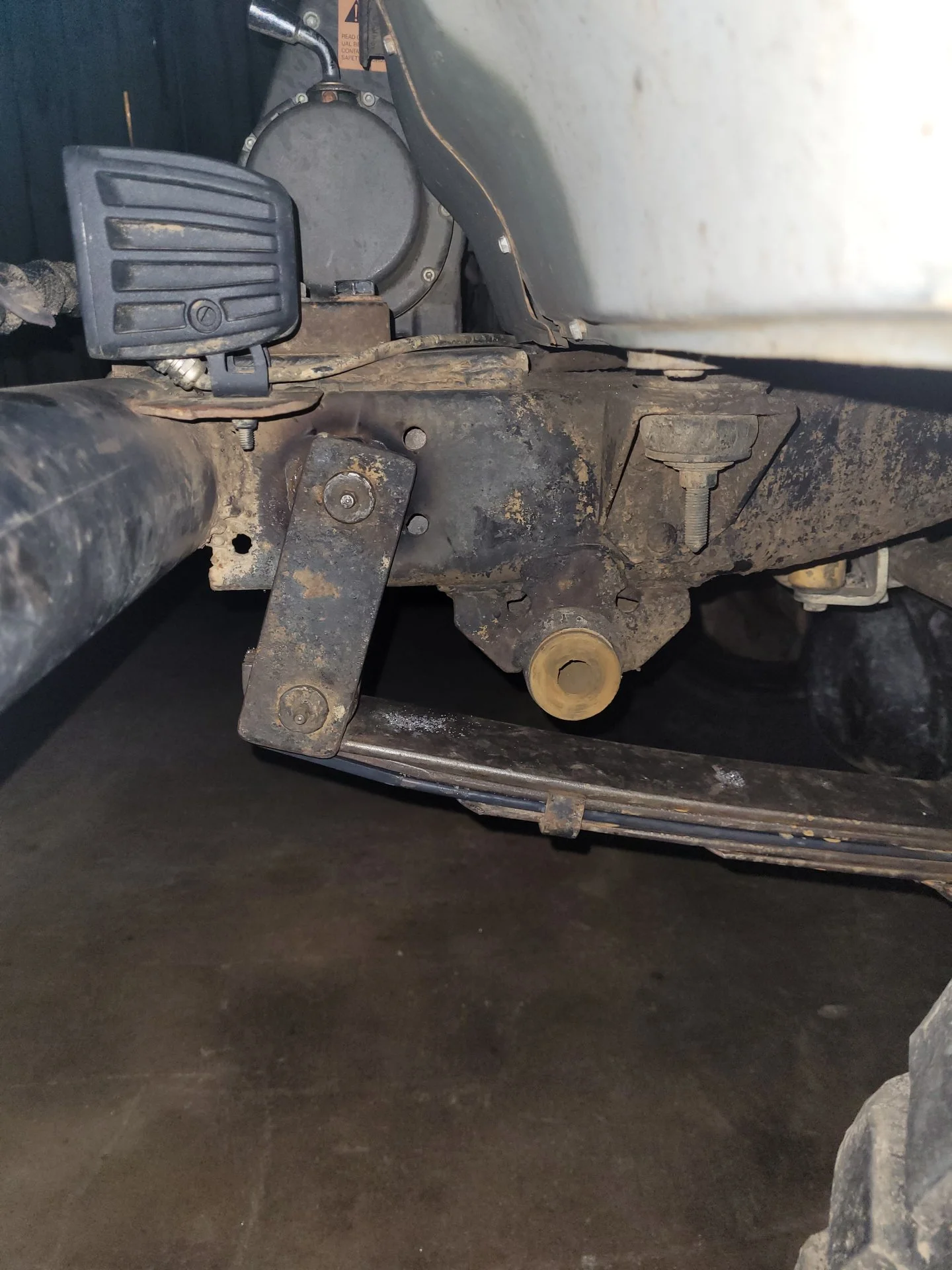

New front suspension layout:
The springs are the old factory rears with an AAL to wake them up. There's about an inch and a half of arch in them. That put the nose way high, so the shackle hanger got frenched. Left the stock pivot hanger. I'll get it twisted up and we'll see how it works out. If all goes well, I'll yank the old shackle hanger and carry on.
Got to play with the new suspension a little this weekend. Holy crap. So much better. Driving over little ruts like those below with speed is no issue. Might not even spill any beverage. I like it.

Forgot to follow up on the front shackle hangers. They and the height, or lack thereof, that they enable work well. I cut the factory ones off a while back. Further changes to the front end are very much in the tweaking / refining category. This truck doesn't sit as low as @cruisermatt's 62, but it's still a very tame height compared to lots of SOA 60s.
All SOAs require a fair amount of fab work, so frenching the hangers isn't really that much of a scope add. I'd recommend it 100%.

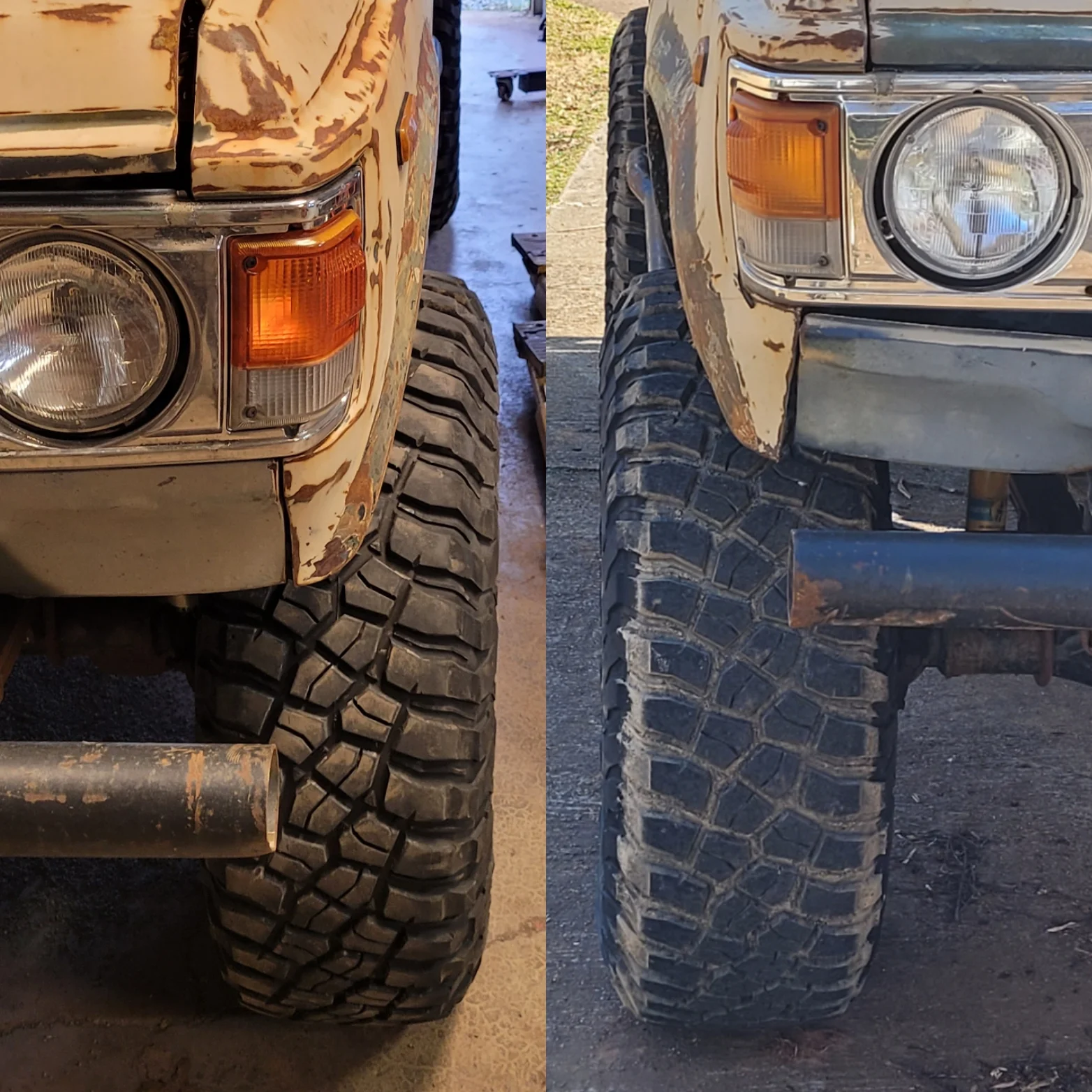

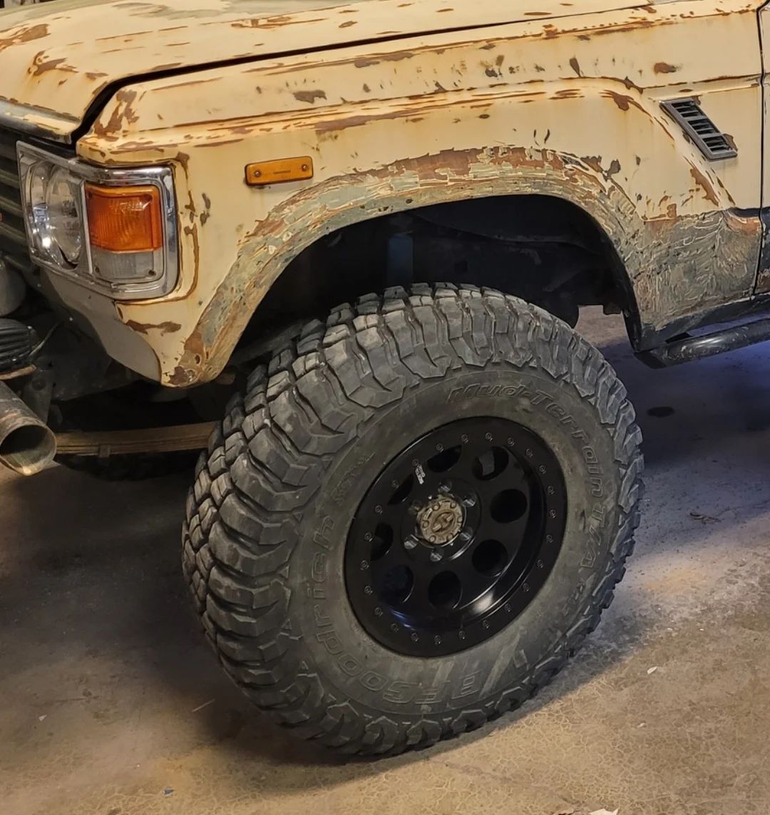

Little update. Found a few fun funds and acquired some 'locks. An inch more backspace and effectively an inch wider, but the stance aesthetic isn't really affected. Looking forward to running some single digit pressures and seeing if these km3s can hook up.
Much appreciated. @bush discovered these for our group and ran them first. He's given them a serious thrashing and they're still kicking. That plus their price point made them hard to pass on. Sidetracked Offroad is the vendor. I think they have them made, but don't quote me on that.
What are the specs, and what was the true width ?
Thanks
They list as a 17x9, but I didn't measure them. I should have.
Seems that lots of BL vendors are measuring inside distances between the wheel lips. Which throws you off since the outer bead actually seats the inside tire surface against the outer lip...adding roughly an inch of width.
