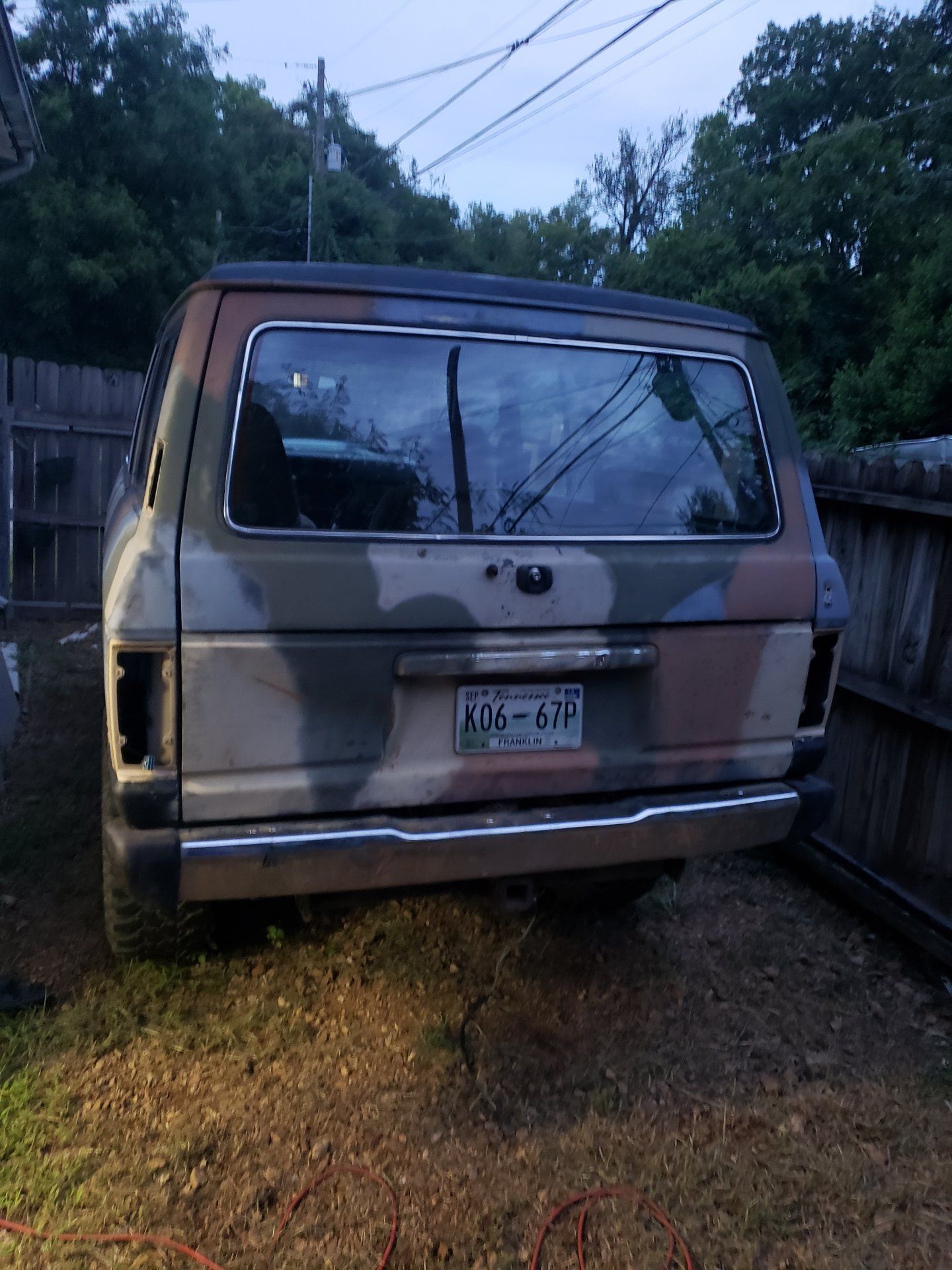

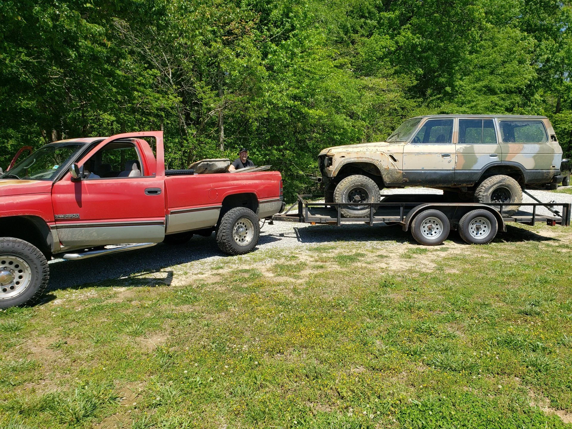

I'd seen this truck in the sale ads for a long time, but never could seem to get a hold of the owner. Heck, I'm sure several of us in the South have. Then a couple weeks ago I was making plans to pick a few pieces from a 470 at LKQ Nashville and things happened to line up. I'd just sold some stuff and had some cash burning a hole in my pocket, and he happened to answer a few messages, so we took the long way home from Nashville to check this old girl out.
Several things were going against it mechanically to keep it from being test driven but we poured some gas down the carb, gave the battery a jump and it ran just long enough to not hear any weird noises. As I pondered just where in the hell I was gonna store it, how much explaining I'd have to do to the gf about another cruiser showing up, and why I would pick up another frigging project, solutions came up for all of these problems and we cut a deal with plans for pickup the following weekend.
I'd made a list of failures that kept it from moving under it's own power and got parts ordered or pulled from the spares bin. I recruited @ufg8r to help with the field repairs (thanks again, Chris!) and the owner pitched in to get a fresh battery charge and air up the flattened 35.
Once we returned, the workload got lighter as the "seized" clutch broke free after I gave it a few whacks with a pry bar to break mud/rock clods and dauber nests out of the clutch slave/fork works. Chris replaced the fuel pump, and I replaced a few fuel lines and rigged up a gas can to keep it fed. A little more gas down the carb to replace the varnish and she drove up the trailer.

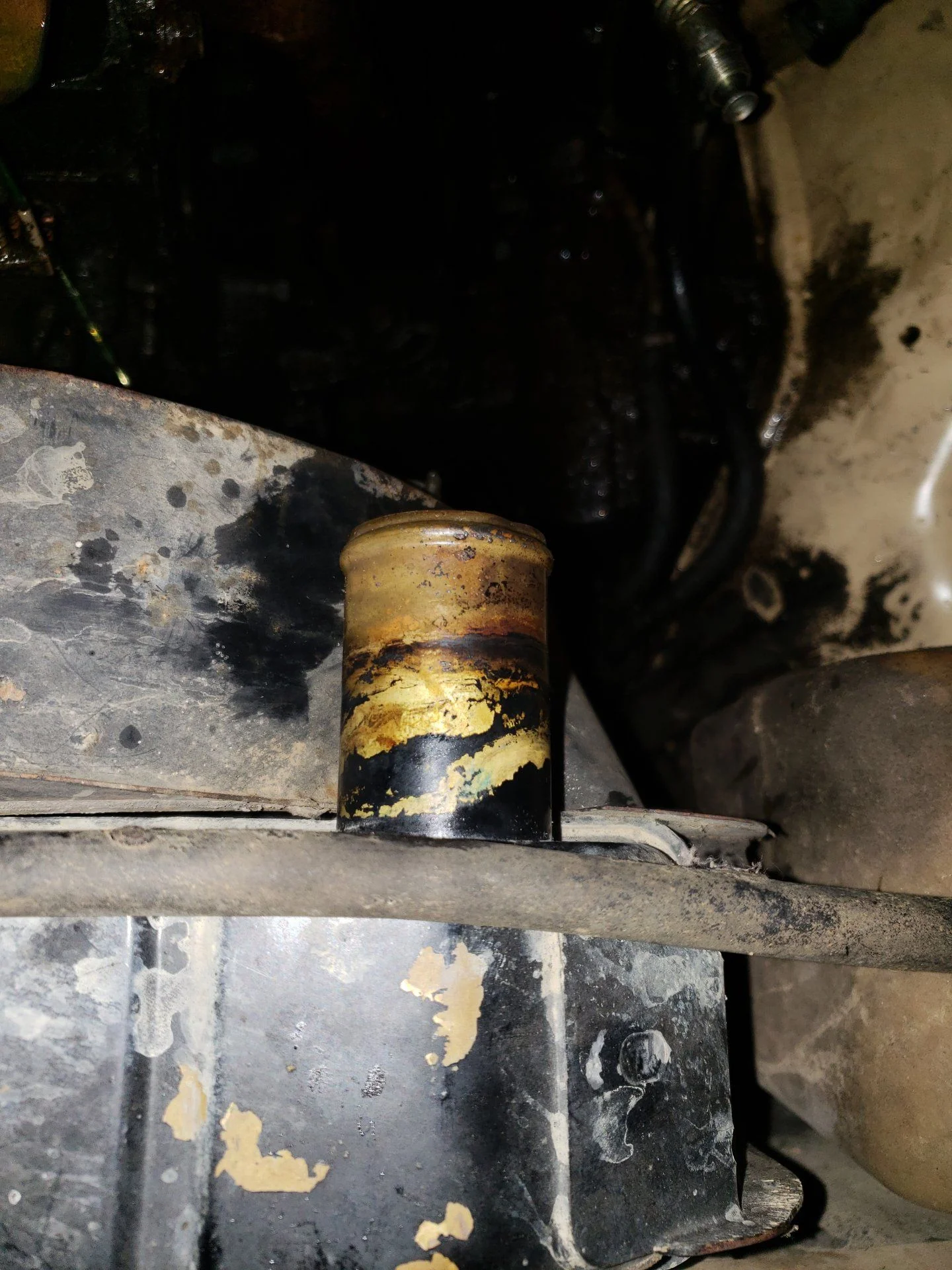

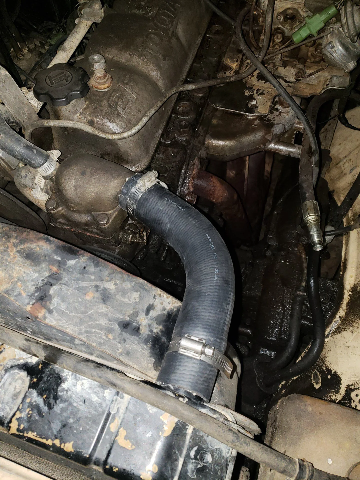

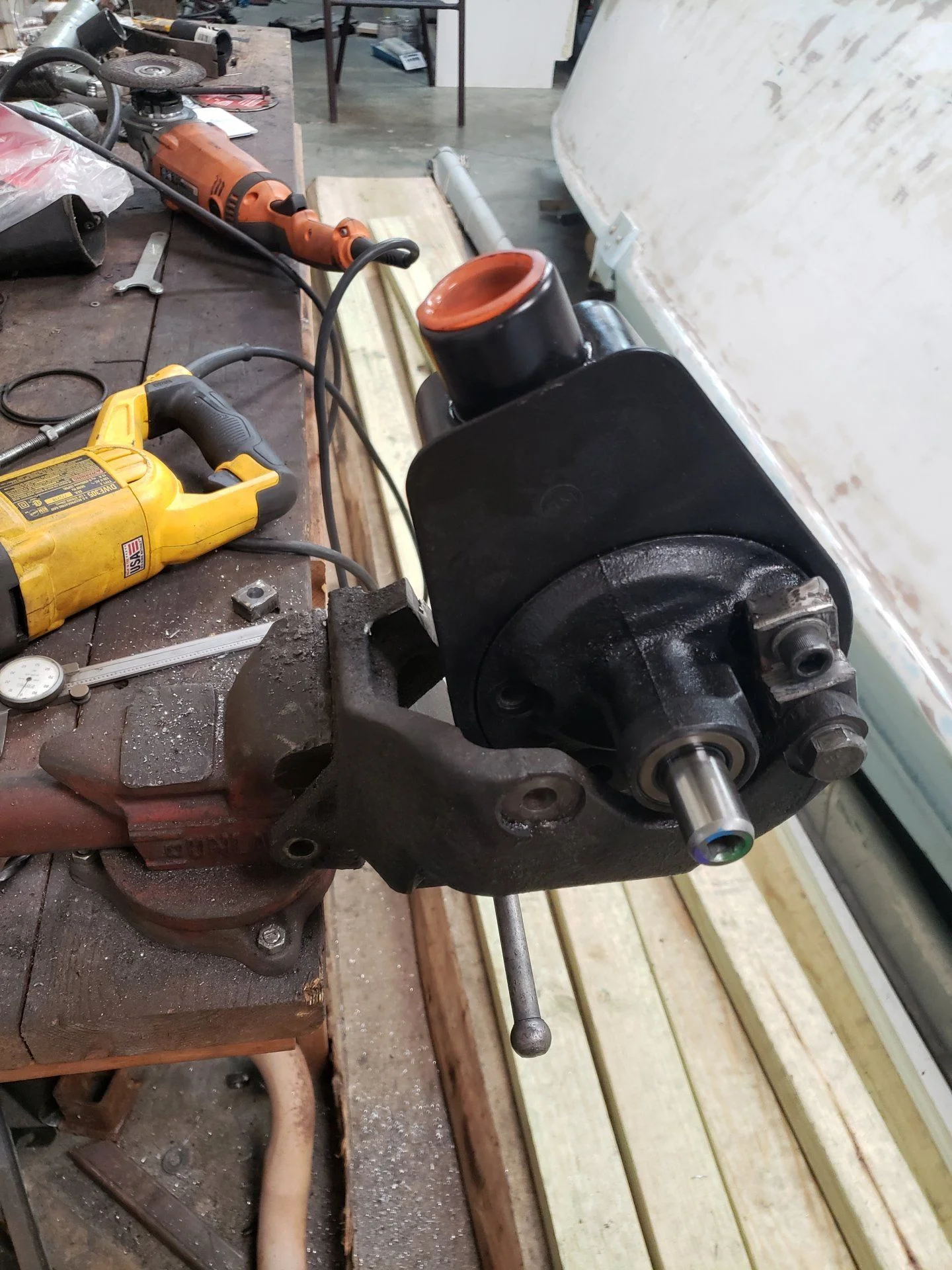

Got started on the power steering fix and the timebomb that was the upper radiator hose.
I used Cruiser Bros Saginaw swap kit on my other 60 and it worked a treat. I'd have gone that route again if not for the budget this thing is on. Scrap or spares are the name of the game when possible this time. So out came the sawzall, the grinder, and the welder to fab up a half a$$ replica. I'll do some poking around to find the 3/8 bolt I'll need to fasten the other hole.
Pulling the upper radiator hose revealed a welcome surprise, a corrosion free OE radiator opening. I trimmed the new Gates hose to length, added a couple new clamps, and topped her off. Time bomb defused.
