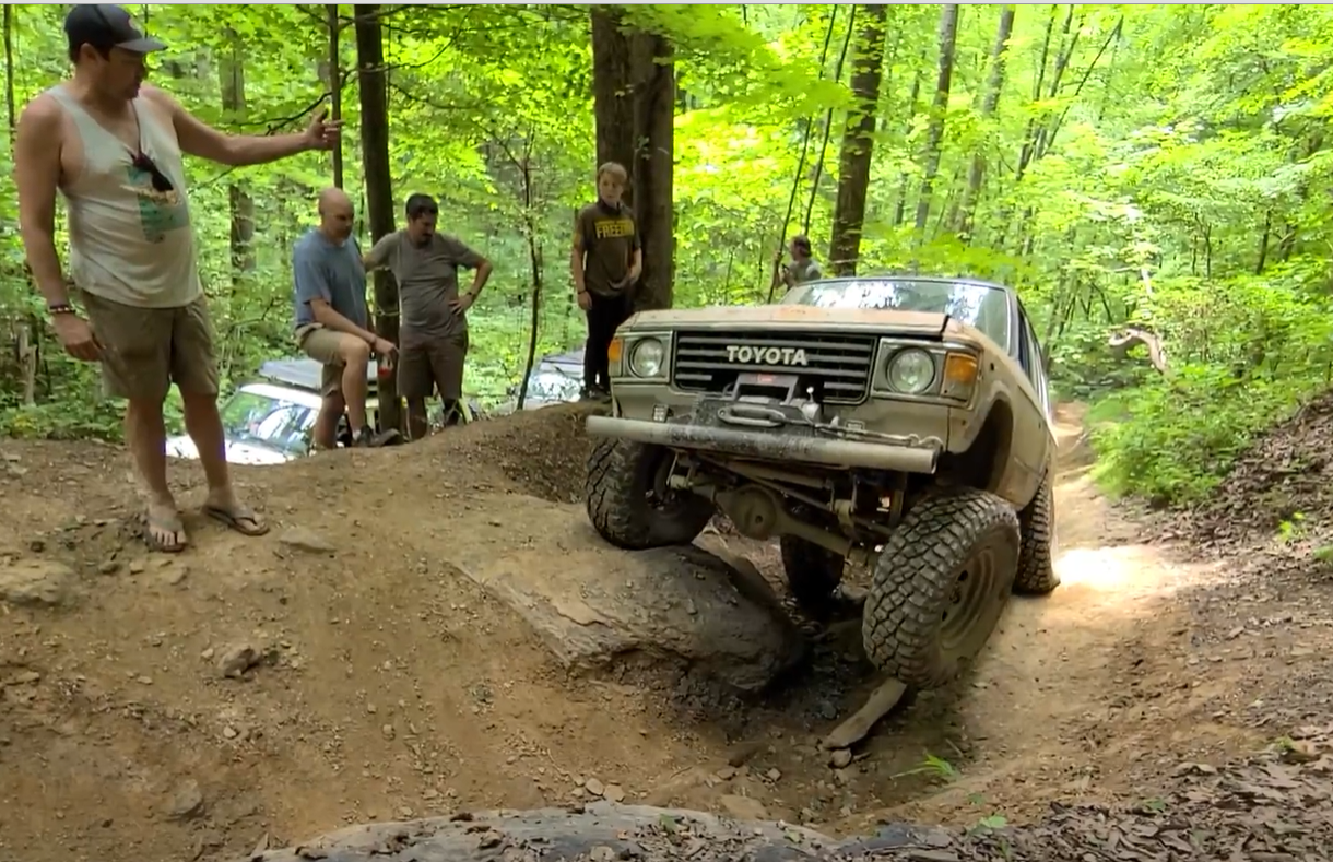

Thanks, guys. It was fun to stretch Camo's legs and see what she could do. Loved taking all the lines I used to have to pass up knowing full well that Gray had no shot on 'em, like this one:
She didn't come out totally unscathed, though, so she'll get a few tweaks so that I don't have to be so gentle. The main one is the engine...she's gotta go up - there's lots of room so I figure I'll move it up 2". Reason being that I had a little fun coming out of an obstacle and crested a hill under throttle right into a deep hole which rolled the pinion high up into the oil pan when the tire hit the hole wall. Thanks again to all the folks on the trail for sparing their JB Kwik, their oil, and their patience to help me get this thing patched up.
The rest of the week went by repair-free thanks to lots of good spotting. She rides well on the trail and turned in good fuel economy to boot. Averaged 17mpg on the highway there and back, and made one visit to the pump for the whole week we were there.
