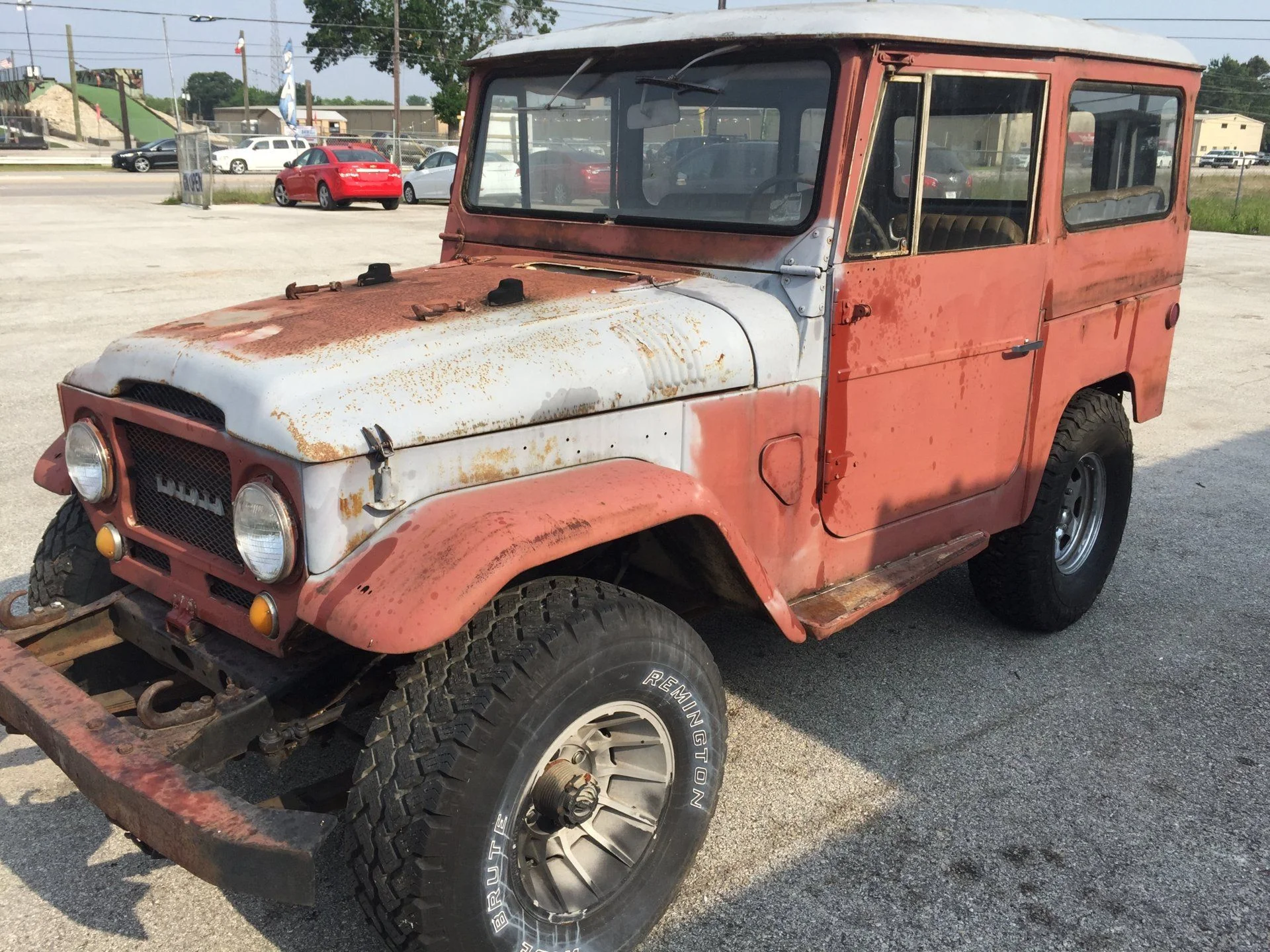

A friend of mine picked up this 40 with us going half and half on it. We were going to share the truck and eventually one would buy out the others share. Well, that time came sooner than I expected so I jumped on it.

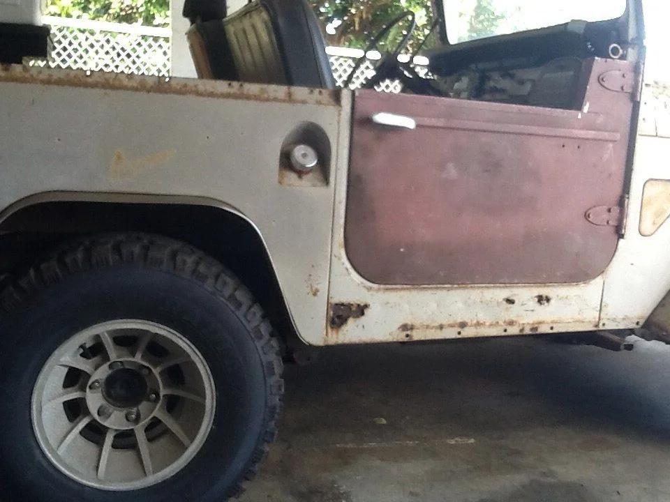

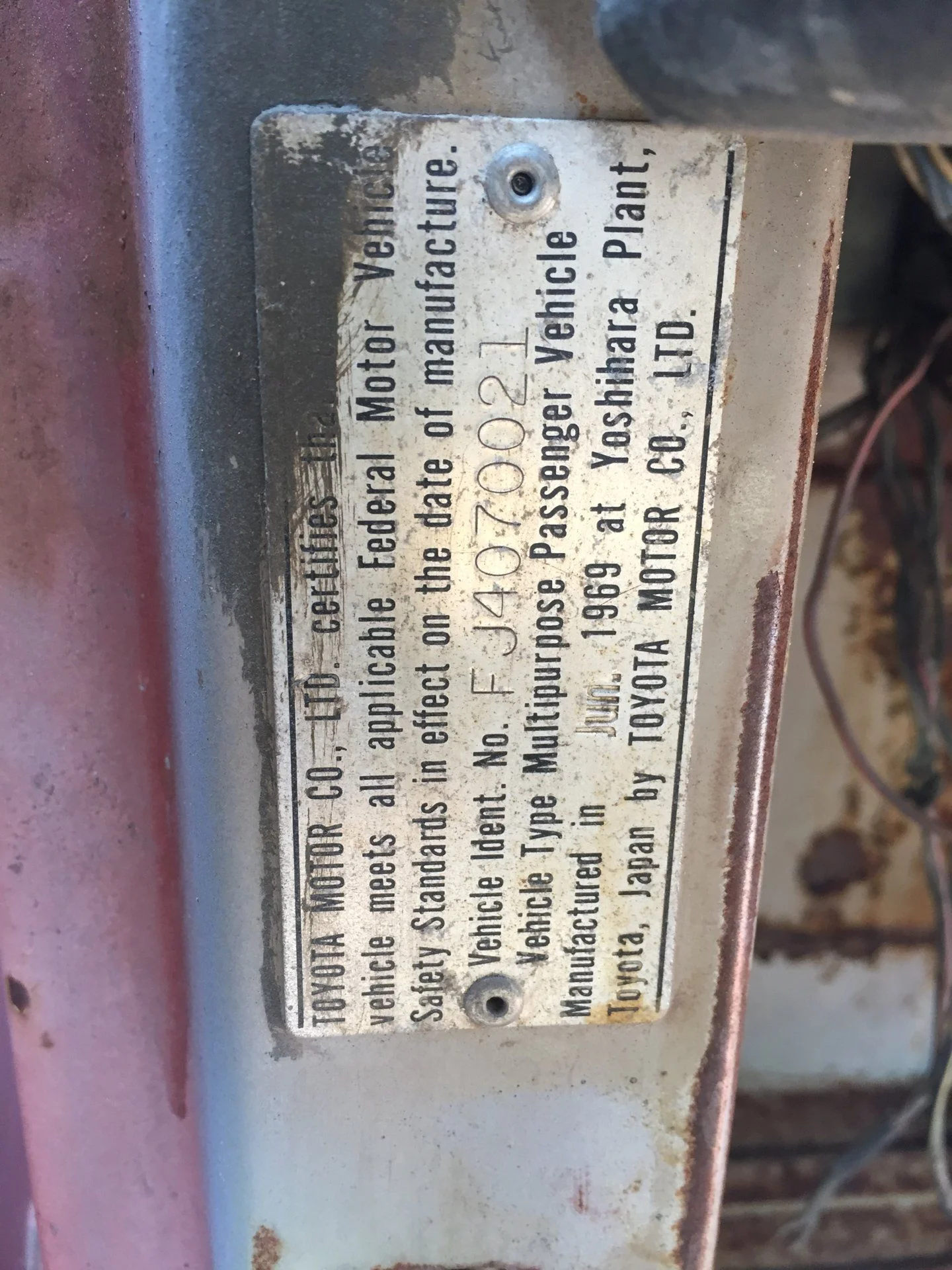

Its a very ugly but complete June of 1969 FJ40 and it was a Texas farm truck. I believe the odometer hasn't rolled, so its under 100,000 miles. It came with a few OEM parts from about 10 years ago, and not much else.
Someone primered it throughout but there is very little rust. About two dime sized holes around the back window and the frame could use some wire brushing and POR.

That's a pretty decent 40. You need to put a sealed coat of primer/paint on it to stop the rust. That red oxide primer is not sesled and is allowing rust to develop significantly under it. I would hate to see you loose a good 40 like that. Keep up the good work and enjoy a great old relic!
I've been contemplating doing a bad roll on paint job in a flat color to keep it sealed.
It need a weekend or two of POR15 work to get it sealed up. I want to rhino liner the inside but I know what a pain that is to get off.

That’s a beaut I wouldn’t rinho line it if I were you.
I'm not thrilled about that either. I need to figure out a better solution.

That is a easy simple restoration. Has very little cancer. I think the patina is killed by the spray on primer in different spots. I would replace the rear sill, clean off the surface rust, buy and cheap paint gun, and spray it. The I would do the same to the inside. A couple of weekends, 500 to 1000 bucks, and some labor, and that thing could look pretty good. Of course if you wanted show quality then it would take significantly more.

I'd leave the exterior paint just the way it is.
