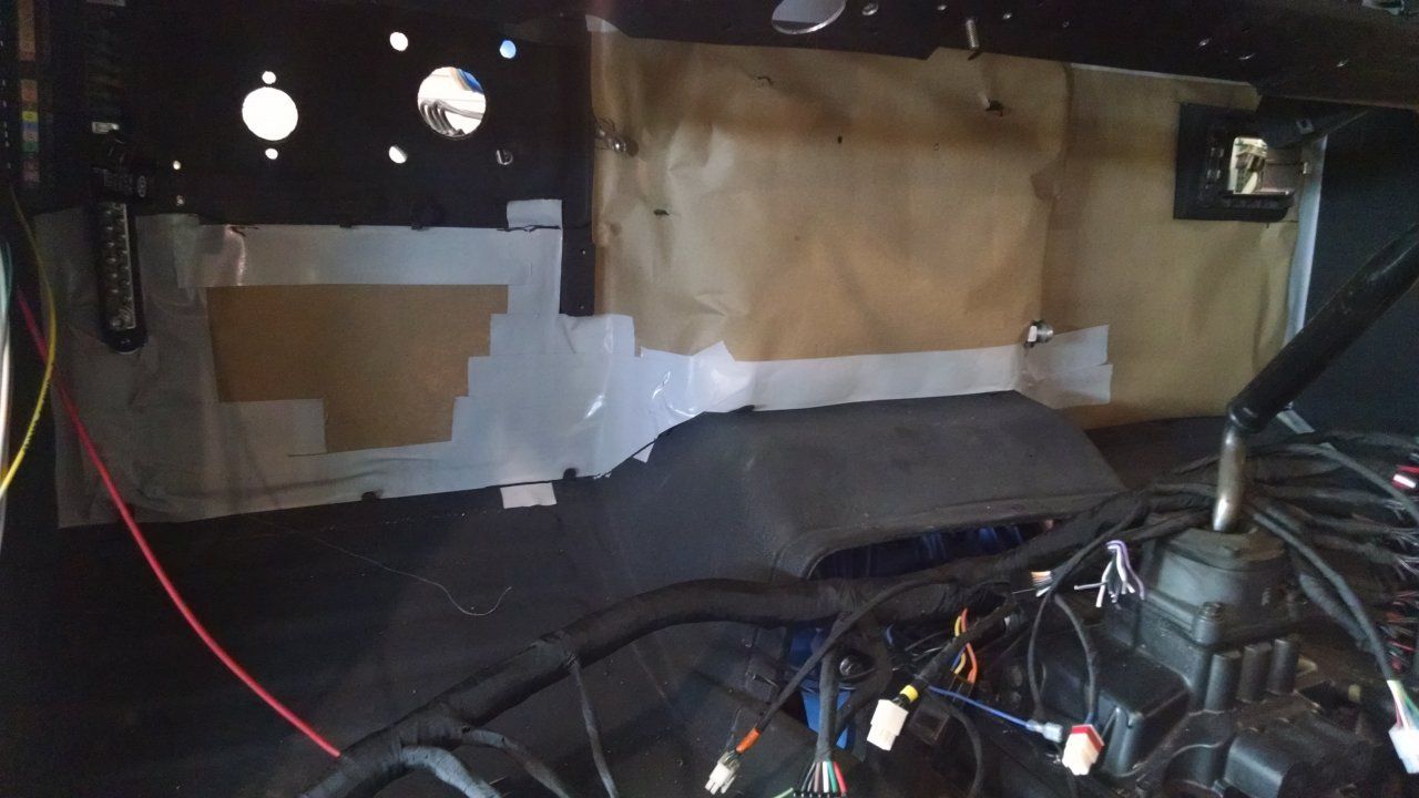

No picture of the finished firewall but this is the template I made to transfer the pattern.
