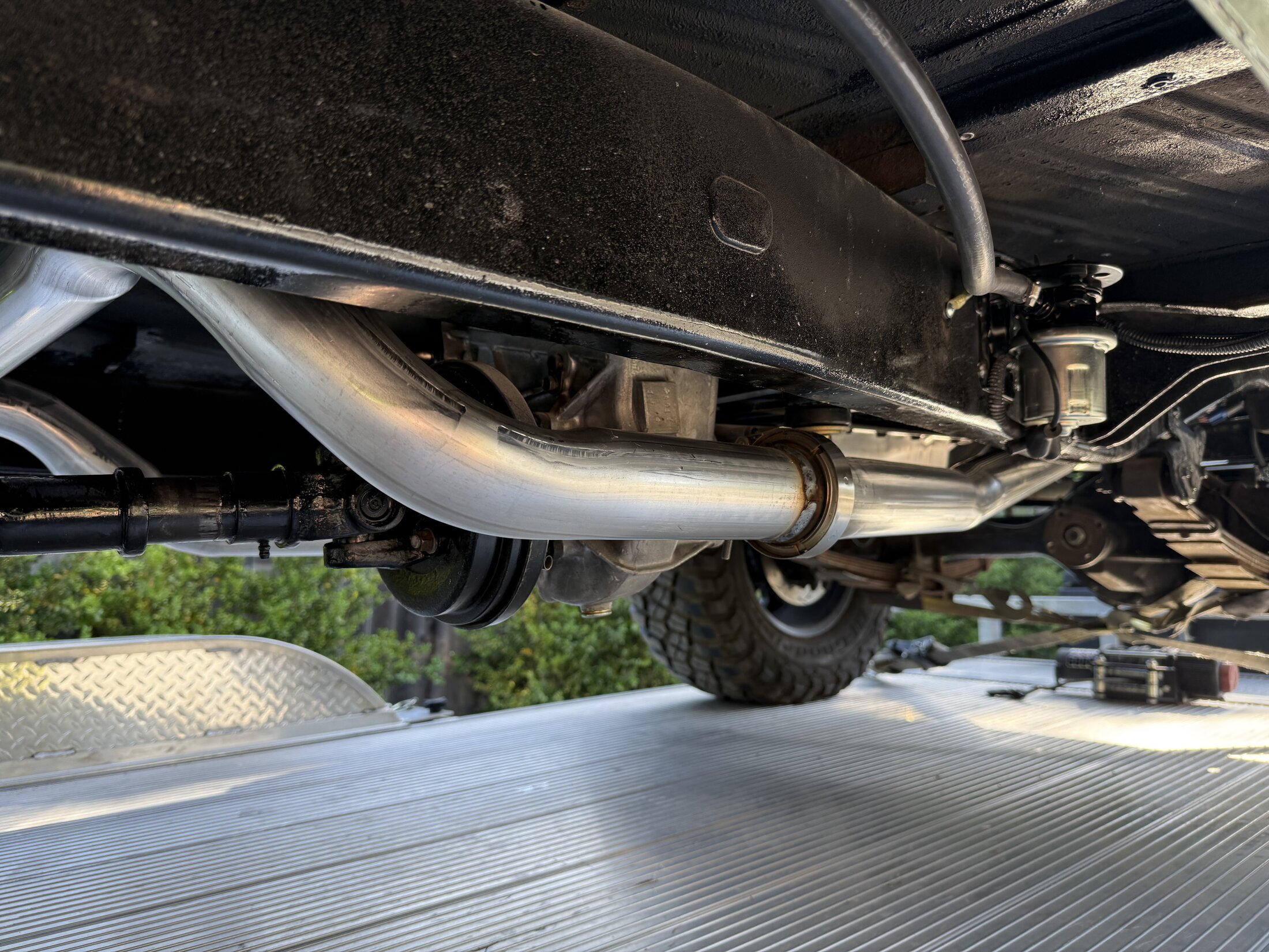

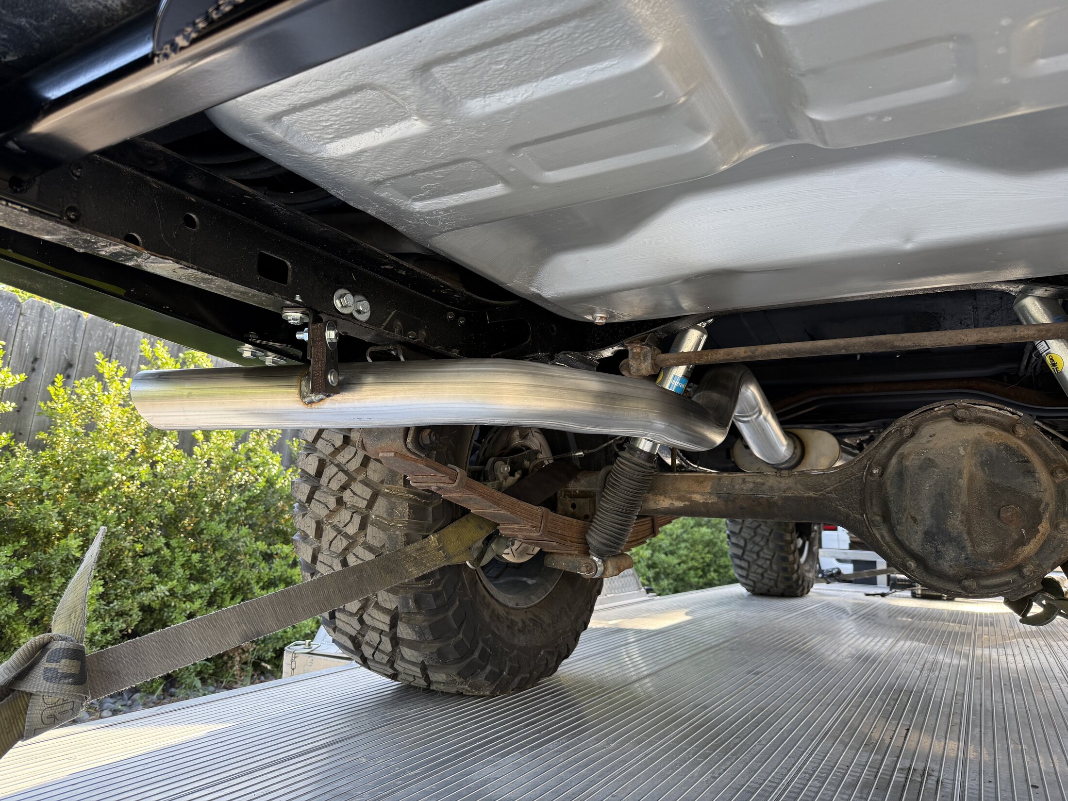

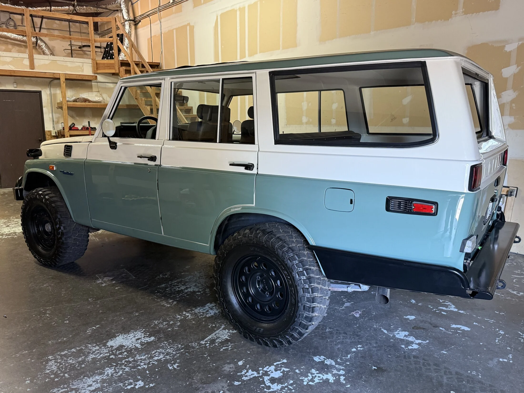

Ok guys. Put in your vote for exhaust. I think I'm doing dual exhaust. exit in front of rear wheels or behind or straight out the back or through the cab and out the ragtop? Stainless or black or Chrome for obvious performance increase.
Cut holes in your rockers (you really should have sliders) just ahead of the rear wheel arches. Poke the stainless exhaust tips out through them.

Two problems have emerged as I get more adventurous driving it around the block. 1. The steering is terrible. It wanders and has a ton of play. I assume I will need a new steering box, which I am assuming will not be readily available and will lead to another 2-3k conversion or something. 2. Tonight when I got back the radiator was smoking and overflowing and the hoses were swollen. I hope its something simple like a faulty cap and not something major! The radiator is new from Mosely Motors with a Spal Fan on it. Any tips or suggestions would be super appreciatated.

As far as the wandering, you might consider taking it to a front end shop. There’s almost always an issue with caster with lifts, but your front suspension looks mostly stock.(?) Verify everything downstream of the steering box is in good condition before throwing steering boxes at it.
No heater hoses, and I do have vortec heads, so that must be in. I’ll get that hooked up this week. All of the steering components are new, so I will take it to a shop. But just standing still there it a lot of play in the wheel.
I would send it off to Red-head Steering Gears for rebuilding. Will cost you around $500 IIRC but they do a great job and are very fast.
