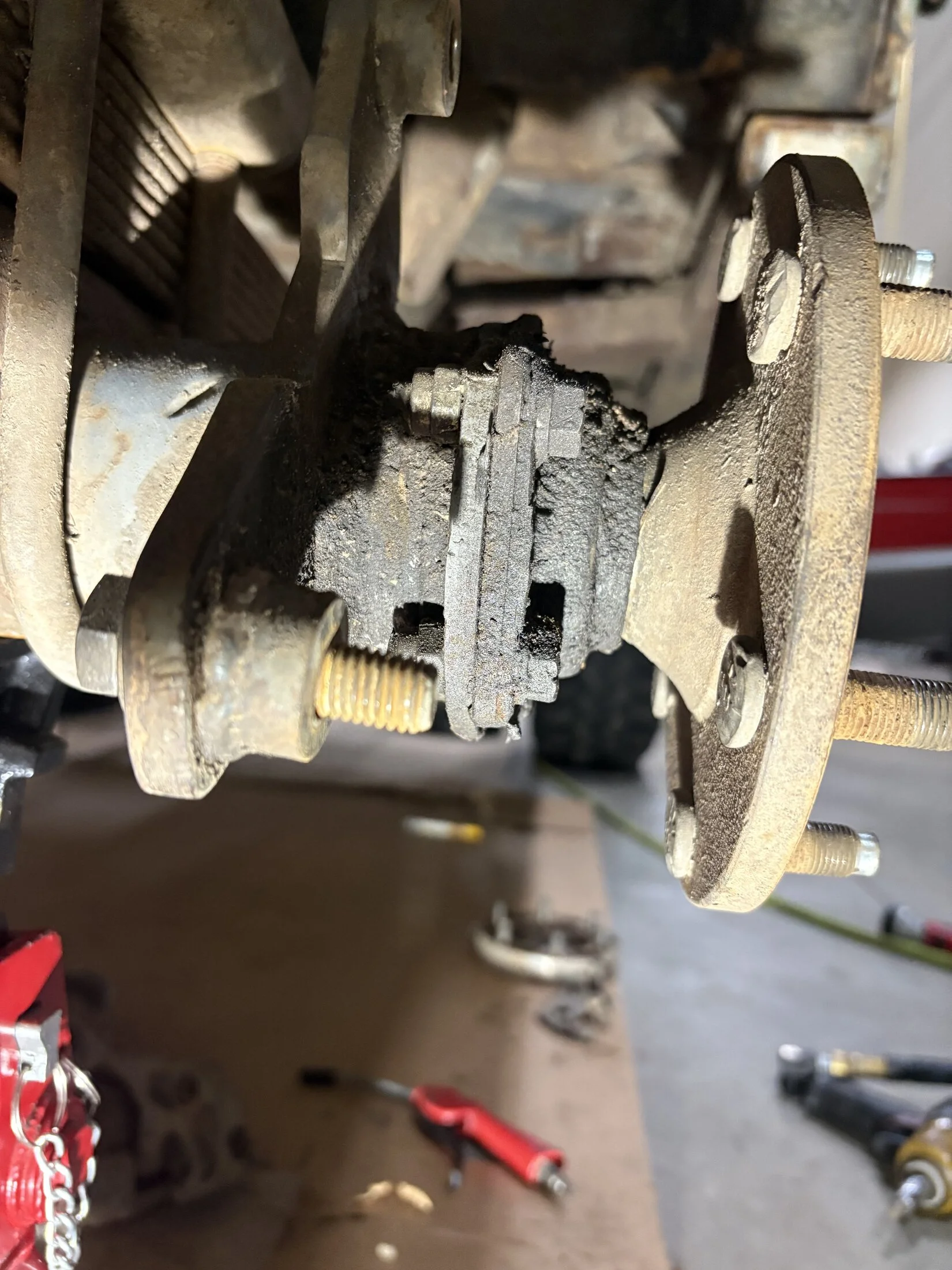

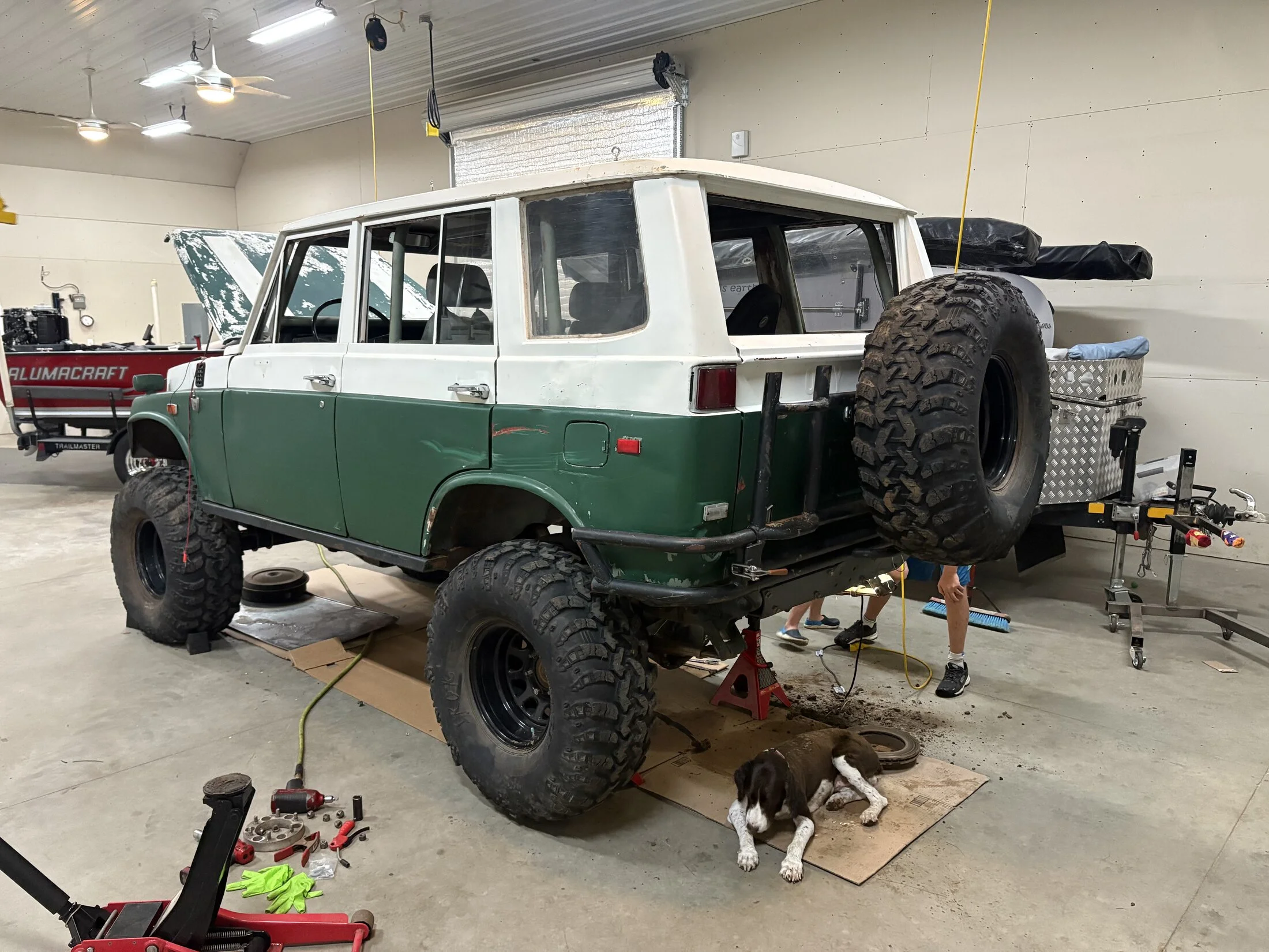

Made some progress tearing things down today and learning about D60 axles. Pulled the calipers and discovered the driver's side axle was sticking out a good inch compared to the other side. It also had about 1/4" of play in/out while the passenger side did not. Drained the nasty fluid, no chunks of gear found so that is good. Looks to be an ARB, also the part number on the ring gear comes up as a Motive Gear 5.38 gear set. Back to the axles, I pulled the driver side and found the bearing completely wasted. I need to pull the passenger side tomorrow. I will say those axles are no joke, massive, 30-spline. Still more to learn and figure out here; I am leaning toward keeping this setup as it just makes sense since it already has the gears and ARB air locker.
Before I got into the axle I mounted one of the wheels on the rear tire carrier, definitely looks better with a big tire back there.

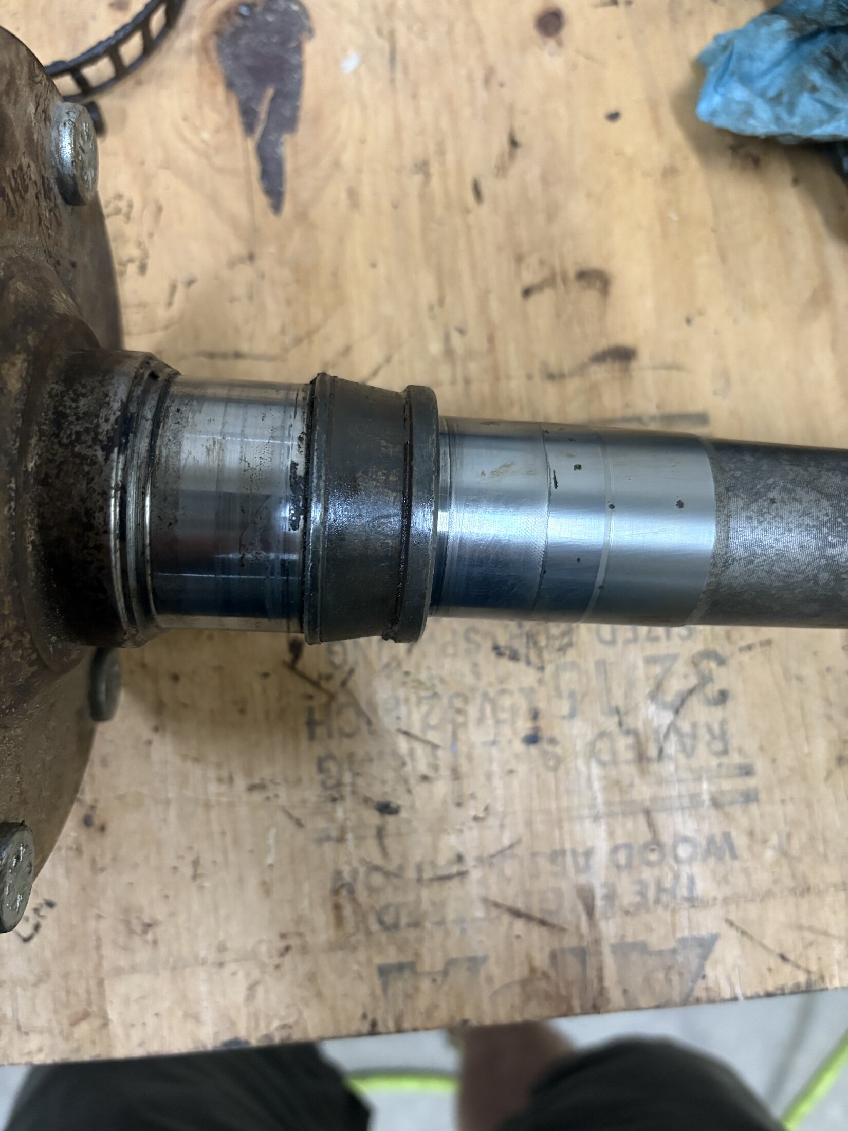

Seems to be how the semi float 60 is setup. No c-clips either. What is weird is that metal sleeve behind it, I have no clue how to remove that and replace the bearing.

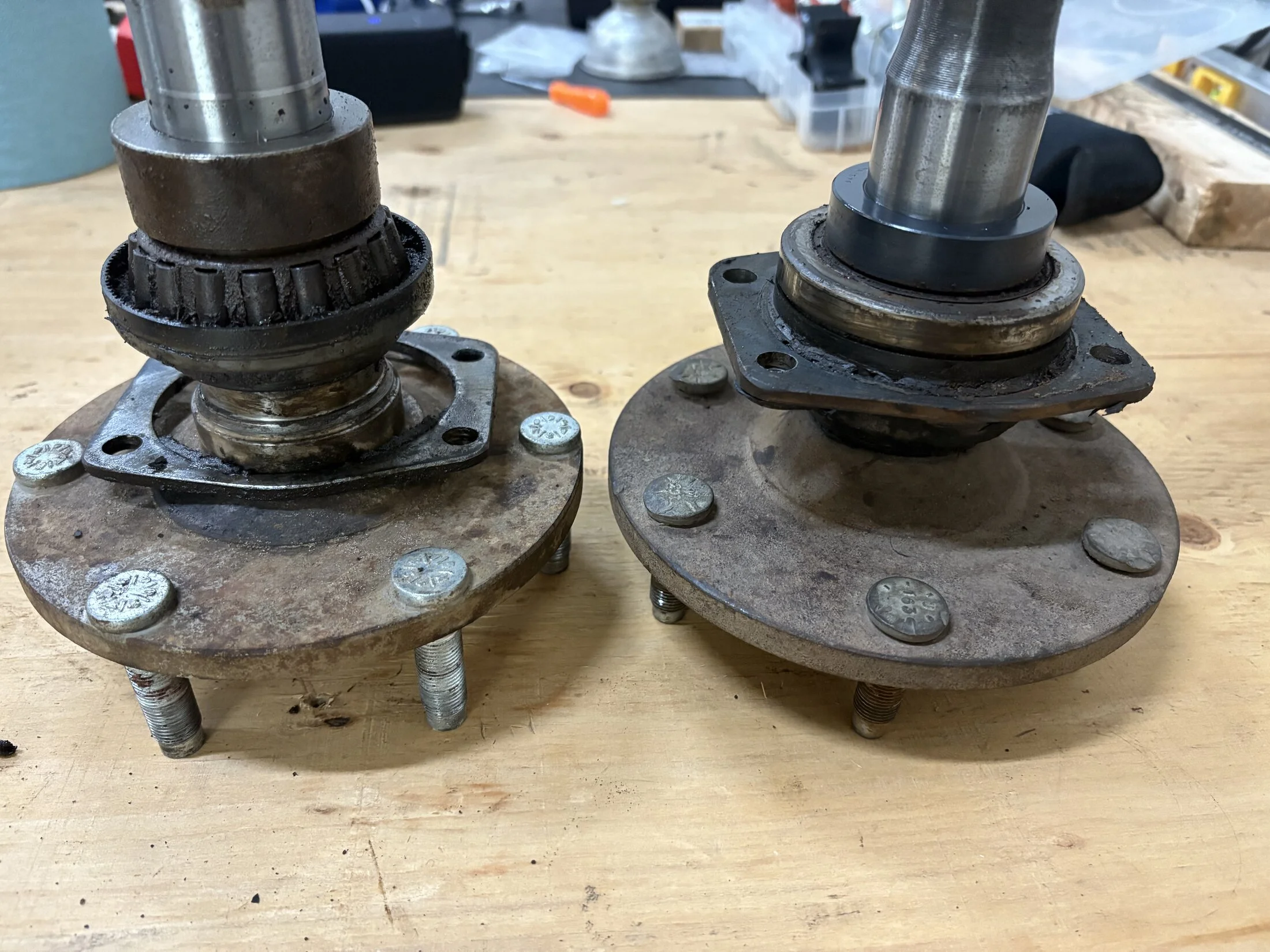

I guess they are Ford 9” style axle housings and that is the bearing assembly they use. I pulled the other side and found a different bearing setup, it looked to be a sealed bearing. I am going to send some emails off and see what I can come up with for proper replacements. I have to drill and break that retainer with a chisel, what a chore. I started drilling today and gave up, that is not soft steel.

A common way of removing those collars is grind/zip cut and then chisel, just have to cautious not to nick the axle 😱

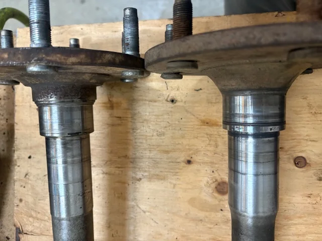

Great advice on the cut off wheel, got the first axle stripped with no fuss. It looks like the spacing between the two axles is very different, confused as to why. I measured the brake caliper mount to hub flange and they were the same left to right side. I need to get the other bearing cut off to see what that one is like. The axle pictured sticks out a good inch further than the other side.
I had my ten minutes of time in the shop today, got the Moser axle bearing cut off. It's totally different and what I believe to be is the wrong length. The bearing seat has a spacer pressed on to try and make the flange width correct (it's 2.4" with the spacer, should be 2.5"). This also messes up the brake caliper fitment. Guessing I am going to have to go with another Dutchman axle setup for the set20 bearing, I will contact them with my issues and see what they say, nothing is easy!
