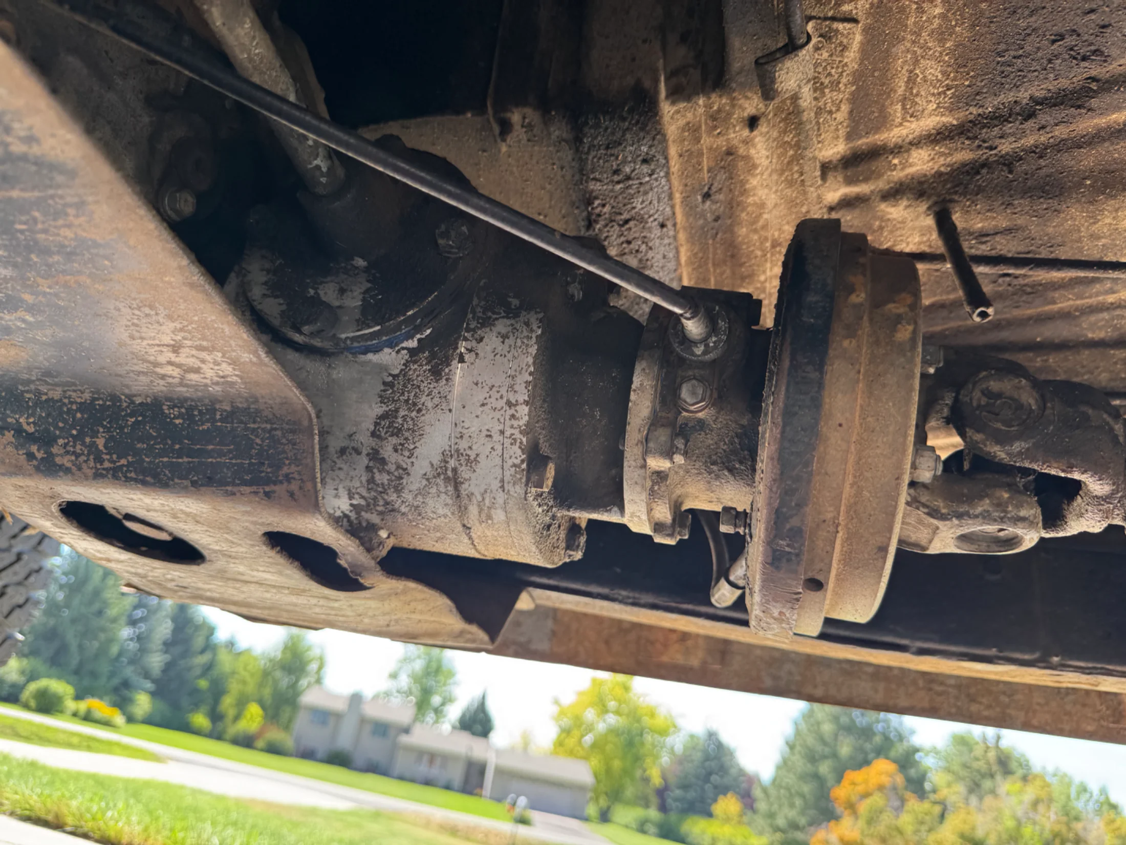

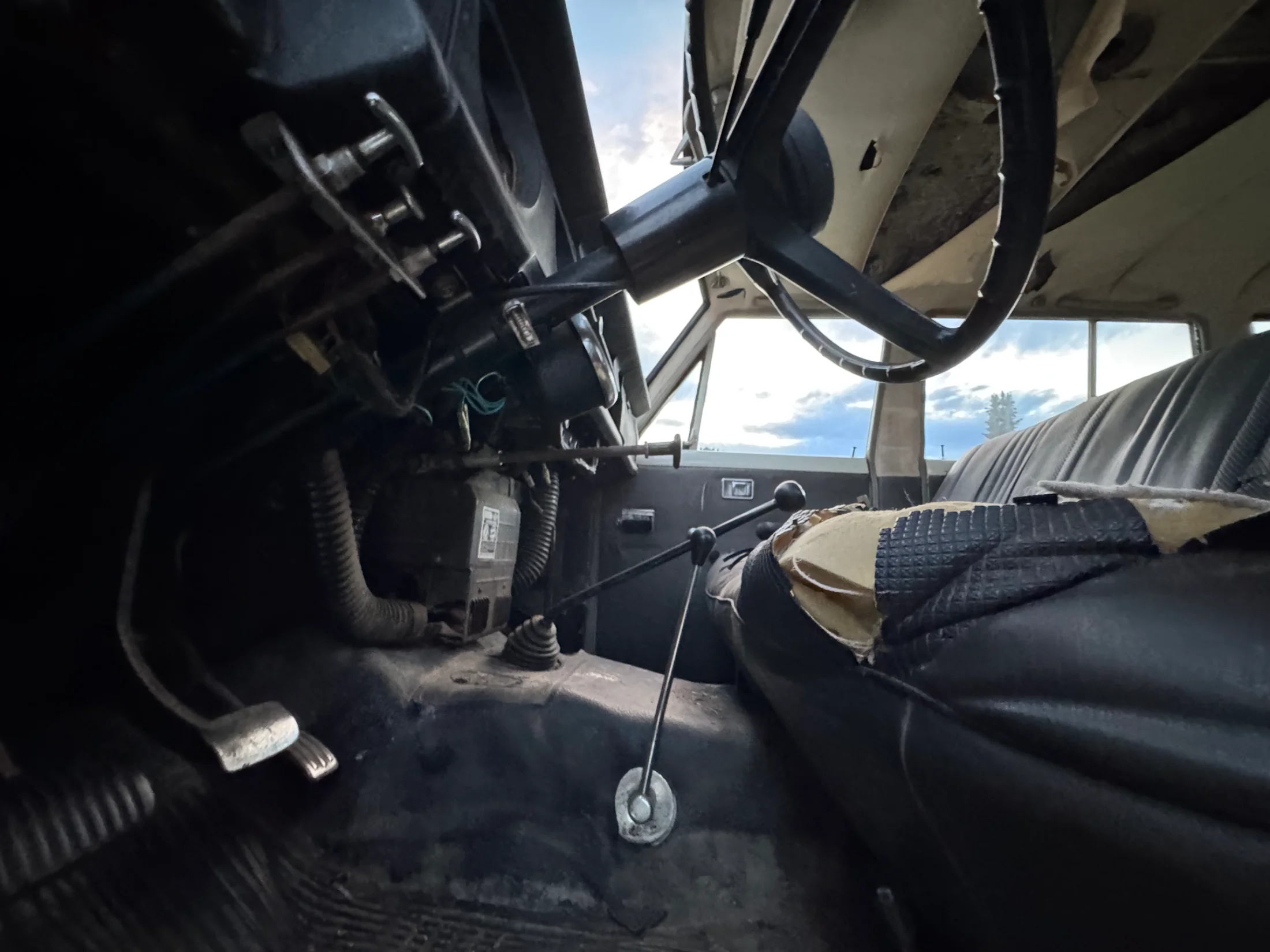

Looks like an overdrive hanging off the lever in the cab?

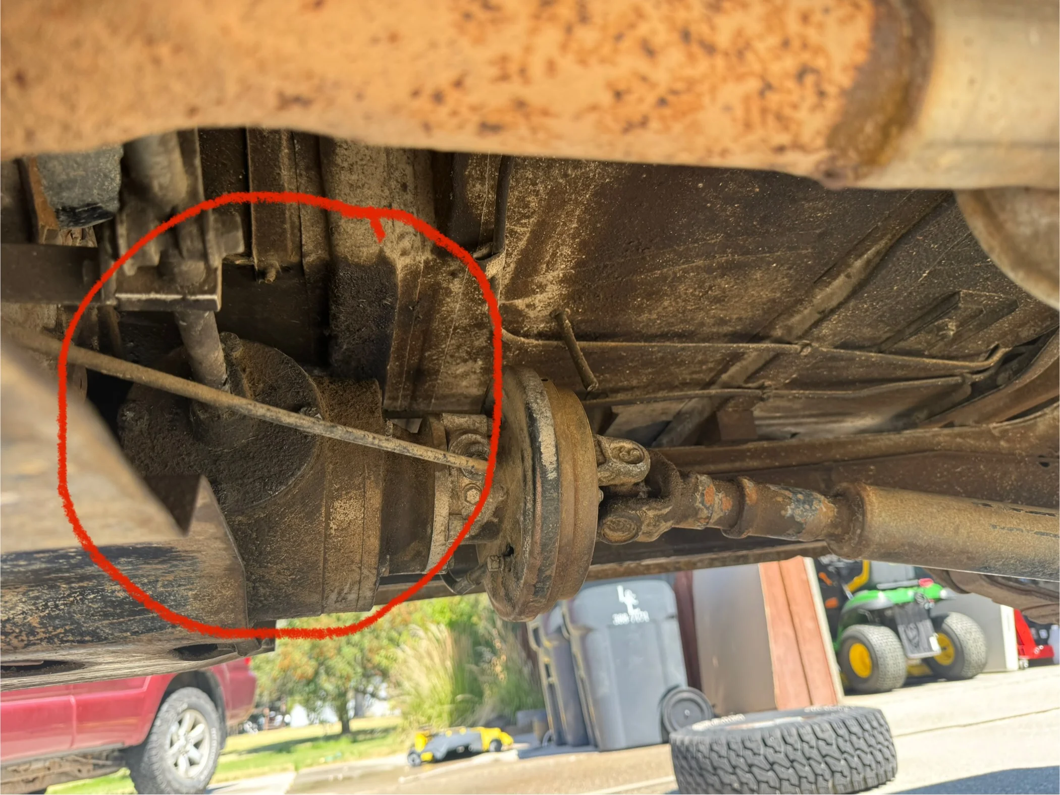

Can anyone ID what kind by looking at it?
Yeah that is the speedo cable. I am pretty sure it is an overdrive just wondering if anyone can identify it. It attaches to this lever on the transmission hump.
I tried shifting at speed in 3rd gear and it just takes in it out of gear. I need a second set of hands to operate it while I am under the rig. I'll clean it up and see if there are any markings. At first I assumed it was some aftermarket PTO. But a little research says, Warn, Husky, Fairey were all popular in the 70's.
Great info. I’ll need to dig deeper.
So it’s a Hone over drive. @Living in the Past for the win! Found some good info on the Hone Overdrives in the 40 section. It’s down the list to get working. Seems like a great thing to revive if possible. Could be easier than a 4 speed swap, but it is way down the list to get up and running.

Down side of the Hone OD it's only on the rear driveshaft and can only be used in 2WD. I do not know anything about the Home except what it looks like from the outside. While the Fairey changes the input to the transfer case and and be used in 4WD it has a bunch of needle bearings. Would think it would more prone to failure behind a V8 and lockers or tires with good grip. The split transfer Fairey replaced the back of the case and used ball bearings. Never a late split transfer case Fairey but H55F still has parts support and probably would be a better option.

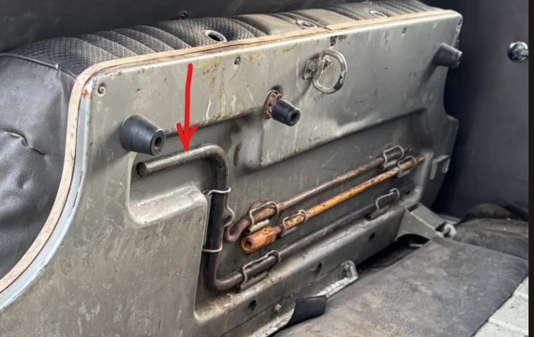

What type of jack holder was used in the FJ55 8/69-9/73? I have the style used in the early FJ45LP-B and one from a 69 FJ55. Those are stout.
I’ll snap a pic. Looks like an exhaust clamp that is hinged.
