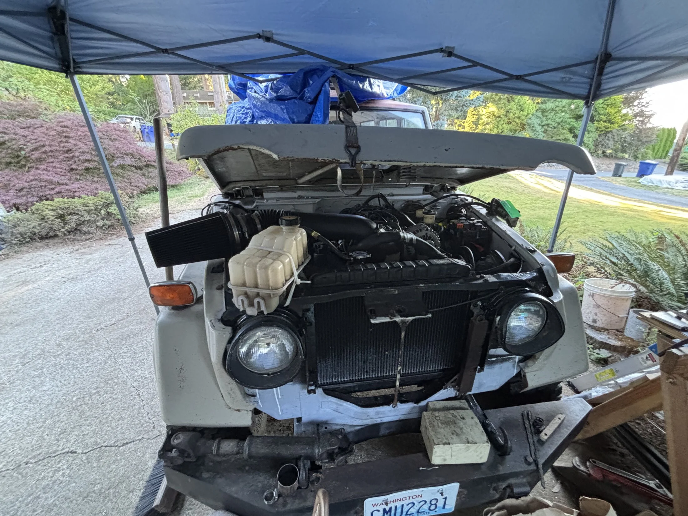

Big weekend! Finished fuel system, wrapped up some electrical connections, did some troubleshooting, and came up with some work-arounds (bi-passing the “in-park” sensor for start-up), and turned the key (of the Silverado ignition…sitting on my driver’s seat). Started on first attempt, though we had some vacuum issues-namely I hadn’t connected the vac line to the brake boost (pretty sure my dad will be dining out on that find for quite a while!). After addressing that, engine idled nicely, if a little loud (mufflers were not critical path). Still need to sort out coolant and air filter, but couldn’t wait any longer to fire her up!

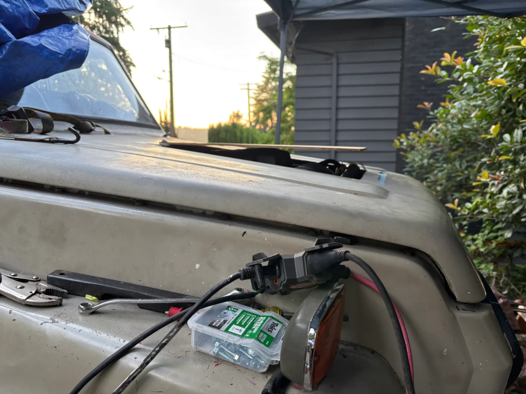

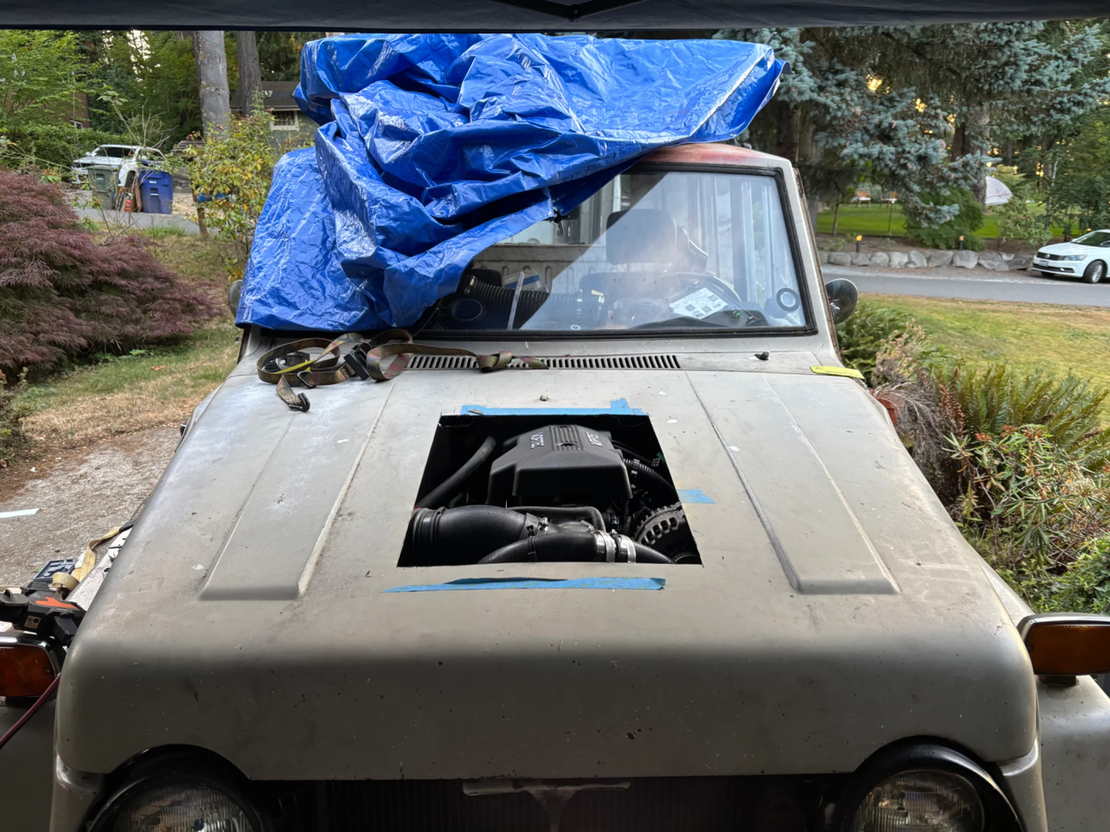

The eagle eyed amongst you may notice a skylight in my hood- the intake manifold on the V-8 sits a bit higher than the 2F. Adding a hood scoop wasn’t part of the plan, but I don’t hate the idea. Have not finalized the hole b/c intake air and radiator hose routing could impact the extent of the required hole.

Going to try to address specific build items now that the stress of getting it running again is past. Today, I’m going to focus on the engine layout. With the hole cut in the hood, I’m guessing there are some raised eyebrows amongst the society members.
So. The details: Motor: this is a 1999 LM7 (8th digit “T” in the VIN) GM 5.3L V8. While it’s called an LS, there are lots of variants. This motor was typical in the base Silverados, Yukons, etc. the LS motors in Corvettes, etc. is shorter but wider- this is taller and narrower, from what I understand.

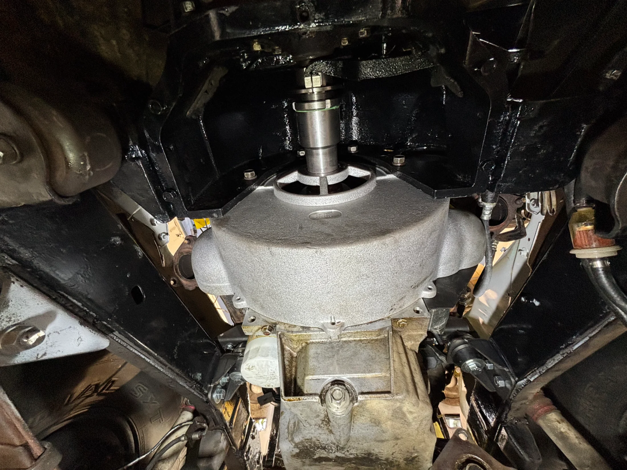

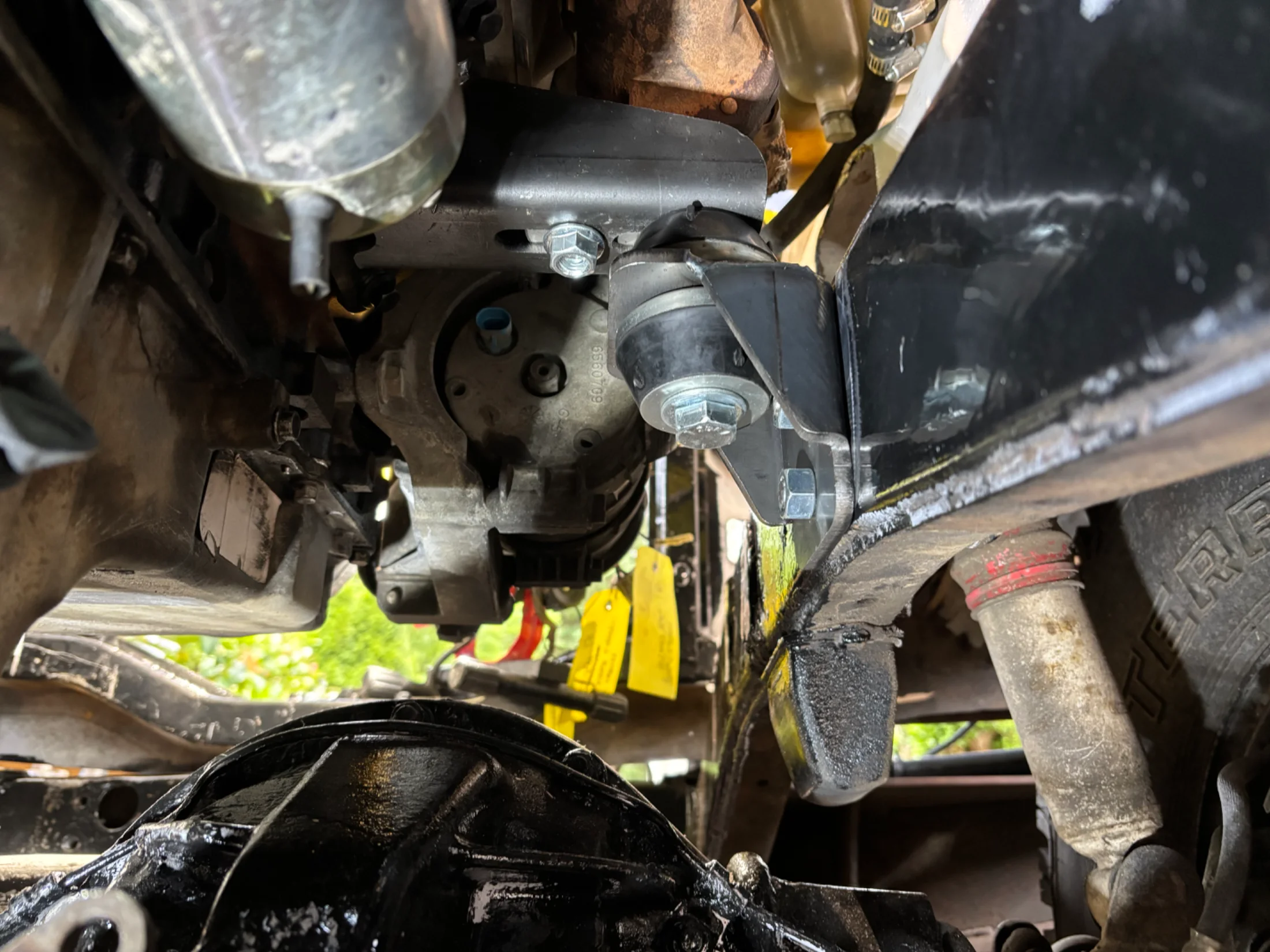

Adapter: Mark’s 4wd LC bell housing to LS adapter, purchased in conversion kit from Advance Adapters, along with clutch plate, pressure plate cover, and engine mounts. The Mark’s 4wd adapter includes the outer housing, a sleeve for the throw out bearing/clutch fork pressure bearing, and a splined adapter to go from the 10 spline H41/H42 tranny input shaft to the GM spline on the GM clutch plate. This adapter is a bit shy of 5 inches deep and mounts between the bell housing and the engine block. The extra depth pushes the engine forward in the bay to move the engine out of the narrow indent in the firewall, meant to accommodate the narrower inline 6 F series motors. By using this, the rest of the drivetrain can stay where it is, and driveshafts don’t need to be re-sized.
Engine brackets: these are a 2-part universal mount from Advance Adapters. They allow for about 3” of play side to side depending on which hole you run the bolt through. Vertically, there isn’t any adjustment, but they come with (2) bolt holes for placement.

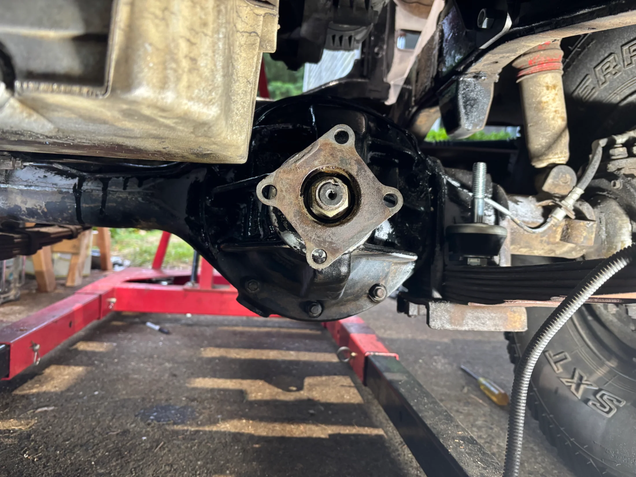

When we got the motor positioned in the bay, we noticed a couple things:

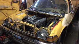

1. Motor is not centered- it is shifted to the driver’s side. Not sure why that was the case with the 2F, but with the 8” deep oil pan on the LM7, we needed that layout to avoid conflict between the pan sump and the front drive shaft mounting flange off the back of the differential (4th photo with motor centered- not good!).(5th photo with motor shoved as far to the left as possible- better but still close!)
2. Motor mounts needed to be mounted as close to the bottom of the frame as possible. The bottom of the bottom bolt is pretty much touching the inside face of the bottom of the tube. Even so, when we bolted up the bell housing, we had to put spacers between the bell housing mounting brackets and the bearing bushings. Good thing the kit came with solid spacers that were about 1” tall, exactly how much we had to raise the tranny up to meet the engine, like they knew this was going to be the case!

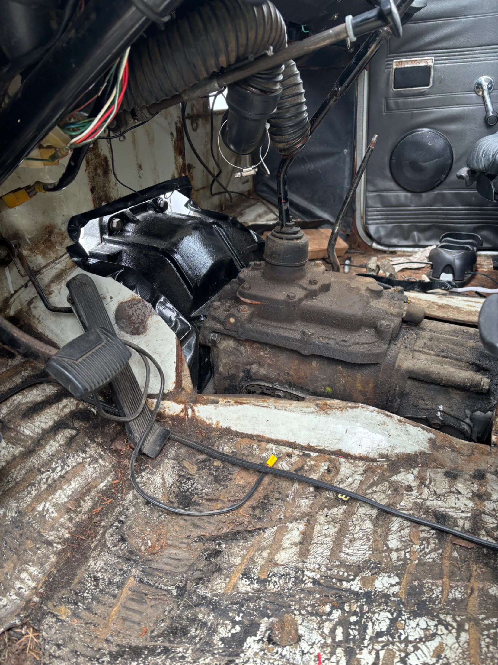

In order to raise the bell housing up, I had to cut out a portion of the fire wall. Right now the bolting flange of the tunnel cover touches the pan floor, but the top of the tunnel cover is sitting right on the tranny housing. And I have to re-fab the initial part that was not removable. I’ll also be fabricating a riser to lift the tunnel up a bit for clearance.

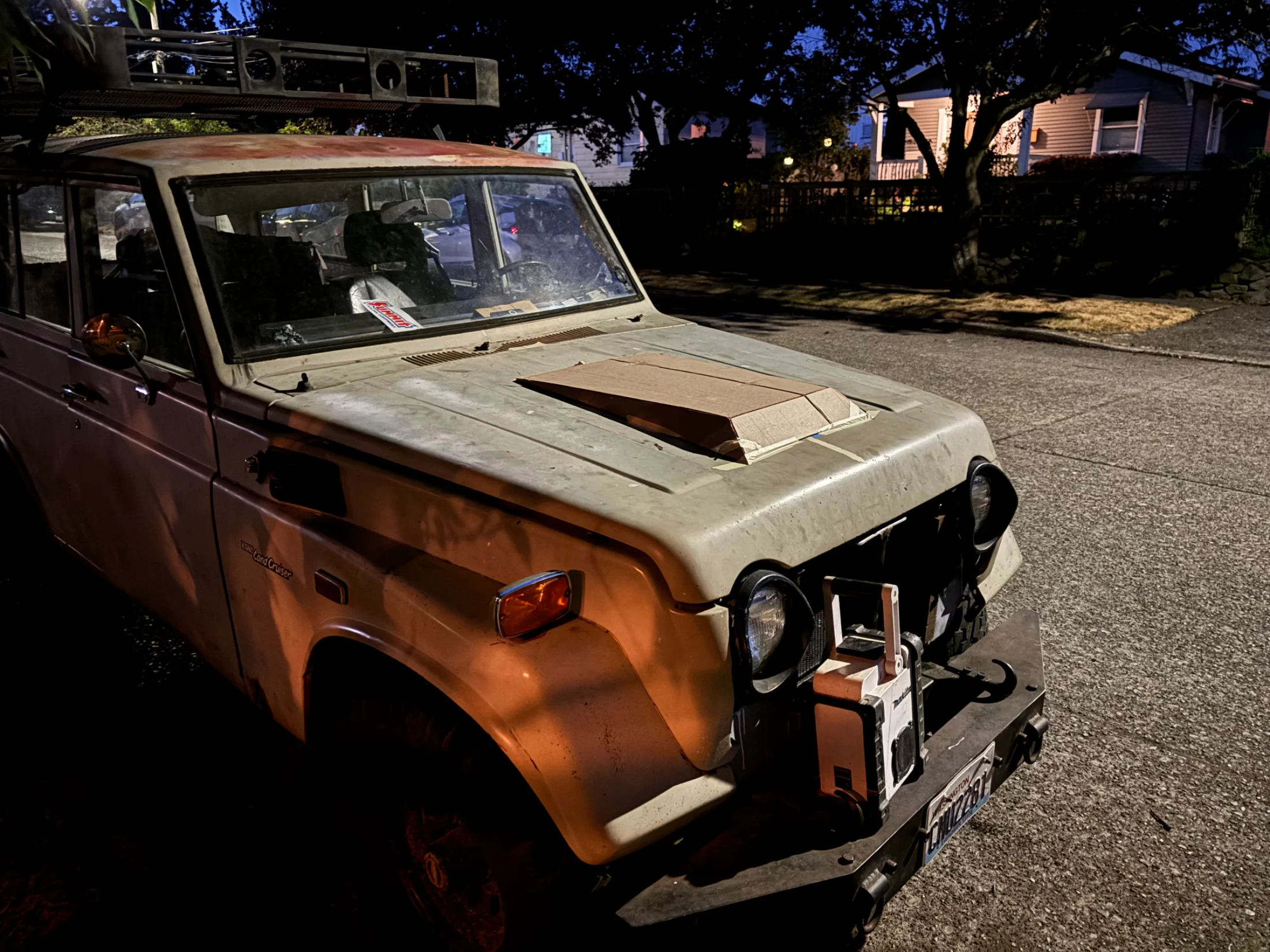

What’s that little device on your front bumper?
My 2 cents- dont rush the hood scoop! You have a nice one now that could work, but grab a beer or three and start playing with the cardboard. Something might come out of that playtime that makes you even more happy.
Great project to stretch your sheet metal imagination!
Makita radio-18v battery pack (same as all my cordless tools) sits inside it- plays forever on one charge. I'm currently running the pig with a Home Depot contractor garbage bag (2 layers of 6mil plastic) taped over the hole with Tyvek building wrap tape. That is holding up well to driving and keeps the Seattle weather out of the engine bay, so I'm in no rush, but also not taking it on the freeway, just in case the bag decides to let loose! I tried the scoop full length, straight back to the beginning of the hood, which makes the angle less steep, but is bigger overall, and I didn't like it as much. The base of this one is pretty much parallel to the two existing raised runners on the sides of the hood, which makes it slightly wider at the back at the base, and much narrower on the front top of the scoop-I like that rather than a tapering gap between the raised portions. Not sure if an open or closed front will look better-it is holding temp right at 190 without any ram-air, so I don't think I need the opening, but I also don't have the grill on yet....Or the potential A/C condenser in front of the radiator (more on that juicy bit later!) Just picked up a used sheet metal break, and have some old ductwork and metal shelving that can act as practice before I fabricate the actual scoop.
That's the most important part. You're happy with it and hopefully having some fun along the way. You're right, the scoop doesn't look bad at all.

I’m still putting things back together, and finding other things to take apart. First with the sheet metal: tunnel modification is 90%. I have one section to fill in, but for the most part, it is complete (enough). Cut the bolt flange off so I wouldn’t lose that alignment, then infilled the gap between the flange and the rest of the tunnel. It is rough, but it will also be covered up with the floor covering.

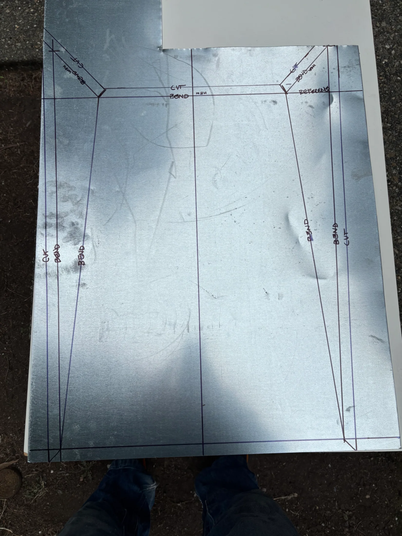

Hood scoop progressed from cardboard to thing gauge sheet metal. It is tack welded at the corners and I think it looks pretty good. I did realize there is a slight curve to the hood both front to back and side to side, so I will have to modify the flange when it comes to the final product.
Forgot to attach photos. Can’t find photos of the tunnel right now.
I want to ease the edges of the scoop a bit. Side by side with the factory details, the hood scoop angles are a bit too crisp. Time to experiment with my harbor freight metal brake.
2nd and 3rd pics are pre-welding. I installed the scoop from below and the flange gives me a decent weld point to attach to the hood. I’m making this up as I go along, so if there is a better way (with basic tools) let me know.

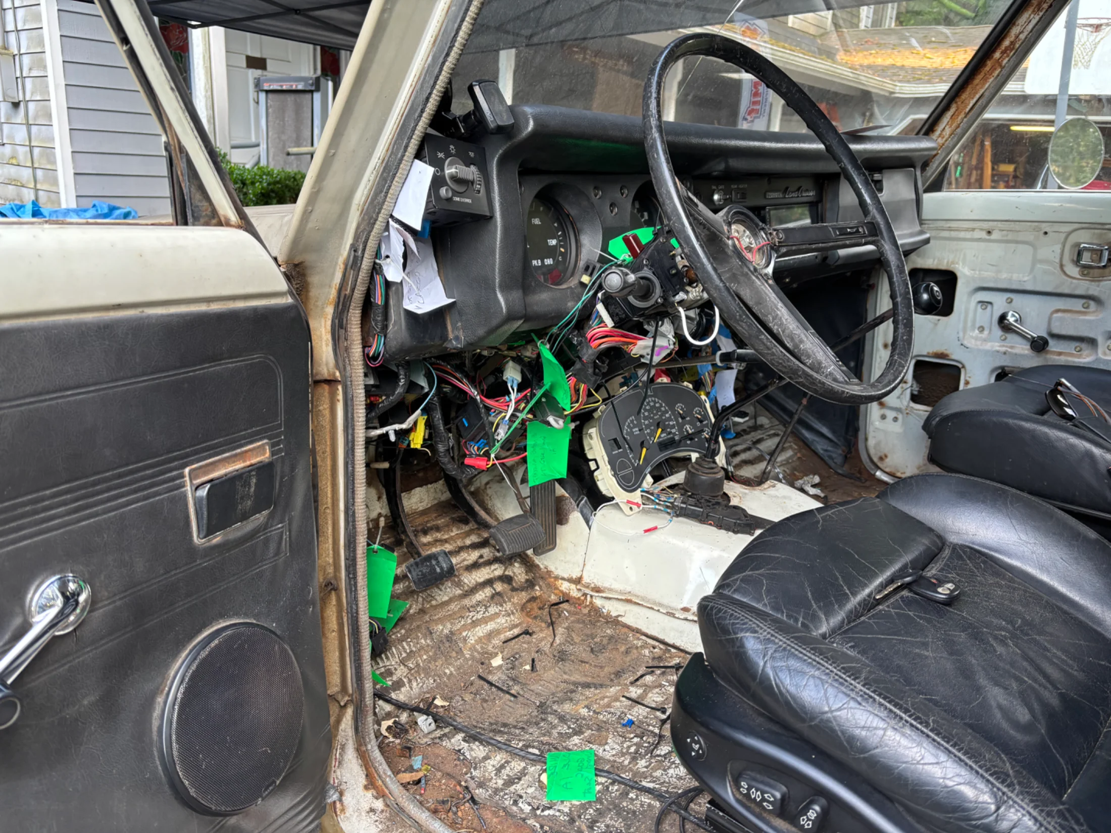

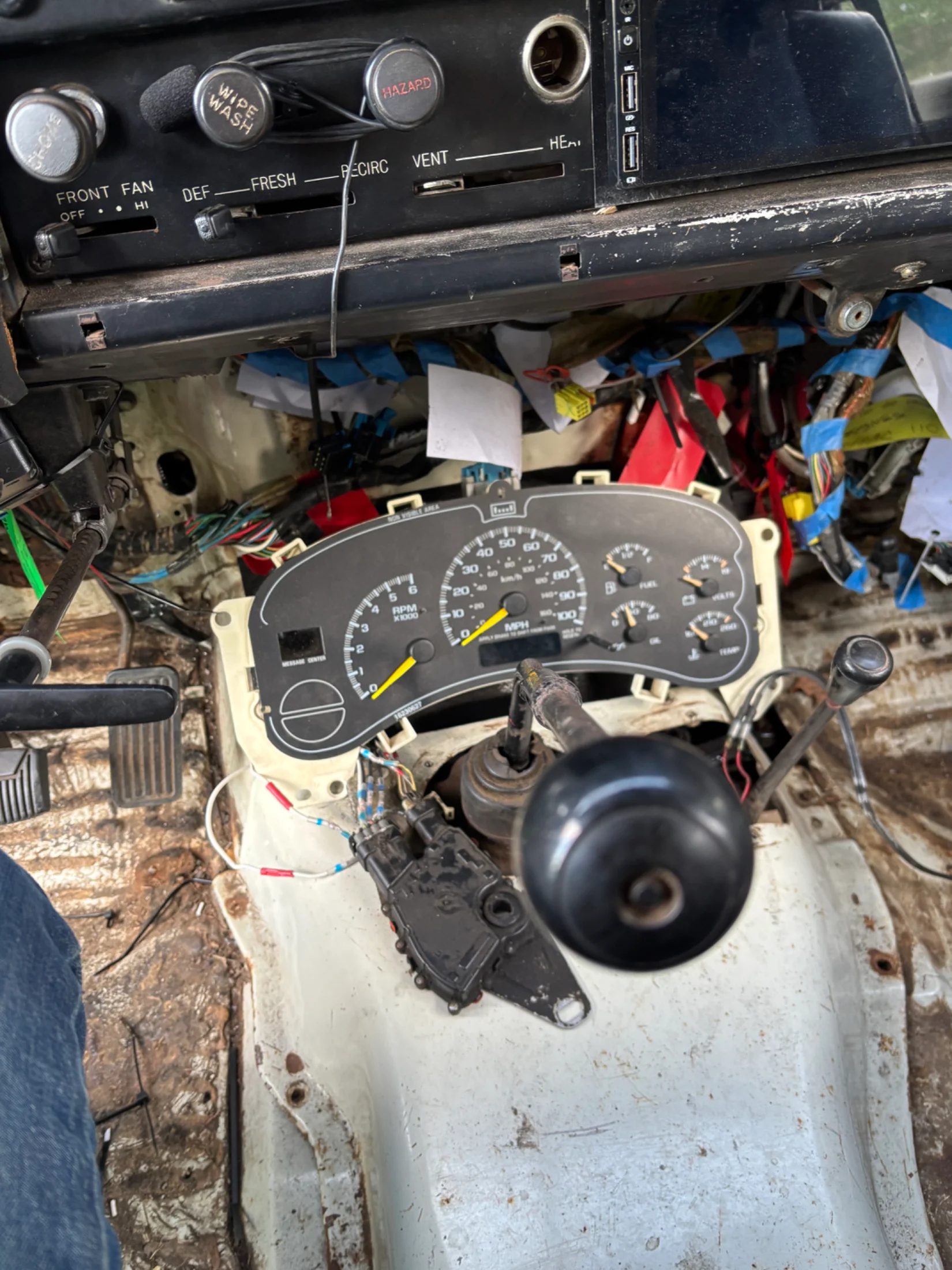

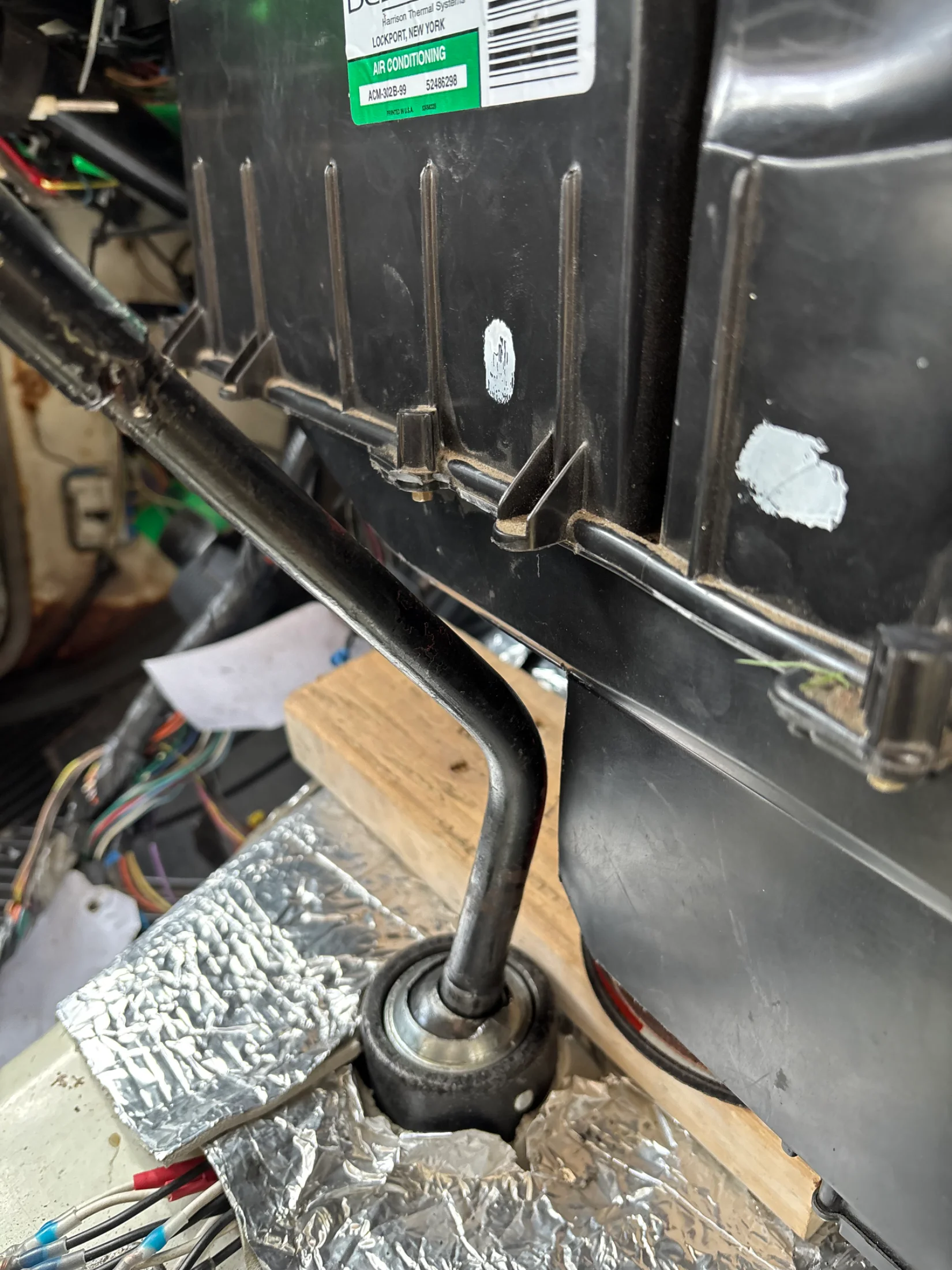

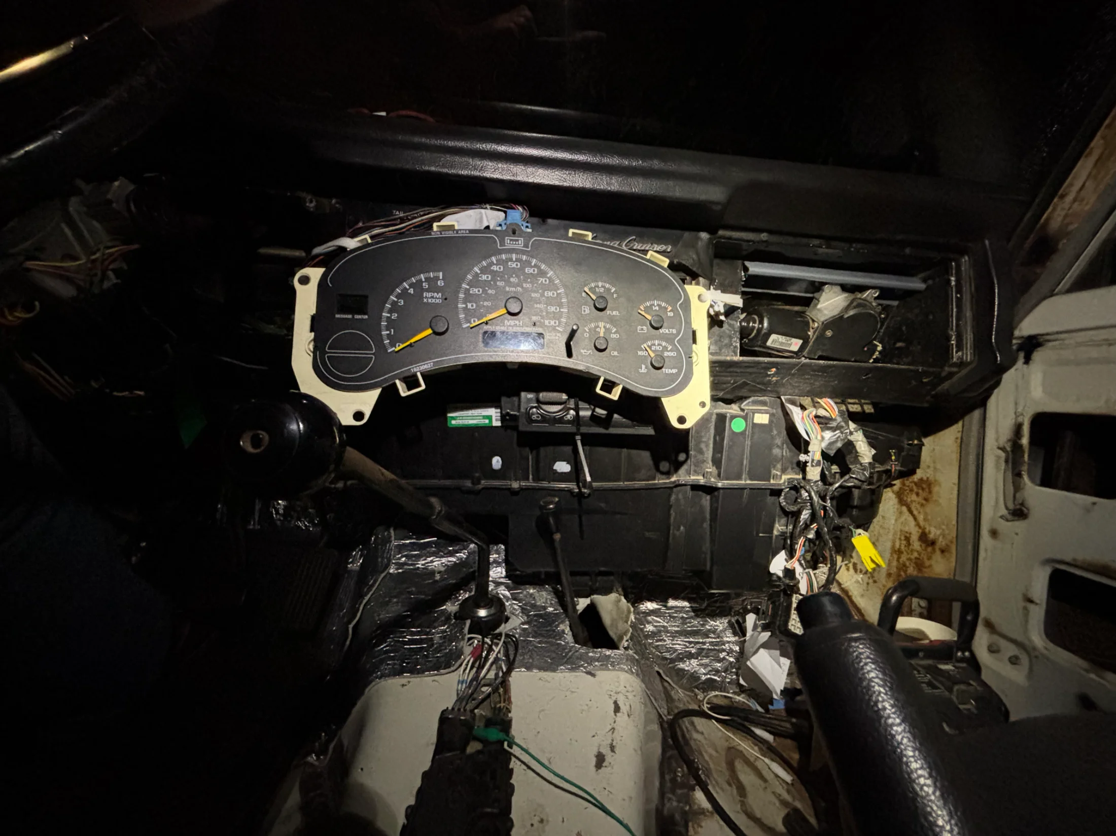

Still sorting out the details, but I’ve done it: shoehorned the HVAC module from the Silverado into my 55. Had to modify the housing a bit to snug it up against the firewall and make room for the stick, and the passenger foot space isn’t what I would call “spacious,” or “open,” but it is enough, and the shifters have clearance. Have to finalize the relocated wiper motor mounting bracket (it now sits in the back of the glove box to make room for the indoor/outdoor air damper) and sort out distribution ductwork, but that seems minor compared to the effort to squeeze this in. I’m going to have AC!
You can also see my current gauge setup in one photo. Everything from the Silverado dash works except the speedometer (GPS app on phone keeps me from really pushing the V8…sometimes). Going to eventually replace with the Speedhut 4.5” triples and mount on the original dash layout, but this keeps me informed in the meantime.
Wow, that's a big HVAC, I bet she's going to blow plenty of cold air. I'm concerned about relocating the wiper motor, did you extend or modify the wiper arm?
Holy guacamole Batman - that’s some shoehorning in a small space! What’s the plan for vents? Going to try and cover somehow? Maybe a quilted mat like was on the firewall …
I think the driver and passengers might need a quilted mat when that puppy cranks up!
If you need more room, an easy way is to relocate the shifter. FJ60 top plate and shifter bolt right on to the OEM 4-spd and move the shifter back about 3 1/2 inches. It does mean modifying the doghouse.
All I did was flip the motor over and mount it to on the cabin side of the linkage rather than the firewall side. The linkage geometry is unchanged. I actually swapped in the Silverado wiper motor so I can have intermittent function as well. Also the original motor was weak AF! Not sure if it was just old and tired or if they never had much power, but the wipers seemed to struggle to get across the windshield before.
