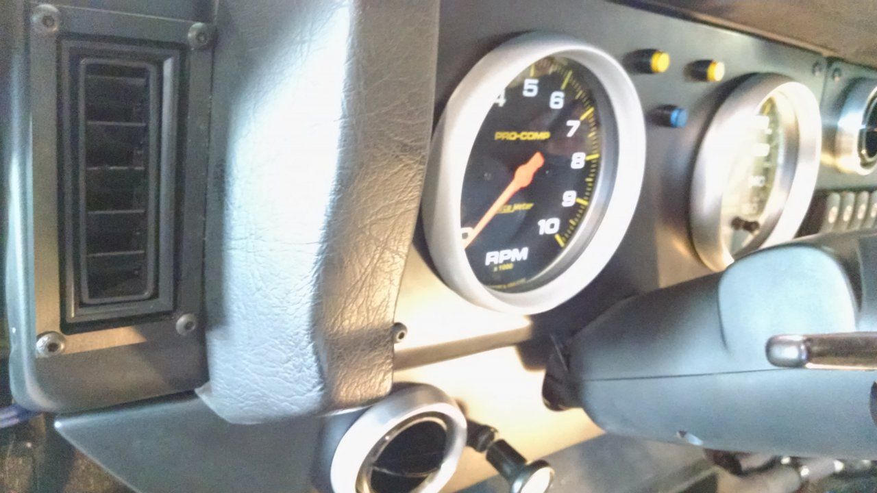

I got a little done on the dash tonight, I’m hoping to make some progress tomorrow.
Wow! I was just starting to get caught back up on your thread when I saw this and had to post. Most impressive. I'm a bit embarrassed by my plans now. Great looking dash!
Finished painting the dash, I still need to work on the glove box door alignment but I’ll deal with that when I install it for the final time.

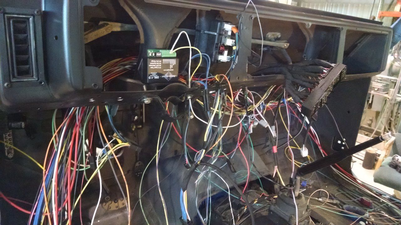

I ordered harness tape ten days ago and it’s still held up at UPS in a storm so wiring is on hold till next week.

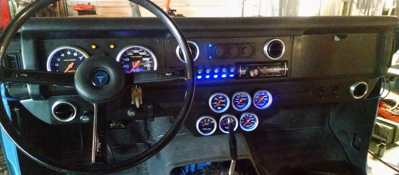

Dash is wired, plumbed and installed for the last time, everything appears to be working properly so I am moving on to finishing up the rack and plumbing the rest of the systems.
