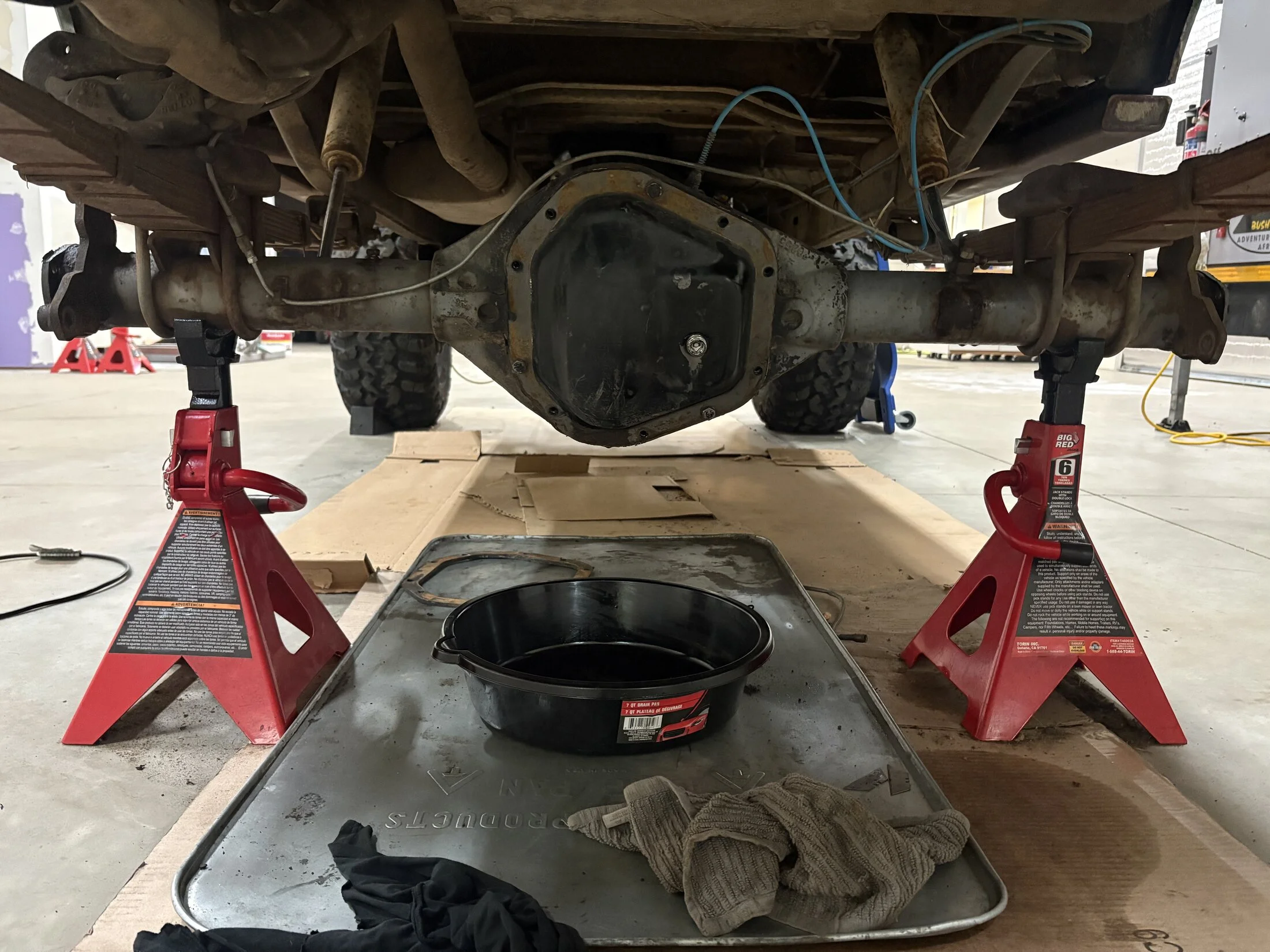

Cracking the code on this rear axle has been a chore, but I think I have it all figured out. I have an email into Moser to see what they say about that axle spacer and if I can get it changed to accept a Set 20 bearing and increase the offset. They are a couple hours away so if I have to I can take the axle there. The tapered bearing was destroyed because it was running dry, the fill plug on the differential cover is lower than the axle tubes! Looks like any of the D60 fancy aftermarket covers have a higher fill plug so that is an easy fix with money.

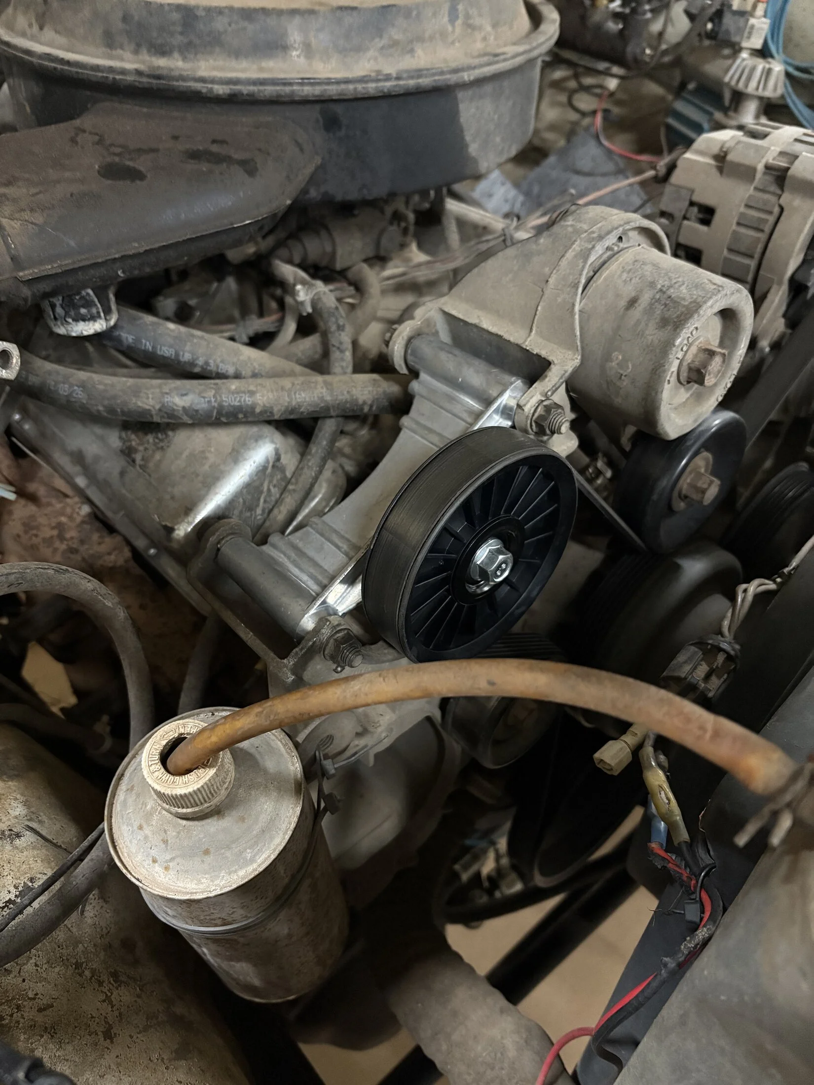

In the twenty minutes I had to spare today I removed the non-functional a/c compressor and added this slick Dorman delete pulley. It's now the nicest piece in the engine bay. I need to source a better overflow tank too.

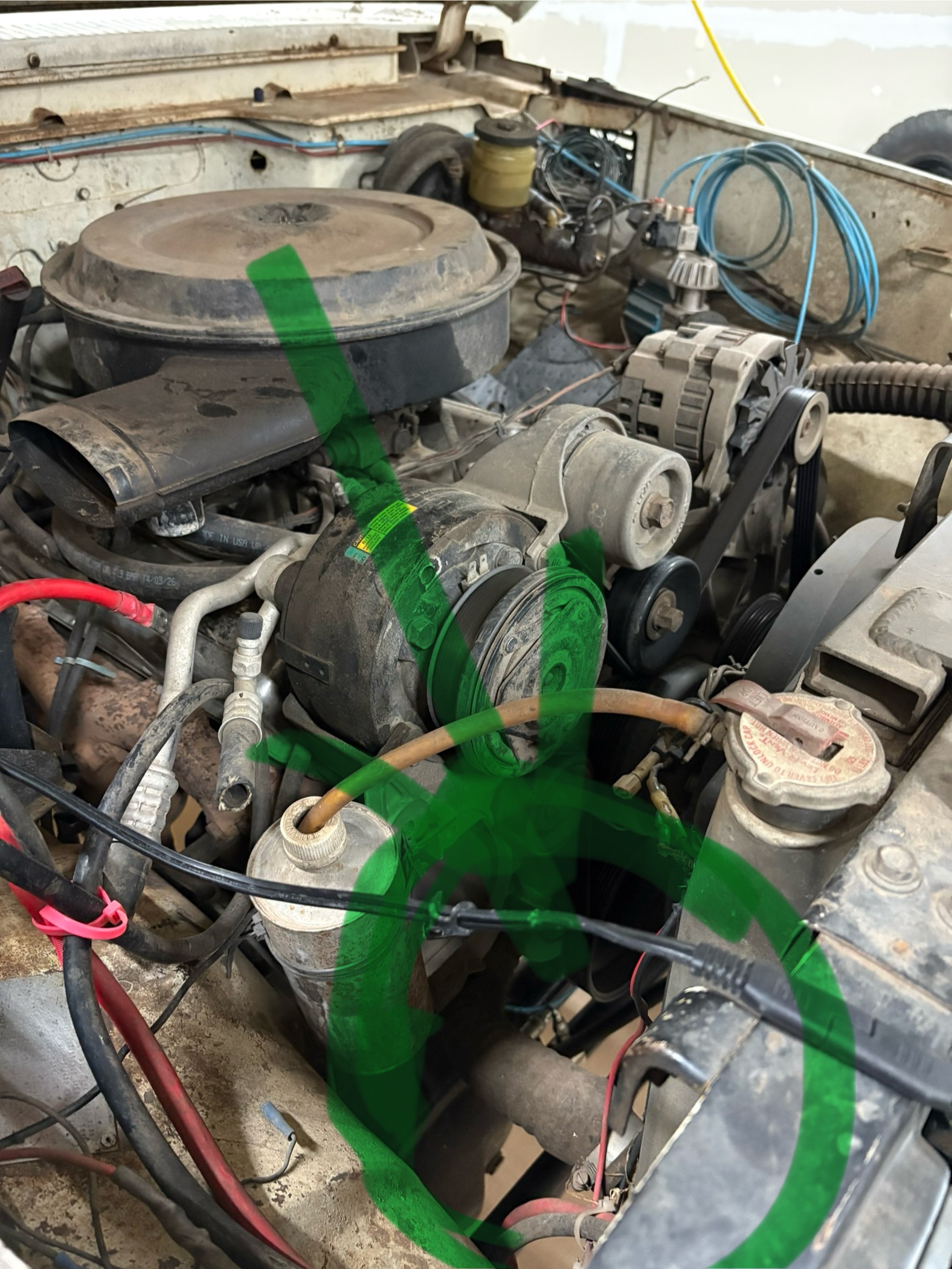

Can someone tell me what this bracket is for?
The early trucks had 1 horn there and 1 next to it on the inner fender on a similar bracket from what I've seen. The early trucks didn't have an overflow bottle either as far as I know
Great, I was going to mount an overflow tank there and wanted to make sure it wasn’t it wasn’t important before I cut it off.
