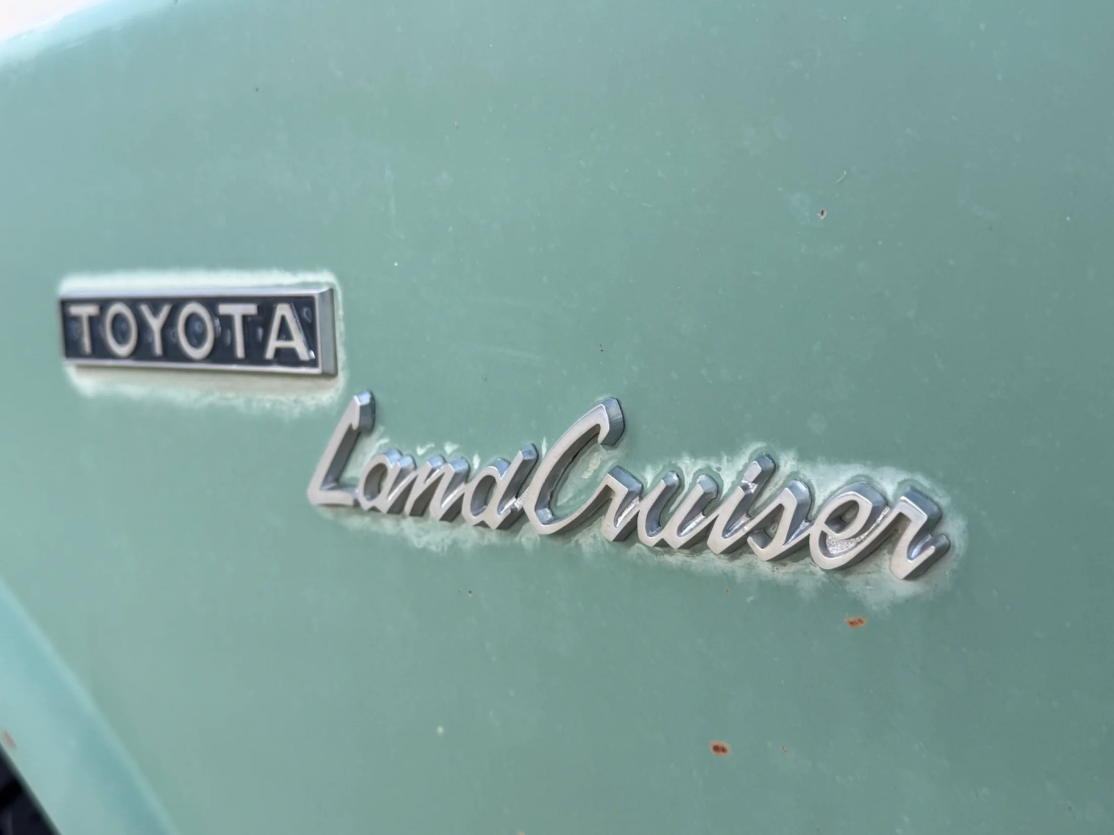

From the dash pic of the overdrive sticker to the left of the Toyota Land Cruiser, does it have one?
Haha, I need to check. It’s got a big PTO-like handle but not in the PTO spot. That’d be sweet if I get another gear out of it.

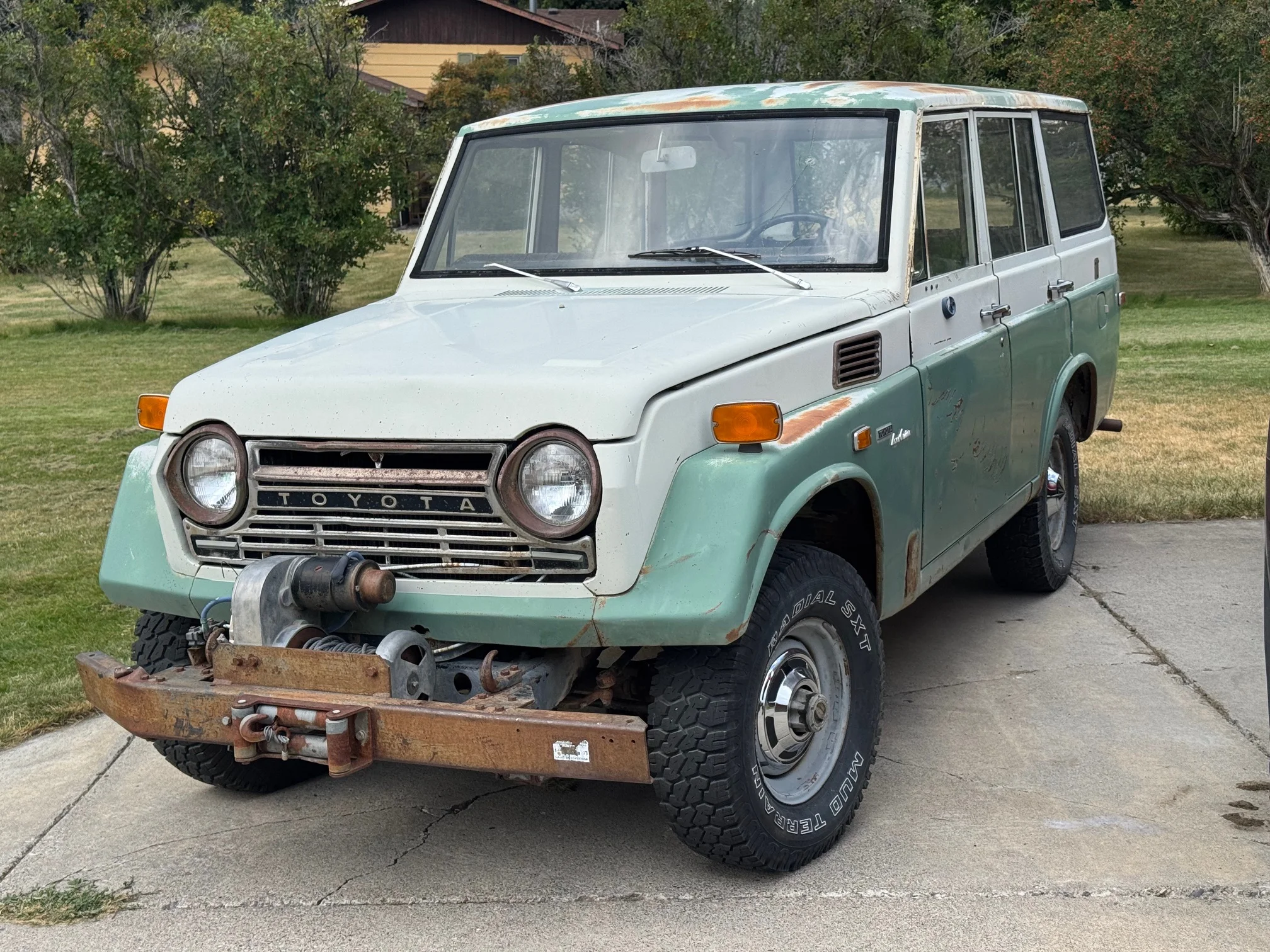

I teach a basics automotive class for one of our local high schools here in Montana. Just two 45 minute elective classes a week. This years project/homework...
A 1972 FJ55.
Found it locally. I pulled over the first day it was on the side of the road with a for sale sign in it. The gentleman who owned it wanted more than I was willing to pay. I passed. It sat for sale for a few months before the owner lowered the price a bit, so I swung back by for a closer look, about a week later and a few conversations with the owner and we struck a deal. My 12 year old son and I drove it home with big grins on our faces.

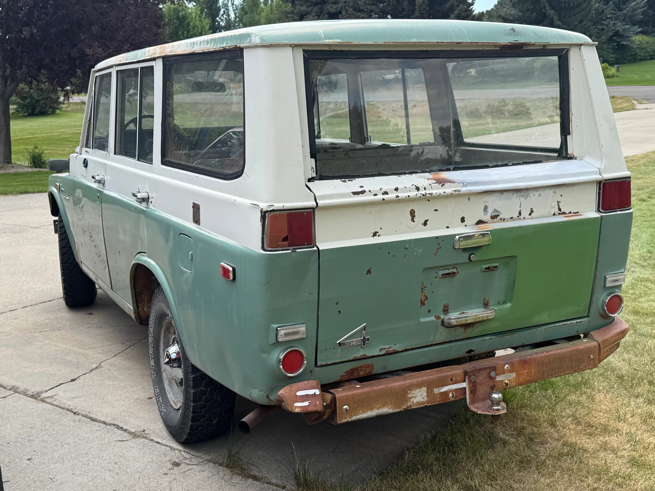

From what I can tell everything works except the gauge cluster. Nearly all the bits and pieces are there. I think it is original and un-restored with one small section of bubba body work on the tailgate. I don't think there is a truly straight panel on the entire truck but the rust is minimal. Only rust busting through is just in front of the drivers door on the fender. The frame and floor are CLEAN for the year. WAY cleaner than my 40.
My class consists of a dozen students and our plan is to go through the safety stuff and mechanicals first, teaching along the way, letting them get their hands greasy. If we end up with a solid running driver, we will likely move to the interior and freshen it up as well. I'd like to see the FJ55 be an "unrestored" driver. We need a new headliner and seat covers and perhaps a carpet kit. Should be fun.

That rear bumper looks scary! I know @Bump It Offroad has a sweet rear bumper for the 55. LMK if you need one...

Okay, I have been slowly cleaning and inspecting the Cruiser in the evenings and I am encouraged overall. Very solid rig with minimal rust. I am just deep cleaning it for starters and observing what's there and what is missing.
As I plan the class I have a few dilemma's:
  • Should I consider a front disk break conversion? I have heard properly built and adjusted drums work really well. Not sure if I am taking away any value by changing things up. This seems like a no brainier to me, simple enough to swap them over. Then the kids learn disks and drums. Thoughts? Does a 40 axle (mid 70's) make for a direct swap?
  • 3 speed or 4 speed? I have a few spare 40 transmissions in the shed. I haven't done a conversion before, I assume I need a bell housing and a t-case adapter? Not sure if I want to go this far into this one. I do enjoy putting around in it, but he three speed is beggin' for mercy around 50-55mph.
  • Is there a cheap route for rubber and door felts? Like buying bulb seals in bulk? I don't want to invest in the good stuff in case we decide to do the body down the road and strip it for paint but it needs something in the meantime.

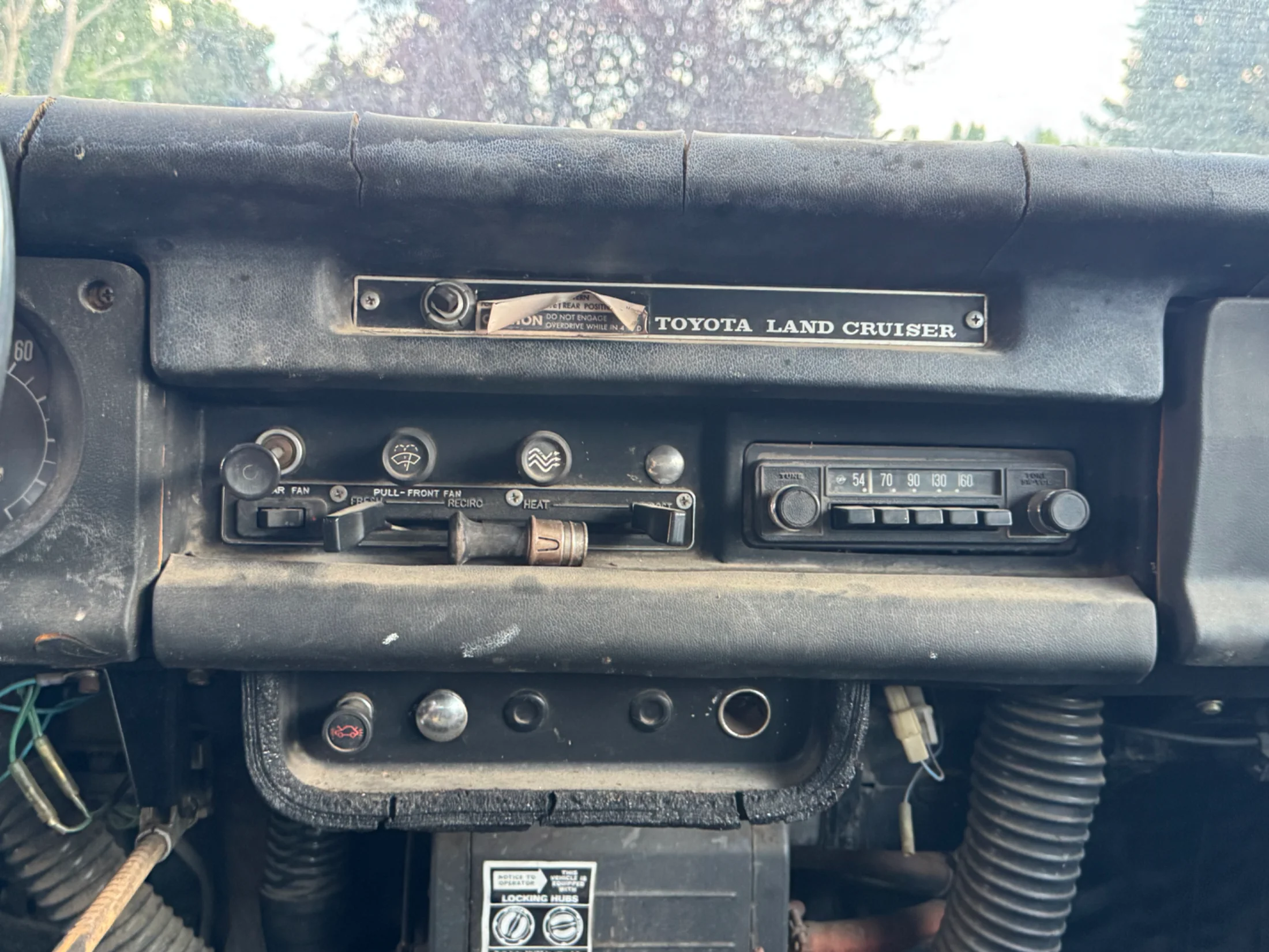

I know you all like pics so here’s a few more.

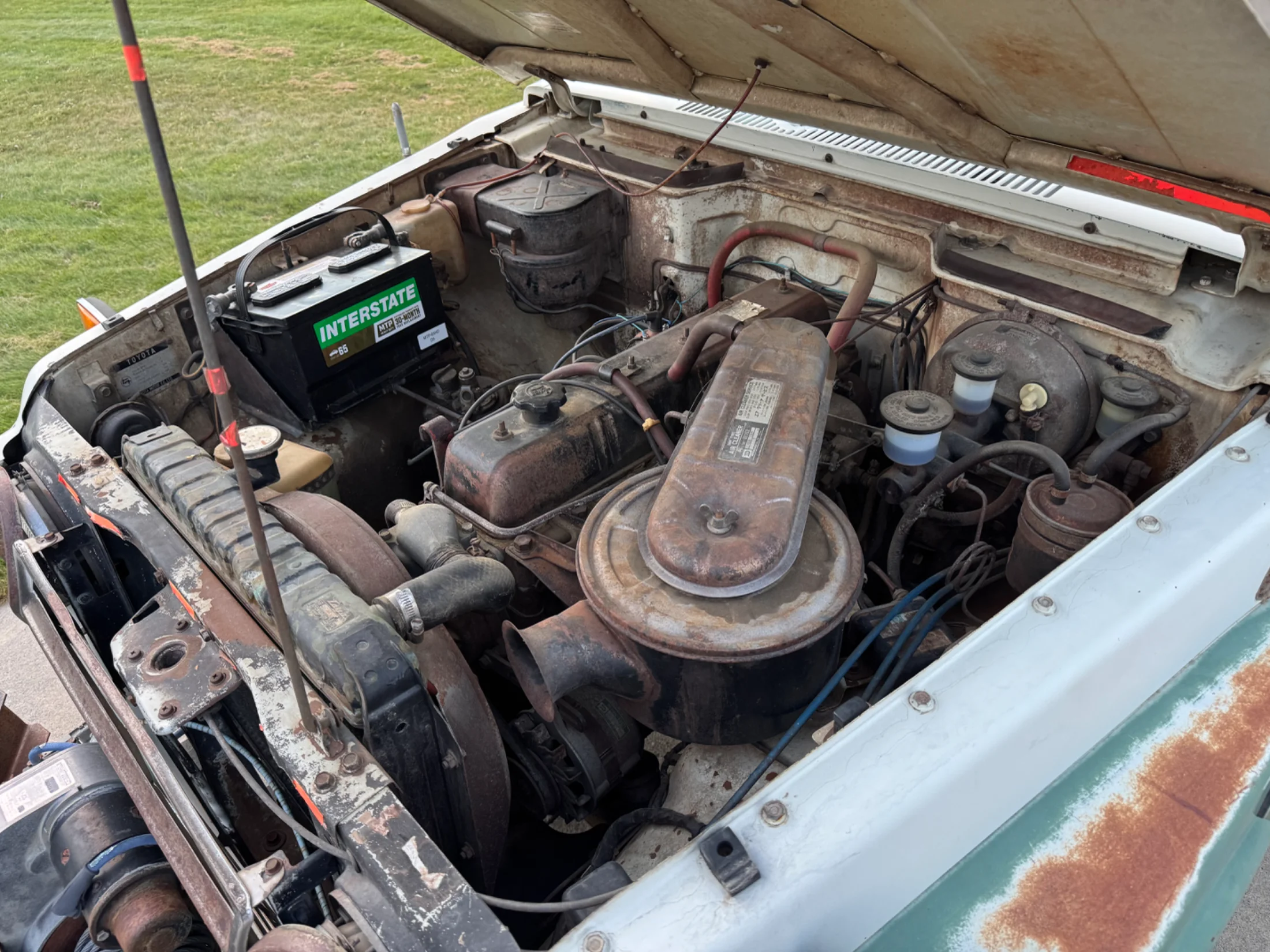

Nothing special about a 1F but she’s there and runs great.
Always nice to find the original Jack and rods. Bottle Jack came with it too. Has the original hardware to mount it all.
Dash seems complete. Doesn’t appear to be hacked up.
Look at that radio! Pretty rad.

Great thoughts!
  • What if you took them through the FSM for maintaining and adjusting the drums, and then you all rebuild a disk front axle while it is on the bench and swap it in? Good stuff.
  • For a 4 speed swap you could keep that bellhousing, but upgrade the clutch from the finger style to the diaphragm style.
  • I found a great place in Denver for a lot of the generic weatherstrip - see my Pig thread. For the specific stuff - SLOCruiser is your hook-up!

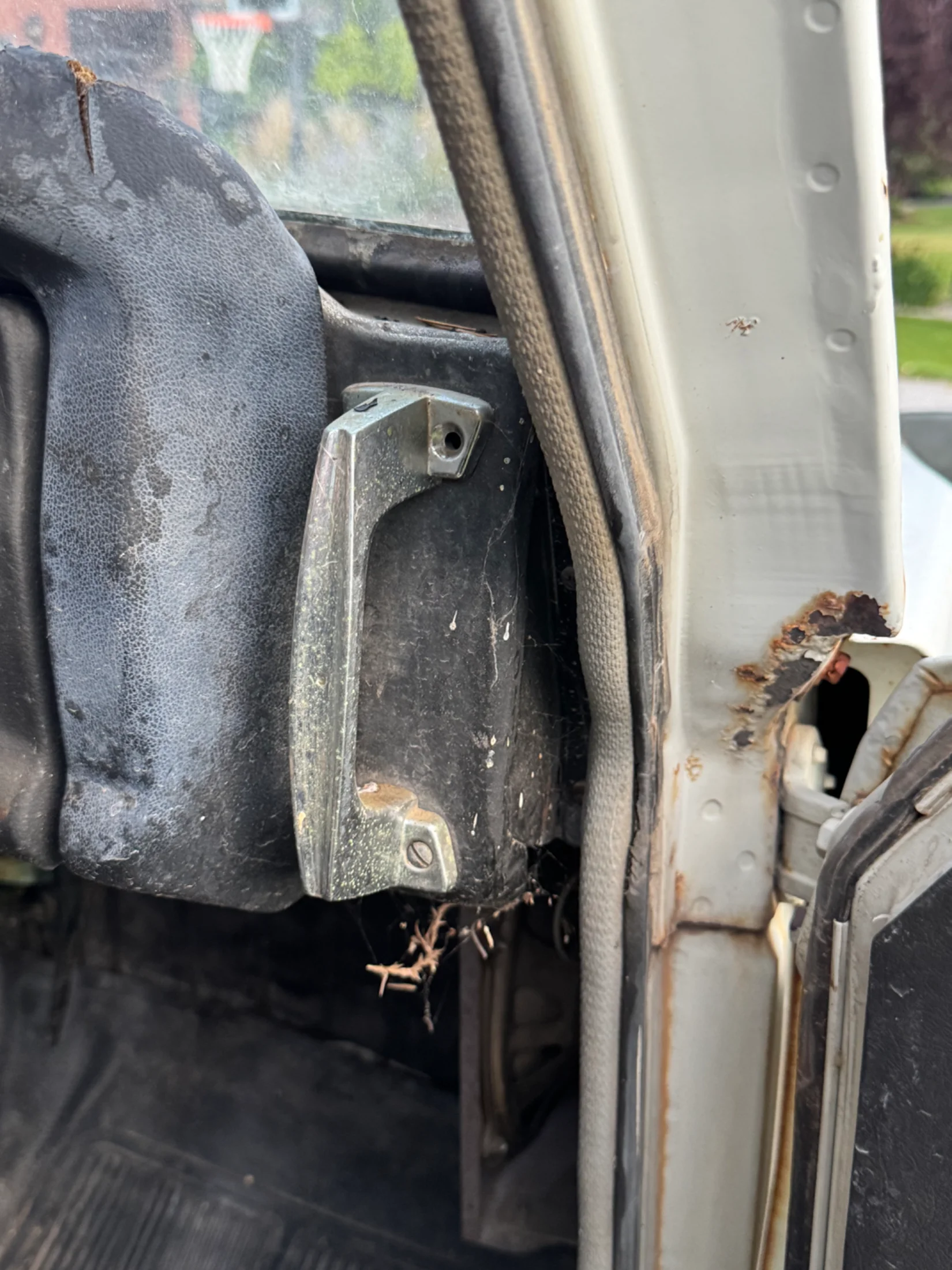

Is this handle OEM? Kinda' cool. Looks old, also looks like a generic handle.

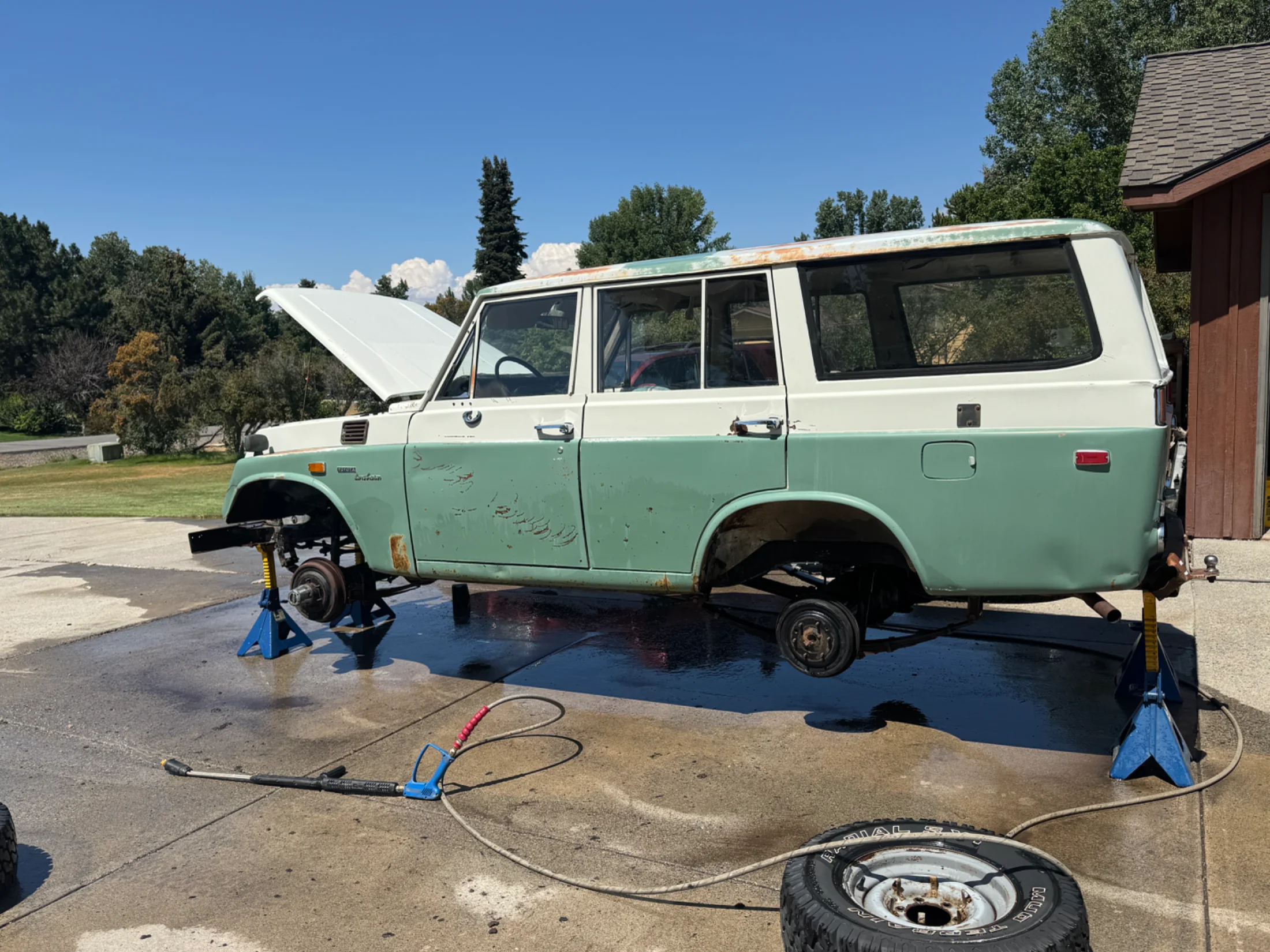

Took the Hotsy to the Pig yesterday. Nearly ruined my driveway. Lots of grease and lot of tar like grunge came off of it. Frame is in excellent condition. Grease and grime can’t hang on when the Hotsy gets up to 220*. It’s my second favorite tool.

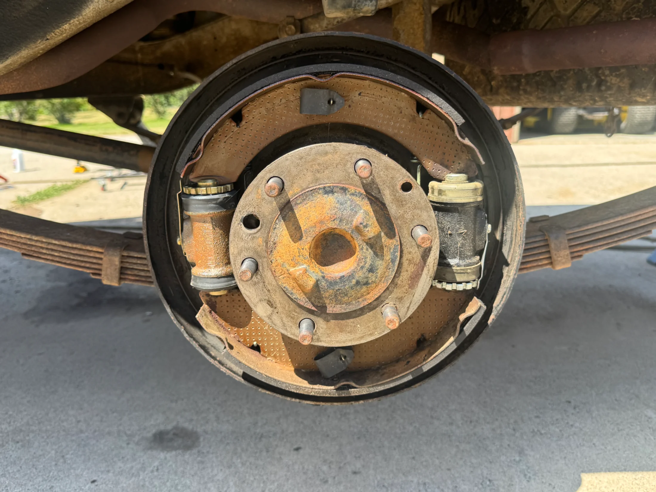

Pulled the drums off the rears, one looked “freshly” rebuilt, the other looked like it was from 1972. Both are WAY out of adjustment.
