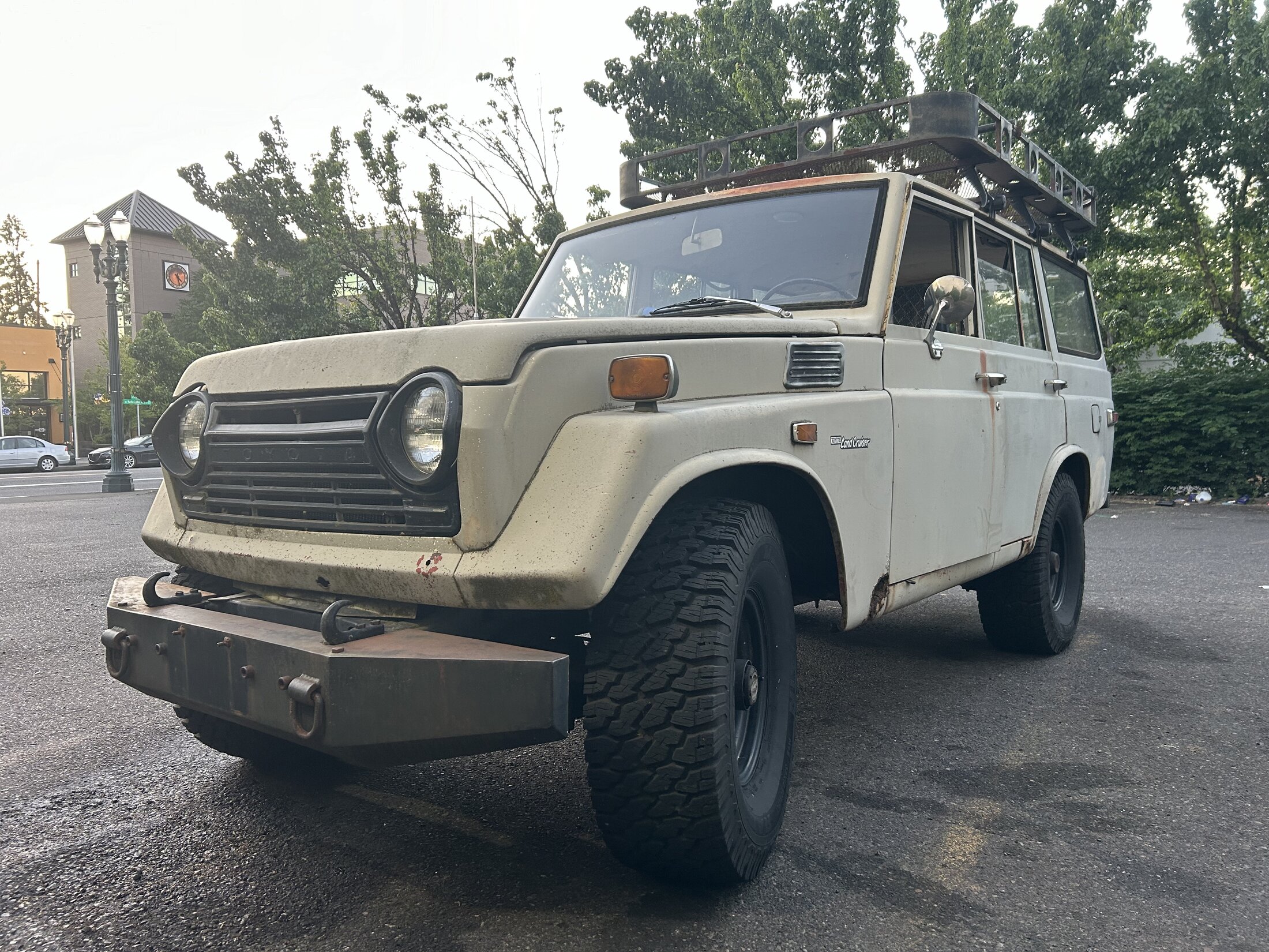

Starting here with my plans/ideas with hopes for comment from you who have gone before me.
I purchased my ‘55 in June, and have slowly been playing whack-a-mole with some must fix items, while also getting to know the rig and putting together my plan.
Baseline: 1974 FJ55 w X26,000 miles has been in continuous operation for entire existence. 226k?
2F motor (from a ‘76 according to an inspection by Land Cruiser Specialties out of Oregon City) that came with the rig) with 90 psi avg compression, no vac. lines, runs kinda rough but made it from Portland (purchase location) to Seattle via backroads: 230miles at 45-50mph without any major issues. No major oil leaks out of engine, but one leak out of mystery (to me) threaded stud on the side of the head between cylinder 4 and 5. I can get it up to 65 (57 on speedometer + rubber overdrive) but am afraid to keep it there for long.
H41 tranny (I think) with leak out front seal and bearings sound like they are shot. Tranny is VERY loud during normal operation- can’t hear engine running over tranny whine. I think H41 based on comments I’ve read- can’t get through an intersection without shifting to 2nd. Any way to tell for sure? Replaced slave cylinder first week I had it and master cylinder is failing now- need to order a new one.
Transfer case has leak out the back (I think). Oil comes out of speedometer cable and e-brake. Otherwise functions fine.
Factory differentials, axles, etc. shocks look super worn.
Power steering has play in middle, but otherwise functional. Shock on this looks super worn also
Drum brakes seem to work fine. Have not opened them up to see remaining wear.
Factory springs
33’s on nice rims
No lift as far as I can tell-plus 33s rub on far ends of turn radius.
All fluids needed replacement. Some grease fittings don’t want to take more grease so I’ll need to work on that.
Exhaust must have been rebuilt at some point b/c it is solid.
Body- one of the main selling points: rust in the normal worst spots-back/bottom of front fenders, bottoms of some doors, running boards, but nothing on the roof/drip rails, and body mounts are solid. Original is Red/White, but the matte tan is honestly growing on me.
F/R Bumpers are aftermarket custom and one of my favorite mods- pretty sure they are 1/4” plate, and the welded on D rings are pretty tough.
Interior- front had two trashed seats with non-functional lap belts, so I found some seats with integral shoulder belts (BMW convertible- all others seem too big/plush for the ride-looking at you, GM trucks). Dash has an aftermarket shell on the vinyl-not cracked but kinda deformed. Any ideas for giving that some new life or just replace it? Gauges all work. Heater core is good and I was able to re-build the blower motor. No interior carpet. Door panels are trashed. Ceiling liner is stained and torn in places, but overall not horrible. Overall mildew smell is just about right- it’s there so you know it’s an old car, but it doesn’t sting your nose. Back bench vinyl is torn but overall this seat is in decent shape.
Rear door window mechanisms are jammed/torqued to the point they don’t roll down, but rear tail gate motorized glass goes up/down (with assistance) from both the key in the tail gate and the switch on the dash.
Missing the 2 Toyota Land Cruiser badges on the fenders, and the big 4wheel drive badge on the tail gate. Otherwise all trim is in place.
Will follow up with initial build ideas.

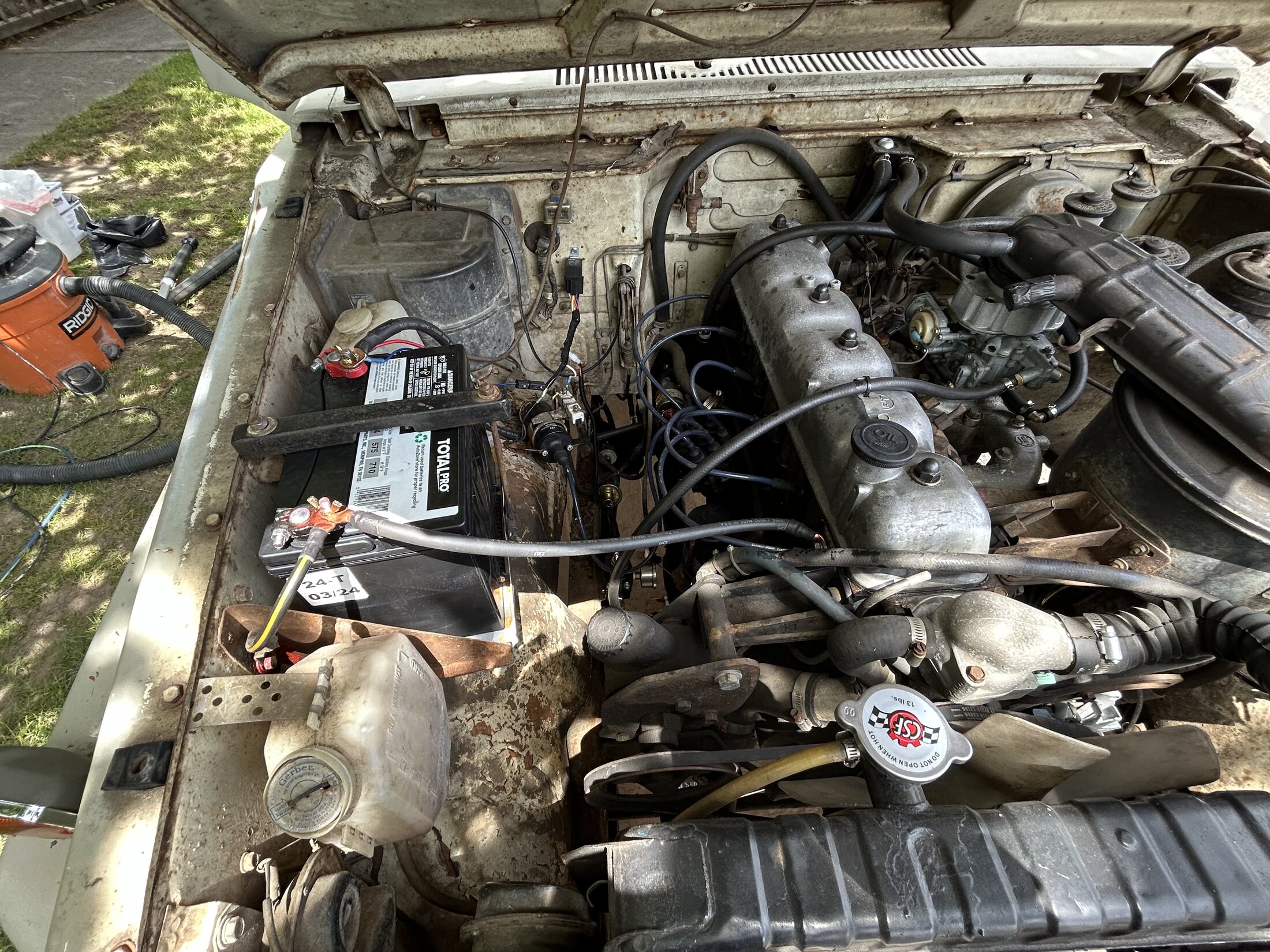

Initial Build Ideas: drive train
I’d like to replace the engine with modern Toyota option. I’d like this to be a daily driver/ mountain rig but not looking to do any crawling in it. Want to be able to go freeway speeds and hopefully get close to 20mpg.
I’m looking at JDM import engines but open to other suggestions. There is a 2Gr-FSE at the JDM importer nearby for $1500. This V6 makes 300 hp and 280 ft lbs. These impressive numbers are hit at higher RPMS, the ECU needs to be modified to work with a manual and it would also need a new flywheel and I’m not sure how it would fit against the firewall- still sorting this out. .
If I could find a low mile 2UZ-FE, I think I’d jump at that, based on the durability reputation.
Does anyone have experience with the JDM import engines? These JDM motors supposedly have less than 50k miles on them and that is enticing, but I’m hesitant at accepting this at face value.
And then there is the 5.3 liter GM. Any thoughts on finding low mileage options? I don’t really want someone else’s 150k motor if I’m building this to last a while.

That's a sweet Con-Ferr Rack.

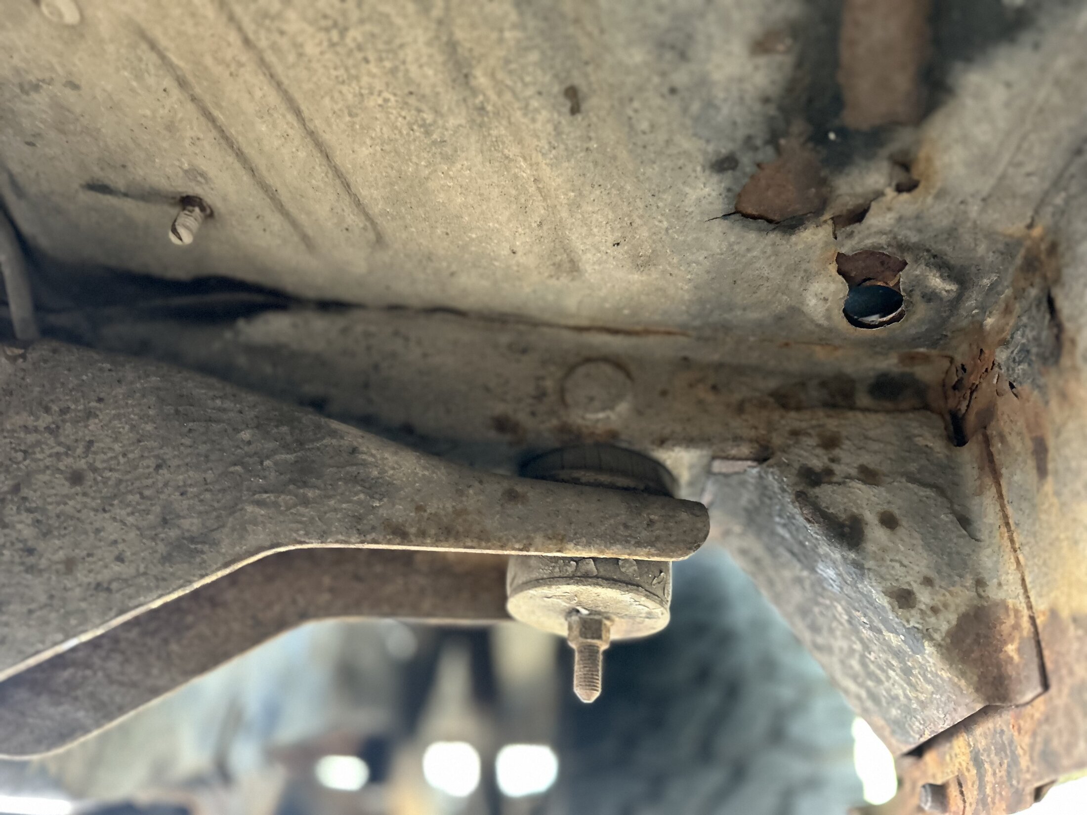

Is that rust on both A pillars? That is not an easy fix and I wouldn't want to put big money in the wagon until that was corrected. After the major body work was done, then sky's the limit on cool ideas.
Congrats! Nice rig👍🏼
The seal around the windshield, and all the glass, for that matter, is done and needs to be replaced. That said, most rust appears to be surface at this point, but to your point, it needs to be addressed before it gets worse. I would like to focus on the drive train first, and address the seals when addressing body issues, ahead of paint, but I’m definitely keeping an eye on it.

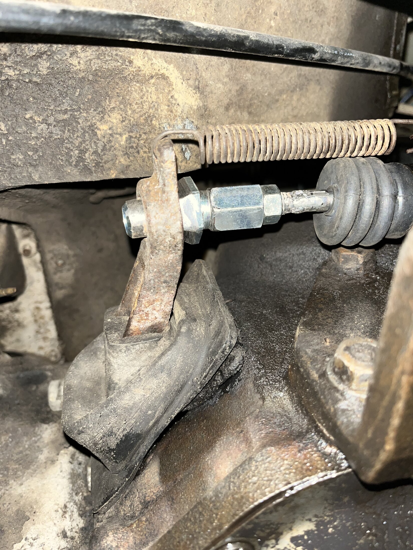

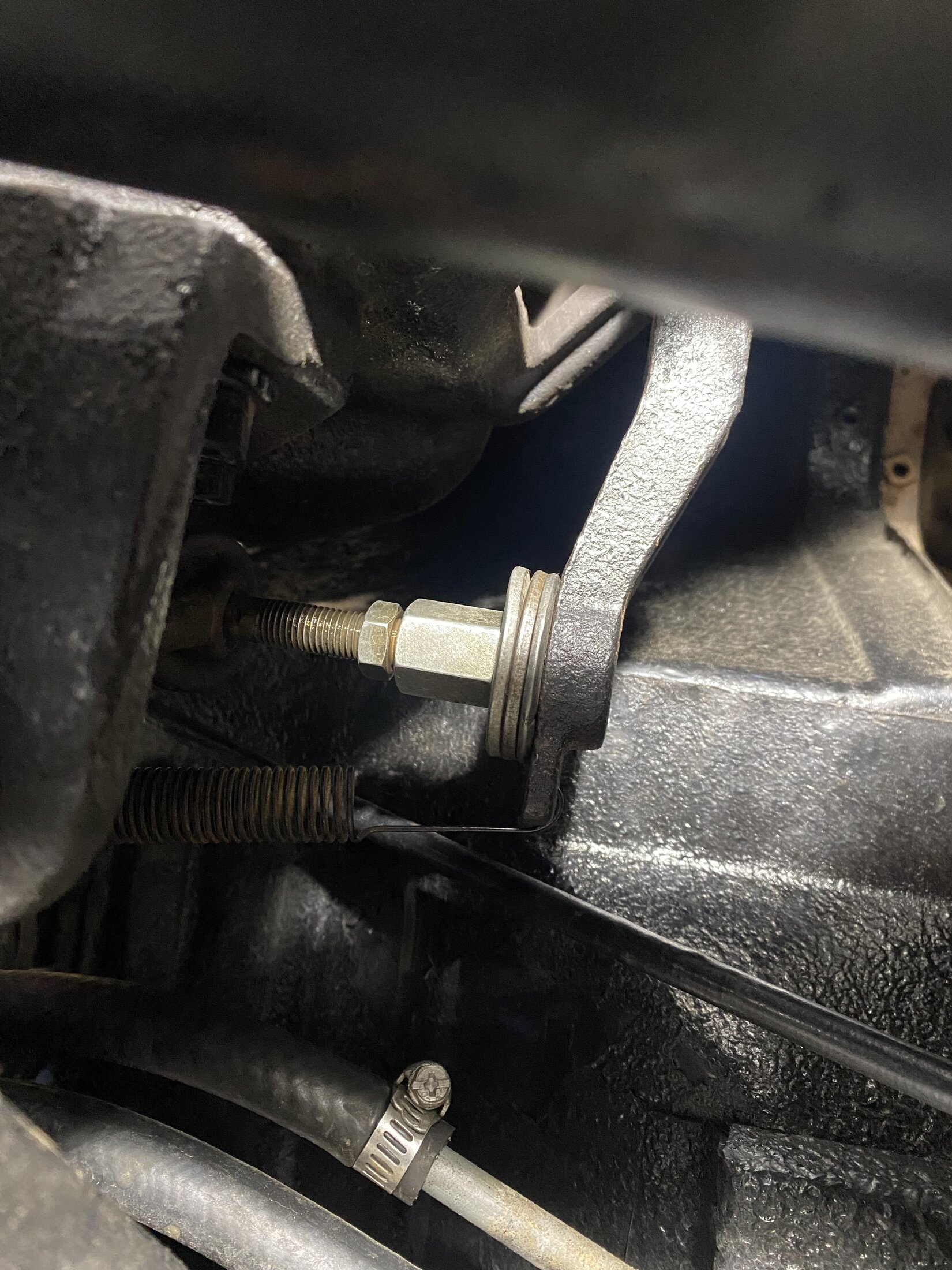

Not really part of the “build” but more like ongoing whack-a-mole: I have now sheared 2 rods between the slave cylinder and the clutch fork. I’m pretty sure it is due to the hex shoulders on the domed nut on the end of the rod digging its way into the clutch fork, and becoming locked in place, so that when the clutch is depressed, the rod cannot pivot easily. Both rods were bent and eventually sheared at the lock nut. The latest one has a lifetime warranty, so while I wait for the replacement, I figured I could try to come up with a solution. I cut out the bent section and welded the threaded end back onto the rod. Then I took a grinder to a gas flare fitting with male and female threads and reduced it down to something that would fit inside the hole in the clutch fork, and would give the domed nut something to push against/rotate within. With the shoulder of the female end of the flared fitting keeping the domed nut from falling out, and the previously male threads (ground off so it is the correct diameter) poking through the fork so it can’t fall out, this Macgyver solution seems like it will work, at least for the short term.

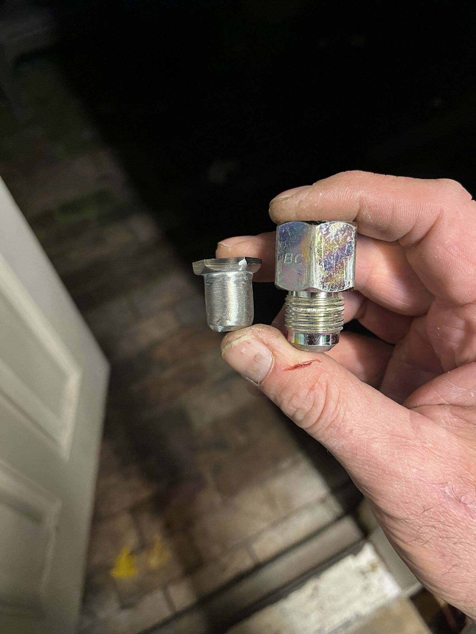

Before/after photo and photo showing flared seat are the prototype. I didn’t like how little shoulder was left so I fabricated a second one- which is shown installed. I left more of the nut end, which keeps the domed nut in place better, but still allows for rotation.

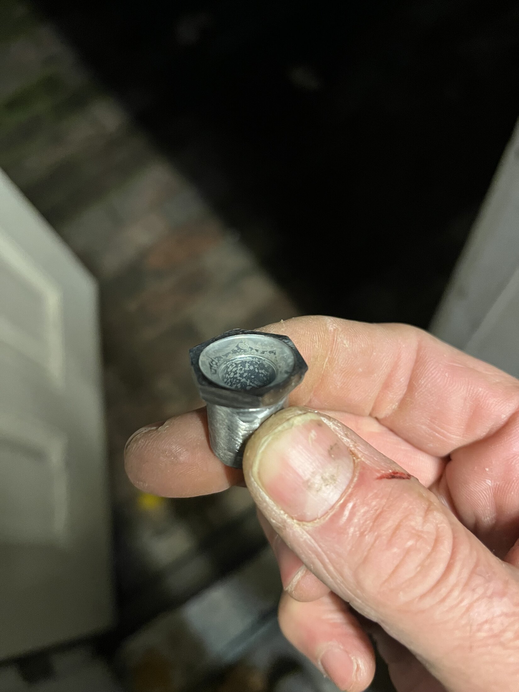

Has anyone else run into a situation where the hex shoulders of the domed nut starts digging into the clutch fork? Solution -aside from fork replacement?
Is the slave cylinder misaligned? Is the clutch fork a non 55 part and the ball not fitting in the socket right? I've seen wear on clutch forks before, but never seen what you're describing. That's not saying much though, so it could be a common problem.
As far as I know, the clutch fork is stock to the H41 tranny. The slave cylinder is in line with the fork when the pedal is not depressed, but when you engage the clutch, the angle changes as the fork moves away-that is to be expected. The issue is the domed nut at the end of the rod is wedging itself into the fork and unable to pivot at all when the clutch is depressed, creating the bending, and eventually shearing forces.
Years ago I had a slave cylinder deploy on me.
I don't remember if I figured out what happened, I don't think I found all the pieces once I stopped rolling.
