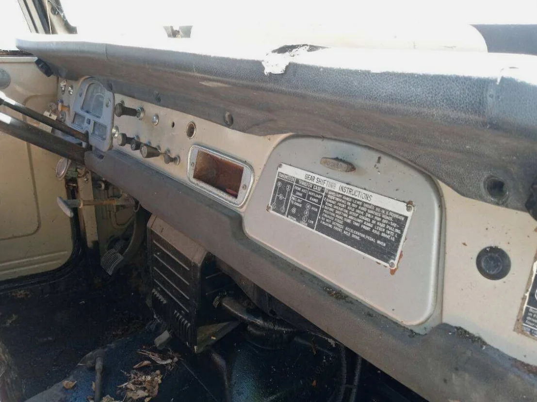

Yours didnt have one, they went away about the time dash pads showed up in this market.
Well that's good to know. Thank you. I thought it went where the 2 holes are in the pad on each side of the glove box, but now that you said that, I bet those are just there for the mounting bolts or screws for the dash pad. See attached pic:

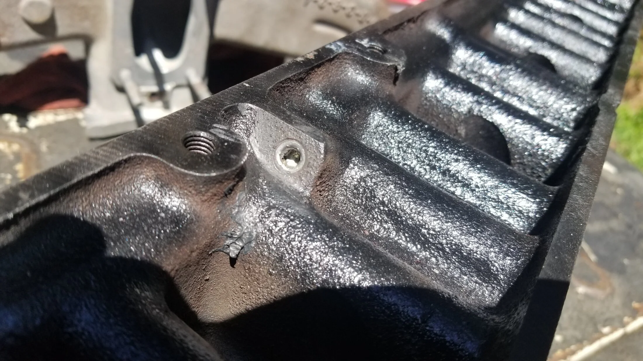

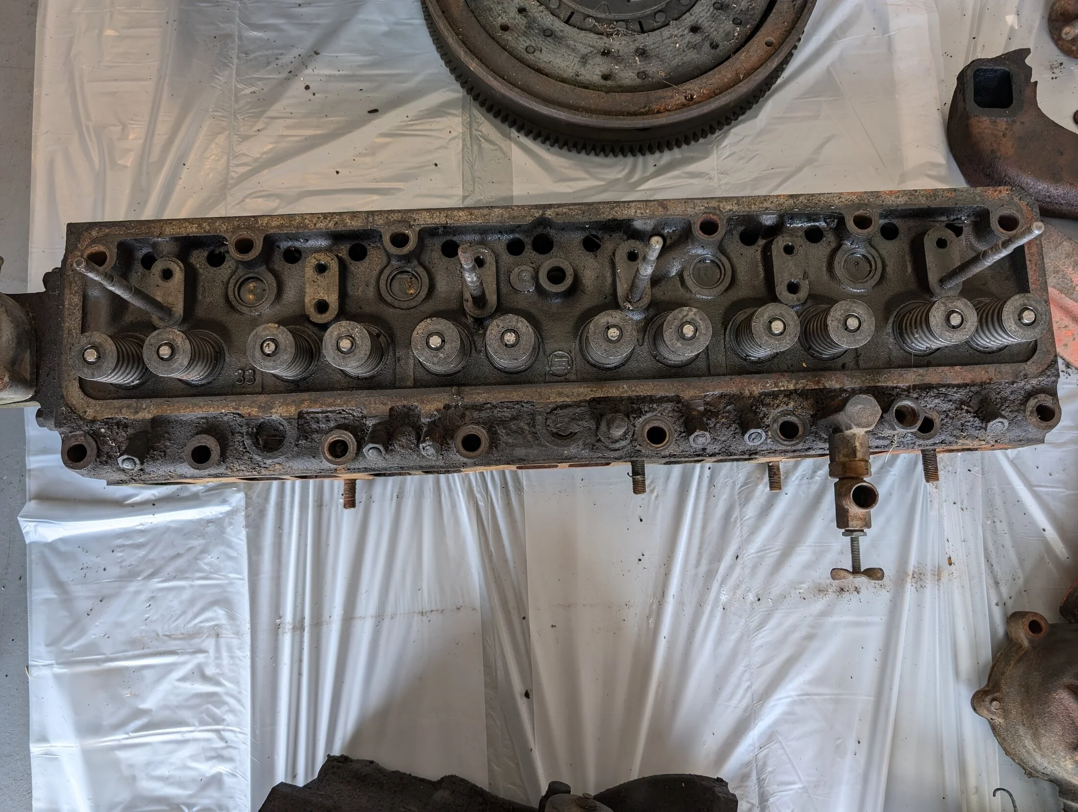

Cylinder Head Oiling

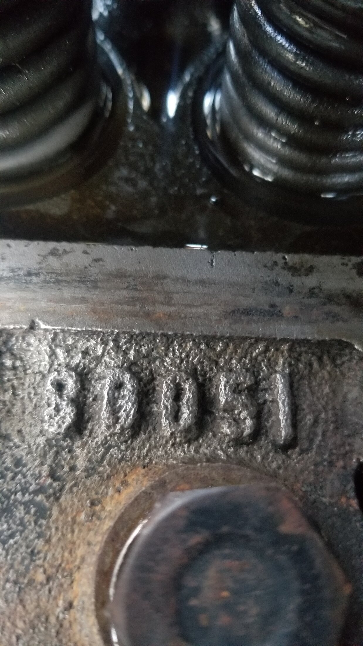

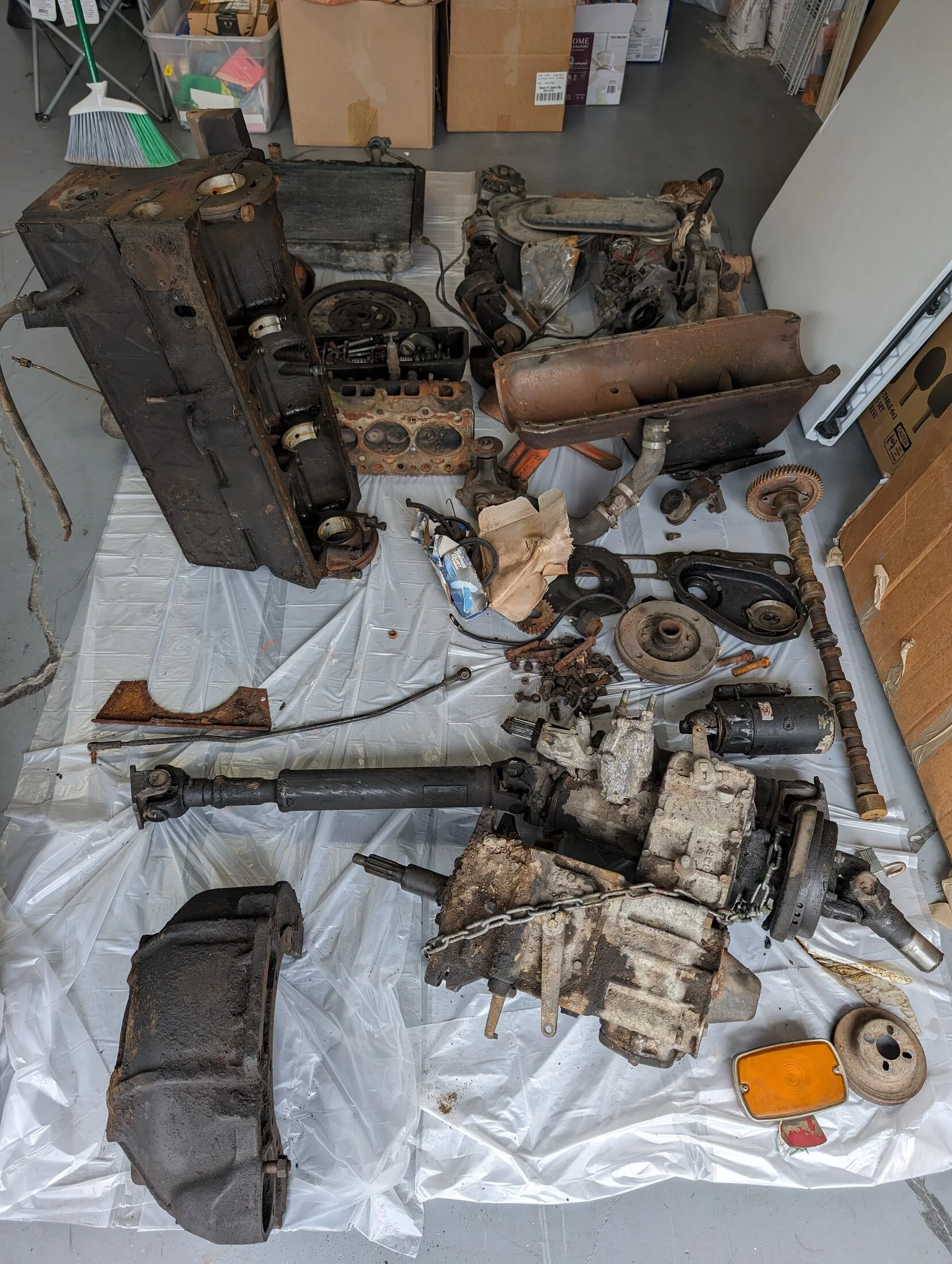

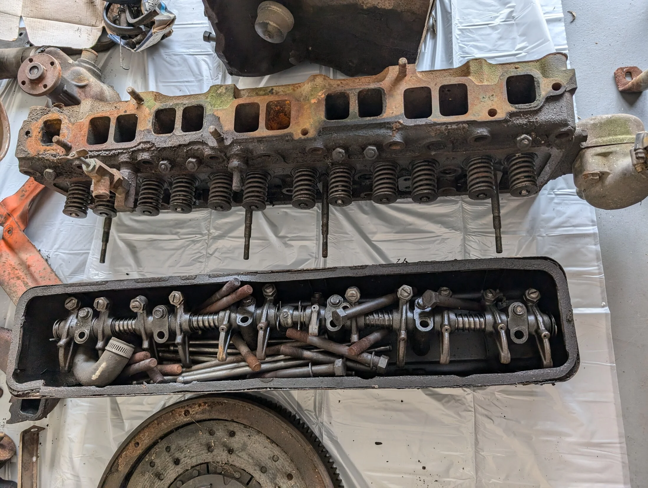

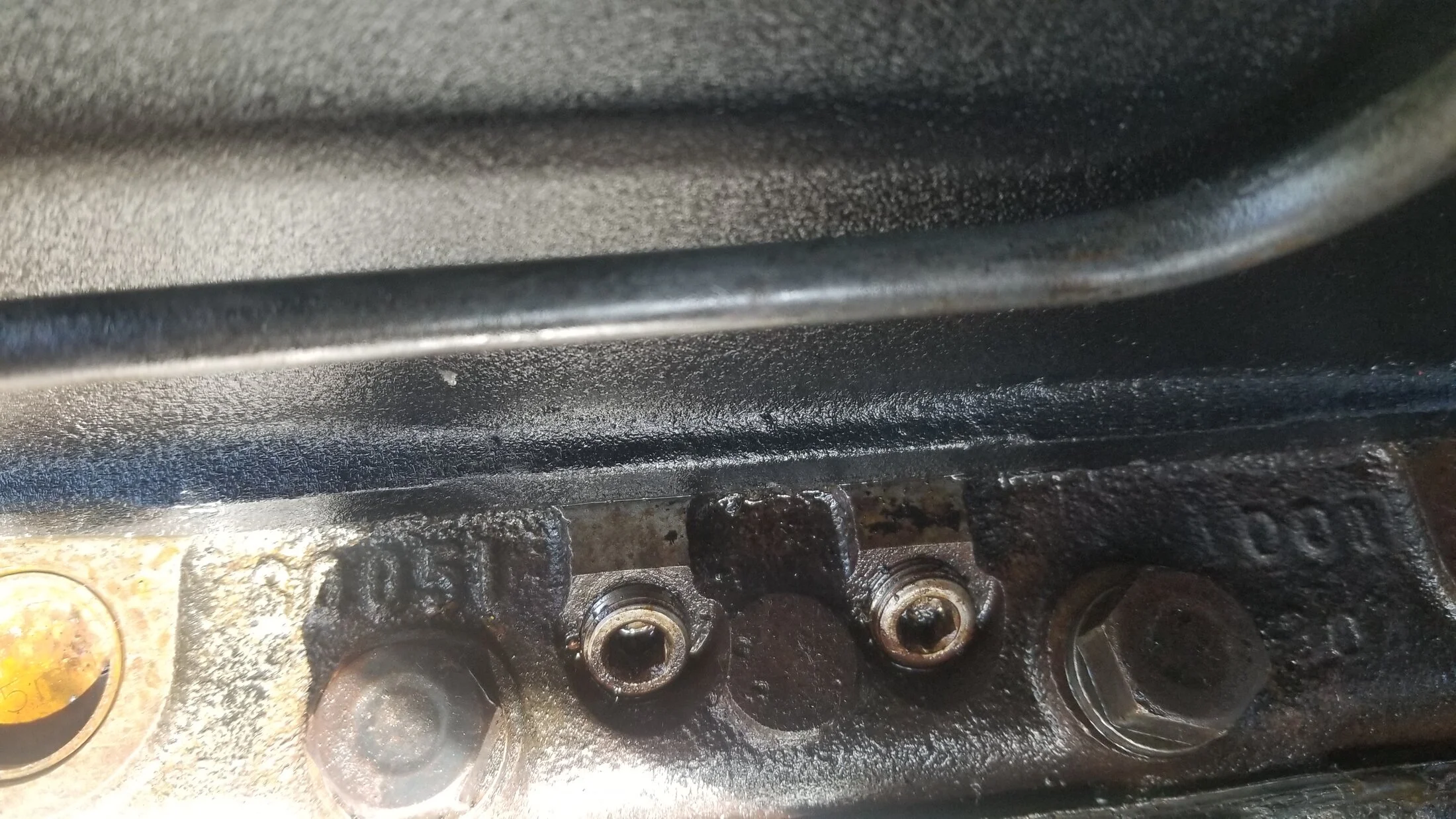

Previously when I had posted about parts I had for sale, multiple people said I should keep the head because just bolting it on my 2F would increase the compression. So I have kept it. But, it was also mentioned that it would need to be drilled out at a certain place to improve the oiling. Below I will post some pics of it. Would someone please photo edit and place a circle or an arrow at the exact spot that needs to be drilled please? Thank you!
IIRC, the '74 head bolted right on the 2F block, no drilling required.
You may be thinking of that oil passage plug in the head that sometimes blows out, the one that needs to be permanently plugged before that happens.
Just above and in front of sparkplug #5
"Supposedly" this is a 1971 head. However, when I went over to cruisermatt's he ran the numbers on the carb that I had and if I remember correctly it pulled up as a '73 carb. So it is entirely possible that it had an engine swap at some point.
I would have to go back and dig through mountains of thread responses, but I'm pretty sure they were saying a passage needed to be drilled, rather than plugged. But, my memory isn't what it used to be. LOL! Getting old SUCKS!
The galley plug is what it is called on other threads. It is a known weakness and when it blows, you don’t have long to shut the car off.
I had the machine shop plug mine for engine rebuild- I will edit the post if I find the $ they charged for reference.
I would not date the head based on the carb, while logical, anything possible with a 50 year-old car. There are numbers on the manifold that goes with model number etc to cypher.
Thank you. But it seems like they were saying it was something that would improve oiling, rather than something to prevent a blowout.
