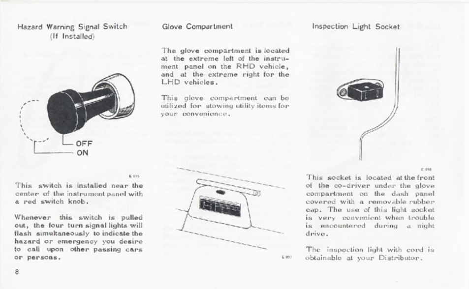

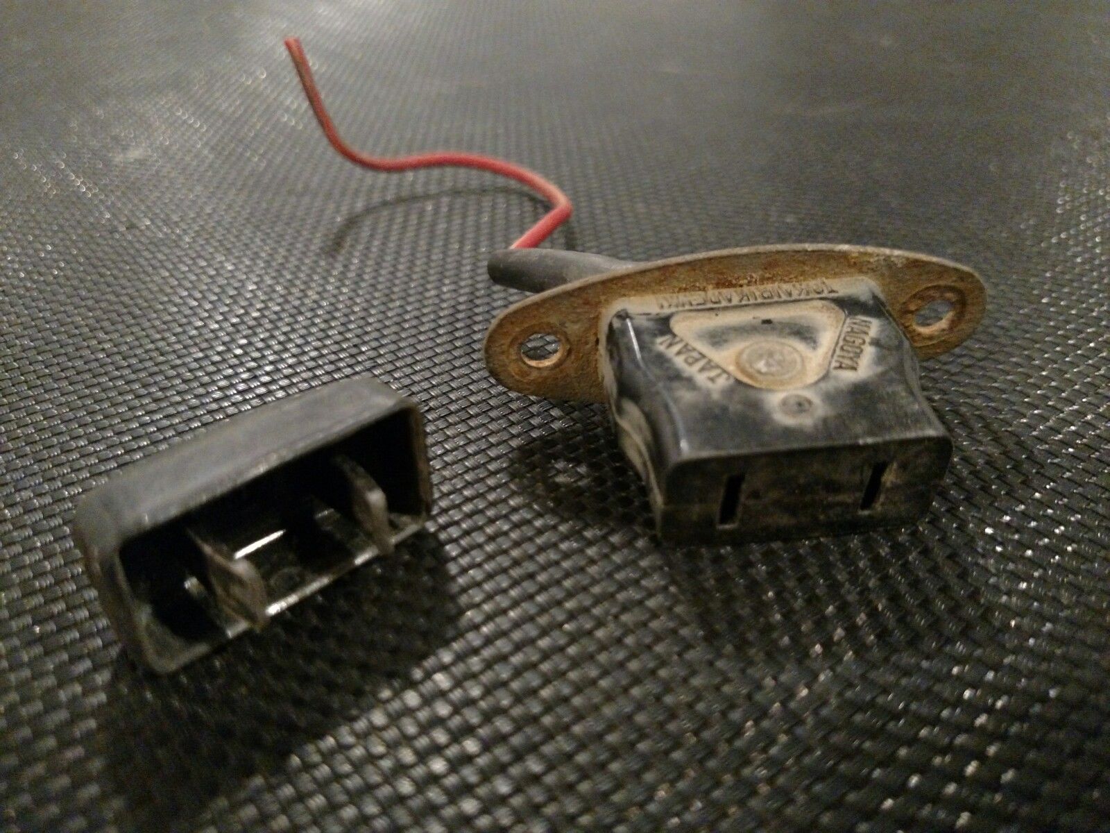

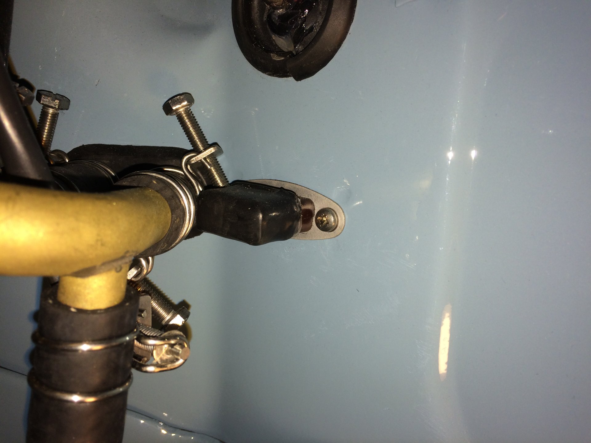

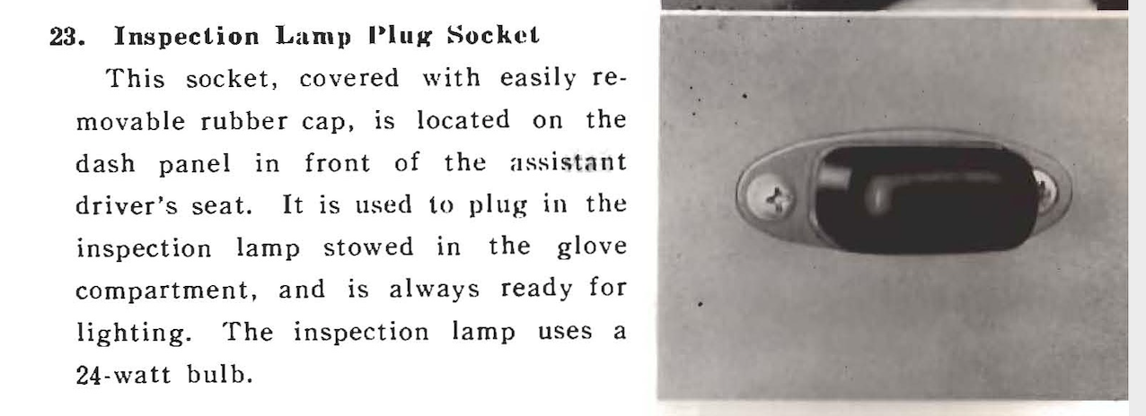

Did all FJ40 / 45 BJ60's come with the Inspection Light and the plug under the glove box that it plugs into? And, was it in fact under the glove box, or off to one side or the other? I ask because I looked at mine Saturday when I was there and I didn't see the plug anywhere, or any spot that looked like that's where it was. And I'm curious how it was wired up. I've got bigger more important and critical things to deal with first, but eventually I would like to get one of these and have it usable.

Early inspection lamp socket location.
In relation to heater pipes, shown with the socket cover.
Early socket and cover.
Early Owner's Manual description.
1971 Owner's Manual.
I like how Toyota refers to the “Assistant Driver” instead of as a mere passenger. I wonder if in Japan the assistant driver can get a traffic citation in the event of a wreck.
