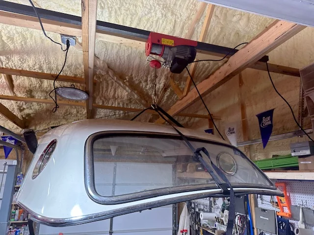

I am just getting caught up reading your posts from April. If you have not solved your solo hardtop removal here is what I have used for several years now. It is an inexpensive solution but that is all relative when it comes down to it.
I use a 110v Harbor Freight winch that sells for about $139.00 and is on sale occasionally for $109. I have the winch sliding left to right (in my case) on a 1 1/2” 11 gauge box tubing. The 10’ box tube rests between two trusses in my ceiling that are 8’ apart. Total cost of this setup was about $400 including the t-bird/jeep bar, pulley and straps, winch and box tube.
Using it I can single handedly remove and replace the tops on my ‘56 T-bird and FJ40 by just pressing a button on the wired remote….
AND keep it stored up in the ceiling. The T-bird roof has been up there for a few years now

How much does the hardtop weigh? Harbor Freight has an electric hoist for $99 rated to lift 440 pounds. Then again, if I get the one that @knuckle47 got it would lift 1,300 pounds and could be used for lots of stuff I guess, as long as I had plenty of joist reinforcements put in.
I don’t know what the top weighs but 440lb lift works. If you use the included pulley, it doubles to 880lbs. If you mount your box tube to slide front to back, you can just pull under the hardtop and then be really close to the target area. This winch has a 1 1/2” square mounting loop so it fits the box tube perfectly. This makes hardtop handling really quick. You will need to initially set the balance points for the hardtop by adjusting the straps. You can do it while the top is on the floor, lift it a few inches and see that it’s level. If not just shorten or lengthen the front or rear straps as needed. Once it is adjusted… you’re done with it forever. Hoist it up
Perfect! That's what I am going to do. Thanks again, Don.
