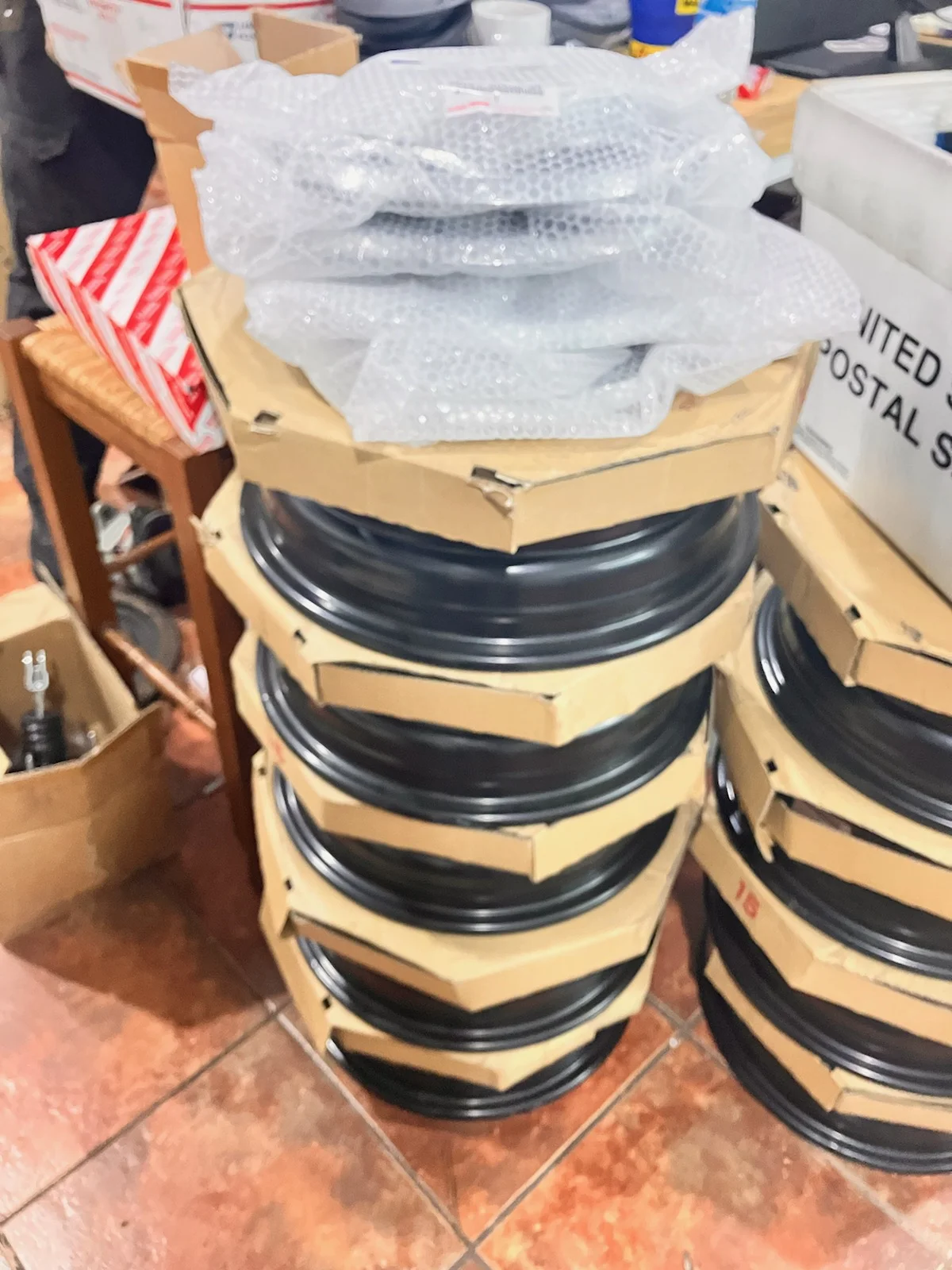

Don, dude, I literelly sell a set of brand OEM new welded wheels an hour up the road from you for like $130ish a wheel.
15"
SOLD! I'll call the other place and stop them. The wheel that was on the spare is welded, so that one should be fine, correct? Keep it and scrap the other four? At first I just thought about buying two new ones for the front but I want to be able to rotate the tire so that didn't make much sense.
