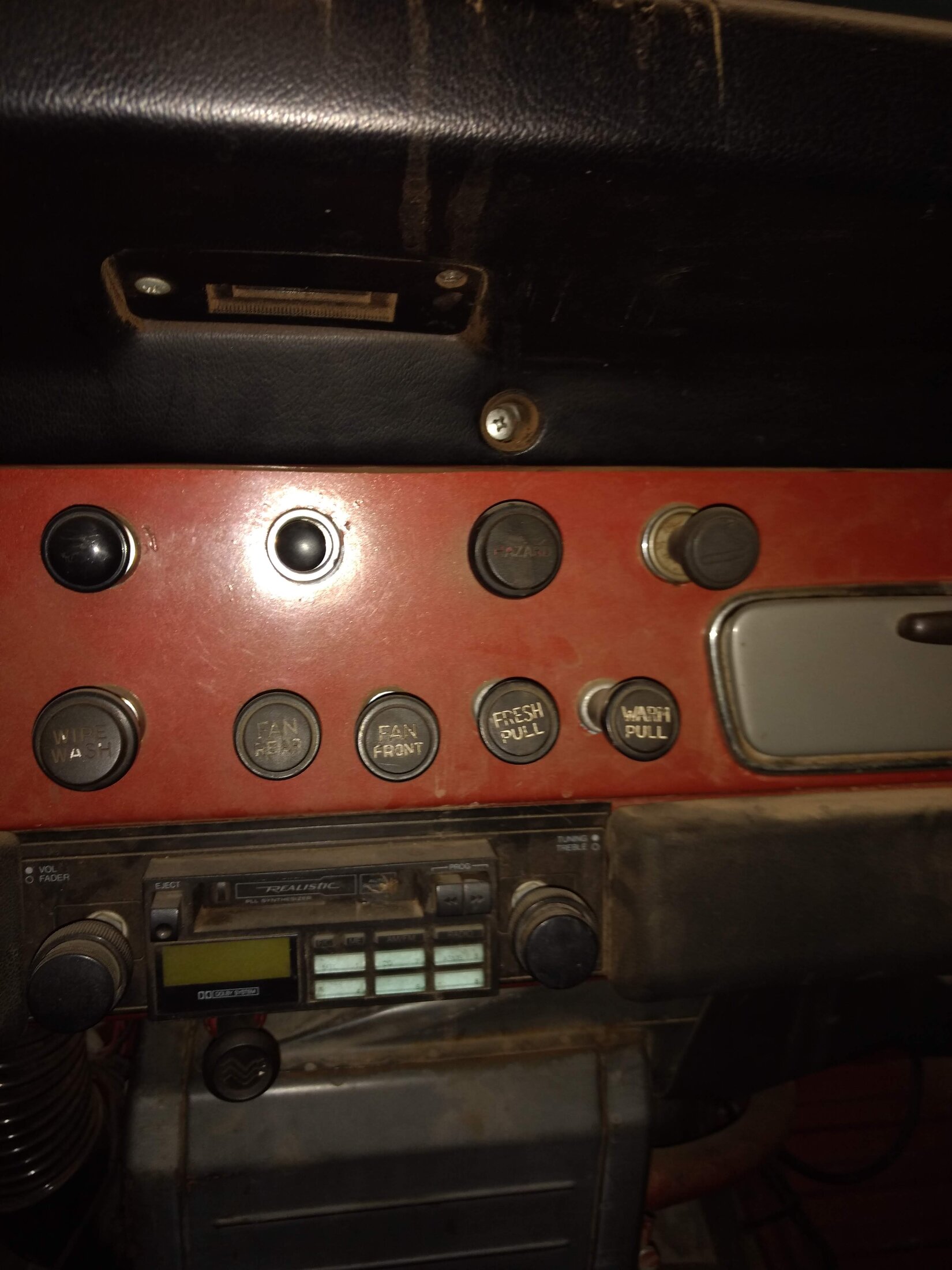

Here is my 68's dash. I thought about it for a long time before I pulled the long lower dash, cut a hole for a radio and the install the 73-82 two pads.
Still have the piece I cut out and the long lower pad. Would have to weld the old piece back in to go back to dash mounted transfer case high low shifter. Besides a bracket for the shifter on the piece I removed the radio would prevent the shifter from being install. 9/72 was the end of the dash mounted high low shifter. 4WD could be operated by vacuum or electric but high low was only on the transmission hump from then on.
Looks good. Where there's a will, there's a way. I guess I could even put it inside the glove box, or fabricate some kind of under the dash mount or mini console.

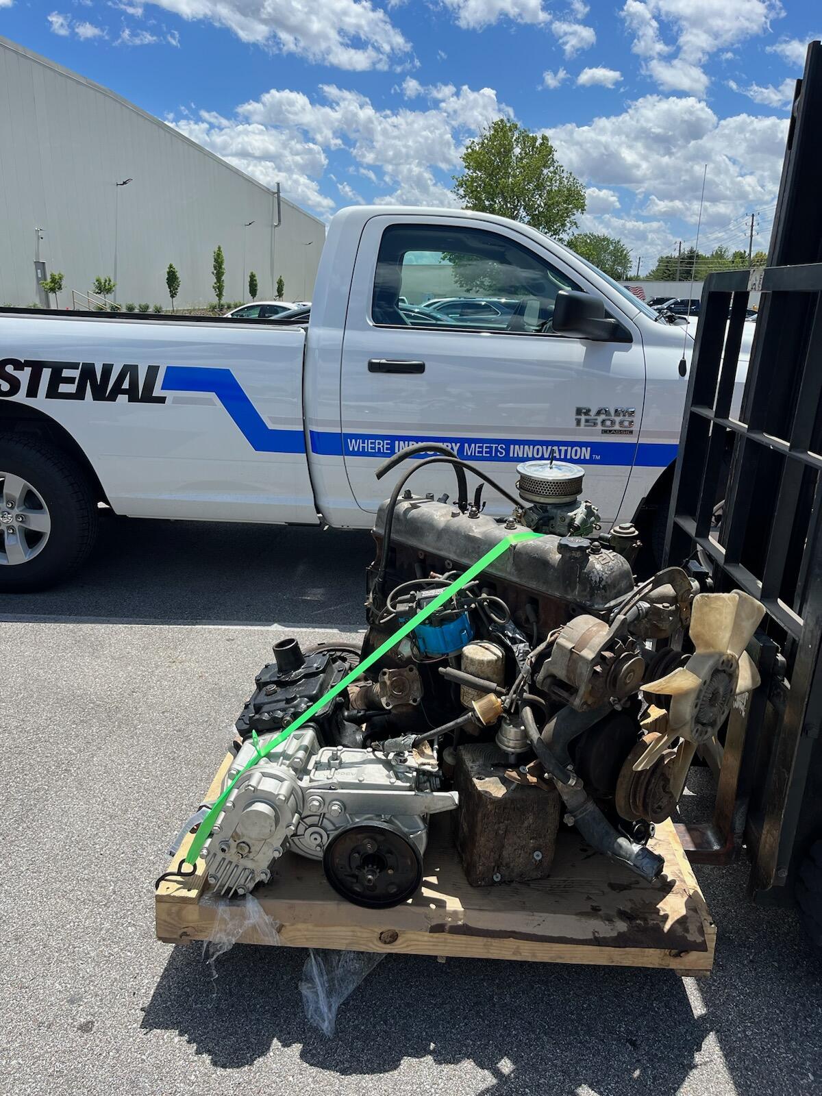

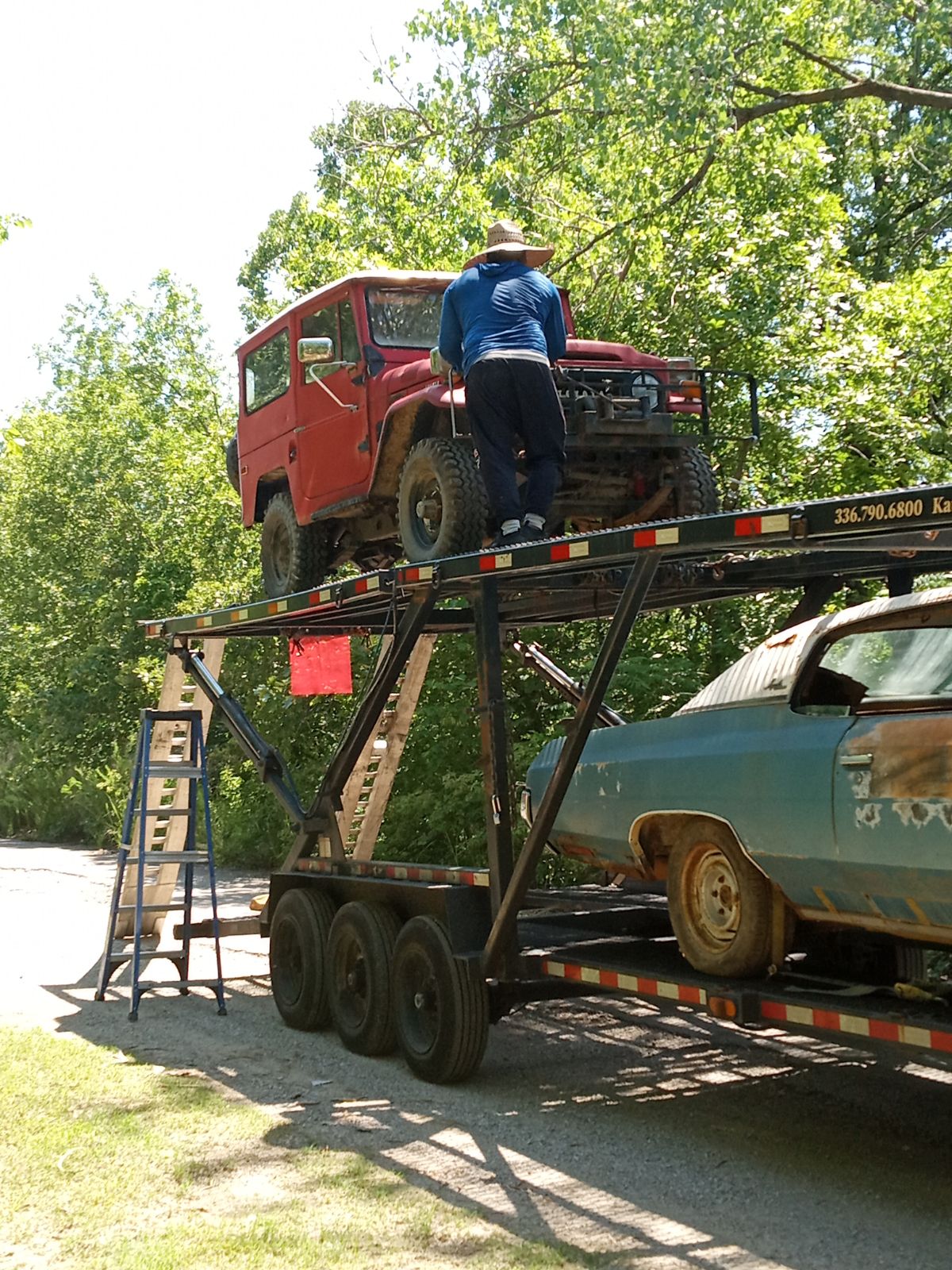

Tomorrow will be Christmas,and I will be able to take pics and tell more. Happy day in my house, as the FJ40 and the drivetrain both shipped. See attached:
I'm just guessing, and not sure how to tell for sure when it gets here later today, but with the HFS (Hell for Stout) Suspensions (CCOT) on the back glass, and the shocks that are visible, and the room around the tires I'm "guessing" that maybe it's been lifted? Any suggestions on how to tell?

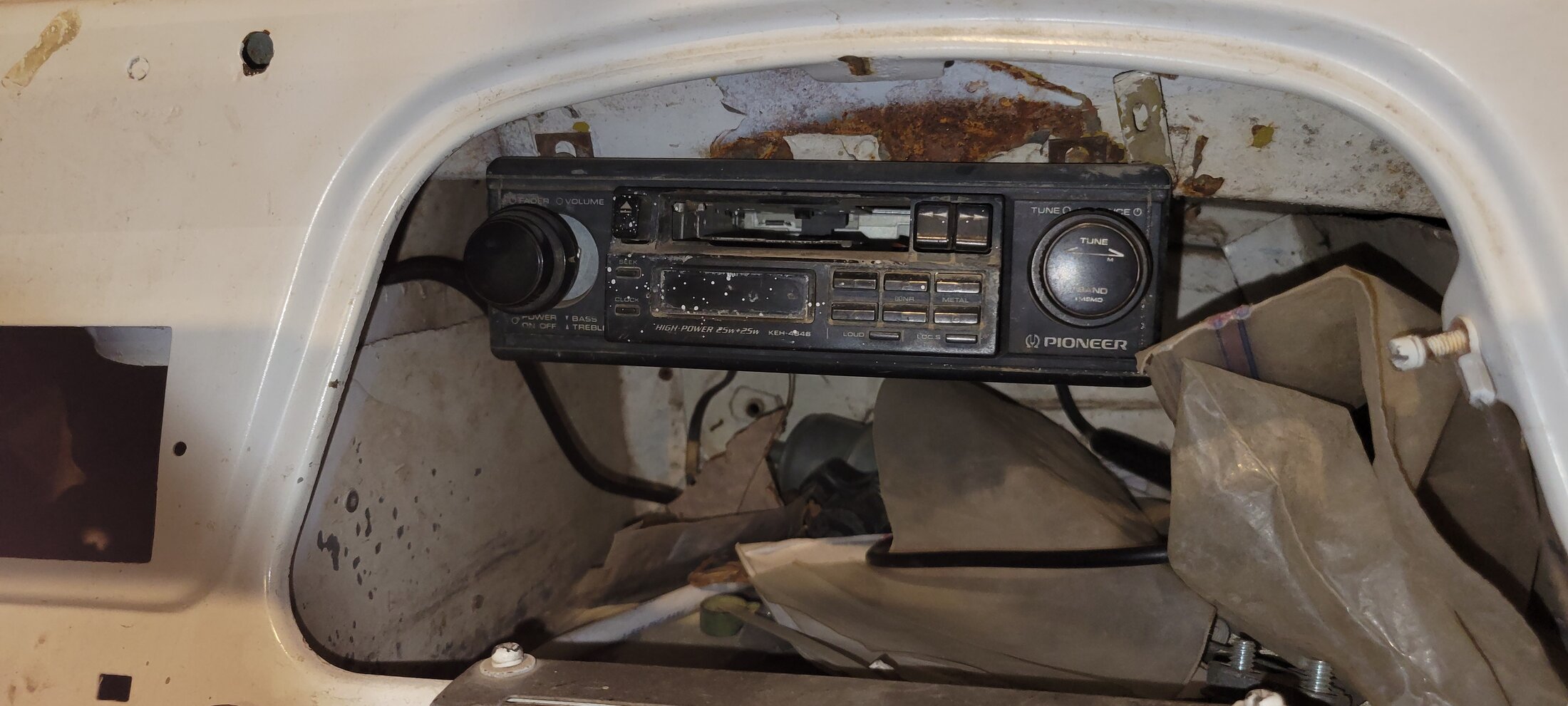

I hung mine in the glove box so I still had room on the floor of the pocket.
I don't see a pic (on my phone) but I'll look again when I get home. I may do that too. Something with voice command so I don't have to reach over and touch it to do or change anything.
You can tell by looking at the radio it was installed a long time ago. I know what all the knobs do without looking at it, which is good cause I can't see it while driving. It no longer lights up anyways.

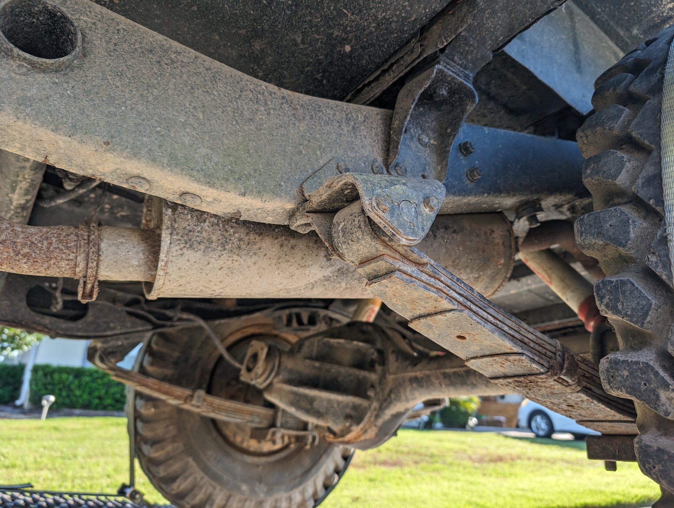

My FJ40 has FINALLY arrived! Some of you have asked how the underside looks, so I will attach pics of that. I'm pleasantly surprised, as it looks pretty good under there to me.

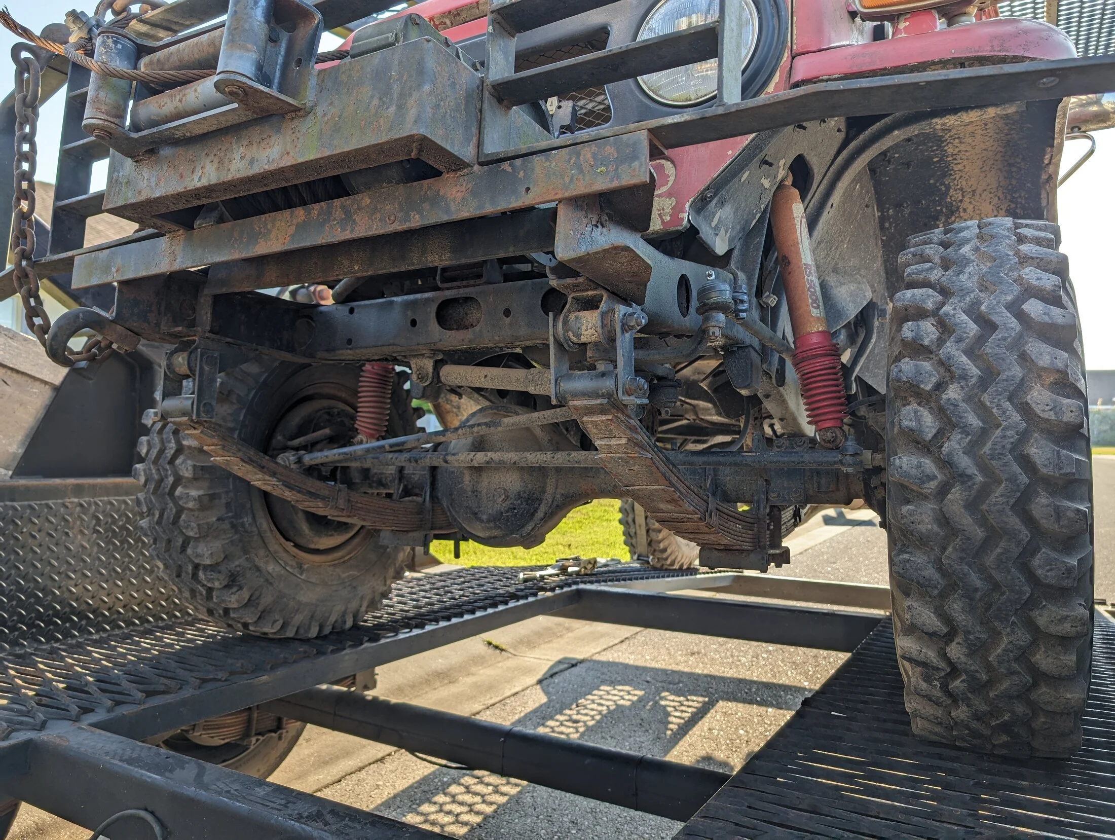

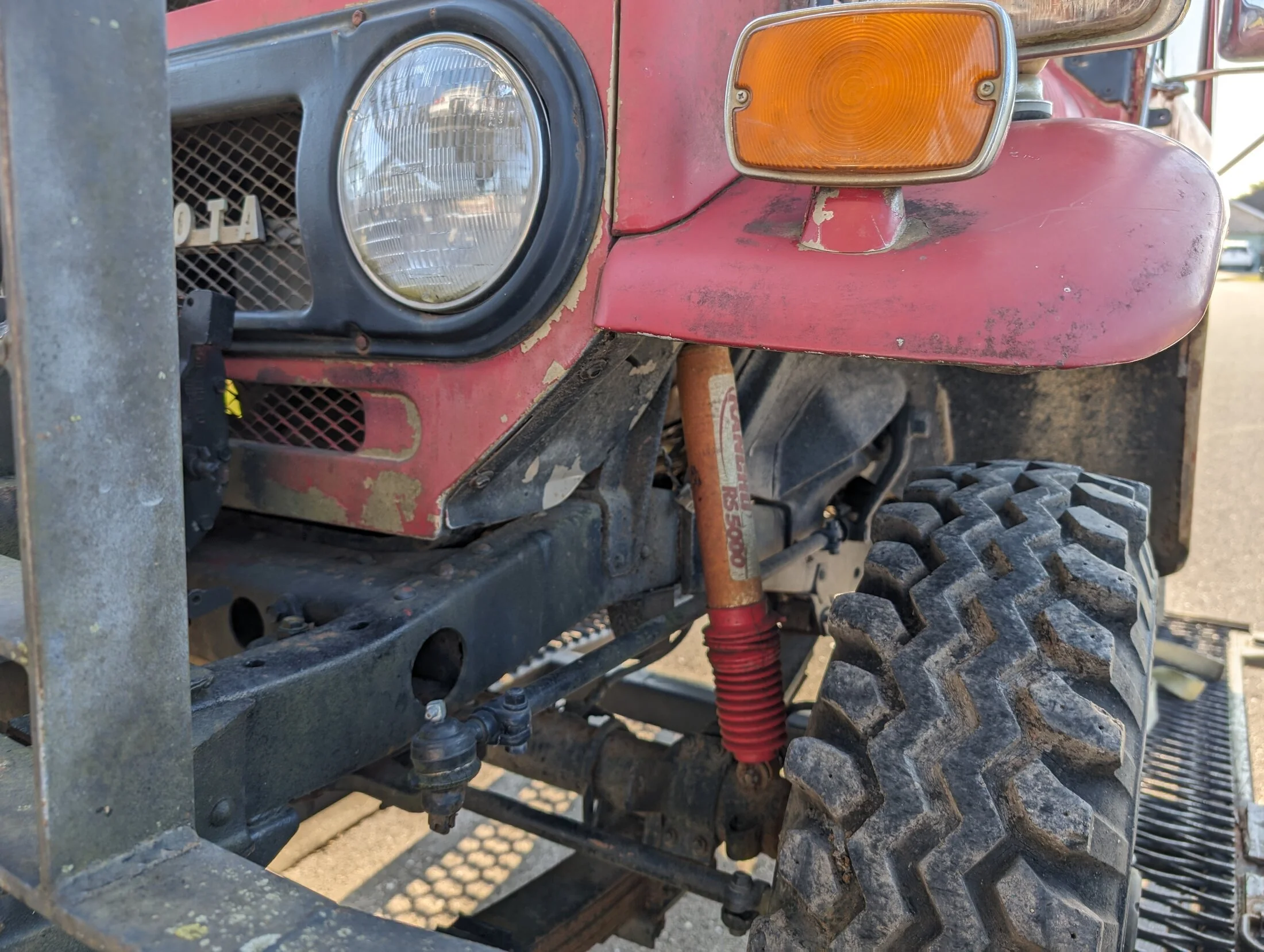

Looks darn good except all the stuff on the front & the fender lites. Front spring packs have 9 leafs, rears have 8, never came across a set of springs like that, they could be really good ?
Agreed! The giant cattle guard bumper is coming off and going to be replaced with a CCOT short HFS Winch bumper, and the lights on the fenders have got to go. It looks like the back is sitting lower right now, but that is because the engine is out of the front, and sitting in the back.
How many leafs did these FJ40's have originally in front and back?
And, can anyone tell me if those shackle lengths look to be the original length, or no?
Sticker on the back glass says "HFS Suspensions" so it may have some CCOT suspension part upgrades. That would be a nice surprise.
That is definitely a lift kit but looks like it will ride VERY stiff.
The shackles look to be oem , at least the front, can't see the rears. It looks to me like someone combined the stock leaf pack with an aftermarket, the stocl leafs have the more squared ends, the tapered ones are ?
Any guess on how much it is lifted? I want to be able to run some bigger tires, but especially with low back surgeries and both hips, I don't want to have to climb much to get in and out of it. I'm also not opposed to swapping out the leaf springs for something that would sit it a little higher than stock while also giving it a good quality ride. Do you sell those? By the way, I emailed your company email address again and never got an answer.
