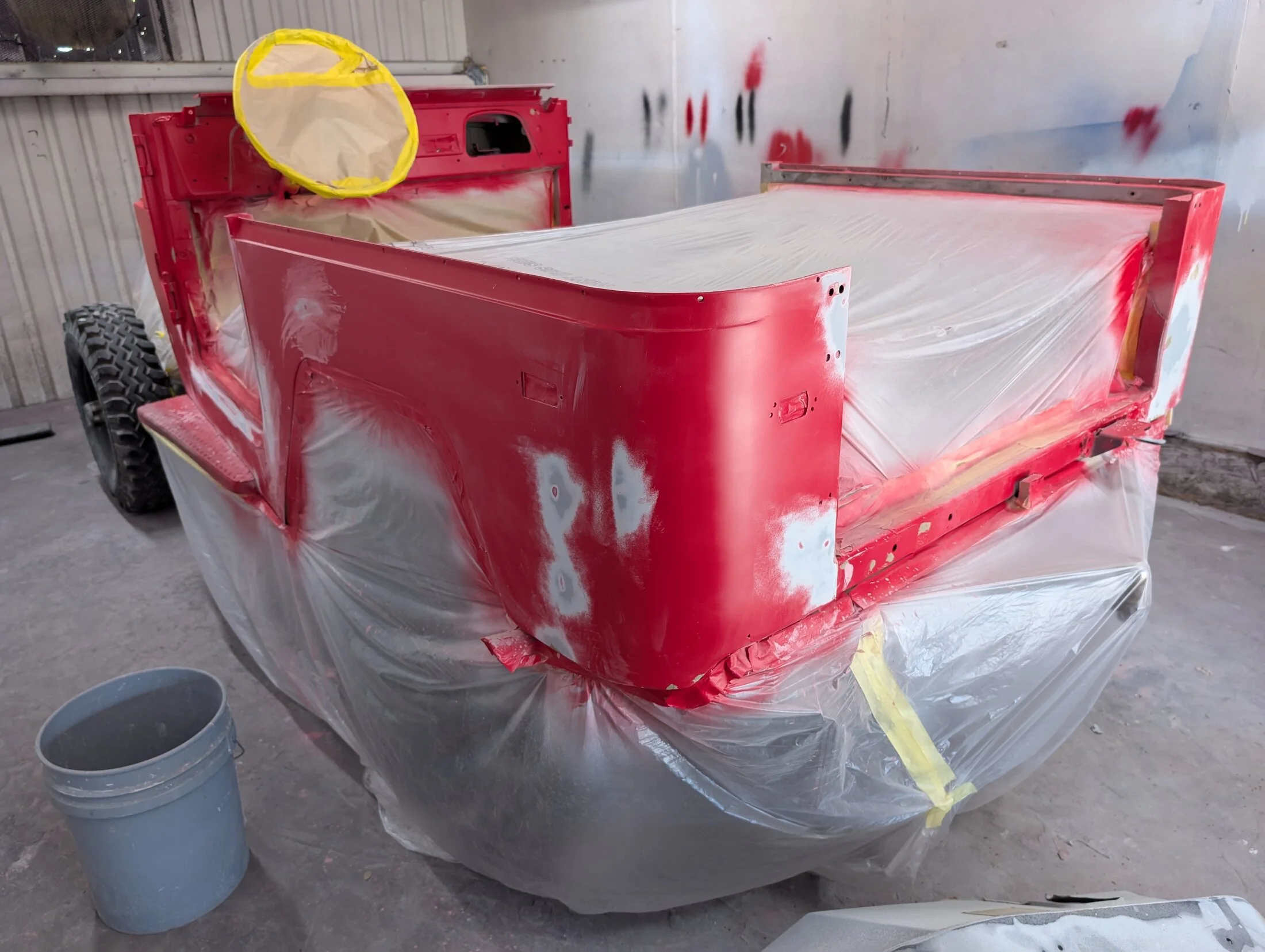

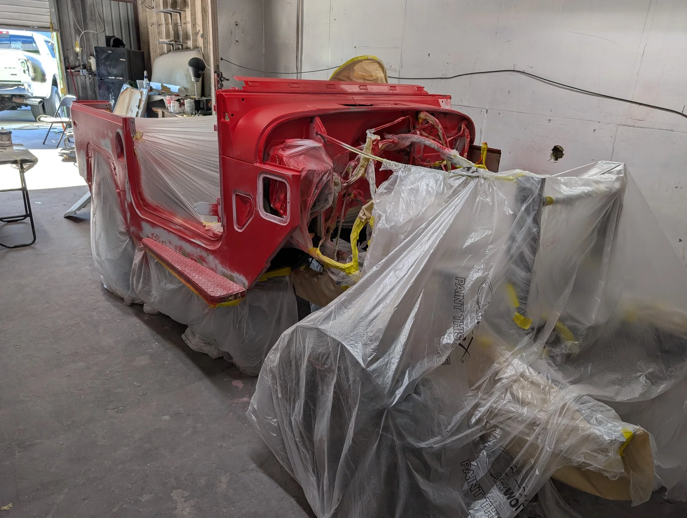

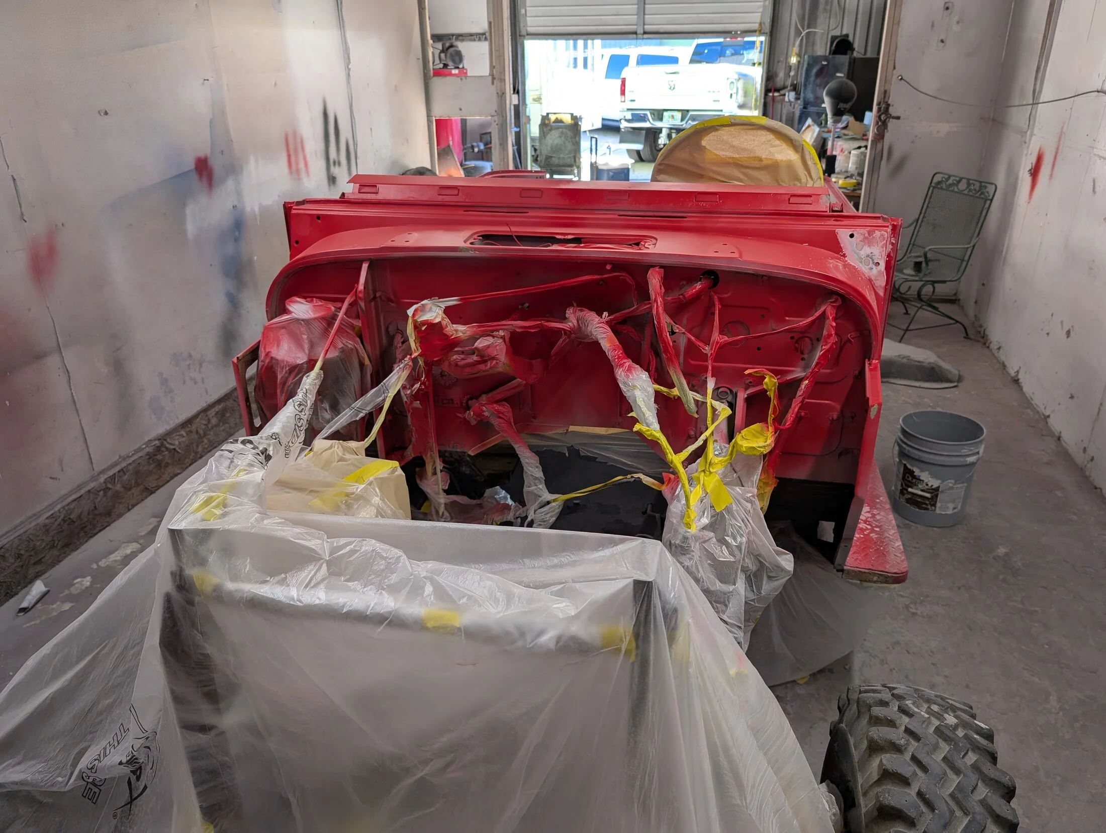

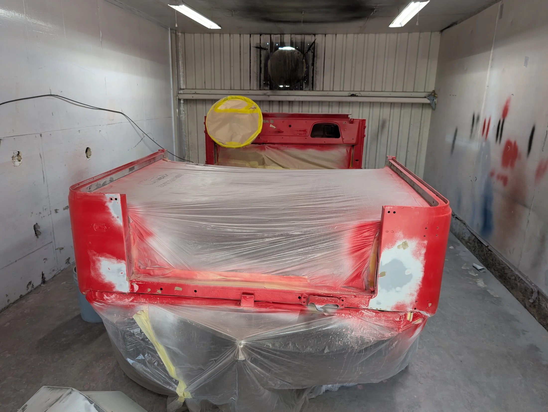

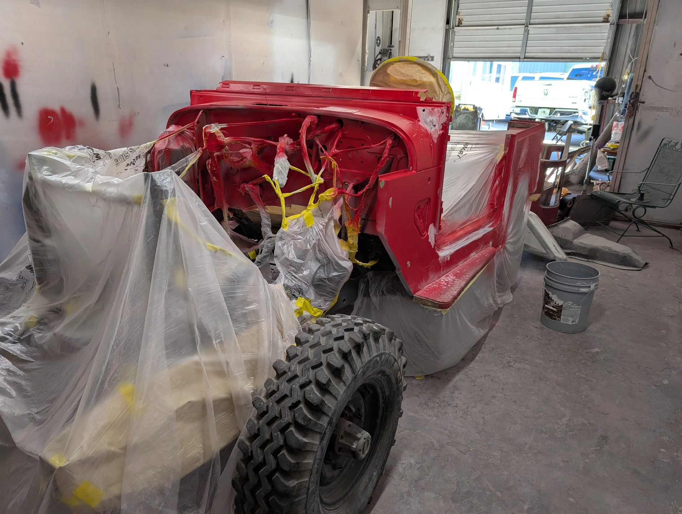

FINALLY getting paint on it:

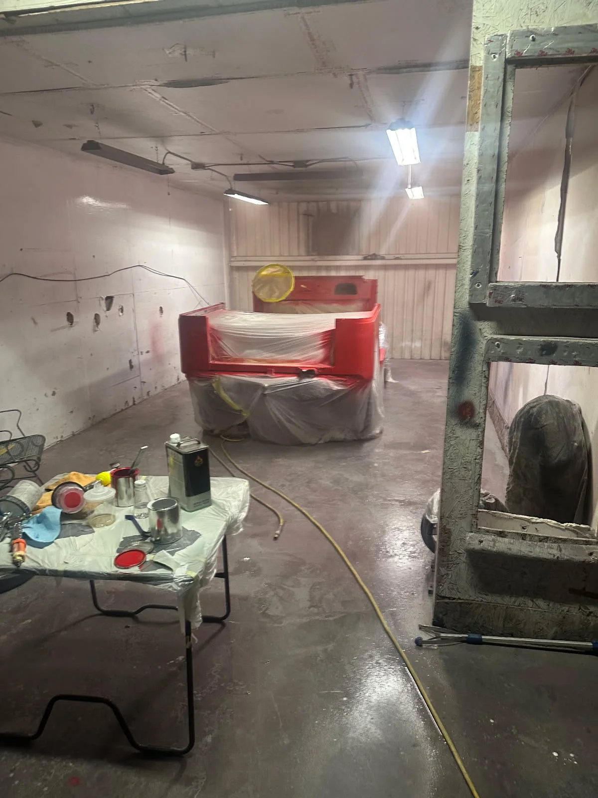

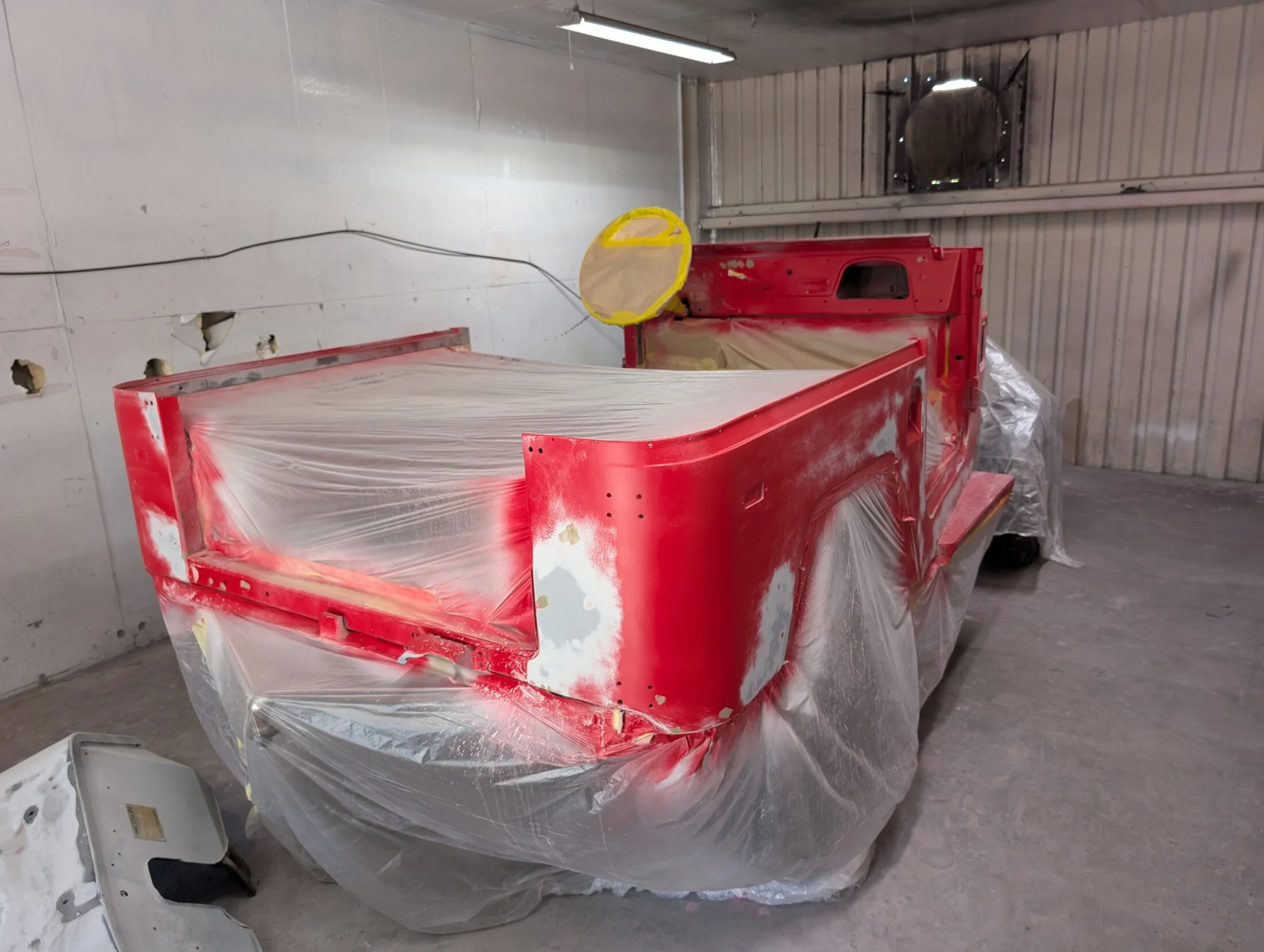

Finally making progress. This is not the actual Freeborn Red, it's just a red he put on to look for flaws and places that needed more work before spraying the Freeborn Red.

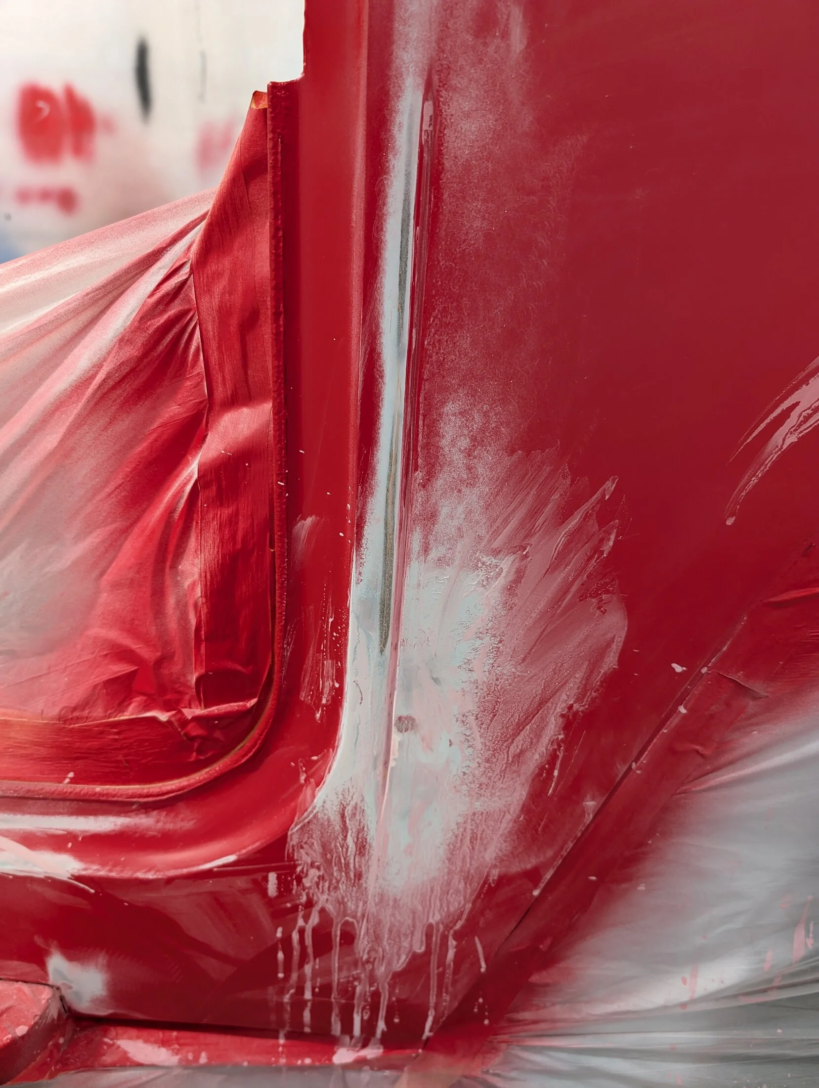

And I never realized there was this line, or indention just behind the driver and passenger door. Anyone know what it is for? Water runoff maybe?
Its a body seam 1/4 panel to B pillar/door opening, that typically extends to the bottom of the tub. There should be 1 where the door and frt cowl meet too.
