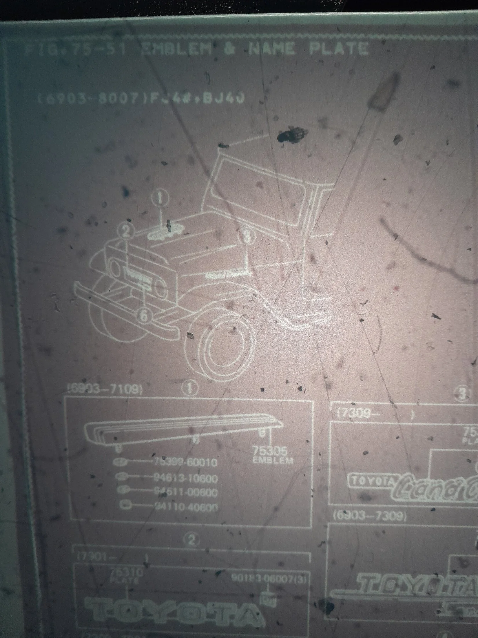

71s had it, 72s didnt..my mistake.
It's your truck, do as you please.
See this pic
I think split hoods had the spear.

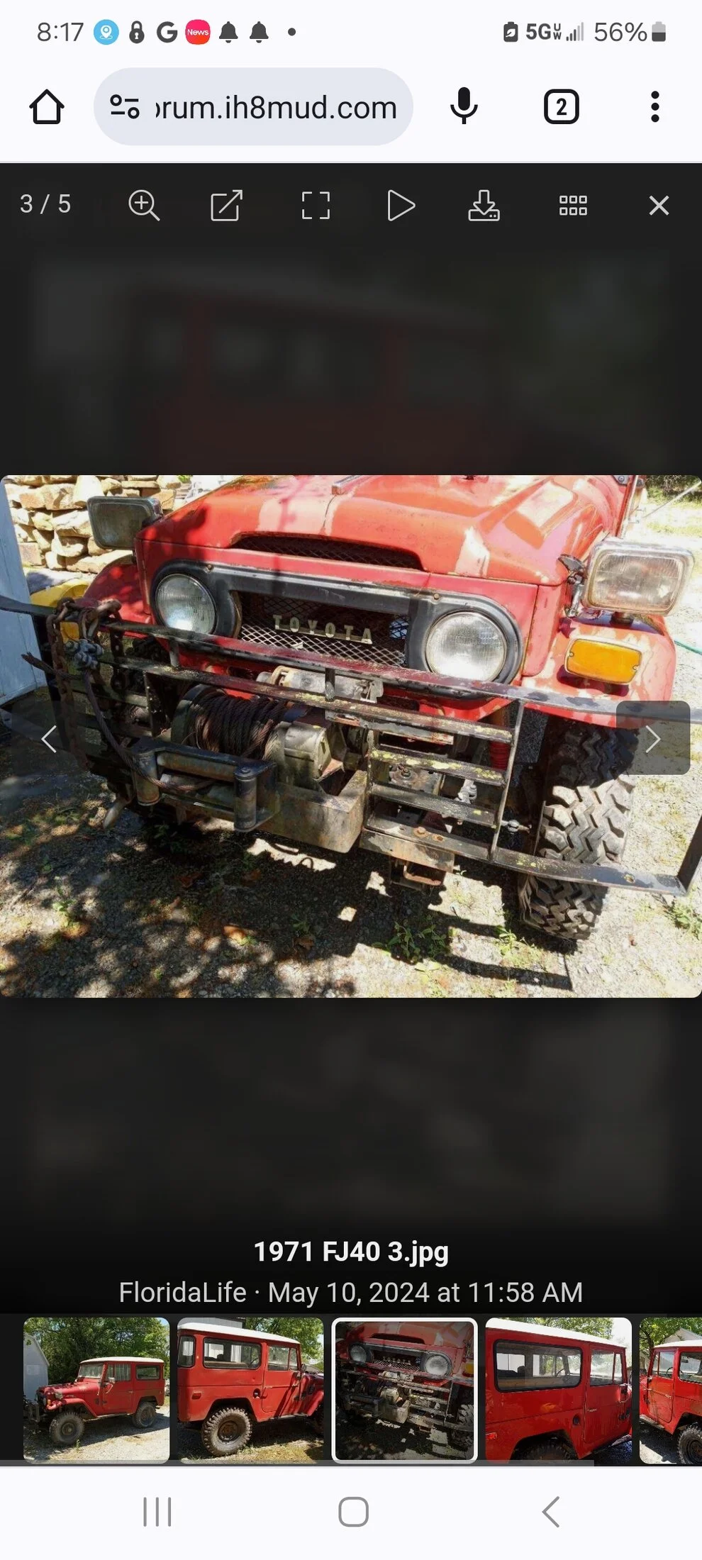

Your's looks like the correct hood for your year. Split is the seam down the center where the 2 pieces are mated together. Sometime late 71 for the 72 model year, the hoods are stamped as one piece.
The early split hoods did not have the rubber bumpers on the aprons; they just have some cusions on the front bib. Do your aprons have the bumbers or the holes for them? I think the prop rod is in a different spot also? Not 100% on that.
Do you not like the hood spear? Personally, I like it better than the later hoods. It's just the right amount of chrome haha.
In the 3rd Pic of your 1st post shows it has a split hood. Look at the seam going down the center. It's a 2 piece hood.
Interesting. I thought that was just a rusty line coming down from the mounting hardware for the chrome piece. Once it was sanded down I definitely did not see a split. I'll check with the paint & body guys.

As for hood spear, etc.; if there’s no seam on your hood, the paint shop filled the seam. My thoughts are that the hood is fairly flimsy on these and that seam being filled is going to quickly crack.
