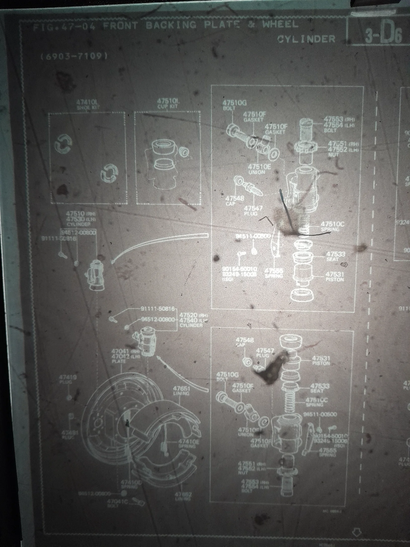

The brake cylinders all ( front and back an side to side) have different p/n's as shown. Note, the number shown for each wheel cylinder is a partial number only, and were correct as of Jan '81.
