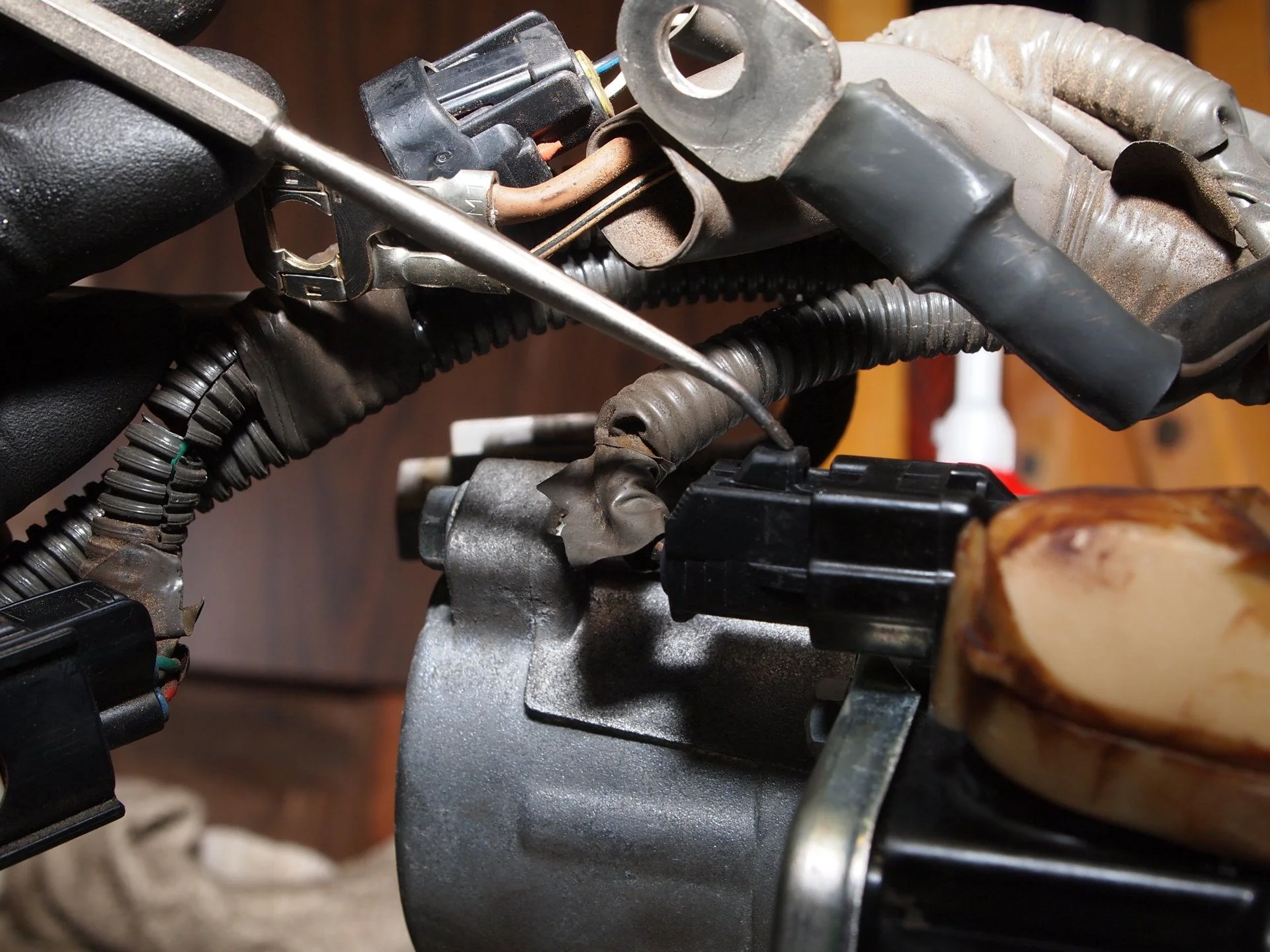

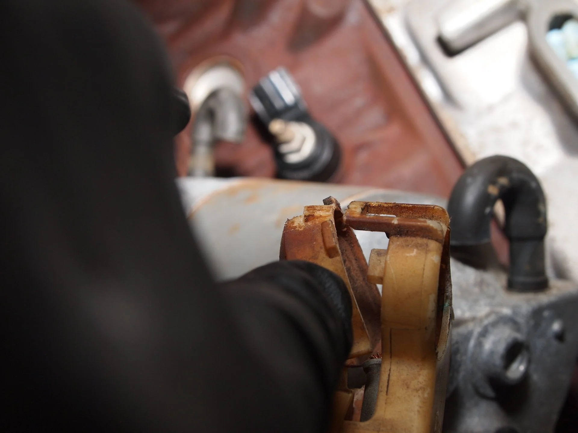

I replace a few wire housing & hose getting at starter to install wire harness (needed to swap): main hose from water bypass to A.I. switch, water bypass pipe to water pump O-ring and water bypass rear gaskets.
By looking at first two picture you can see how starter wire(s) are released. This is hard to see when leaning over fender to do a starter job. I also found three different ways to pull starter. Easiest is to pull rear water by-pass and A.I. stuff as one unit then starter.

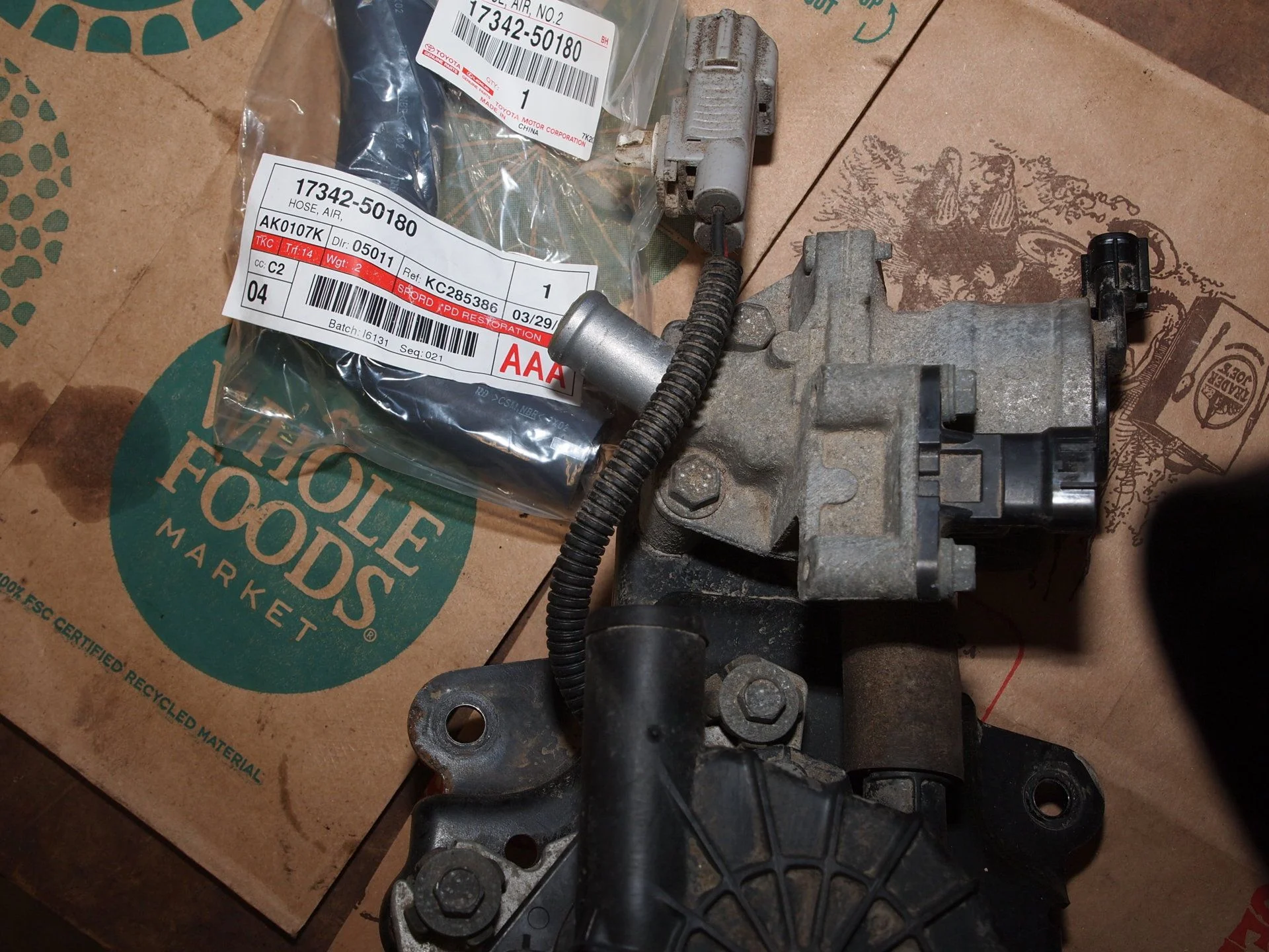

View attachment 1680251 View attachment 1680252

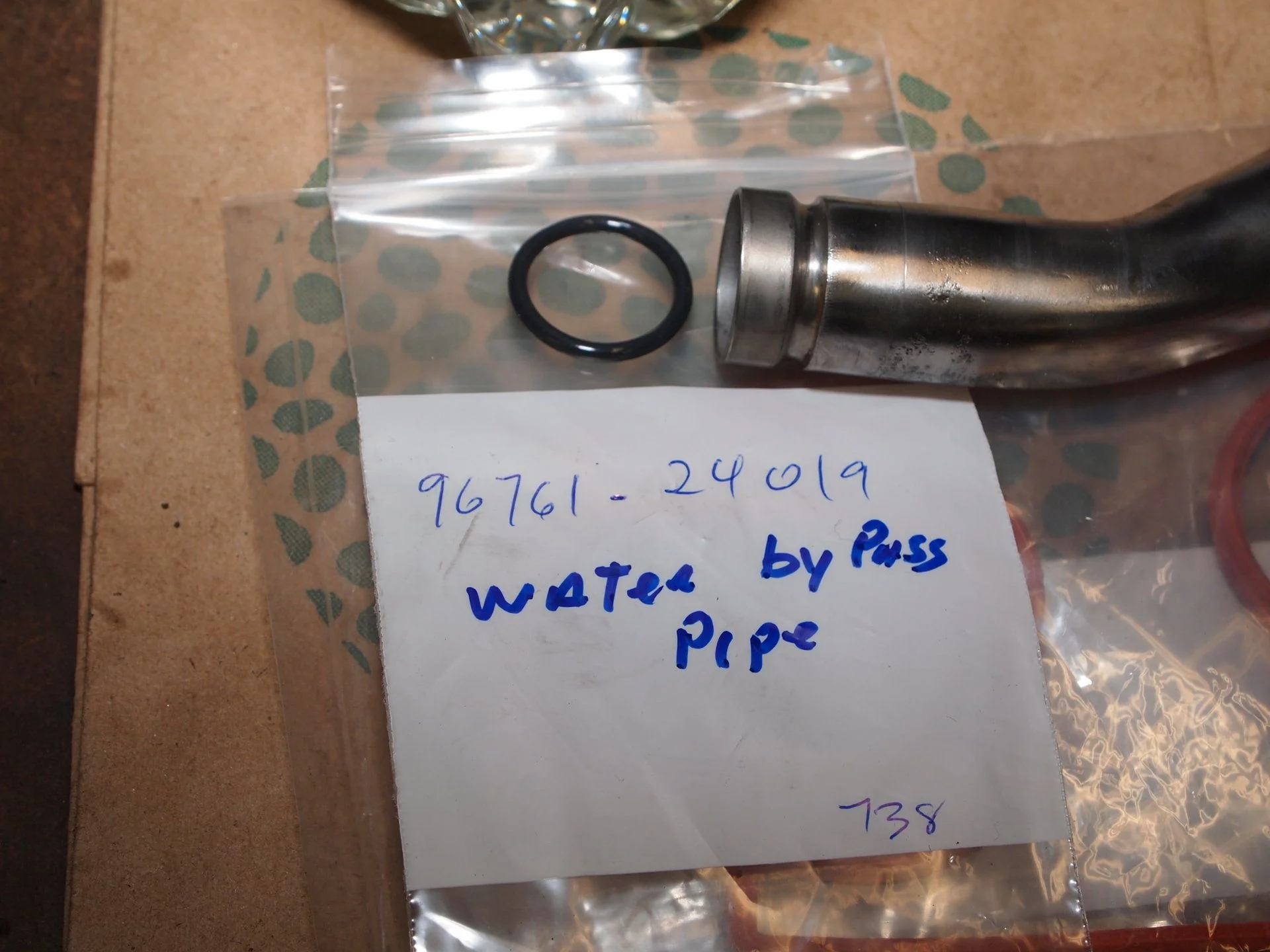

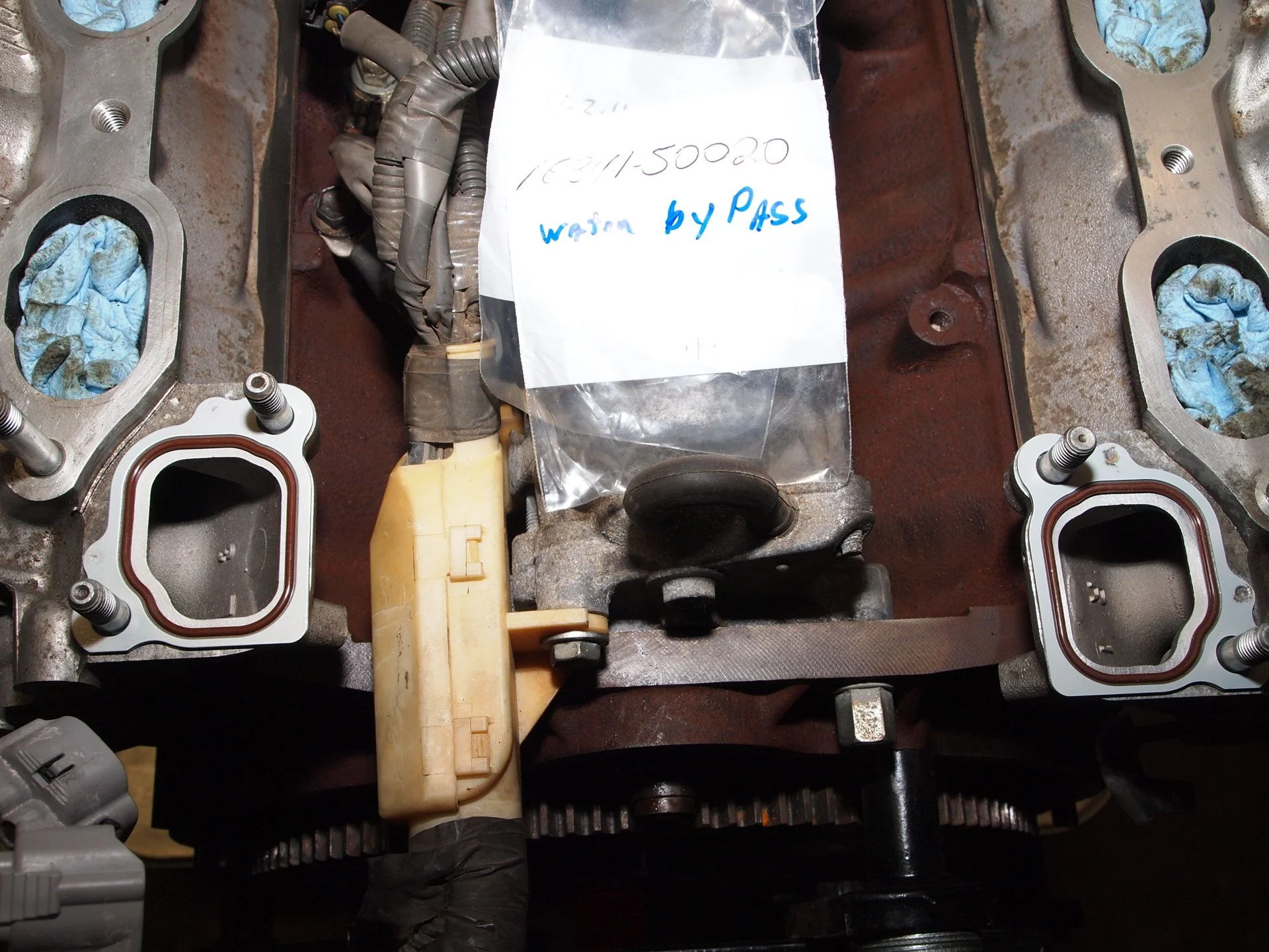

View attachment 1680253 Water by-pass gaskets PN # 16341-50020 GASKET (WATER BY-PASS JOINT, REAR & front (2 each))
View attachment 1680254 I use Dawn dish soapy water to lubricate O-ring for easy install into water pump, just as FSM recommends. Interesting the mechanic in WI Toyota Dealership used some sort of grease (presumably coolant and O ring safe) here and on larger water inlet to pump O-ring. In a rust belt state, this would make removal easier years from now of the water inlet. I like that, not like some of the idiots that use FIPG as a lube (I hate that). Those using FIPG on seals (bad) are likely using the 102 or 103 FIPG that is for oil not coolant. When only Toyota FIPG 1282B should ever be used on coolant application, but even that should not be used on O-rings.

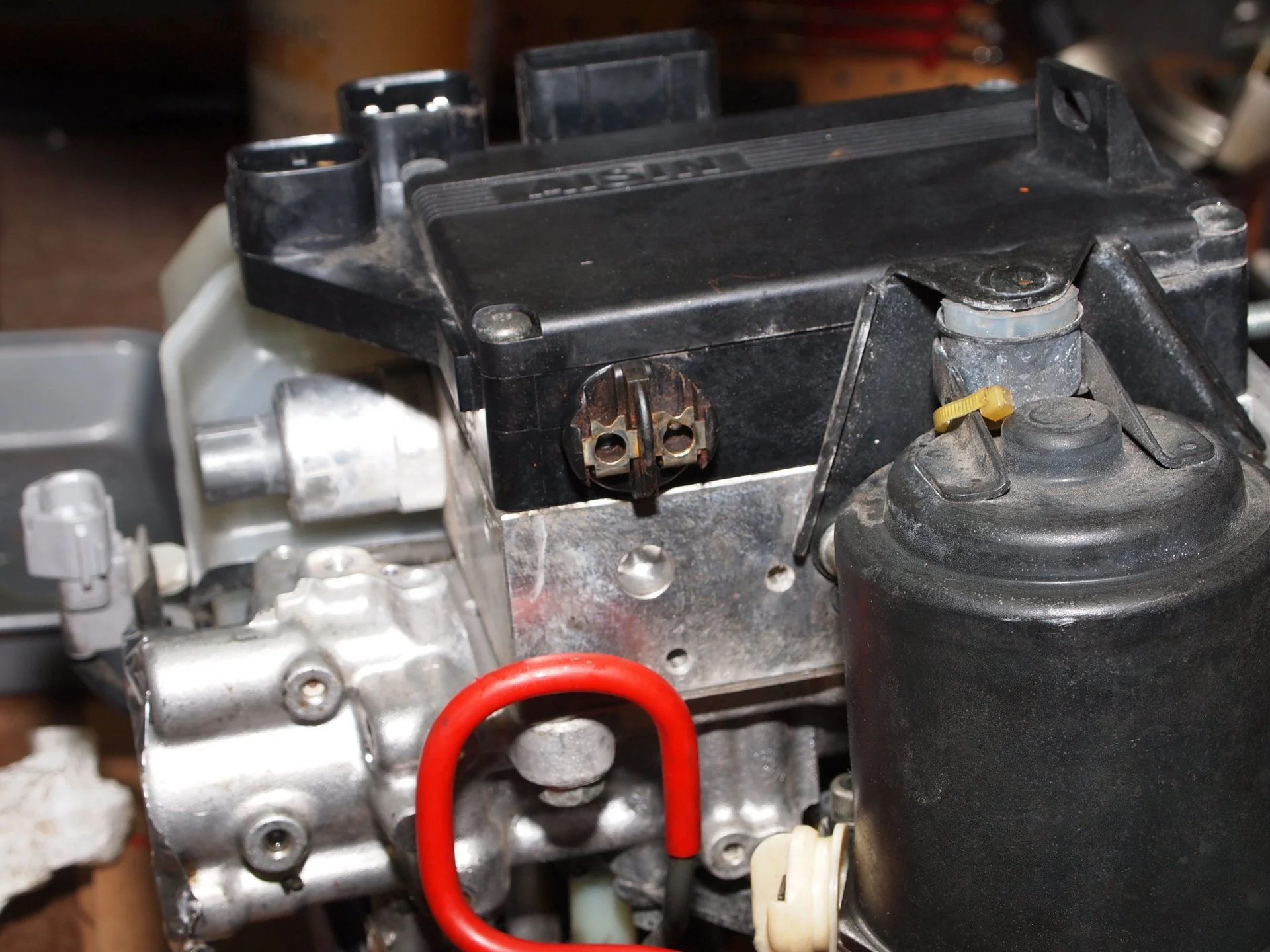

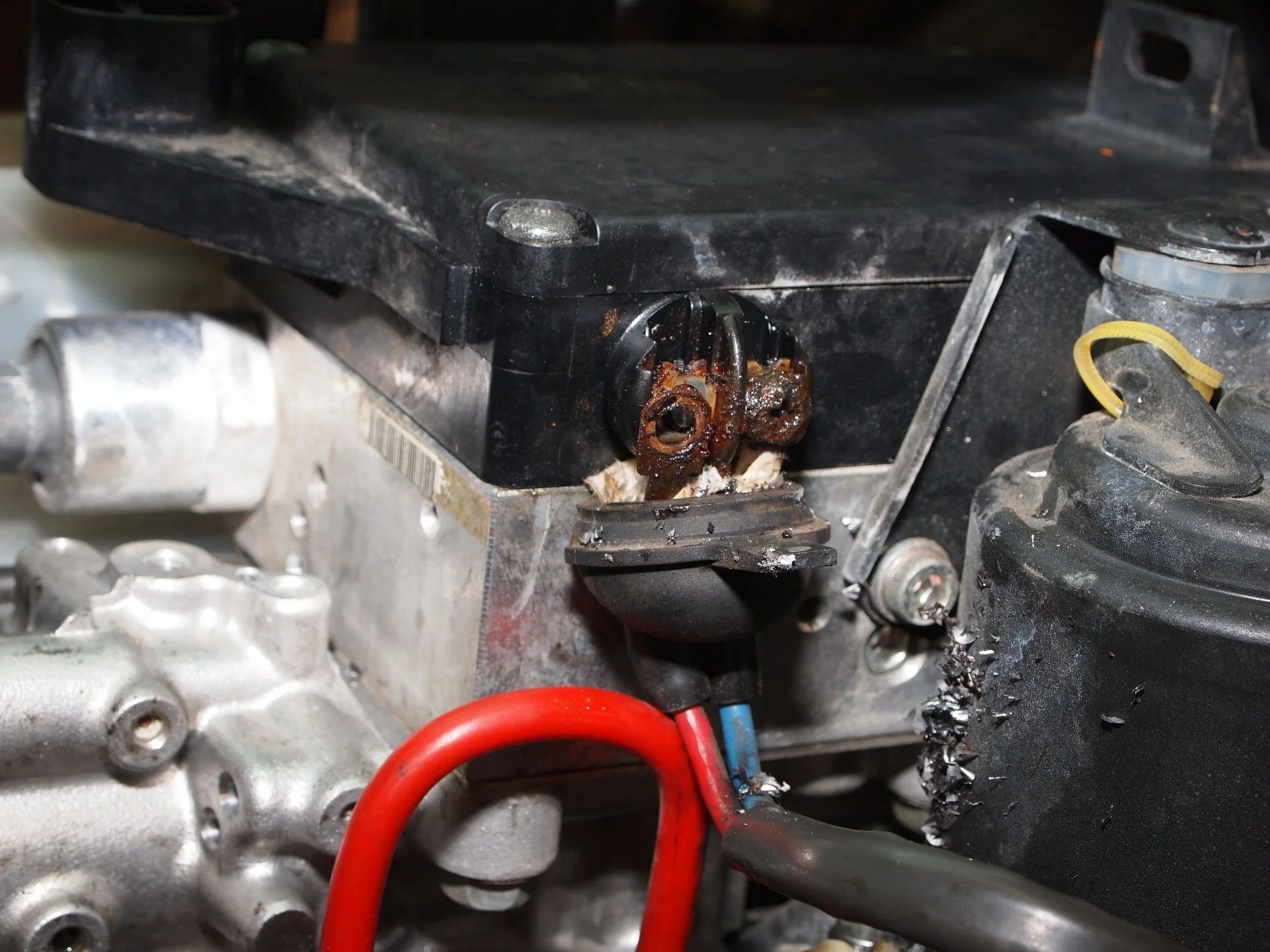

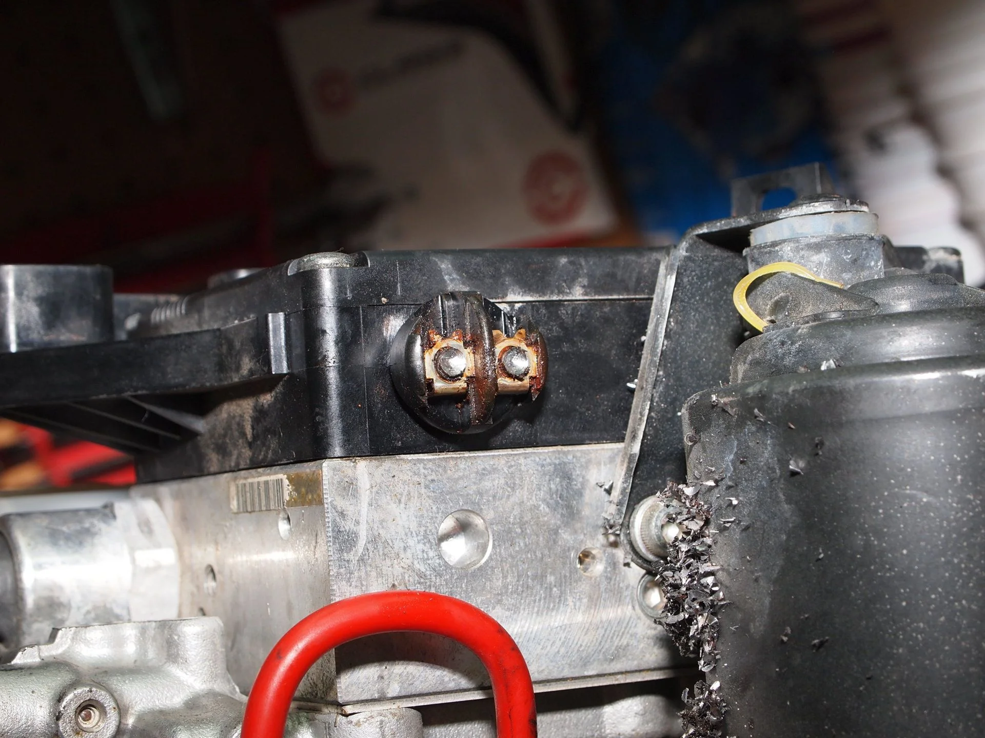

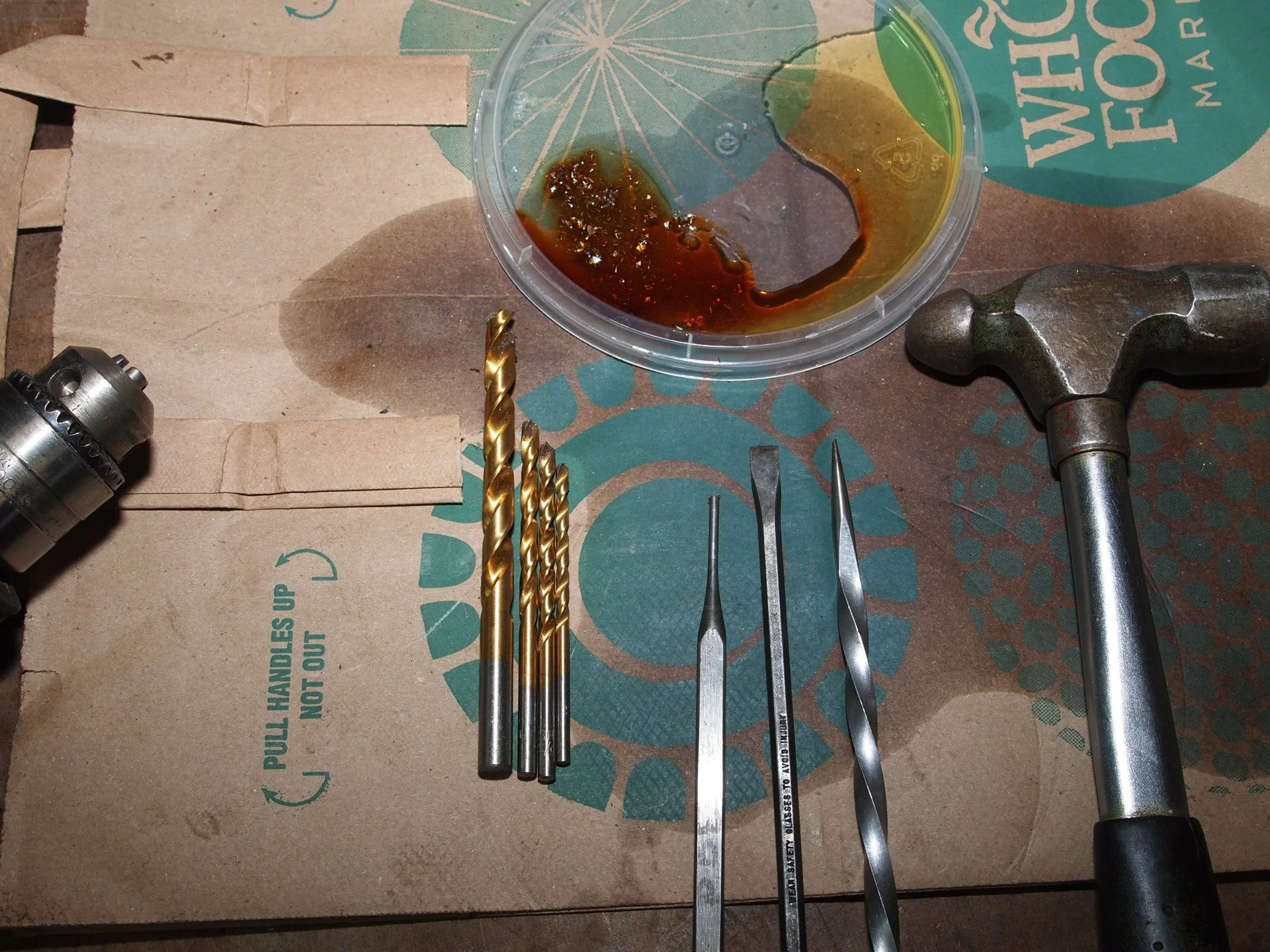

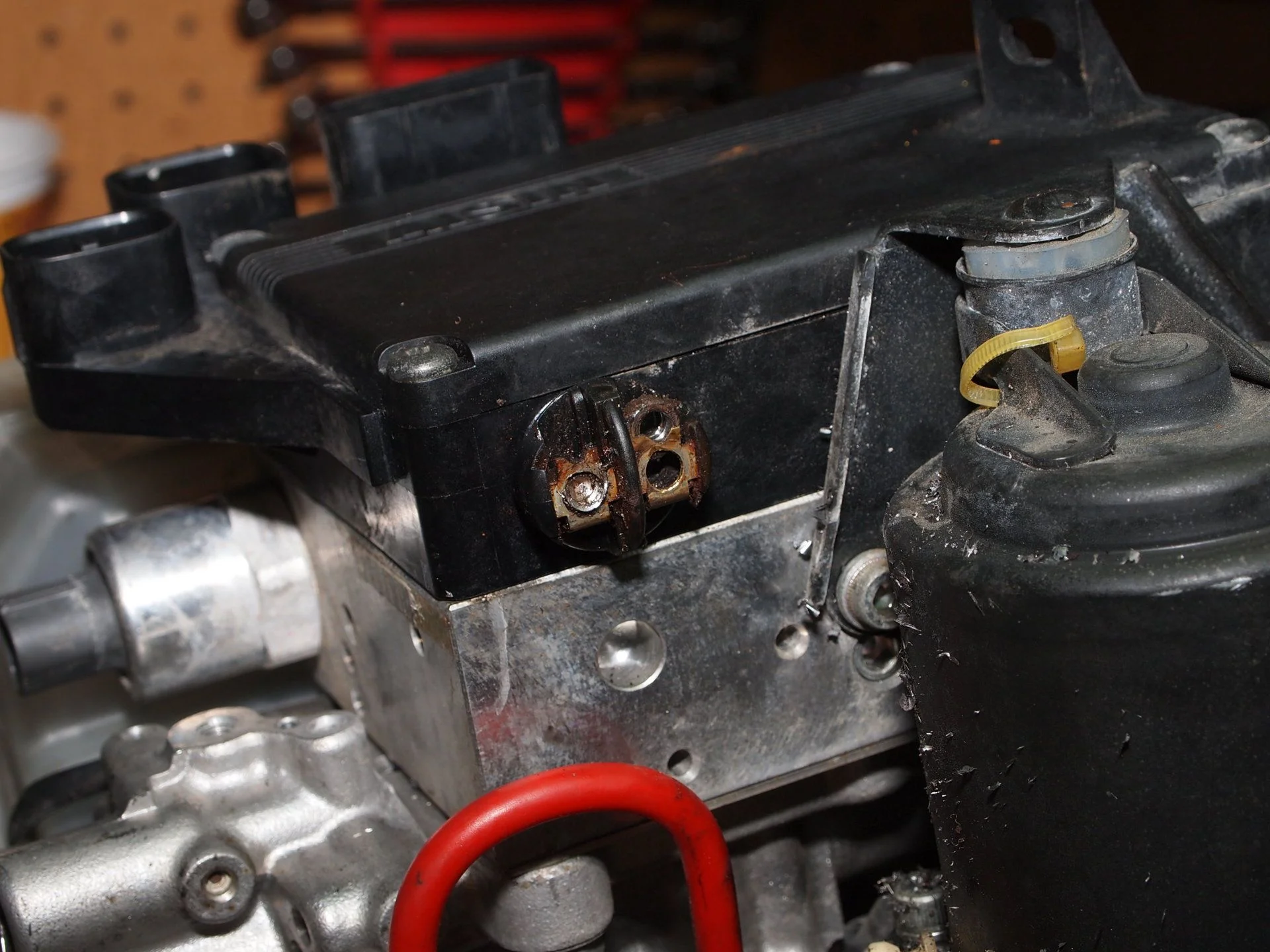

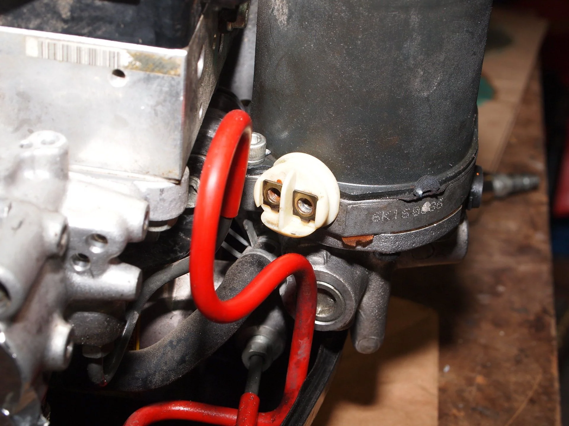

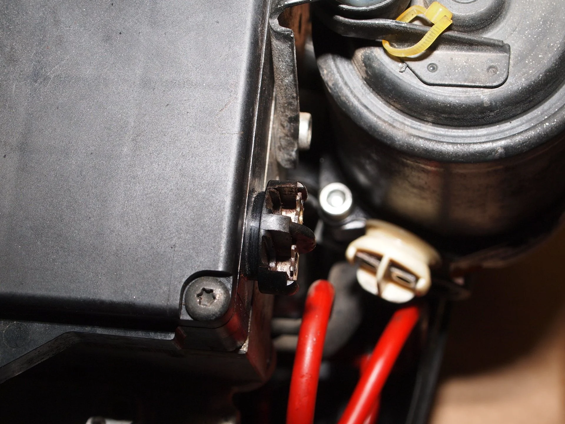

Did the screws twist out with vice grips once you drilled the heads off?
No!
Starting with good sharp small drill bit, then working my way up in drill bit size. I drilling off heads of screws so wire can be removed. This is first step in the process.
I then keep drilling until near nothing left of screw at contact plate.
Them used my cold chisels to gently tap the nut out from under contact plate.
The trick is to not damage plastic in any way, and remove little to no amount of metal from the contact plate.
Then clean, grease with dialectic and install new OEM nuts and screws. Factory also recommends new wires.
