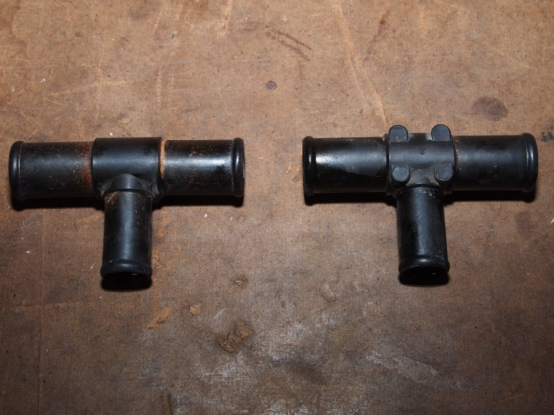

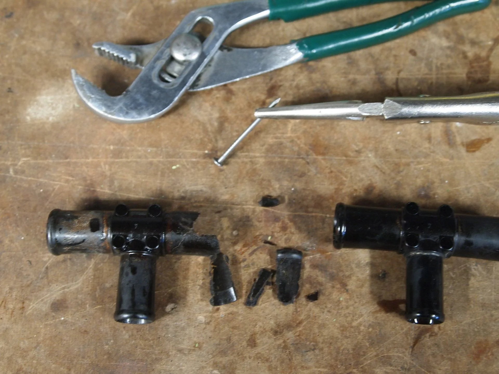

My thinking was, maybe something else happened, that then resulted in Tee's being damages. I mean, really they aren't that old.
But then I replaced The Black Knights (06LC) w/59K on them. Now I'm thinking either the Toyota SLL pink coolant is harder on plastic Tee's or the plastic is not as good as seen in the older systems that use Toyota LL red. Also the return side on the 07 Unicorn looked very aged also, more than I'd expect or seeing at 10 years.
A second possibilities as to cause:
Possible when Dealer did coolant flush 20k miles and one year earlier they didn't burp properly (air in system). Then PO drove, what was likely HWY miles, on low coolant. It could have been running hot for sometime taken out the heater tees then head gasket or visa versa. "Chicken or the Egg story"

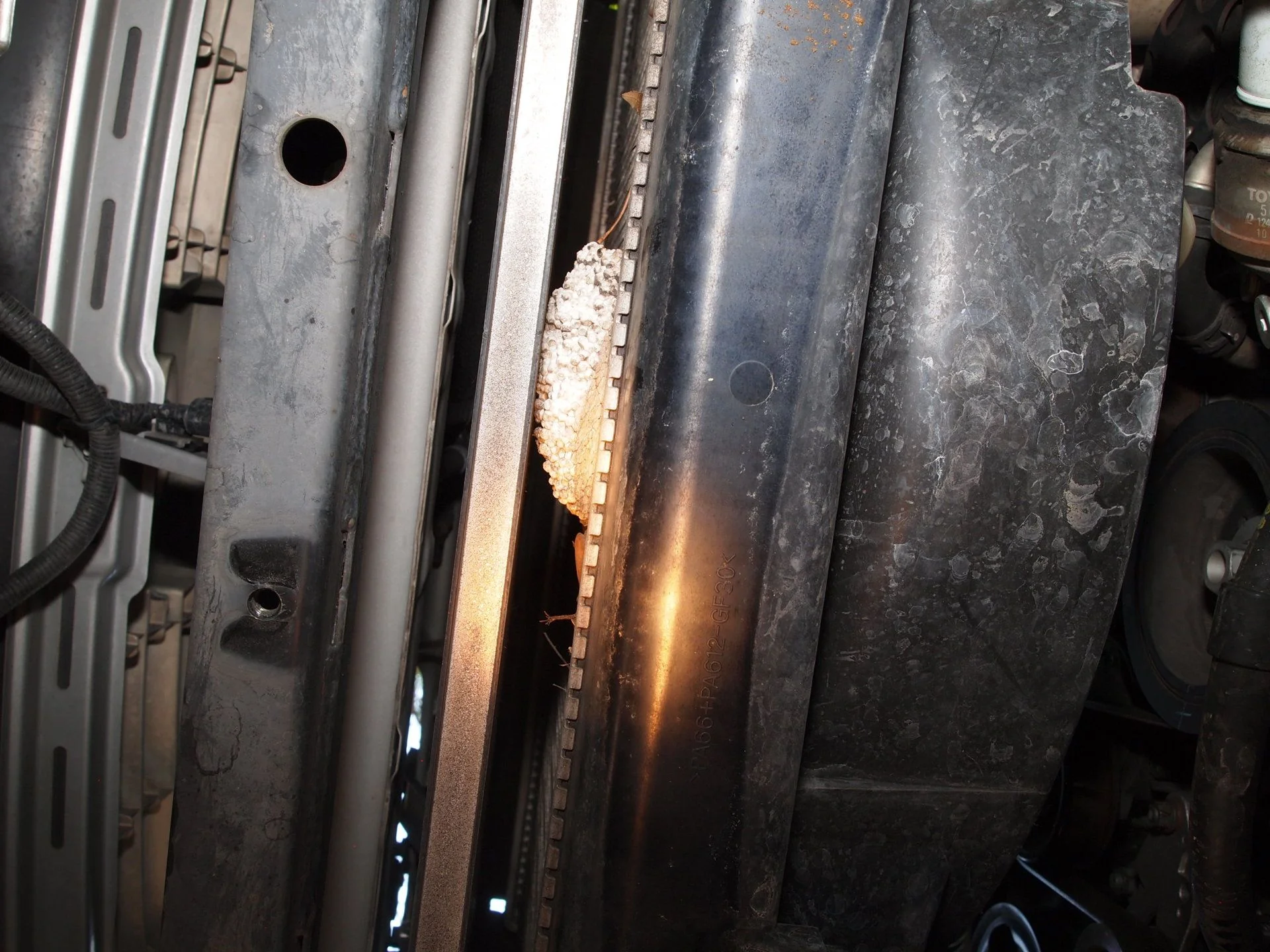

Additionally I found debris which included some styrofoam, on front of radiator and a shadow line indicating possible air flow blockage of lower ~25% of radiator cooling fins.
Clues :hmm: I've a few more it was running hot for some time.
So I can not say heater tee's was the start of the issue.
But I'm reasonably sure overheating took out the head gaskets.

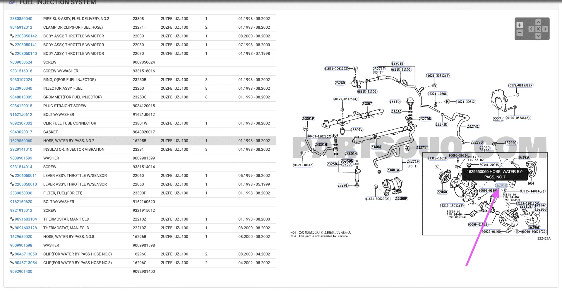

Can you please help me confirm the parts number?
It is the hose that I highlighted in red. It connects the coolant to front of the engine. I think it is coolant hose because it is slowly leaking coolant need to get it swapped?
Is this the correct part number? 15777-50030? The part looks skinny and does not come with the heat foam sleeve.
@ghong14 I've taken the advise from others on this forum and look up part numbers specific to my vehicle (LX) and year ('99) on Partsouq.com. I highly recommend you do the same since parts can vary by year and model. I found that hose part number for my truck HERE and can be assured it fits. Partsouq is also great because you can see related parts you may want to order as well, like the hose clips.
I have no idea if this is the correct part number for your truck, but if you put in the little bit of work to lookup by your vehicle, you'll save yourself a huge potential headache and time. Hope this helps.
This is awesome! exactly what I needed!
