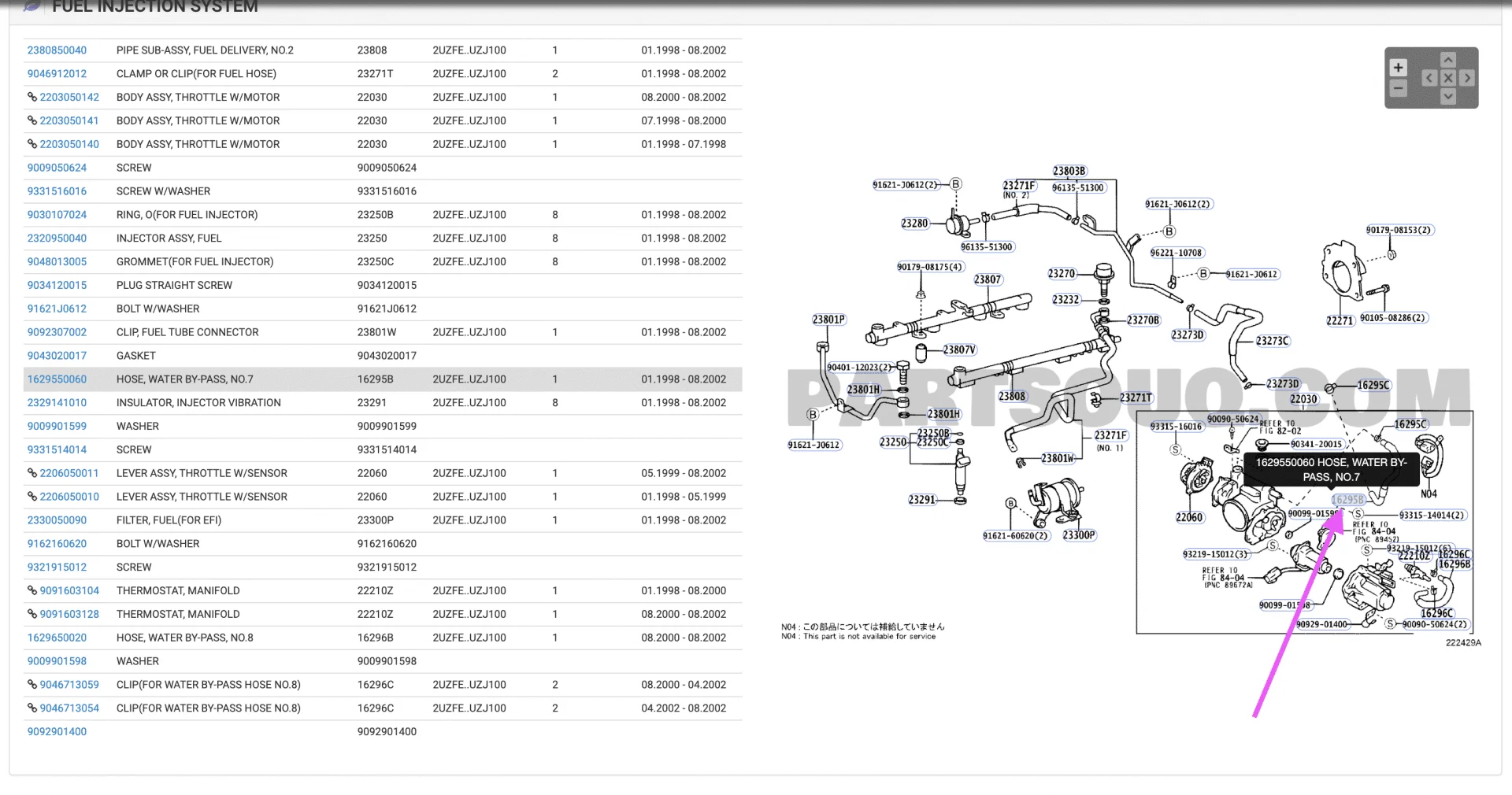

@ghong14 I've taken the advise from others on this forum and look up part numbers specific to my vehicle (LX) and year ('99) on Partsouq.com. I highly recommend you do the same since parts can vary by year and model. I found that hose part number for my truck HERE and can be assured it fits. Partsouq is also great because you can see related parts you may want to order as well, like the hose clips.
I have no idea if this is the correct part number for your truck, but if you put in the little bit of work to lookup by your vehicle, you'll save yourself a huge potential headache and time. Hope this helps.

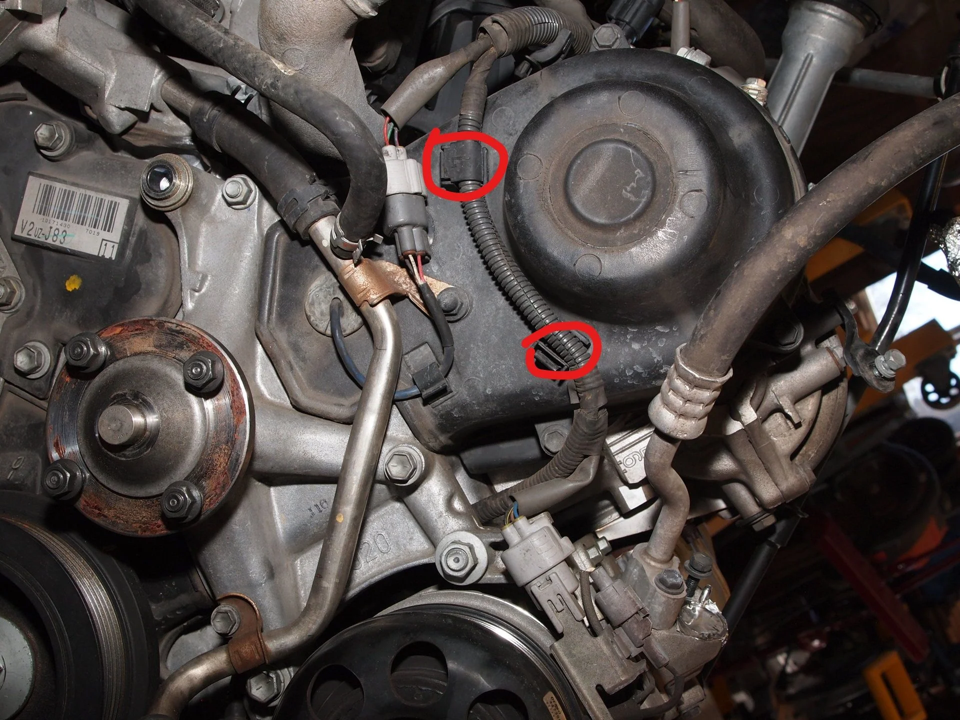

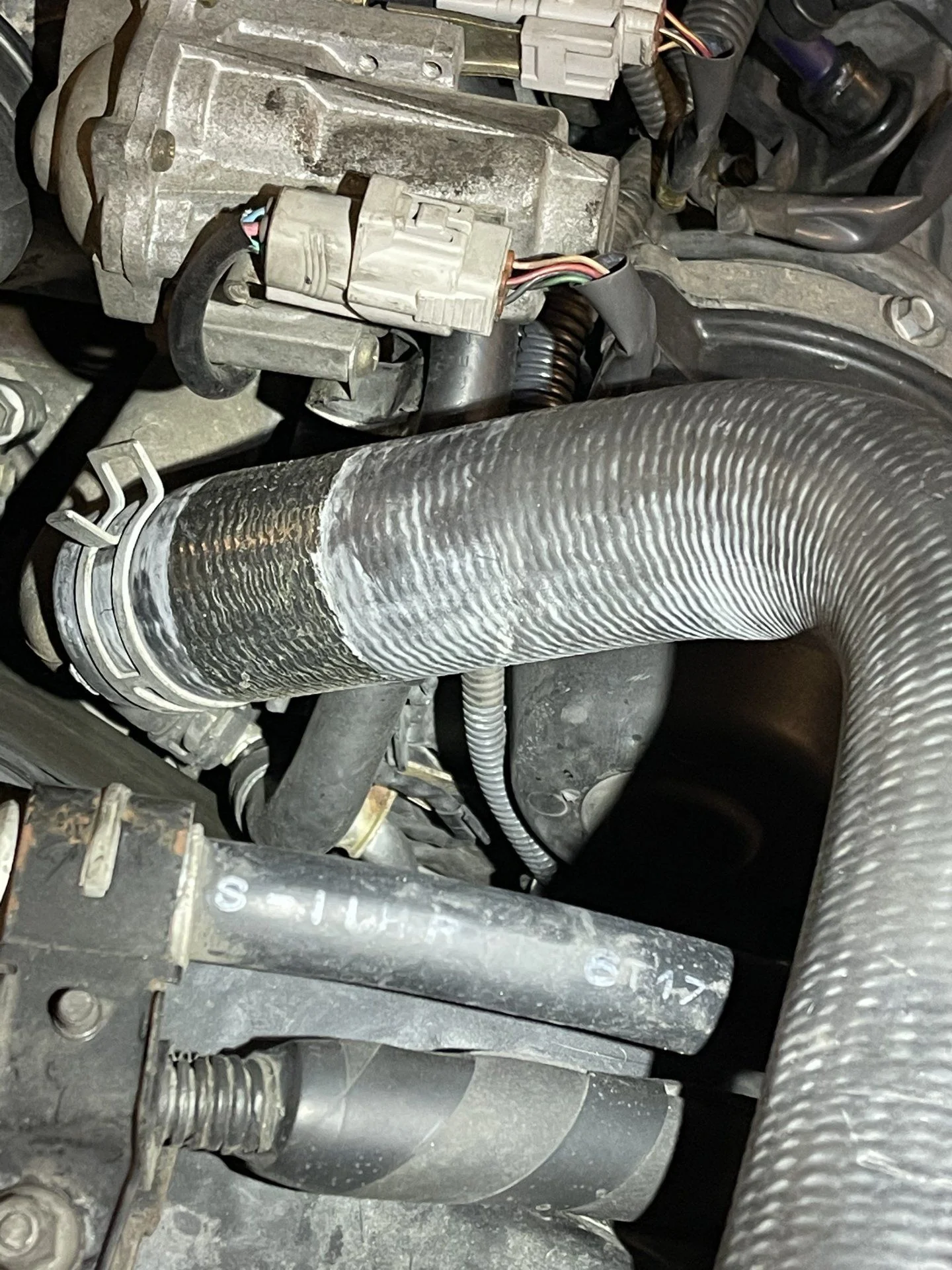

Hi @neilsen100 and @2001LC

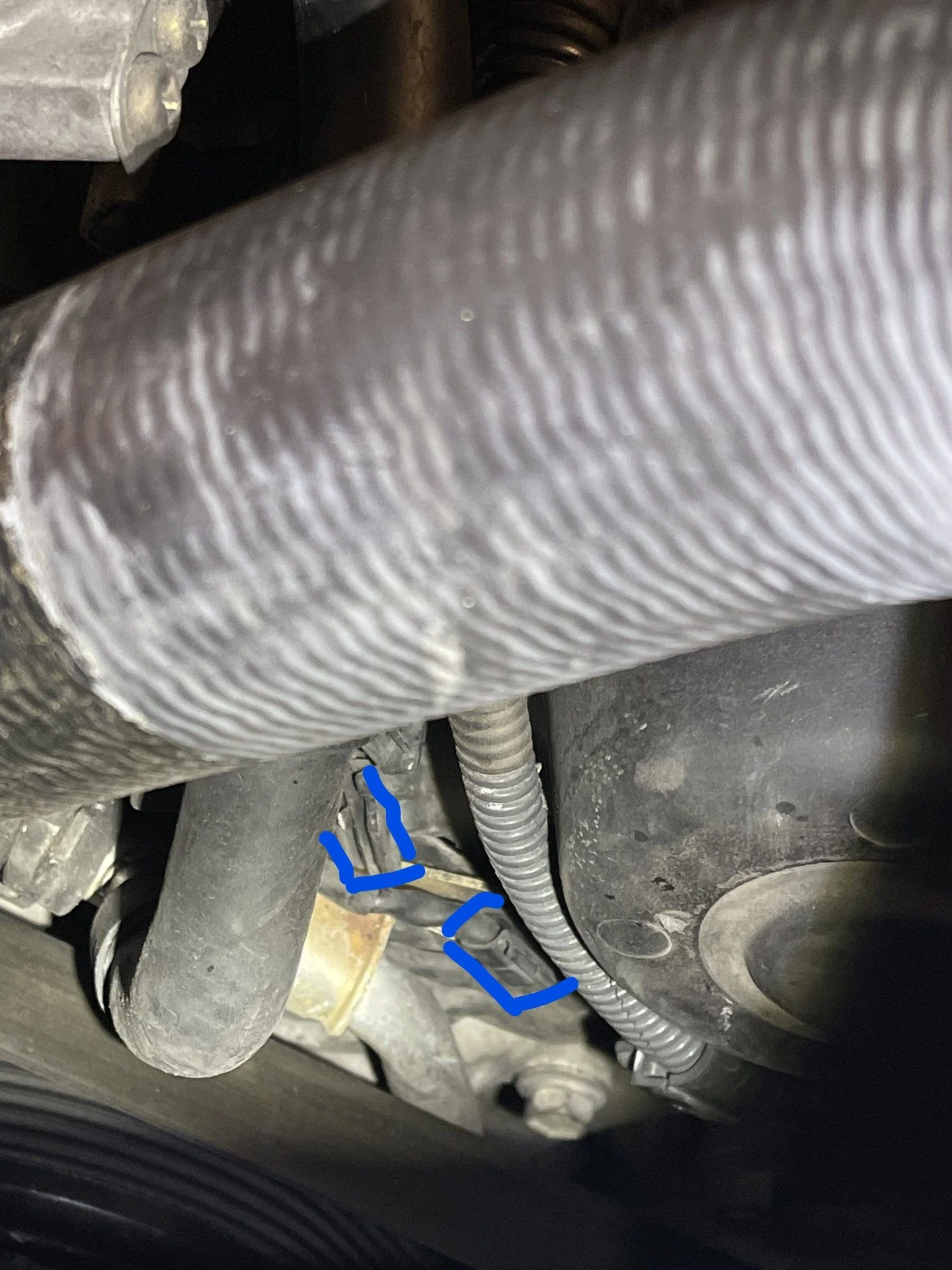

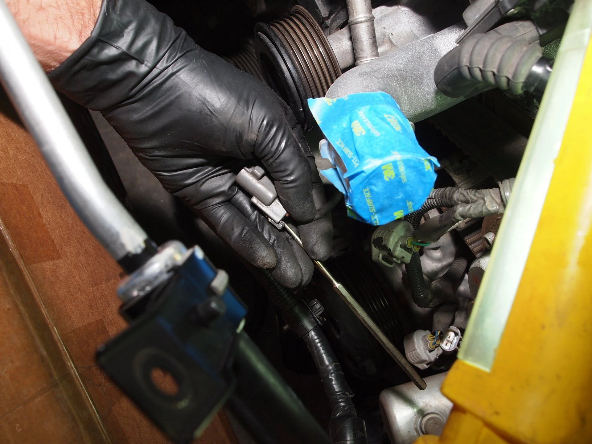

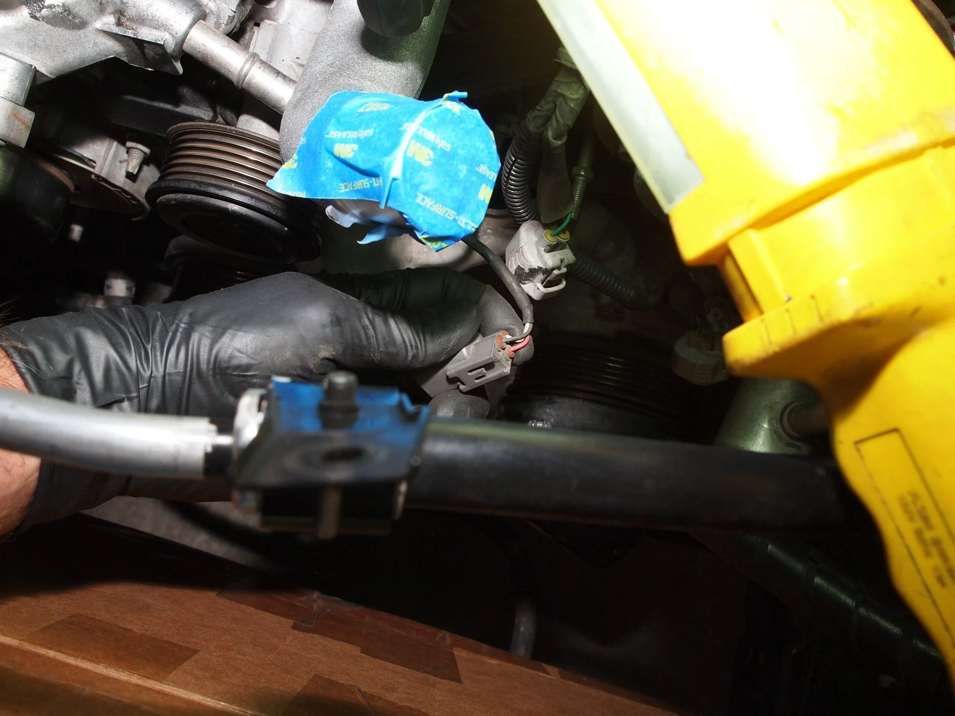

Was wondering if I could get your help on looking at 2 more part numbers. I was changing the hose you pointed out when I saw 2 electrical wire clips were broken. I tried to find it in the site you provided but had no luck. Would really appreciate your help!
There seems to be 3 clips holding the black electrical wire (scroll to 2nd picture):
You can see only one small clip remains. The other is broken. Both are highlighted in BLUE.
PS is the following a part of the main engine housing?
Not really a thread for asking about PN#'s,
I just now took the time too looked through pictures of first 4 or 5 pages. Found something that may help you "see" what you're looking at..
The CAM senor CLAMP WIRING block housing bracket, is available. When you have a better understand, of what you're looking at. You may find! your Wire housing block, which I kind of see it in your blurry pictures. May just need block hanging on it..
Good luck finding any of the harness brackets! This is 03-05.
View attachment 2621981View attachment 2621960
Exactly what I am looking for. I guess this is what you hand the gray electric connect on.
By the way the 2 other black clips that are on the right of that clip looks like the top clip is snapped on yours. Do you happen to know the part for that? PS great idea with the zip tie I thing I might do that too since one of mine is snapped as well. The other clip is completely loose

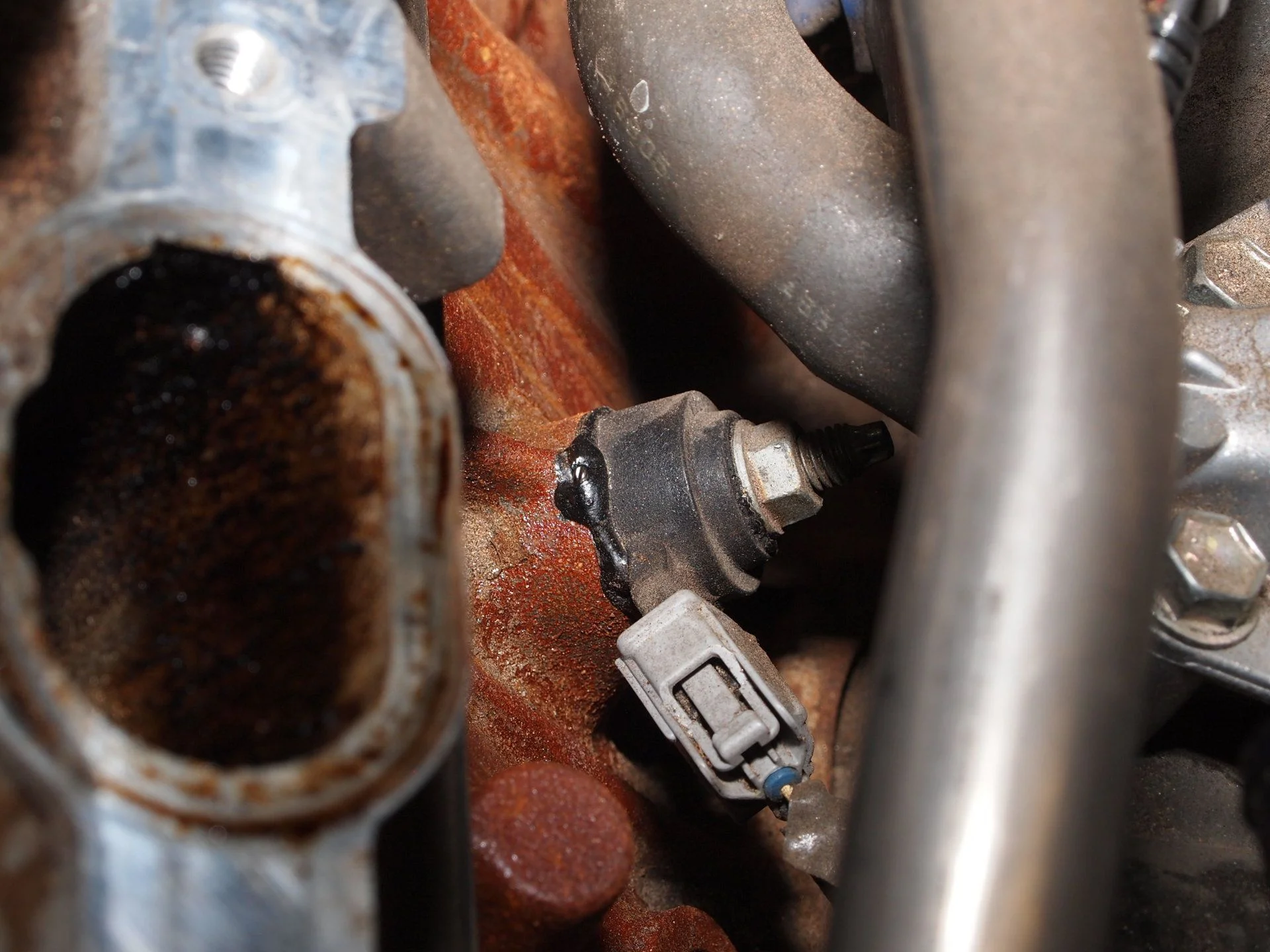

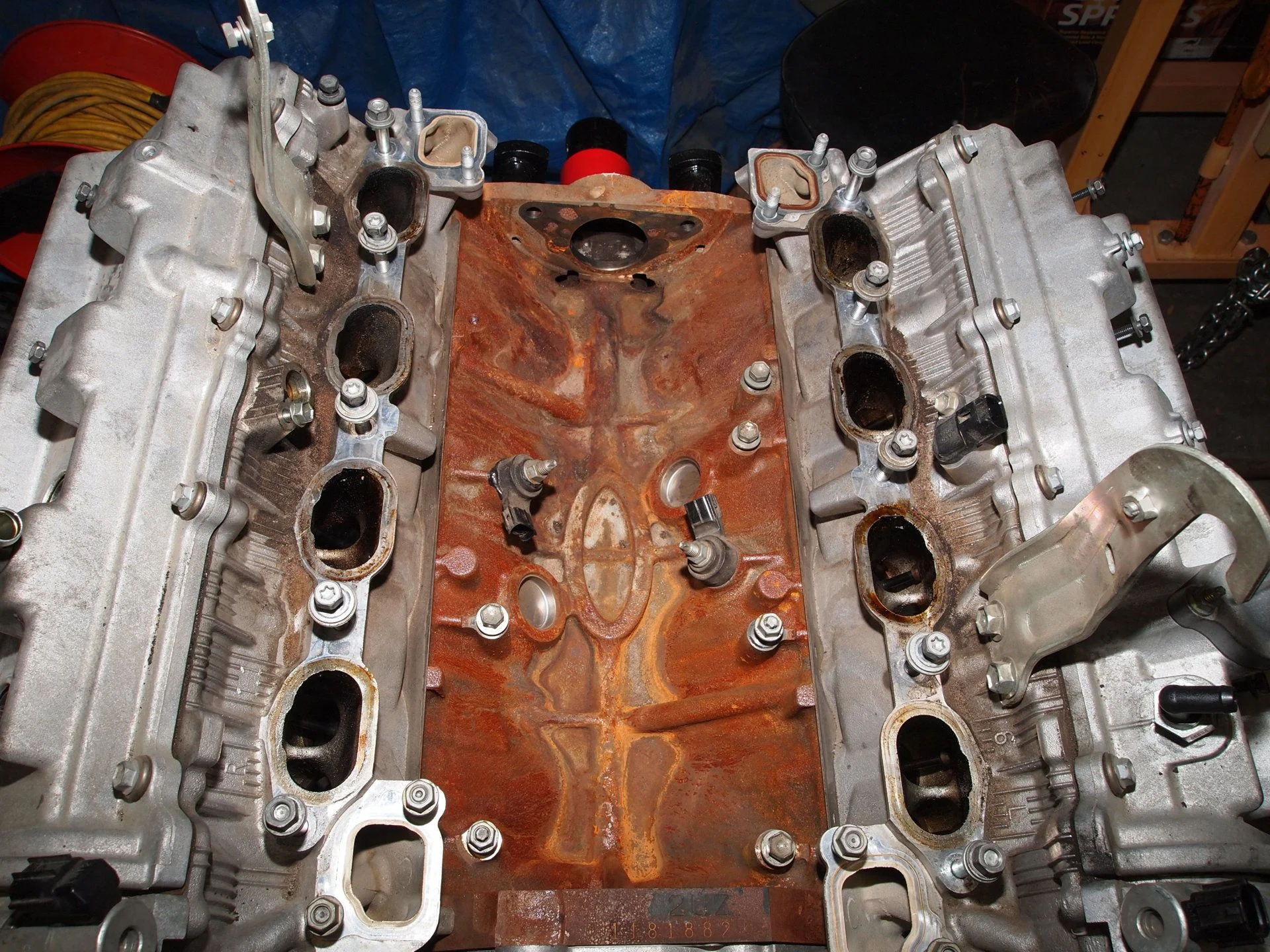

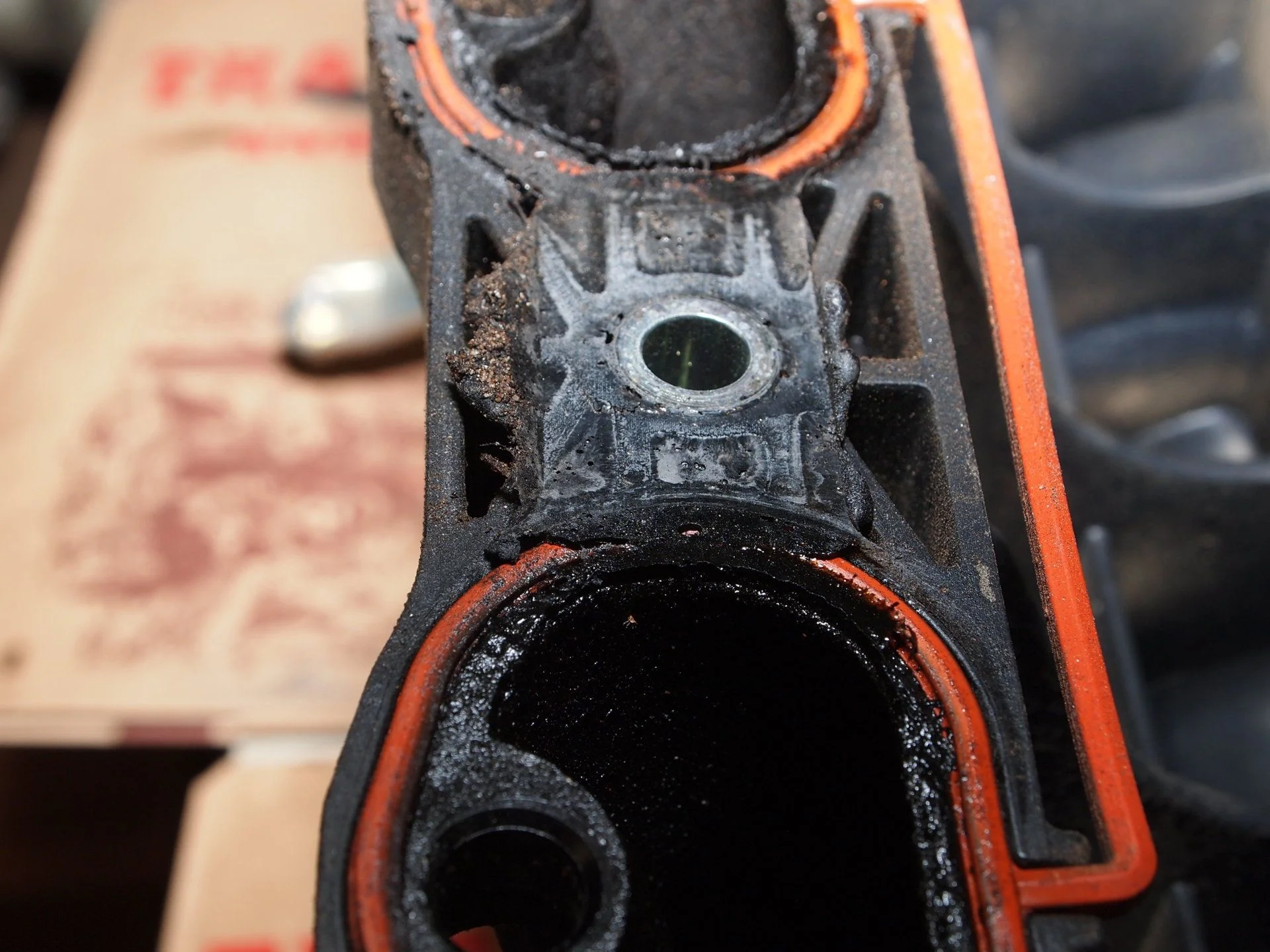

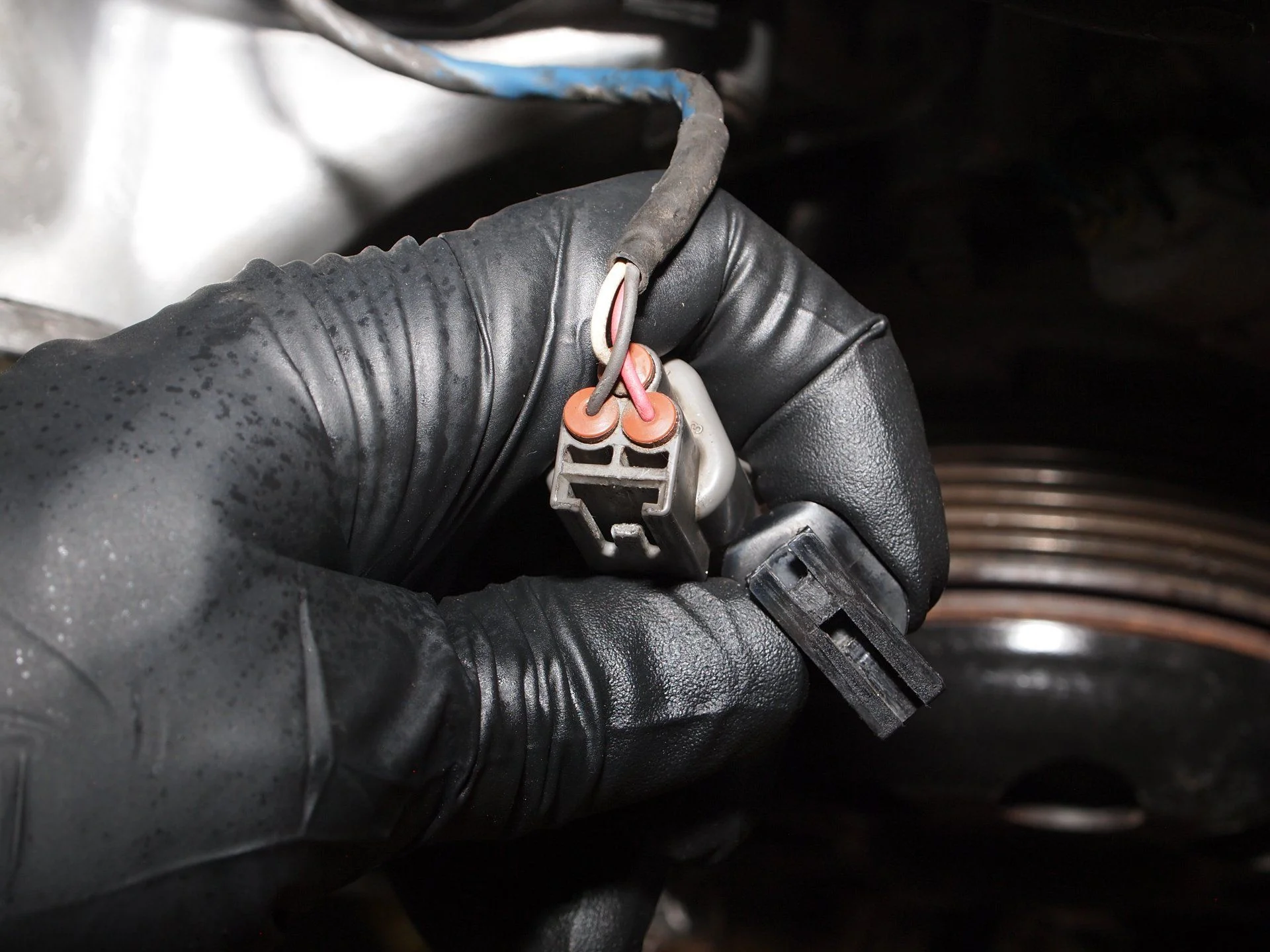

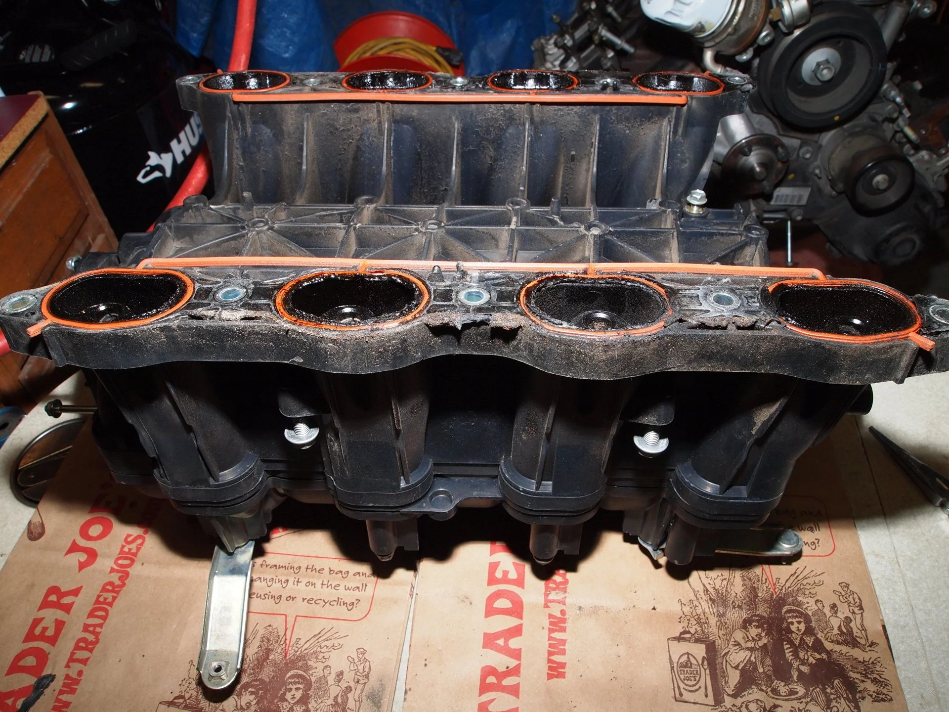

Did you notice the VVT cam sensor located in sides of head. RH was melted. Some plastic had to be chop out to remove bolt so I could take it out. This was necessary so I could remove the intake manifold that was being blocked by it. The RH knock sensor was also melted. Notices also the color of the cast iron of block in the valley. It had and unusual orange glow. This engine was hot!
View attachment 1678637 Knock sensor RH sideView attachment 1678638 View attachment 1678639 View attachment 1678641 View attachment 1678642

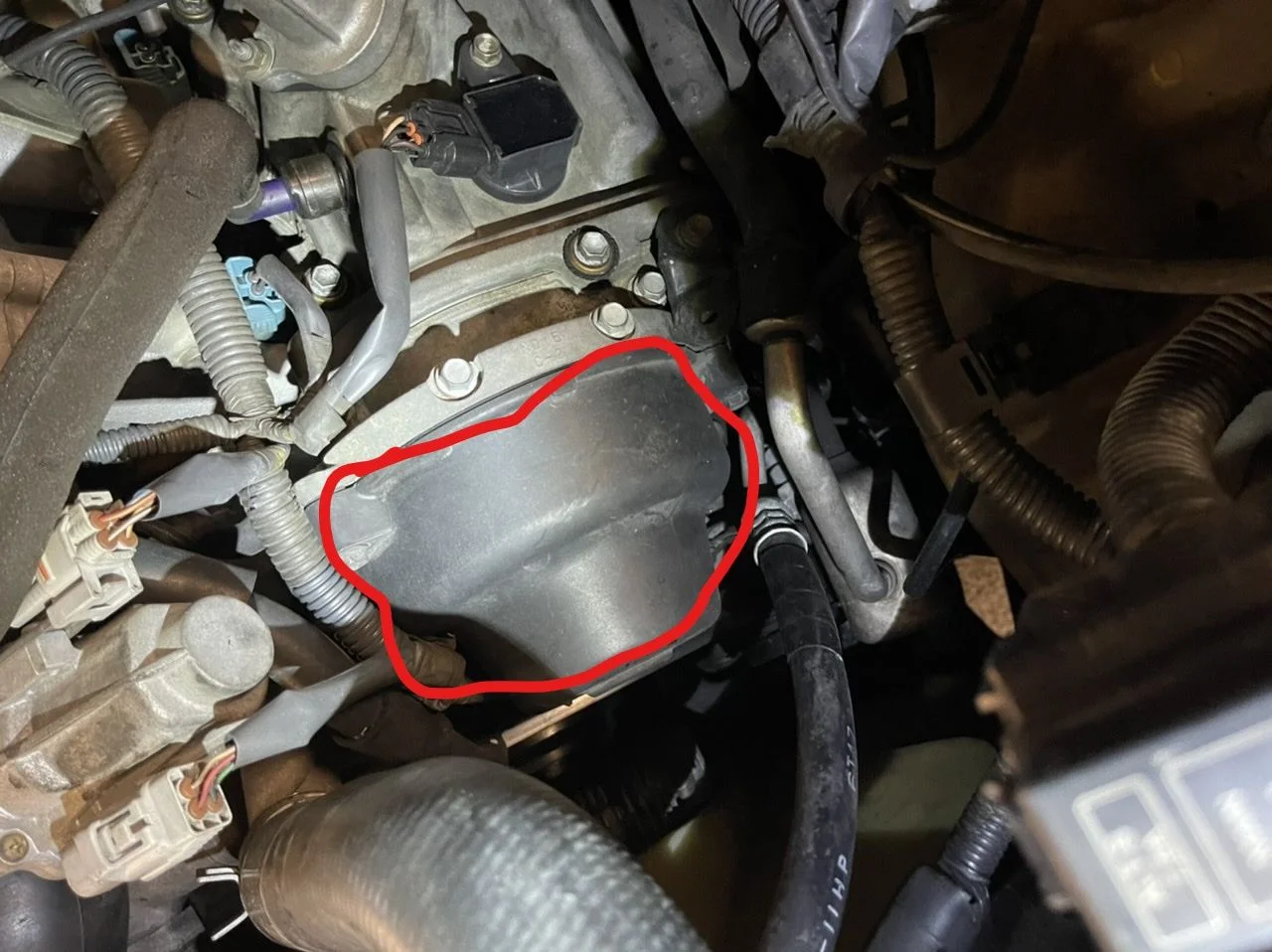

Looks like you were able to find the replacement for these clips! Did you come with the cover?
No I've not, nore look very hard. But if you've top piece even bust away, it still clips in. You can also tie down.

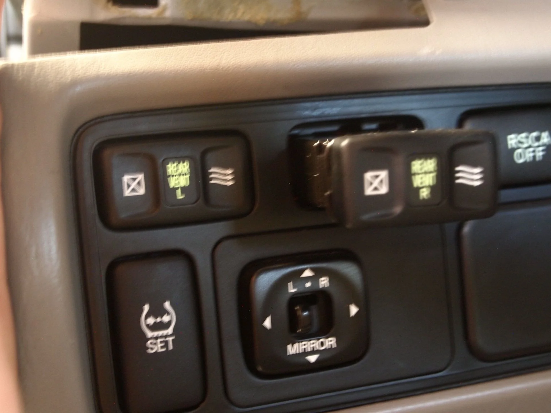

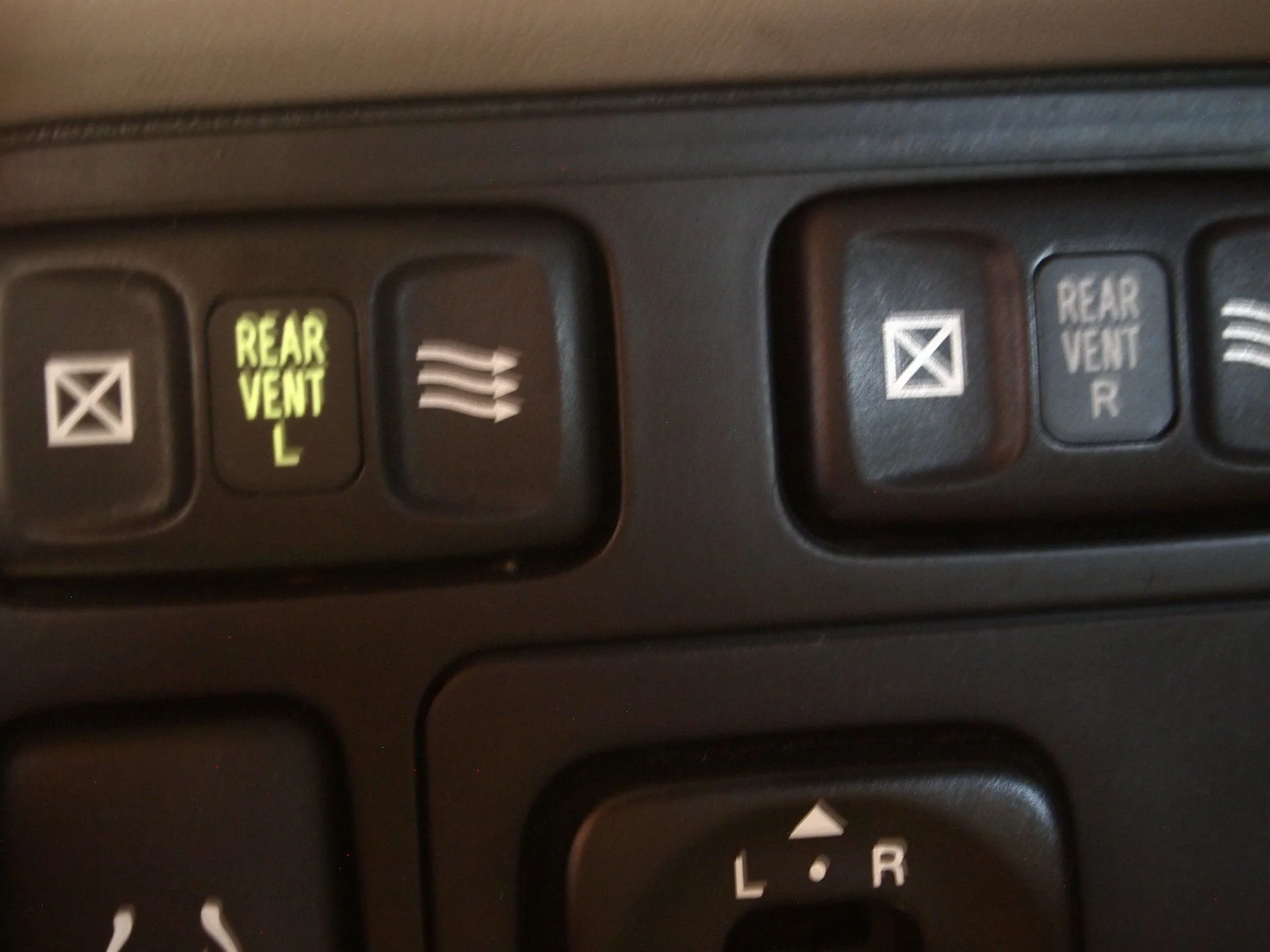

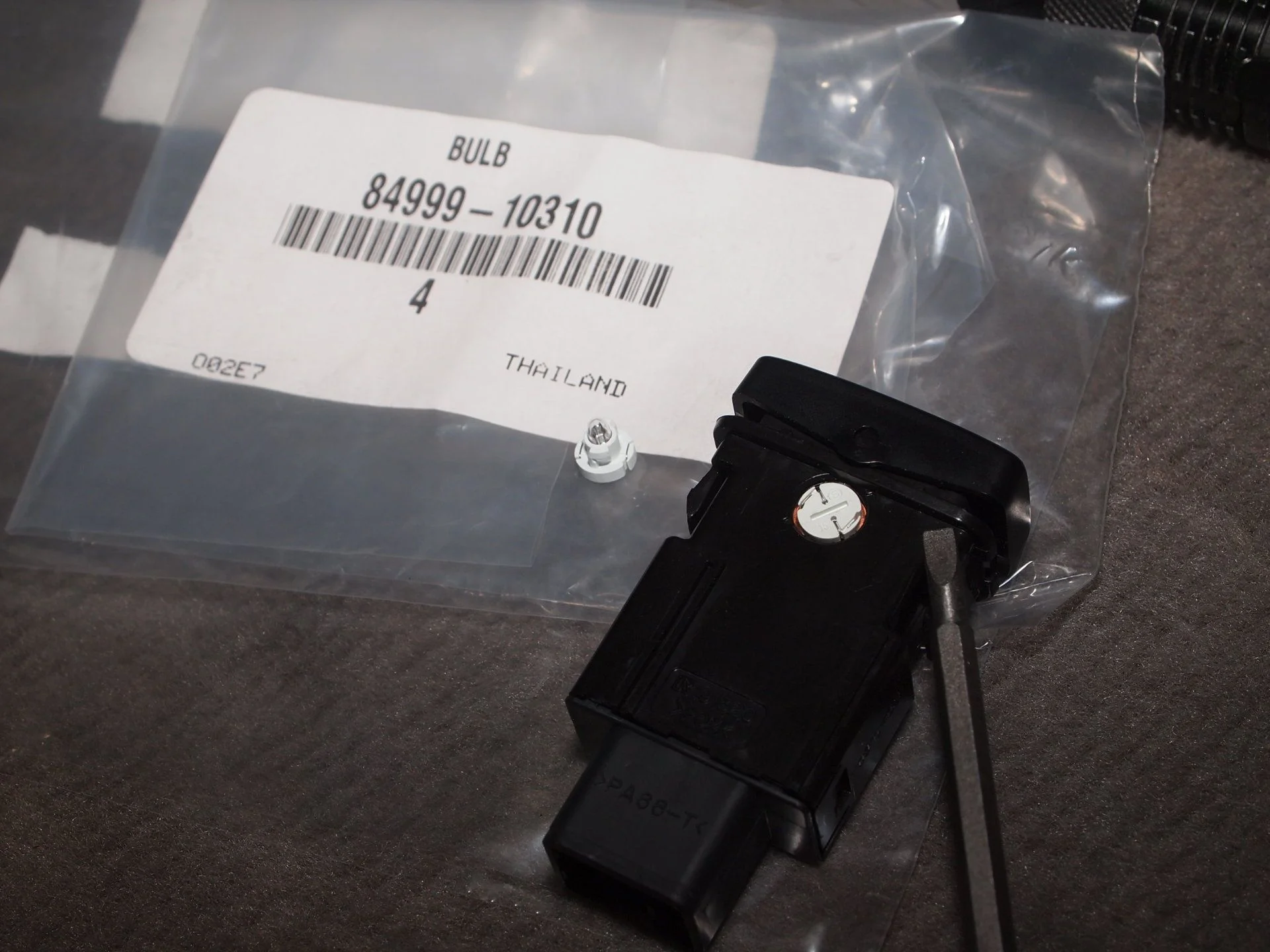

Darn found this R Rear Vent bulb out after I'd buttoned up the LH dash. Off it comes again.
View attachment 1712502 View attachment 1712503 View attachment 1712504
I've a door panel interior light lense on order. To replace one I found cracked. Seems the interior lights were upgraded to LED by PO. I'll add that here when I get it and install.
