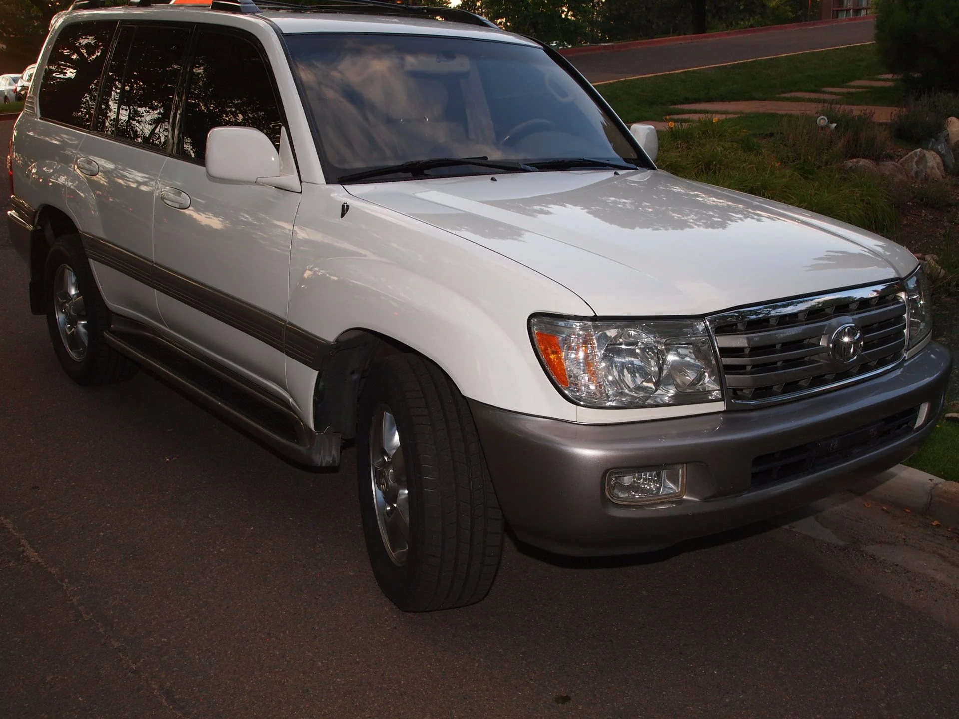

Yep the search is over, I scored a Silver 2007 Unicorn Land Cruiser w/Thunder Cloud trim and stone interior.
I started this hobby of restoring 100 series, after getting the bug! A bug perpetuated reading mud, as a distraction from the stress of trading oil futures contracts 23 hours a day. I'd already been a 100 series owner since 2004 (01 LC No Nav The King), and a wrencher since birth.
I then decided to find a high mileage minimally maintained 100 to see what it would take to bring back to near showroom ready (restore). I found the "WhiteLady" 01LX w/215K, bought it, went to work/play. While playing with it, needing a hood I searched the internet daily for months and months for paint matching hood. While searching I found a few others that turned into project like "Graybear" a 00LX w/274K. One rule I laid out from day one (only way girlfriend would tolerate) is hobby must pay for itself. Second was a goal to work my way up the food chain, one day getting a Unicorn to play with. Got it!
For those that don't know, all 2003-07 series 100 import through normal channels into the lower 48 states of the USA, came with the NAV optional system. With the NAV option also means, the climate controller is integrated into NAV.

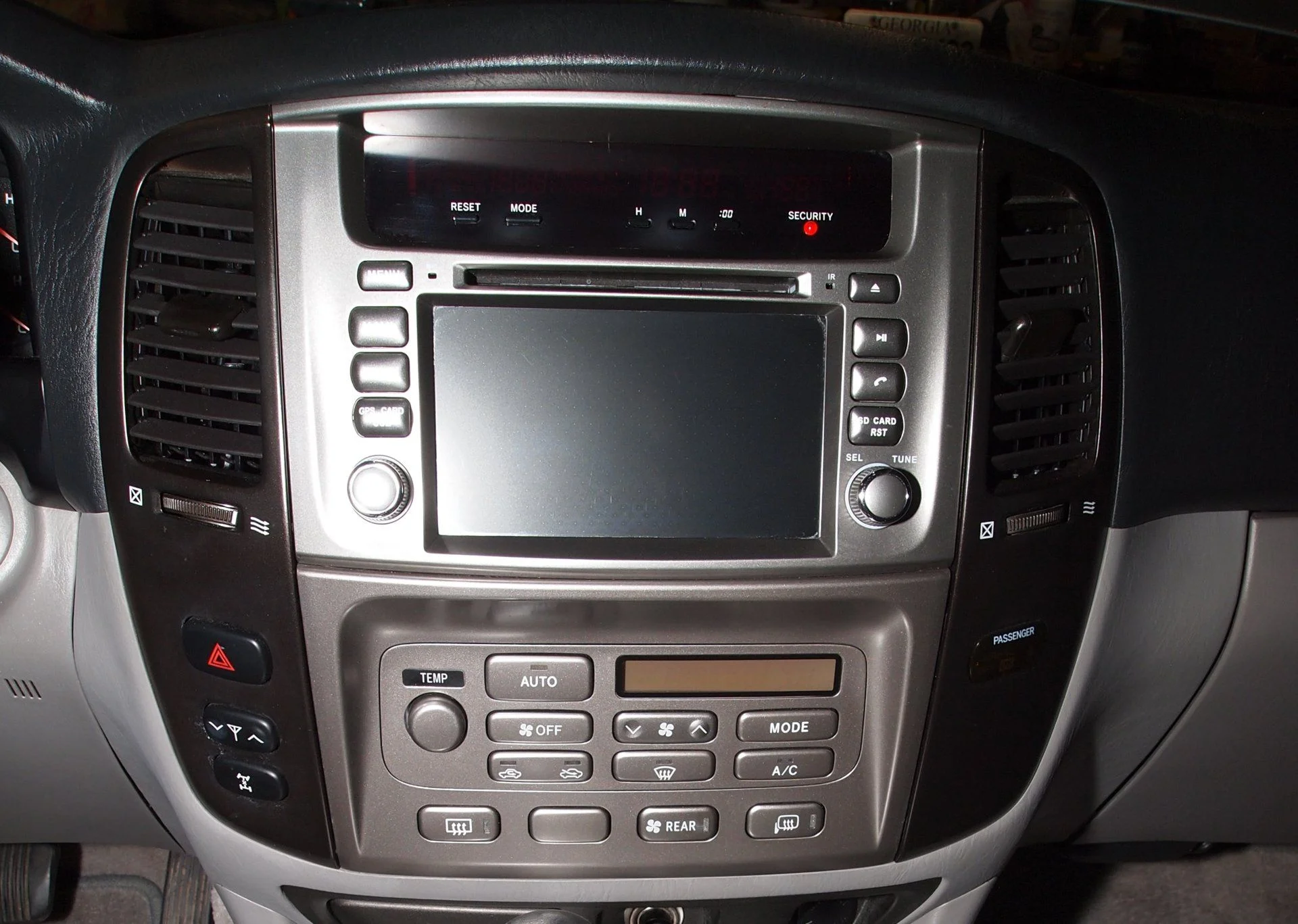

Here's the Unicorn's climate control, which has had an aftermarket radio and backup camera installed. Notice the differences, like it has a fan control.

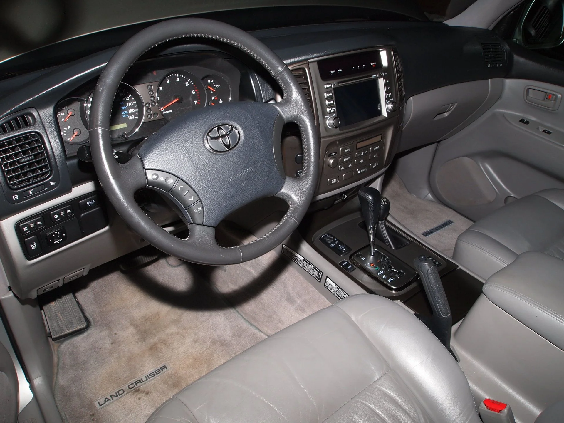

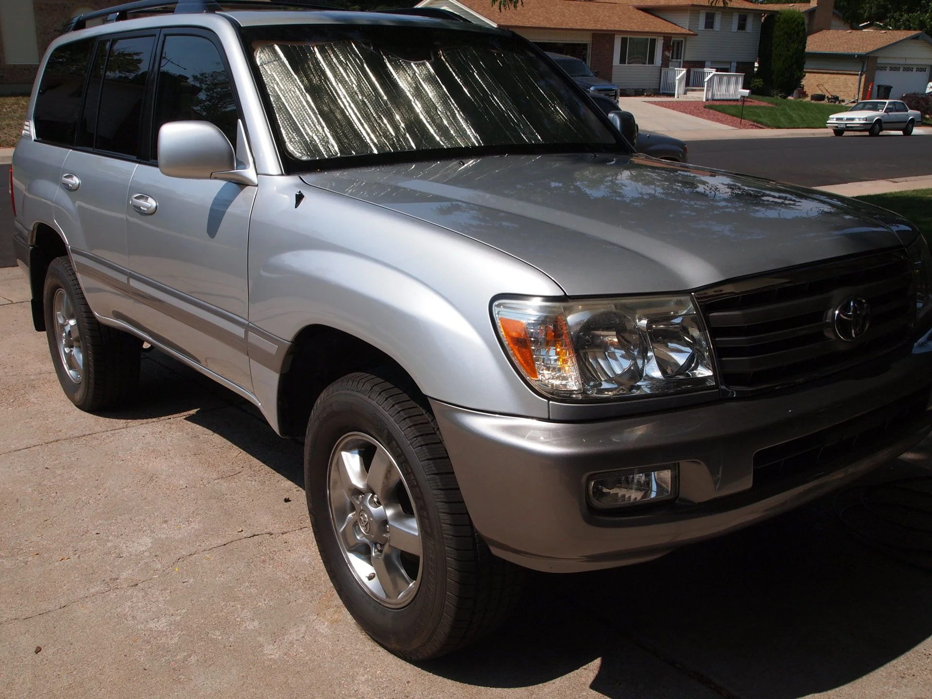

For comparison here is a typical 07 USA 100 series.

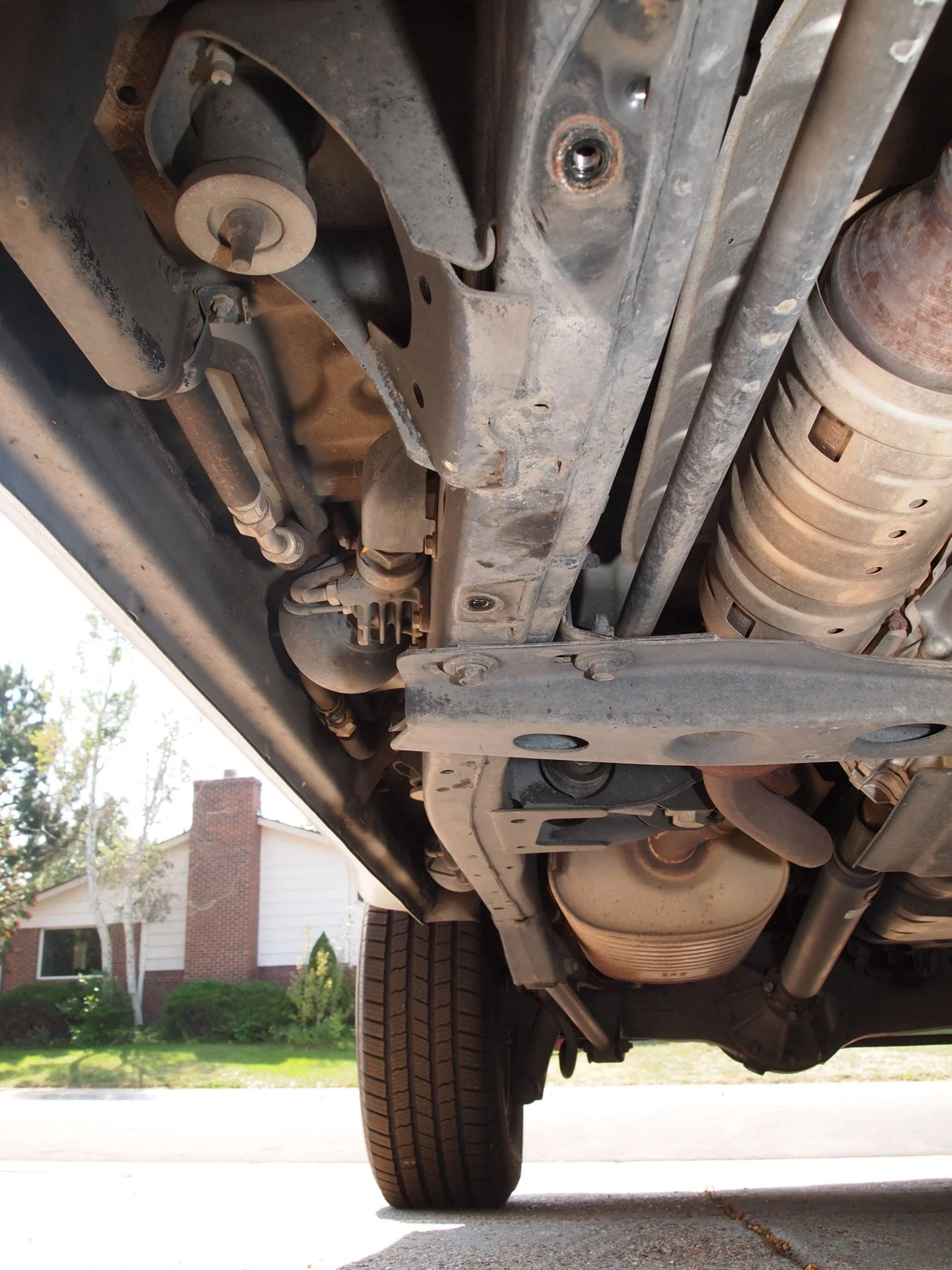

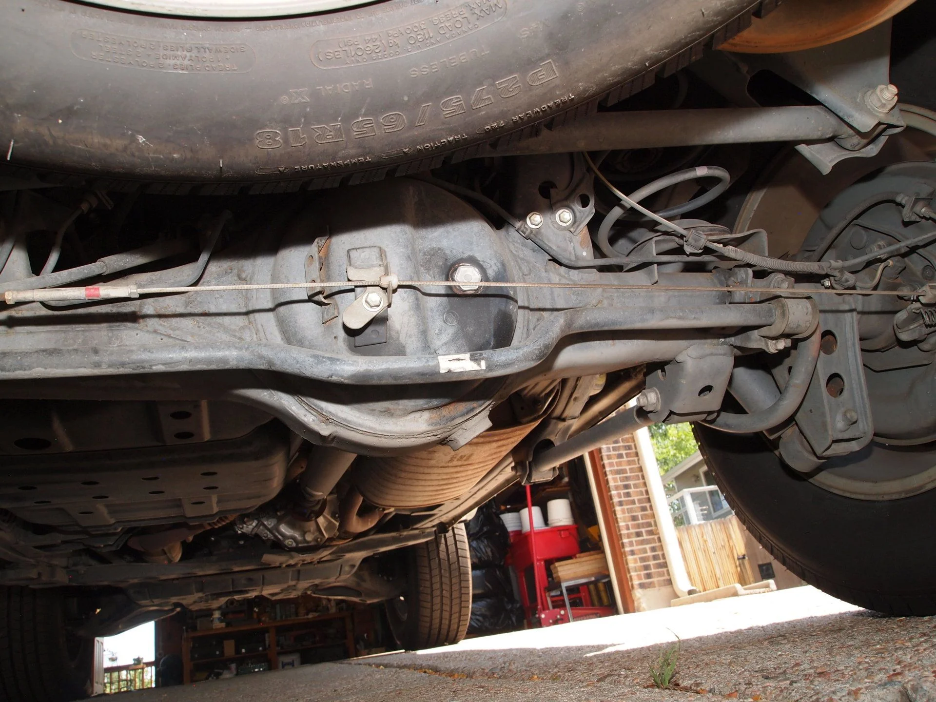

As example: Painting between #3 crossmember and frame. This is a rust location that can lead to a very expensive repair beyond the Toyota designed 25 year life.

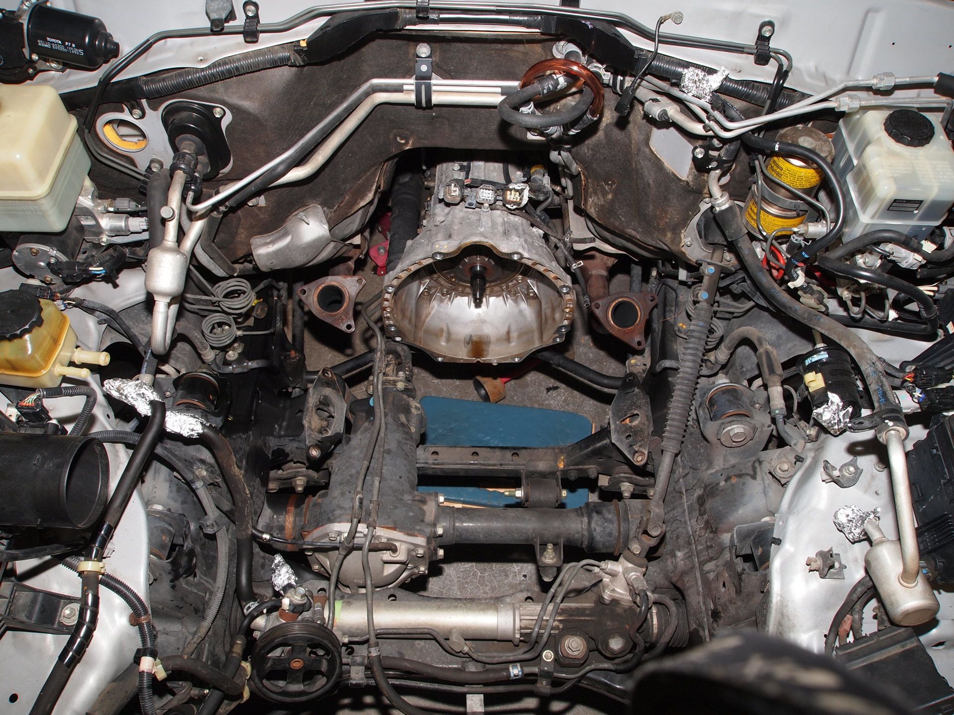

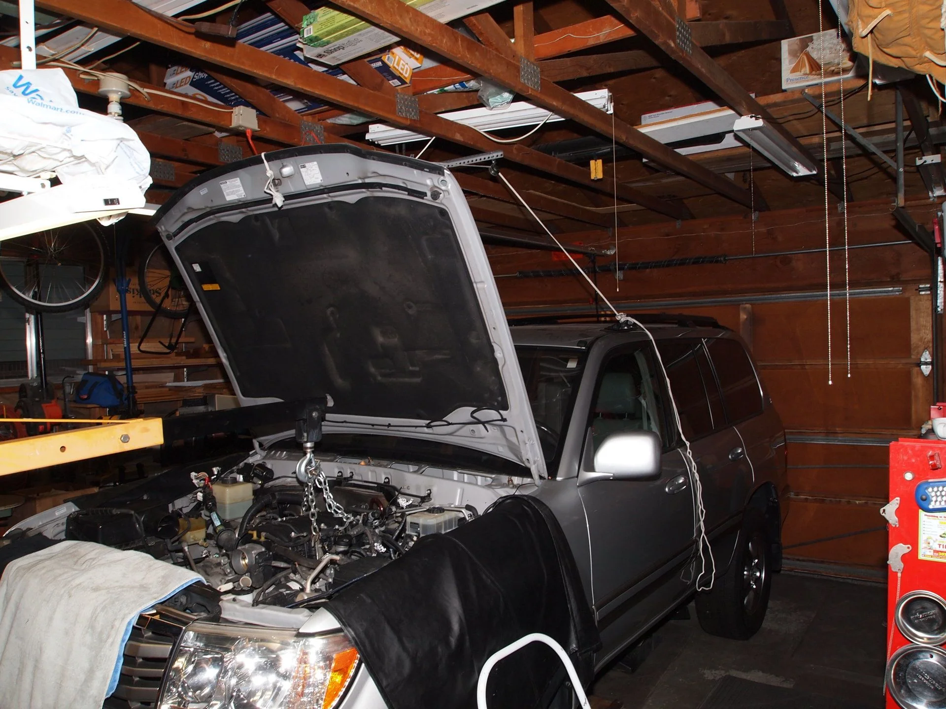

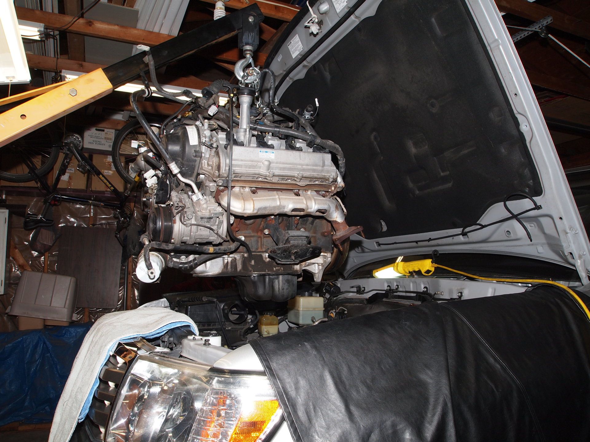

Engine removal. Post #7

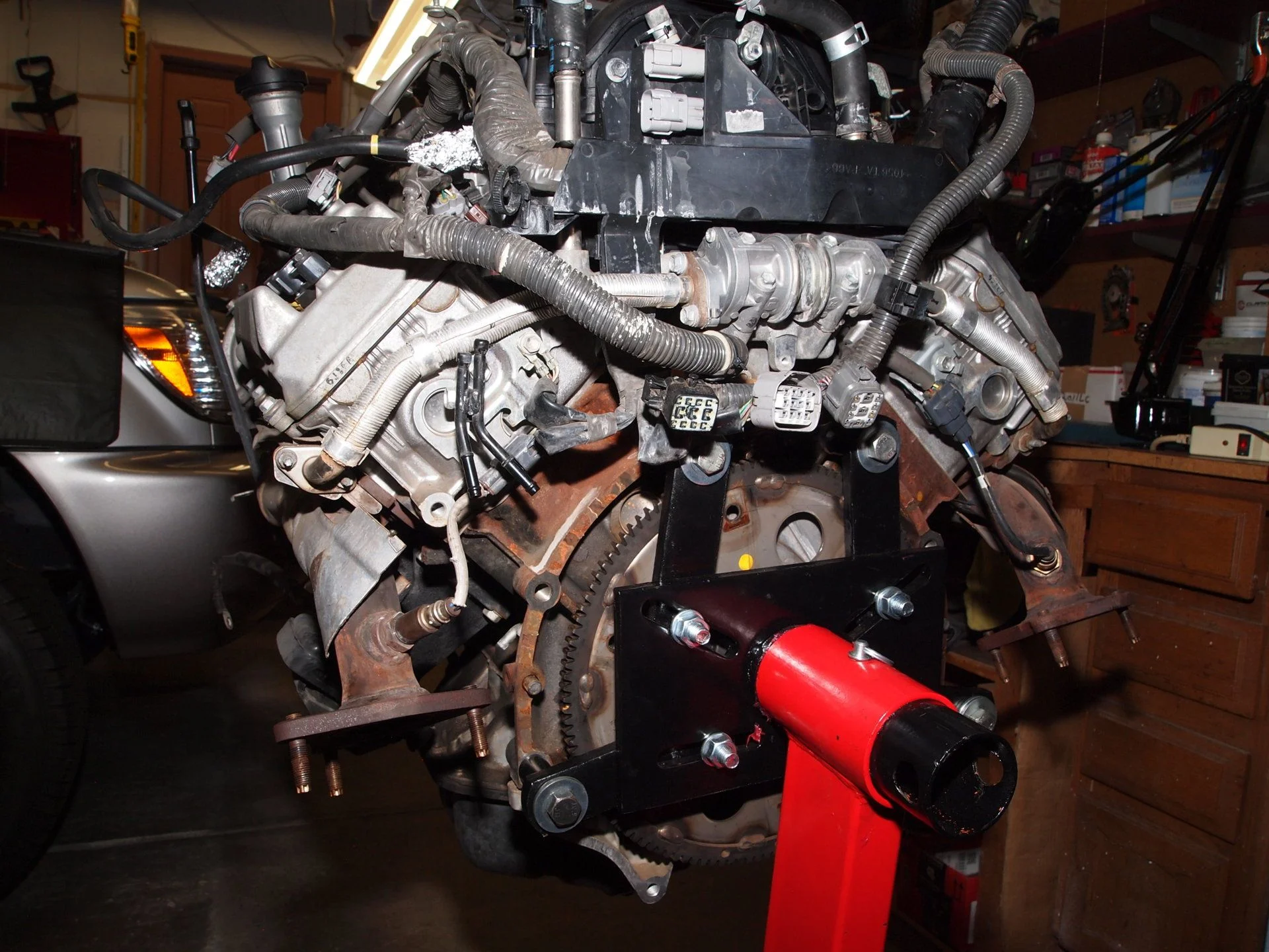

Engine tear down to near barebone long block starts at post #62 page 4
Assembling 4.7L 2UZ-fe VVt engine from bare long block to conform to a 100 series. Starts at post #74 with Oil pan.

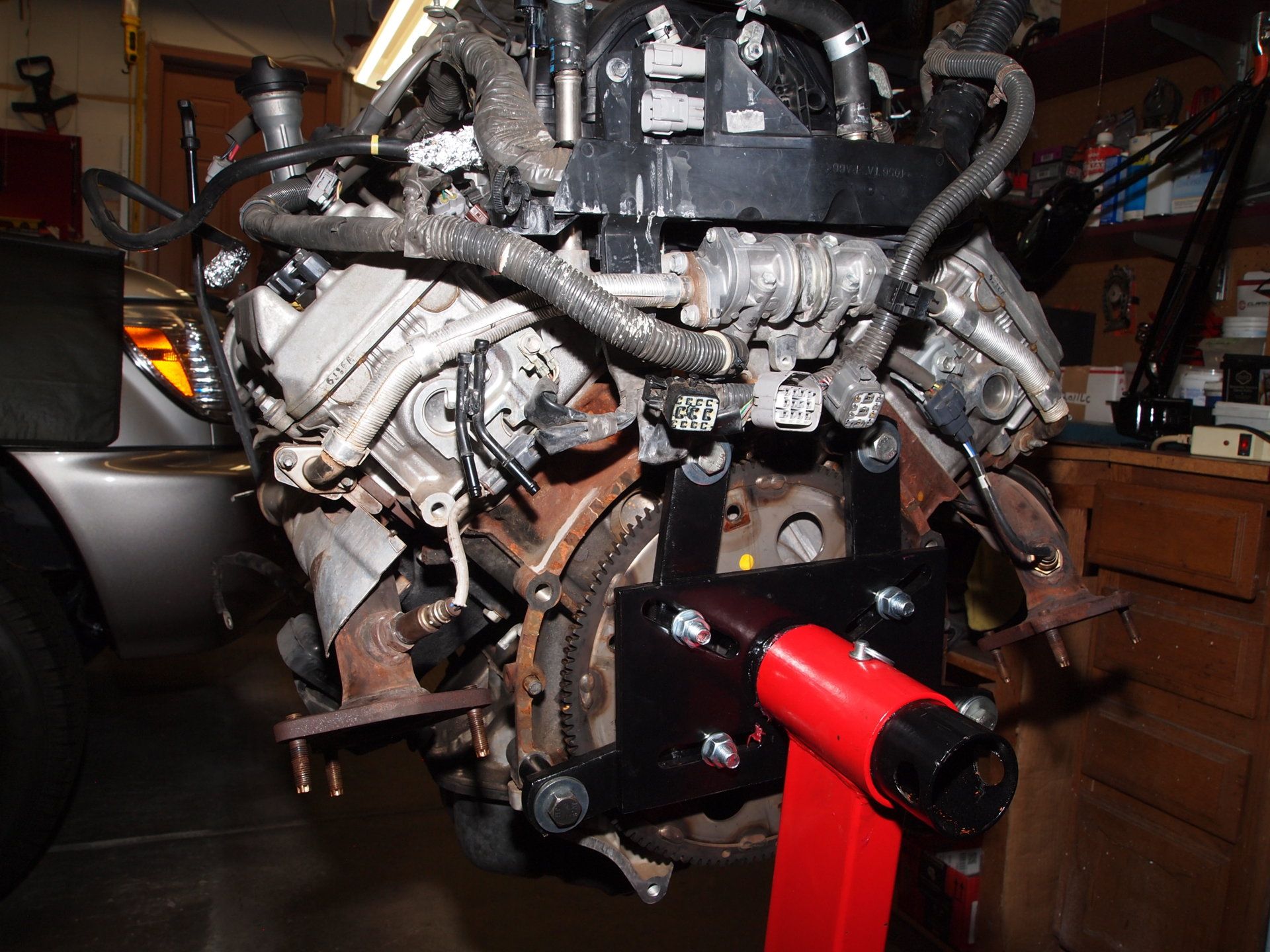

On Engine stand ready to install. post # 125

Engine install. starts at post # 137
Finishing up engine install. Page 8.

Reconditioning #3 crossmembers bolt, bolt guide and contact points are rusting. Post #190

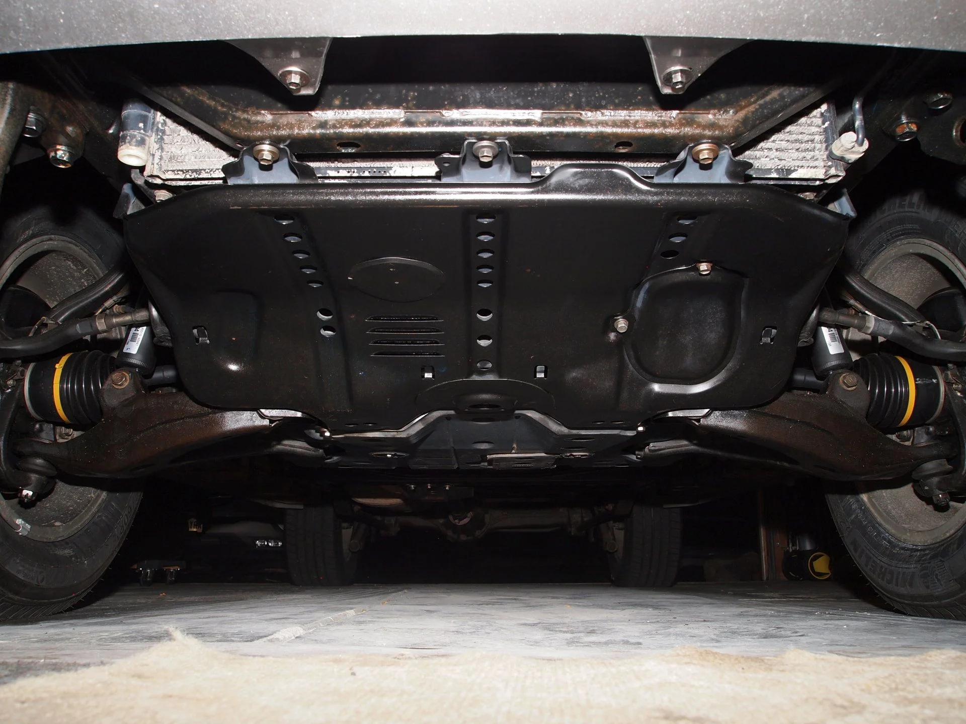

Skid plate rust PM and bottom radiator foam ("cooler pack") pad install. Starts at Post #316

Draining Fuel from gas tank:
Draining fuel from gas tank by removed fuel pump, so I could get a look into gas tank and siphon out old fuel. I was concerned with age of old fuel and look (crudy) of gas cap area. So I wanted to inspect and put in fresh fuel with a stabilizer. With so much work to be done, I didn't want a potential bad fuel issue at first engine start up.
Pulling Engine:
I did manage to pull engine out yesterday after making use of the occasional hours of warm weather to perp. I had planned on pulling pan, but it took longer than it should have to pull. So I'll wait for next warm day.
This is back of the VVt engine, which has tubes coming from the exhaust headers going into the A.I. #1 & #2 switches. Switches connect to the rear water bypass joint.

I did manage to pull engine out yesterday after uses the occasional hours to perp. I had planned on pulling pan, but it took longer than it should have. So I'll wait for next warm day.
View attachment 1637214 View attachment 1637215 View attachment 1637216 View attachment 1637217 View attachment 1637220
Great photos- dont often get to see this levelnof detail with motors pulled.
Thanks for posting.
That's one way to get to the steering rack...
That's what I was thinking. Be so easy.:hmm: I will be looking over that very closely, but so far I've no indication it needs a rack replacement or even mounting bushings.
Thanks for posting.
Thanks! I have a bunch of pictures I'll be puttin up. I chose those to show parts we don't see everyday and how I did some stuff. Keep in mind it's a VVt so a few difference on engine.
BTW: One shop said "It's only a two hour job to pull" Man I'm I slow took me six months...LOL
