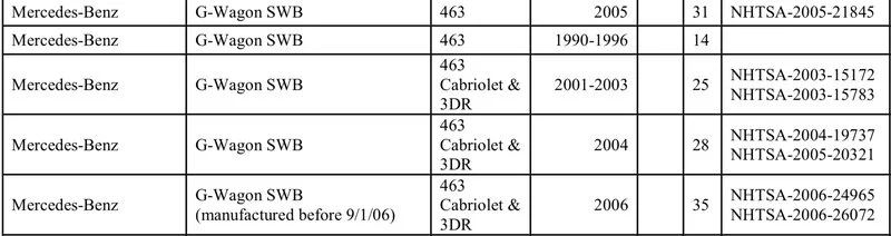

The 99-06 IFS UZJ100L is eligible for import even though it is less than 25 years old. Back in 2012, somebody petitioned for an exemption shown here.
Here is a list of vehicles approved and eligible for import through a registered importer. It shows 99-06 Land Cruiser.
https://www.nhtsa.gov/sites/nhtsa.dot.gov/files/documents/elig120115.pdf

I cannot even begin to properly explain how hard it is to import ANY vehicle into the US that is less than 25 years old. The only time I am aware that it will not be an exercise in experiencing Hell is if it is EXACTLY like a vehicle that is sold in the US.
Bill Gates struggled to get the 959 into the US... He has unlimited funds and a fleet of lawyers. That says pretty much everything I need to know. In the end the Show and Display legislation exists as the only way they could figure out how to import it. That is why that law came into existence. It actually took an act of Congress...
