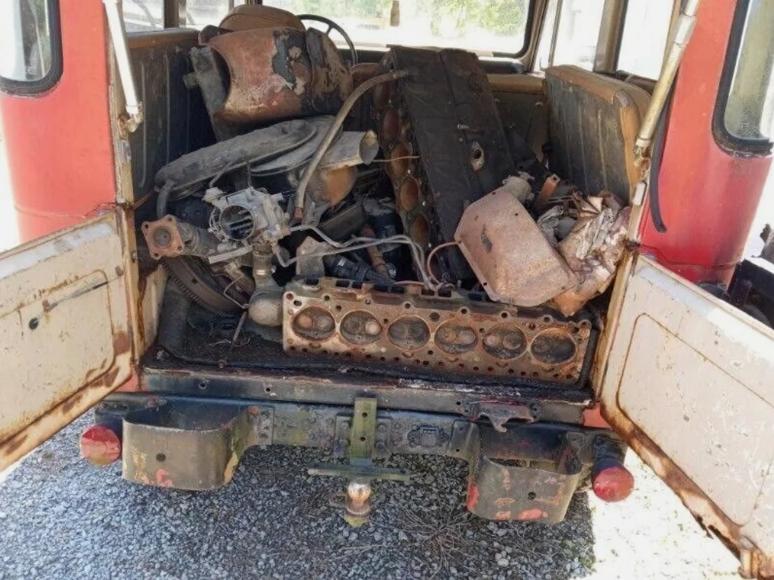

Sounds like VERY good words of wisdom! Thank you so much. I agree with you. I just want to get it running again (too bad someone took the engine completely apart and then stopped, and it's sitting in the back, see attached pic). I learned to drive on a stick shift, but haven't driven one in ages. This, however, is a column shift, and I haven't driven one of those in 40 years! LOL! I'm wondering, for my boys, if I should teach them how to drive a 3 on the tree, or a 4 on the floor. I always loved driving a stick, but had both hips reconstructed 39 years ago at the ripe old age of 16, so especially for driving in traffic I started driving automatics. But I think it would be great for the boys. Load them and our fishing gear up and go wet a hook, or even take it to some trails or the beach.

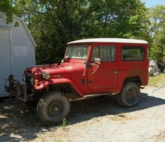

Correction: As all of you pointed out, it is not an OEM PTO winch, and in fact it turns out that it is some brand of big electric winch. If it works, I will probably leave it, pull the gigantic bumper / brush guard off, and replace it with a CCOT HFS shorter than OEM winch bumper.
Since it probably does not have the PTO system, that should (from what I have learned from all of you) mean using the Overdrive unit should not be a problem.

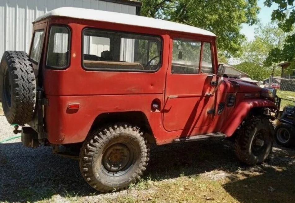

Agreed. And looking closer at the photos I see a HFS Suspensions (from CCOT) sticker on it, and zooming in on pics around the front left wheel it definitely looks like improved shocks, so maybe a previous owner knocked out some upgrades. That would be great. I'll know tomorrow when it gets here! Woohoo!
Looks to me like the winch is an industrial winch converted to 12v starter type motor ... the brushes cover had been removed
if you have a lever inside it could be the engage lever and most likely (maybe not) is a spool in only winch
So, since I am new to all this, does what you said = BAD, or GOOD?
Seller apologized that it was not a PTO winch. Said he thinks there is a lever inside. He sent me 2 more pics of the winch and I will try posting those below.
"IF" you guys think the winch is worth keeping, do I need to try to find a brushes cover? Or a winch cover to cover the whole thing when not in use? I'm also going to swap the front bumper / brush guard our for a short CCOT HFS Winch Bumper.
