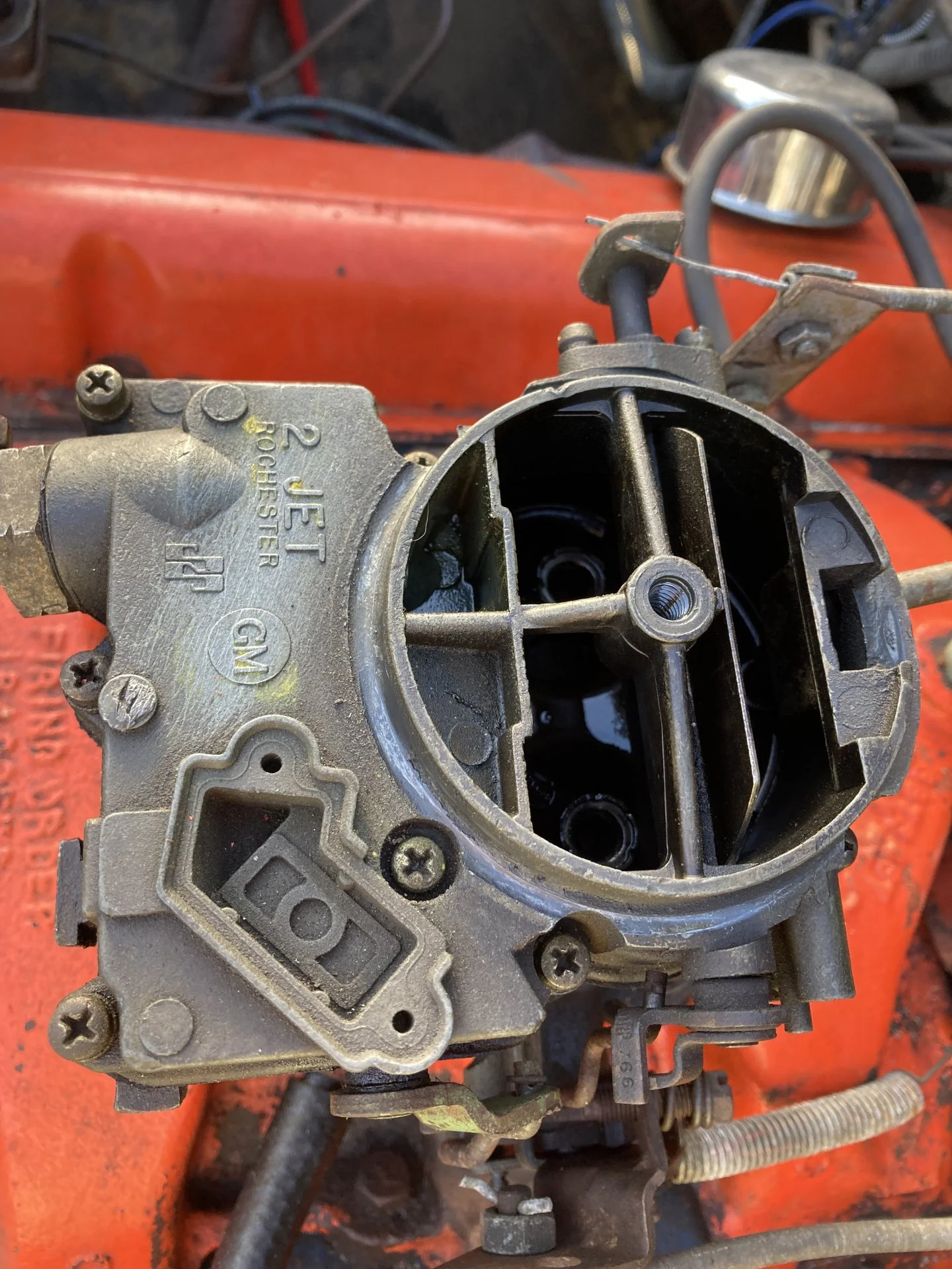

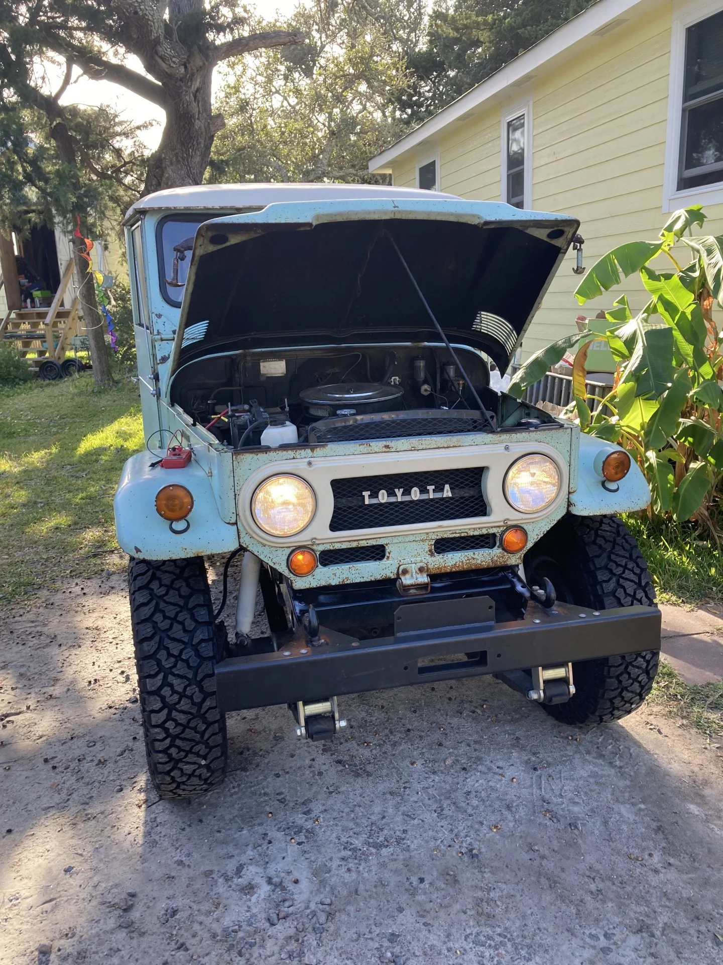

Coming in hot from the 70 series side of the forum... I just purchased my first fj40 from my good friend @Shyrock and his family. They affectionally called it the salt wagon. Luckily the salt has not eaten it all up haha. This is an early fj40 registered as a 1964 model. Has a sbc 350 and the Toyota 3 speed transmission. It needs lots but I am ready to tackle it. I have parts coming in the coming weeks. too much to list but some key parts: new carb. It has a rodchester 2gc that needs a rebuild. but I am not a fan of those carbs so I purchased a new Holley carb and an adapter. New break cylinders and pads.( will eventually do a disc conversion) Quarter patches and rear sill. New rebuilt early 36 spline steering wheel. Horn relay. Wiper blades (I have the arms and the motors work). I have all new weather stripping for the doors. Incliding felts and the swing out window rubber.
Will be fixing the speedo cluster to make function more properly. I think the only thing that works on that is the amp meter. I believe it needs a new speedo cable and some wiring for things like the fuel. Hopefully its not too complicated.

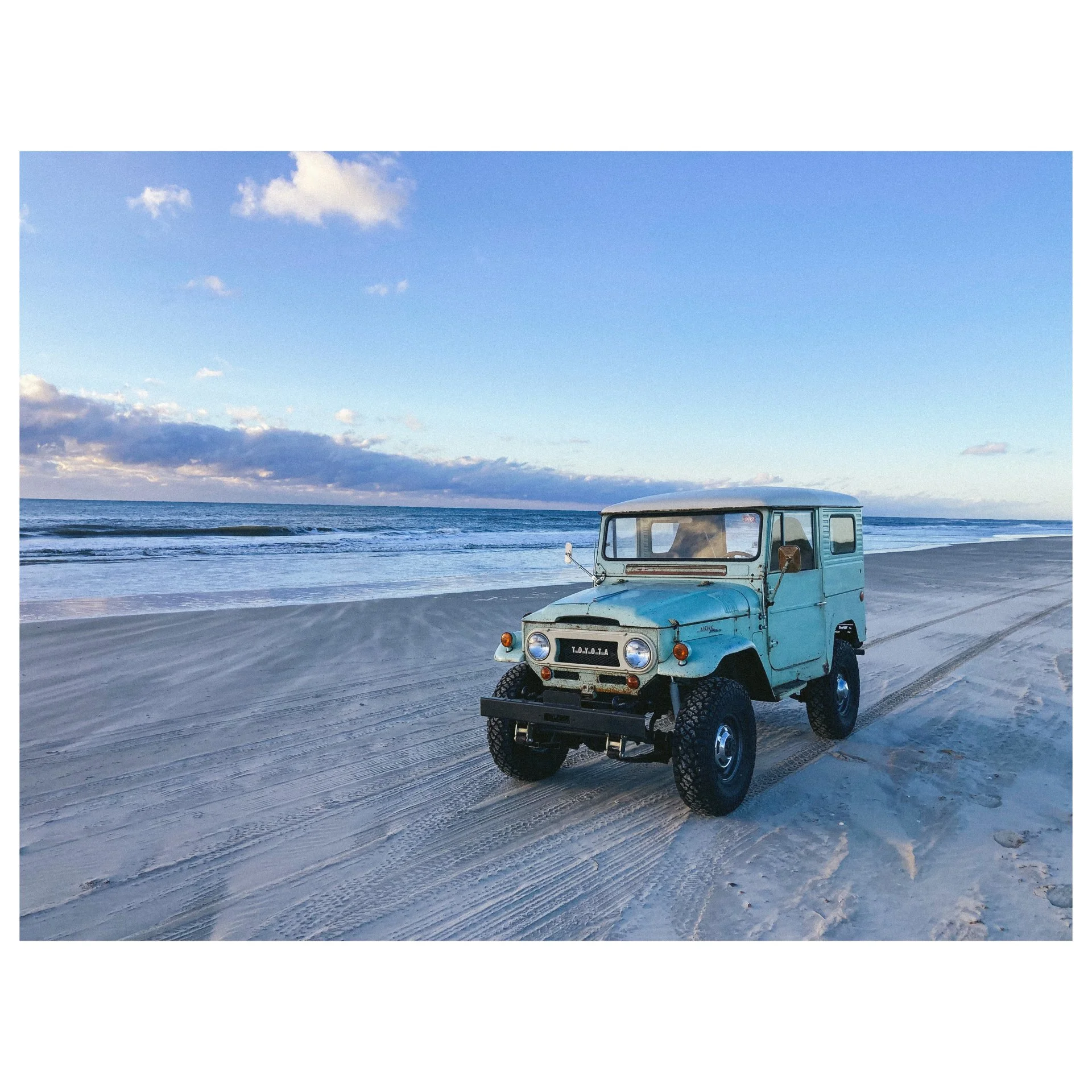

Headlights also have a short somewhere. They worked for a few minutes messing with the wiring but I need to do more to figure that out. Turnsignals and running lights all work.
things to do more in the future: Replace suspension with ome parts. The kit that is on it I believe is a rough country, Key word being rough. but for now its nice. Will be tackling the rear sill and quarters this winter sometime. Heater hoses need to be hooked back up. but the fan works. want to find factory 6040 bench seats. I have always loved the look of those and it would be cool to put these back in.

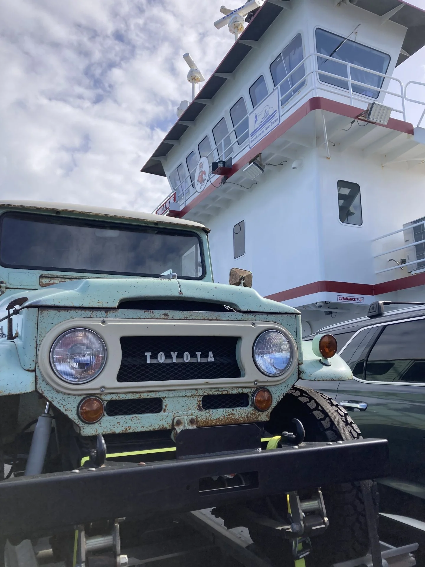

Photos first one with @Shyrock and I. Second one the fj40 on the ferry ride coming home. Third one proof of head lights working. 4th one My dad and I. He helped me pick up the fj40. He is a cool guy! and lastly a photo of the rodchester carb.

it was 100% the high low beam switch. I messed with the wiring behind the switch and cleaned it up. Now the headlights are working.

So I am thinking about a couple of mods on the fj40. My fj40 has a mechanical style linkage for the gas peddle. I am changing out the stock carburetor (a very worn out rodchester 2 jet) for the sbc 350 to a Holley 2 barrel 2300 500cfm carb. While I am sure I can get the mechanical linkage to work I am contemplating getting this and a few other things to switch to a cable actuated throttle. I feel like this would feel smoother too. Ccot has a kit for a webber carb that seems interesting. I dont know if it would work for a holley carb on a sbc. https://www.coolcruisers.com/pecaaswe.html Just wanting some opinions on this. Not sure what other 350 fj40 owners have done.
