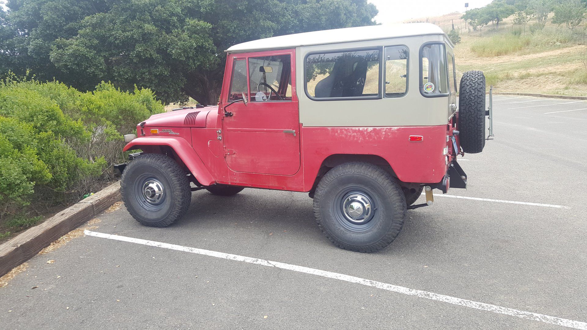

Carrying this one over from my build thread, but making enough progress that the 40 is actually starting to look like a truck. Installed lights, bezel, signals, etc. Still aways to go working on the aqualu tub before I hit the road, but thought the picture was worth posting.
