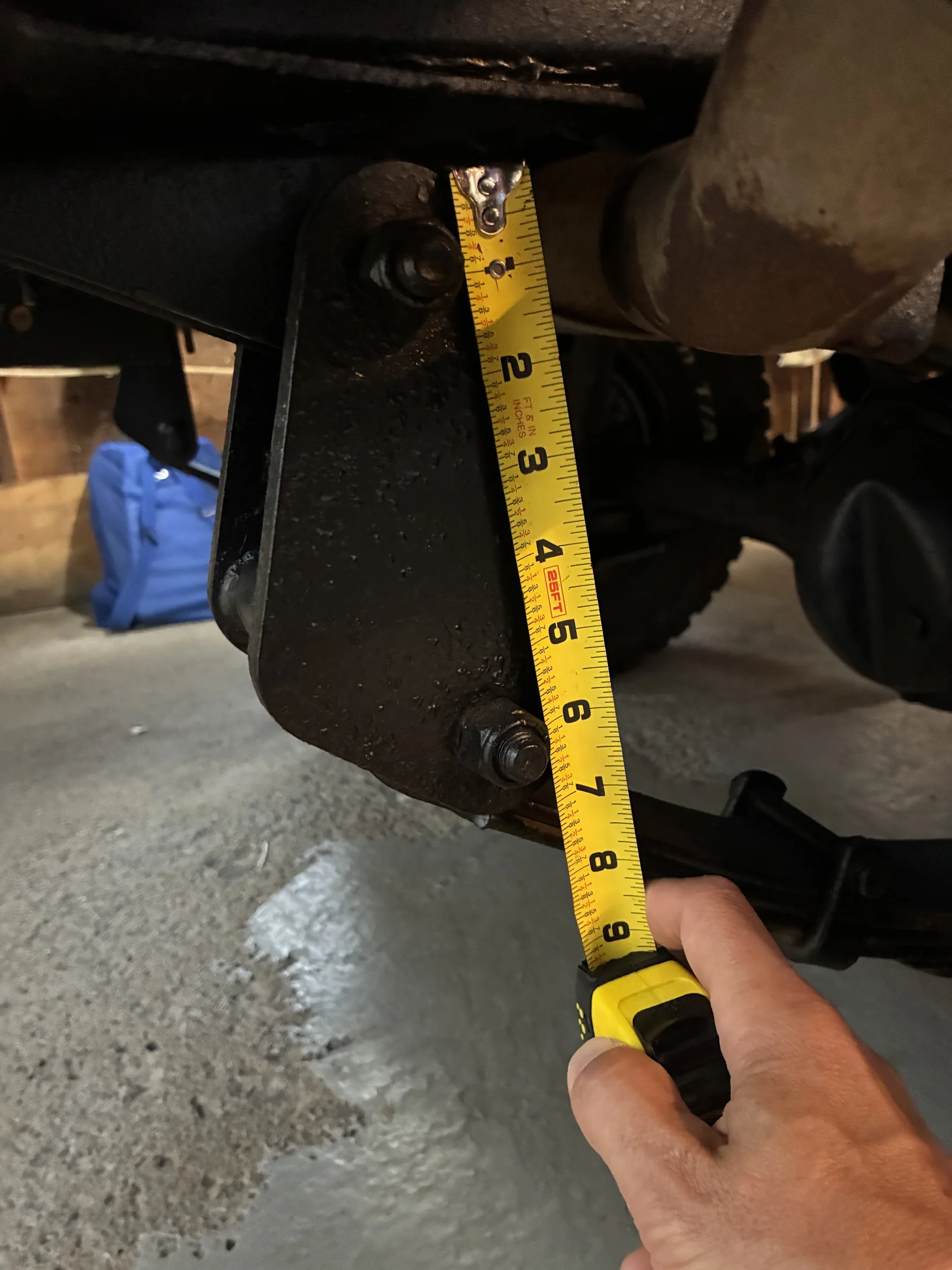

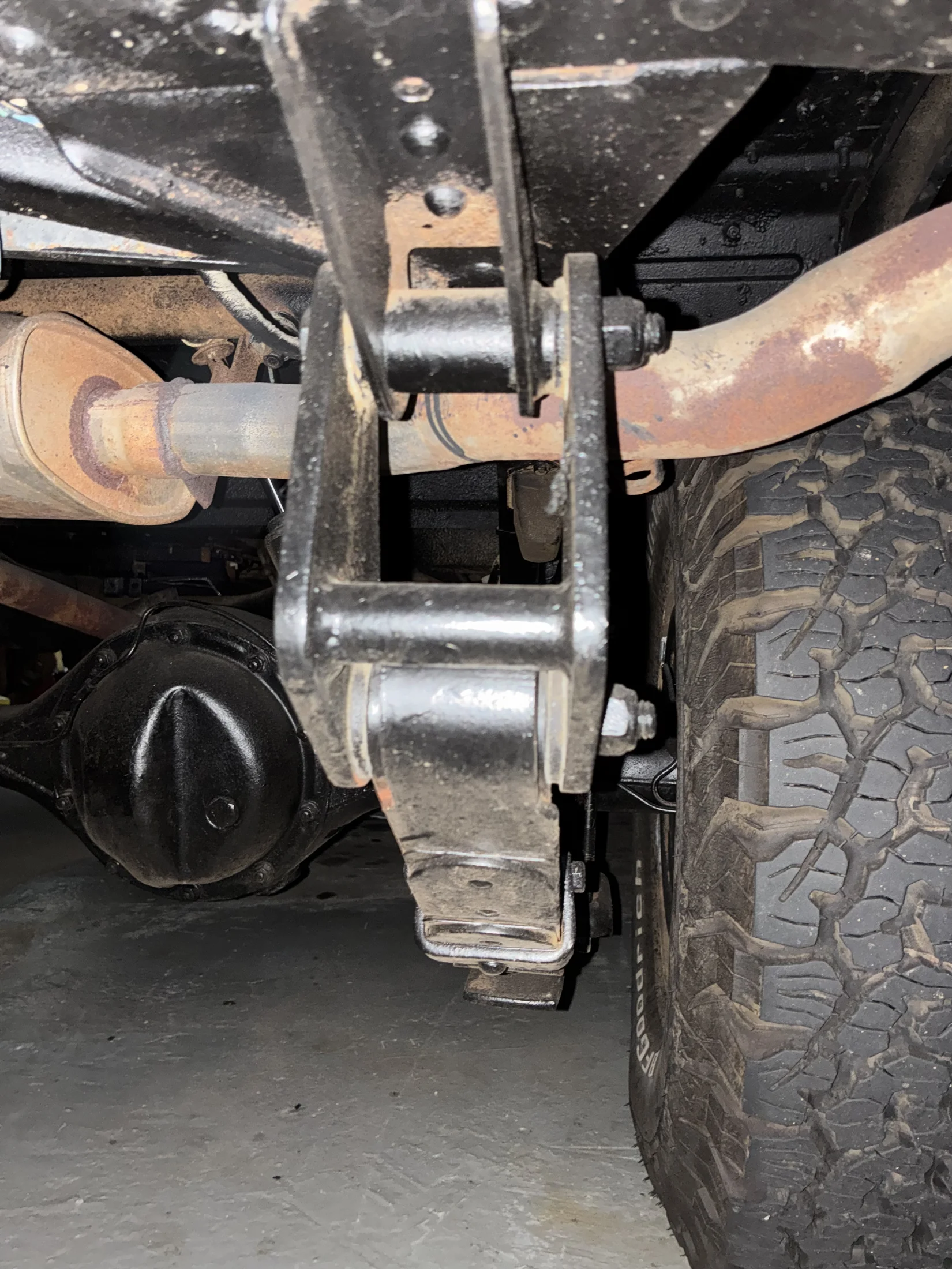

Looking to get some new shocks but don't have any idea how to tell what size lift is on the truck.
With the Sr, probably 4inches in springs and another inch in the shackles....so something around 5inches
to do it correctly, you really need to measure your travel from full droop to full compression. the amount of lift is only part of the equasion: some trucks stand 2" above stock but with different springs they have twice the suspension travel - the shocks will limit the range of motion
You can measure compression, by measuring the distance between the bumpstop and axle.
