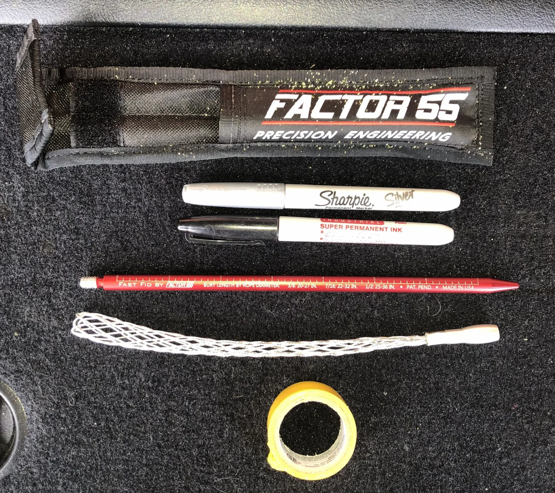

I can't lay my hands on the whipping twine, but it is a waxed twine used for sails, I got a small spool of Robline brand with a needle from West Marine for around $10, and it is good for many whips.

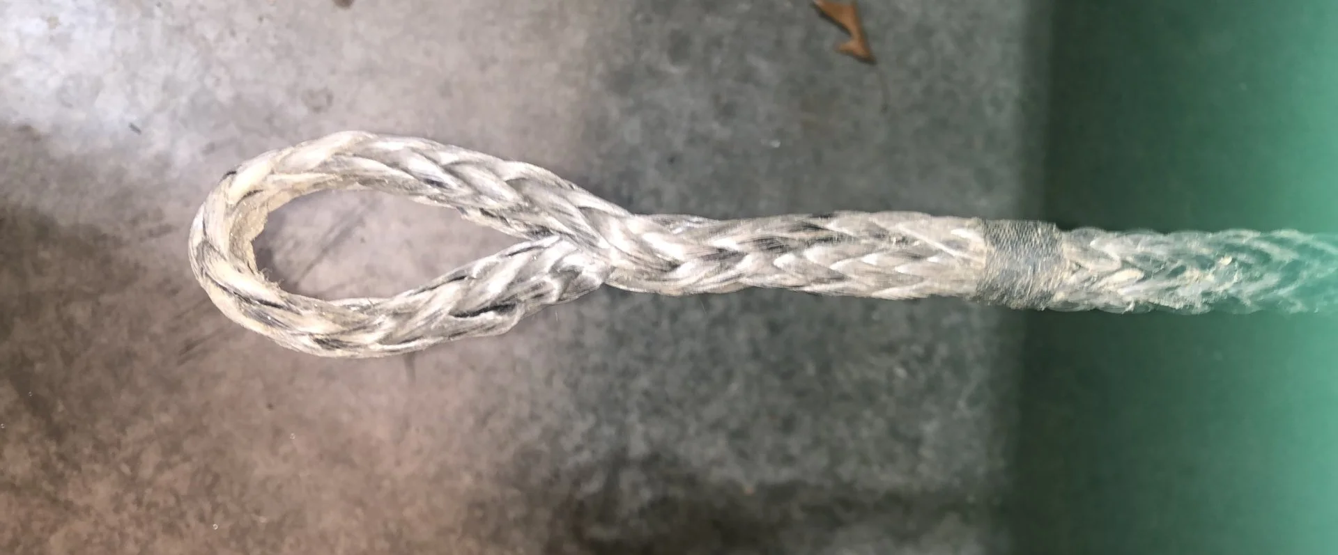

The whip helps prevent your lock from creeping when not under tension. You wouldn't need to whip a field splice, but it is good for more permanent termination.
The loop is a double brummel lock splice. That alone is enough to lock the loop from creeping when under tension.

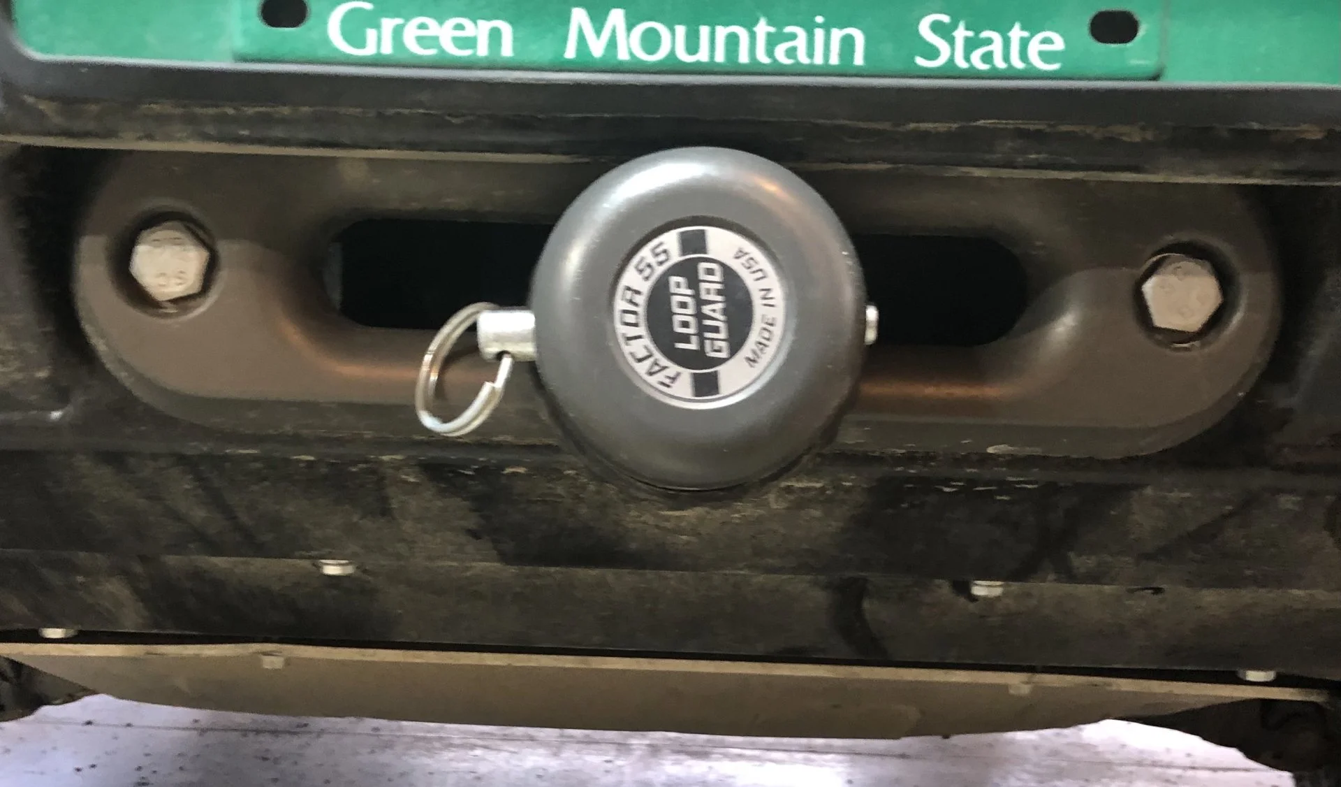

That loop guard prevents the loop from being spooled. It has a removable pin, you pop it off and stow it when you spool out your line. In a perfect world the loop on the pin would be oriented upward, but it doesn't fit like that on the TJM T13 for 16+ (there is a steel piece in the way).

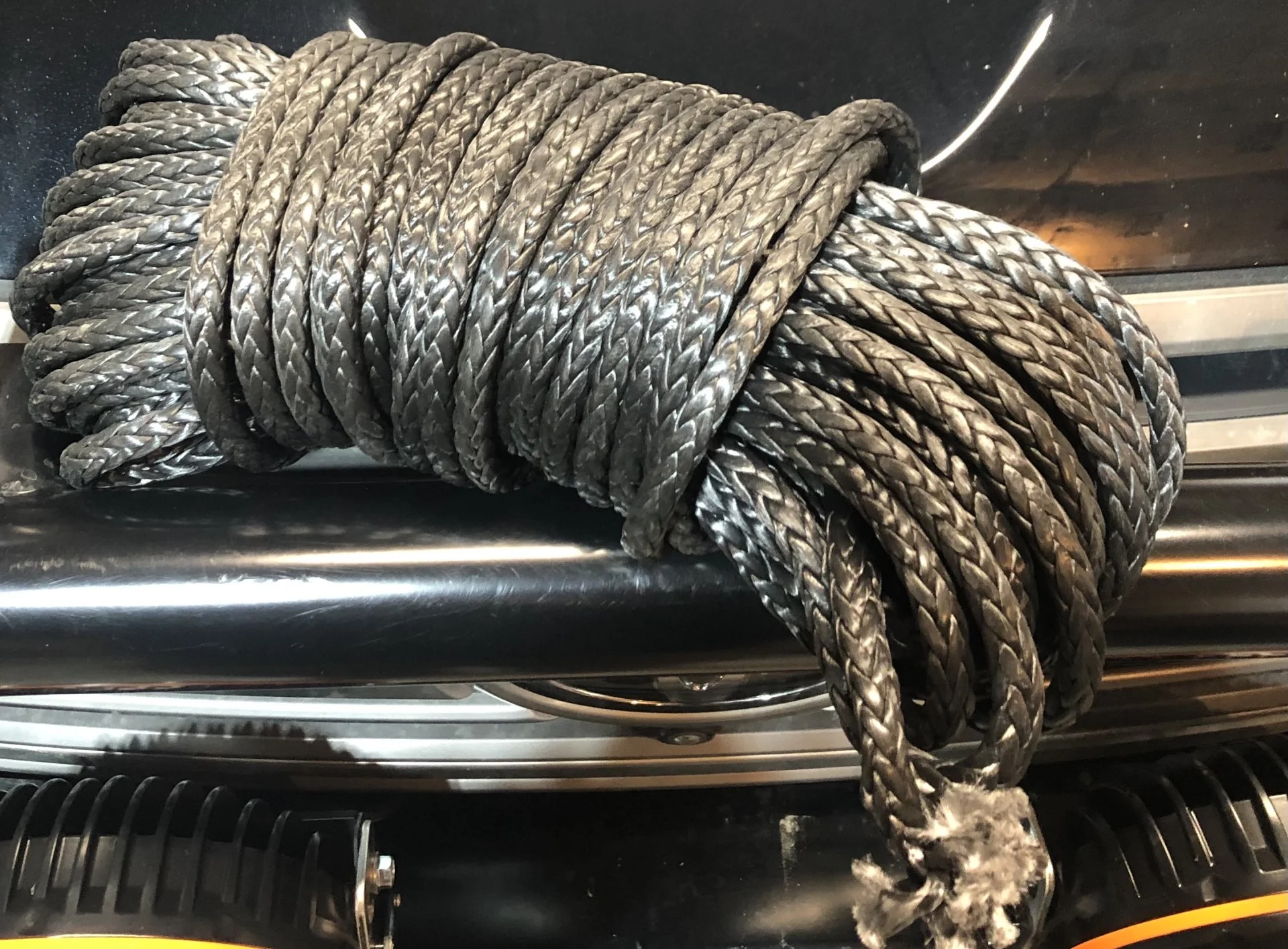

You also need a very sharp blade or scissors - the strands of the line are VERY hard to cut.
The yellow tape is to mark rope damage for later replacement or repair. And for marking the maximum extension of the rope off the spool (you need to maintain a minimum number of wraps).
The sharpies are for marking bury depths and cuts - black for light line and silver for dark line.
The fid is used for measuring too (like bury depth).

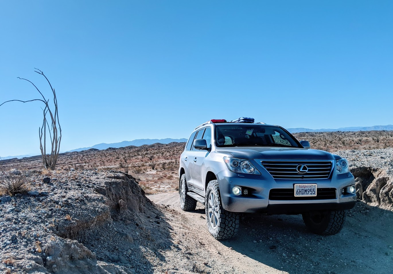

Long time in coming. A build thread for my ‘09 LX570. Hereby known as FLX. Yes, some mild flexing from an understated Lexus. And playing on the F-LX name and what an LX-F could be.
A core goal with the build is to have FLX-ibility. To not build with a single purpose in mind. It’s not a rock crawler, not an dedicated off-roader, not a heavy hauler, and not an overland camper. Yet it can do all those things without spoiling day to day usability as Lexus delivered it. Double date night, minivan duty for 8, tow pig, or heavy hauling; none of that has been compromised in this build. Expanding its capability envelope, beyond stock, without compromising its core virtues would describe my build well.
I would like to think It touches on some of Lexus F sensibilities and philosophies, built with some OEM considerations for engineering and balance. To perhaps imagine what a more aggressive factory performance effort could be if such a thing existed for the 200-series. As a trained and practicing engineer, my profession is about making considered design decisions for trade space, executing, and delivering aircraft designs capable of meeting production requirements. The goal with FLX is modify to expand capabilities in off-road angles and clearance (~6" total lift), increasing capacities (2,000lb payload), driving range (500 miles), minimize impacts to ride, efficiency, and handling, while returning parameters back to stock for things like suspension geometry, gearing, brakes. To that end, I prefer to use OEM parts where possible. As much as I like to modify cars, and this certainly isn’t my first rodeo, I find factory parts are far and away more engineered and reliable than aftermarket stuff. Components that go through real analysis, testing, and validation.
One major consideration to the build is to maximize payload and towing capacity. So not adding too much weight was a big factor. Weight is the great equalizer which compromises so many things including every performance measure, capability, and durability. The build has to continue to tow an 8,000lb travel trailer, or haul 2,000lb payloads. So maintaining payload for utility and performance has been paramount.
This build thread is a bit different as it’s a collection of build topics across different threads, and a retrospective look as many of the upgrades have long been done. Hopefully this also answers questions I often get about my build over PM, as this catalogs and links to various more in depth upgrade threads.
FLX has been built over several phases but is close to its final form now. More build philosophy in post #3 below, but let's first get right to the build list.
