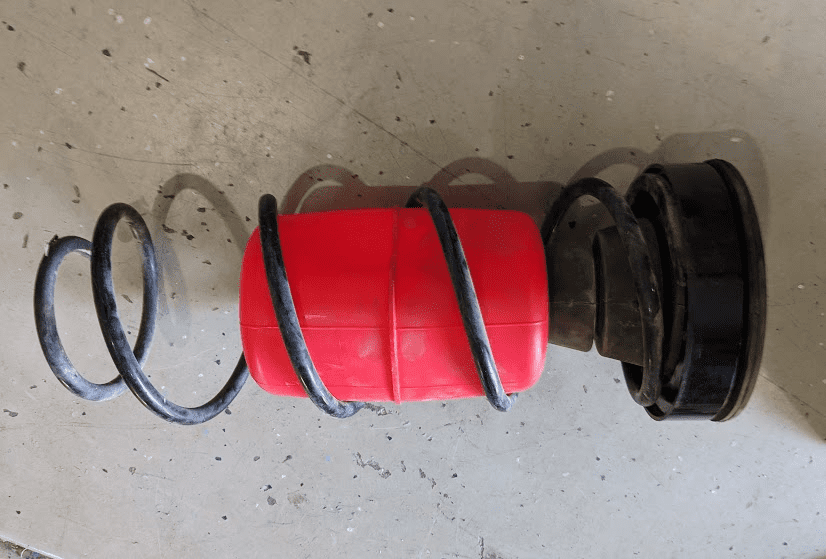

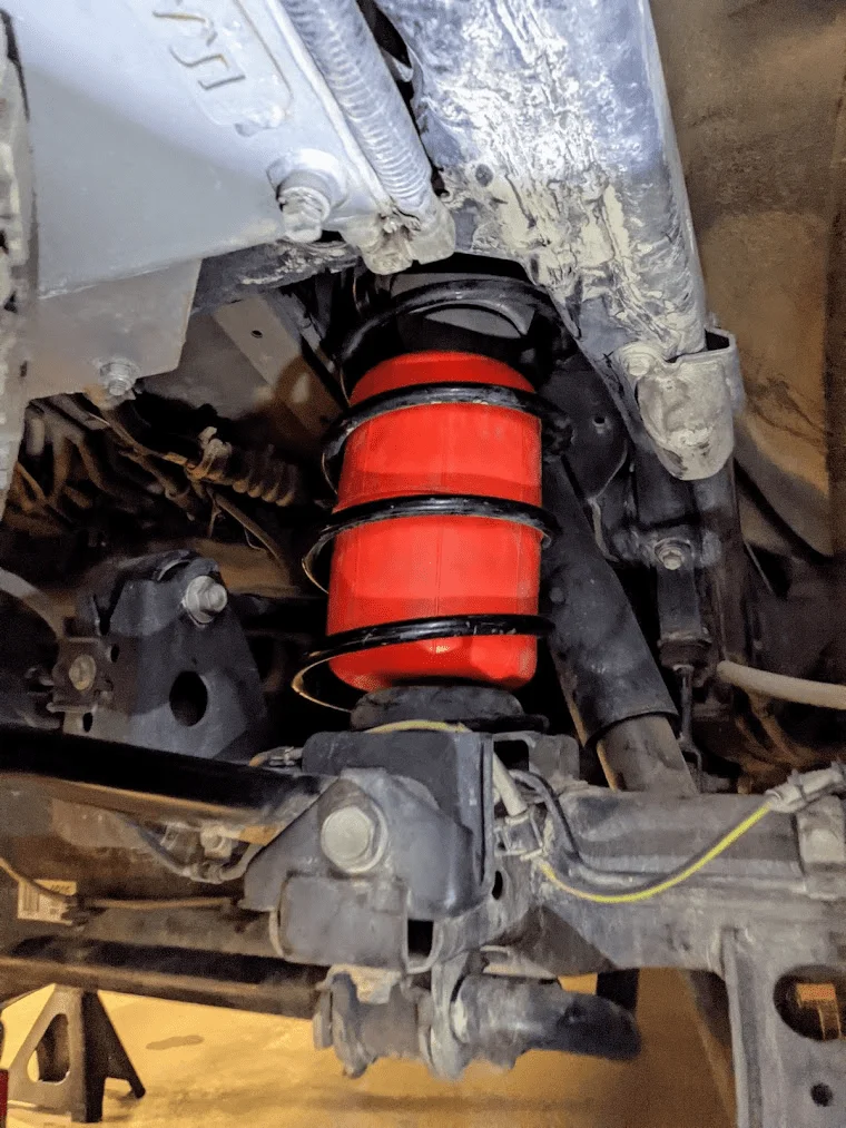

As I installed this more as an experiment, I wanted to minimize mods that were done to the vehicle. The airbags I'm using is Air Lift 60728, meant for the 100-series. I believe they are shorter in free length than what is normally spec'd for the 200-series. Diameter fits correctly in the coil. Shorter works to my advantage IMO.
I didn't cut the stock jounce limiter aggressively, and only took one segment off (of 4). Fully installed, this shorter bag still has 1/2" free length clearance as full droop per the installation guide.
Here's the stack up. Note I also have a 30mm spacer at the top to augment AHC for weight and sensor lift, so I'm not reliant on the airbags at all. They are supplementary which is the way I want them as airbags can have limitations for full articulation, both in compression and extension.
Here's where I ran the airlines. There's a convenient bracket for the tailgate torsion bar (LX only) that already has to available holes. I believe this bracket also exists for the LC? Bent the bracket down a bit to have a better angle to fill. And enlarge the hole just a tad with a stepped bit and the Schrader valves fit nicely.

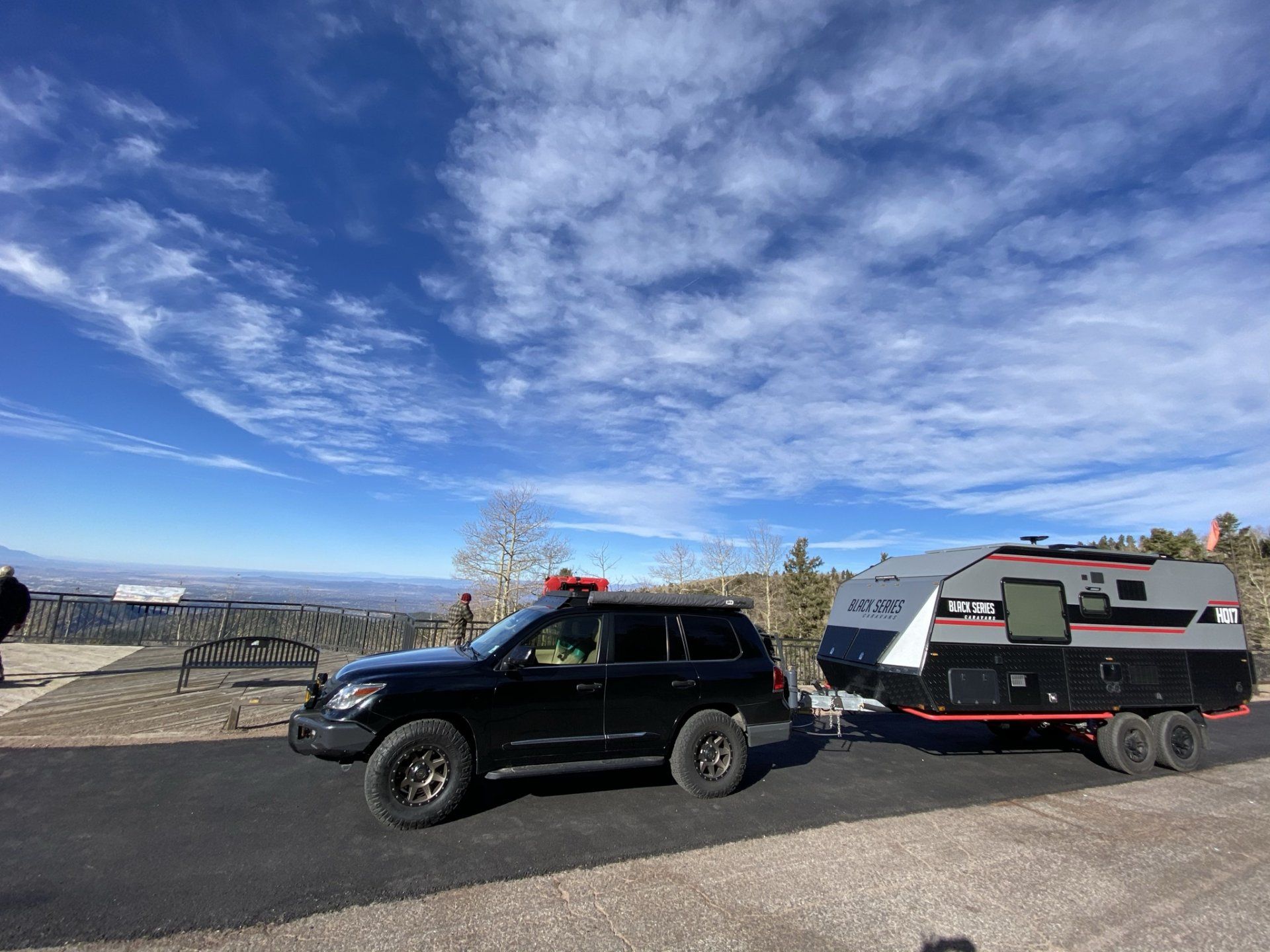

Back on topic of AHC, the bags really actually help in my day to day driving, and I really am not sure how I’m any heavier than the rest of the rigs fully outfitted. Need to get some true axle weights but we take it easy. I imagine if I throw the heavy Tepui back up on the rack, the bags would be a huge help at camp like you said.
The WDH made all the difference in highway stability and did allow for “Normal” height but you go off road and if forced to remove them, it struggles to stay in Normal even with the bags (30lb max for some reason).

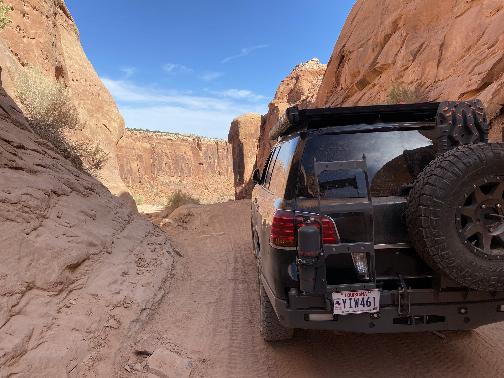

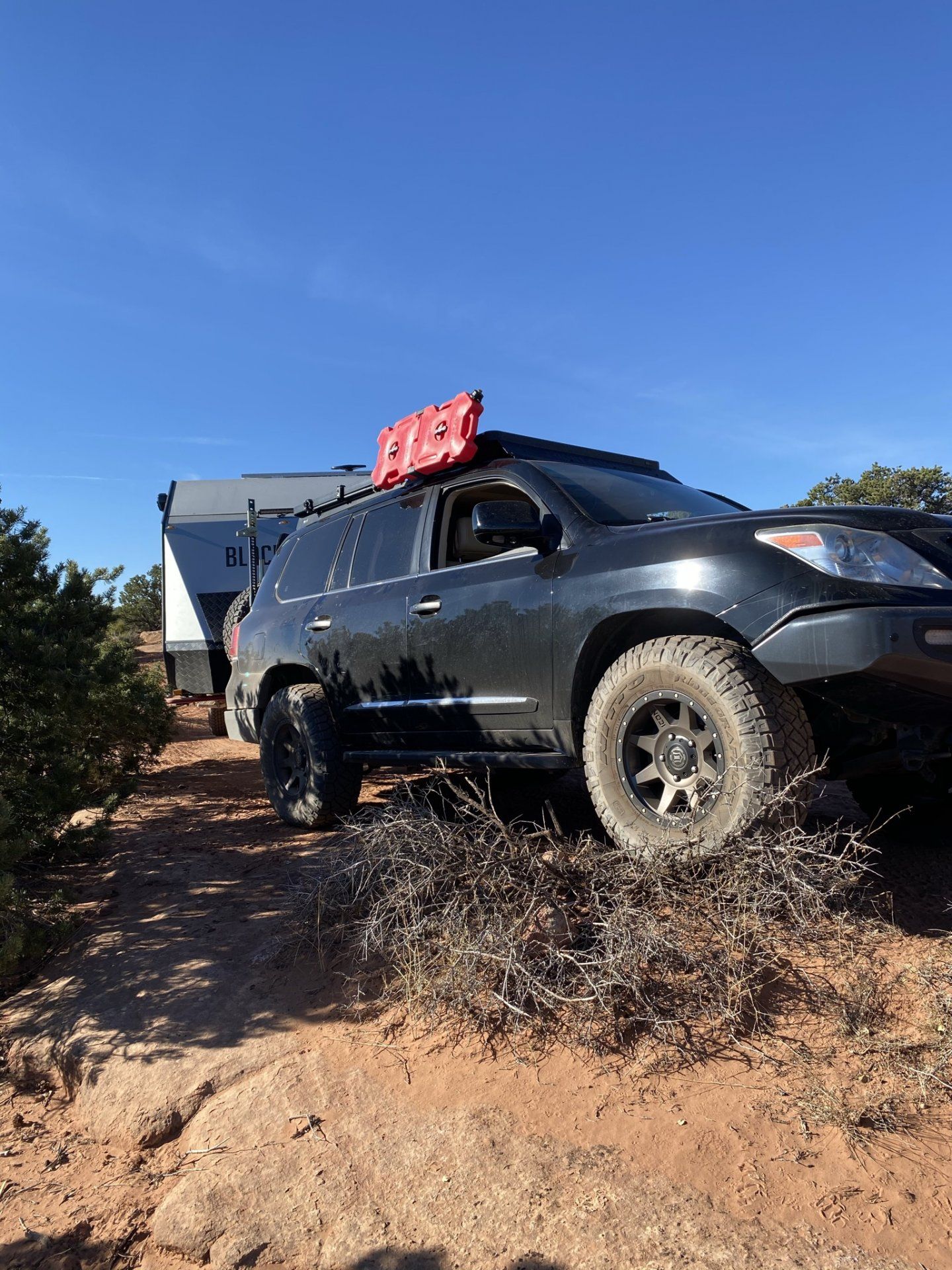

I added insult to injury when upgrading my propane to dual 40lb tanks up front on the camper.
I don’t mean to hijack so these pics are to show the bags are keeping it in normal. Couldn’t hit “High” and I could have used it as you can see.

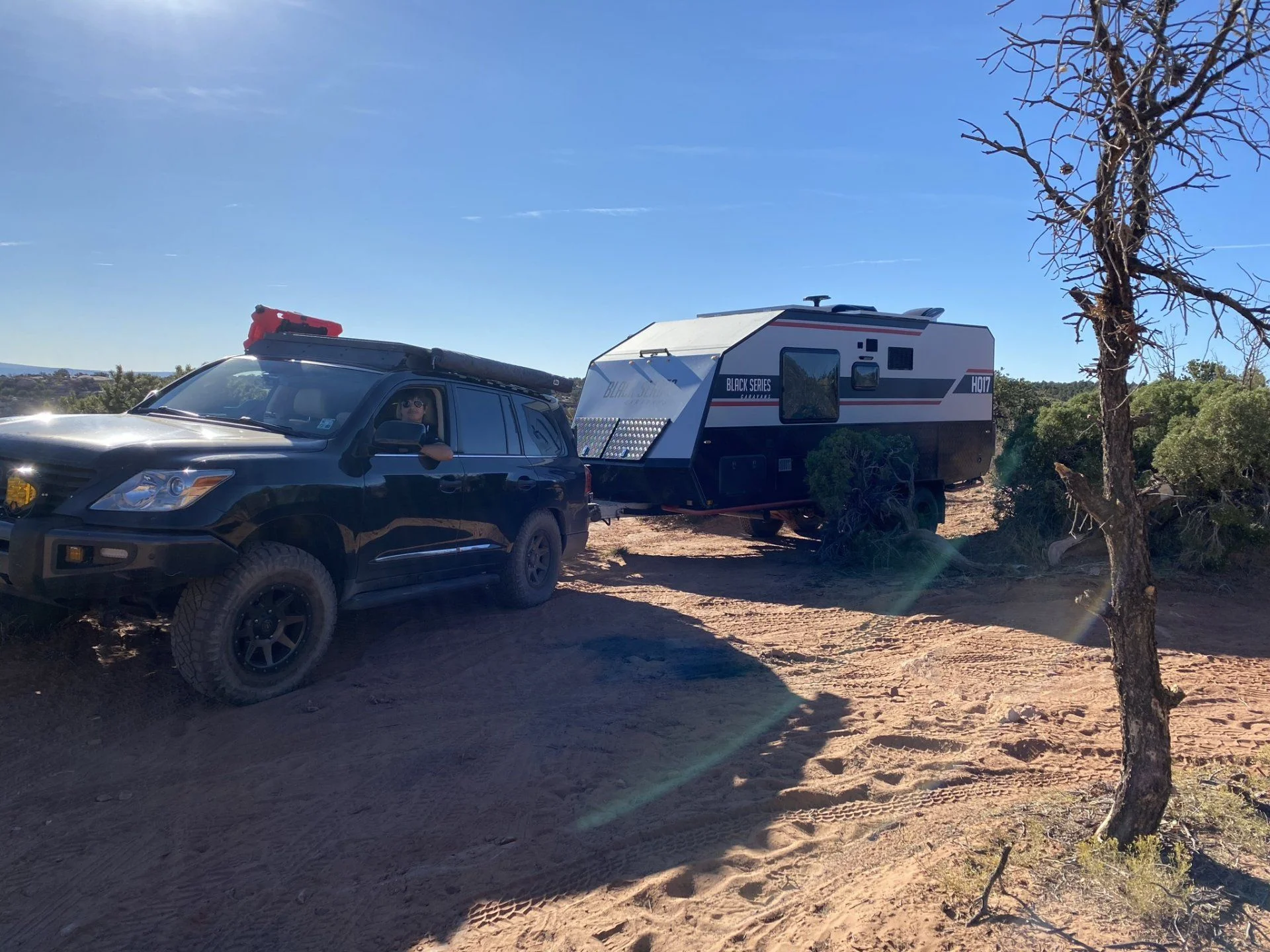

Our first real Moab/Colorado camping trip was pretty awesome from Louisiana last Fall. If only Texas wasn’t so damn big we’d go more often!
About 800 miles in, fully laden with the camper, and airbags set at 10 PSI in normal position.
