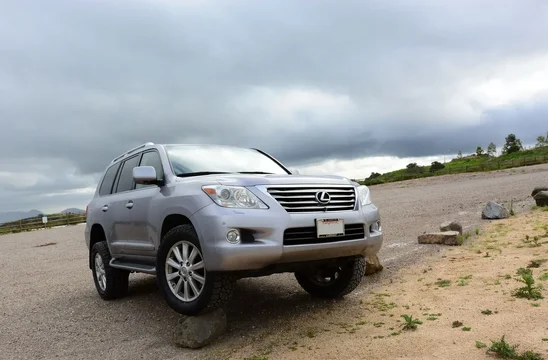

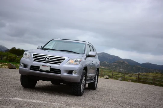

Never thought I'd enjoy 20's, but combined with a larger tire that gives it some sidewall, she's sitting pretty. I wanted 305s partly for the look, but it also keeps the stock 8.5" width wheel more inset and protected (8.5" was the narrowest wheel for this fitment).
With AHC, it's really a nice setup. Ingress, egress, and loading is still easy with it in low. It sits up plenty high for me at the neutral position. And on demand high when called on. I don't think I'll bother with lifting the normal position (AHC sensor lift, can easily adjust 1.25" taller to all L/M/H positions without any mods).
These are Falken Wildpeak A/T3Ws in 305/55/20 LT load E. On stock LX570 20x8.5" +60mm wheels. Added a 1" spacer all around (effective offset 35mm). Spacer was absolutely necessary to clear suspension arms as it just clears at full lock. Only other mods was to remove mudflap (for now until I re-contour them), and pull forward the leading edge splash guard.

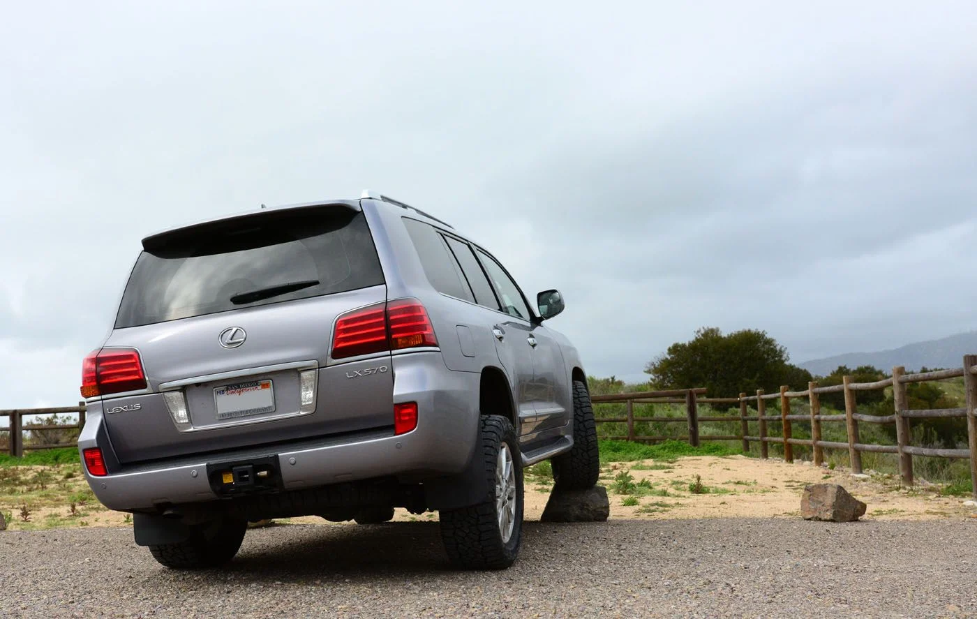

Got a question asking how flush the tire setup is with 305s and 1" spacers on stock 60mm offset wheels.
Pretty darn flush, and shouldn't have any problems tucking when articulated. Front tire is slightly turned left.
