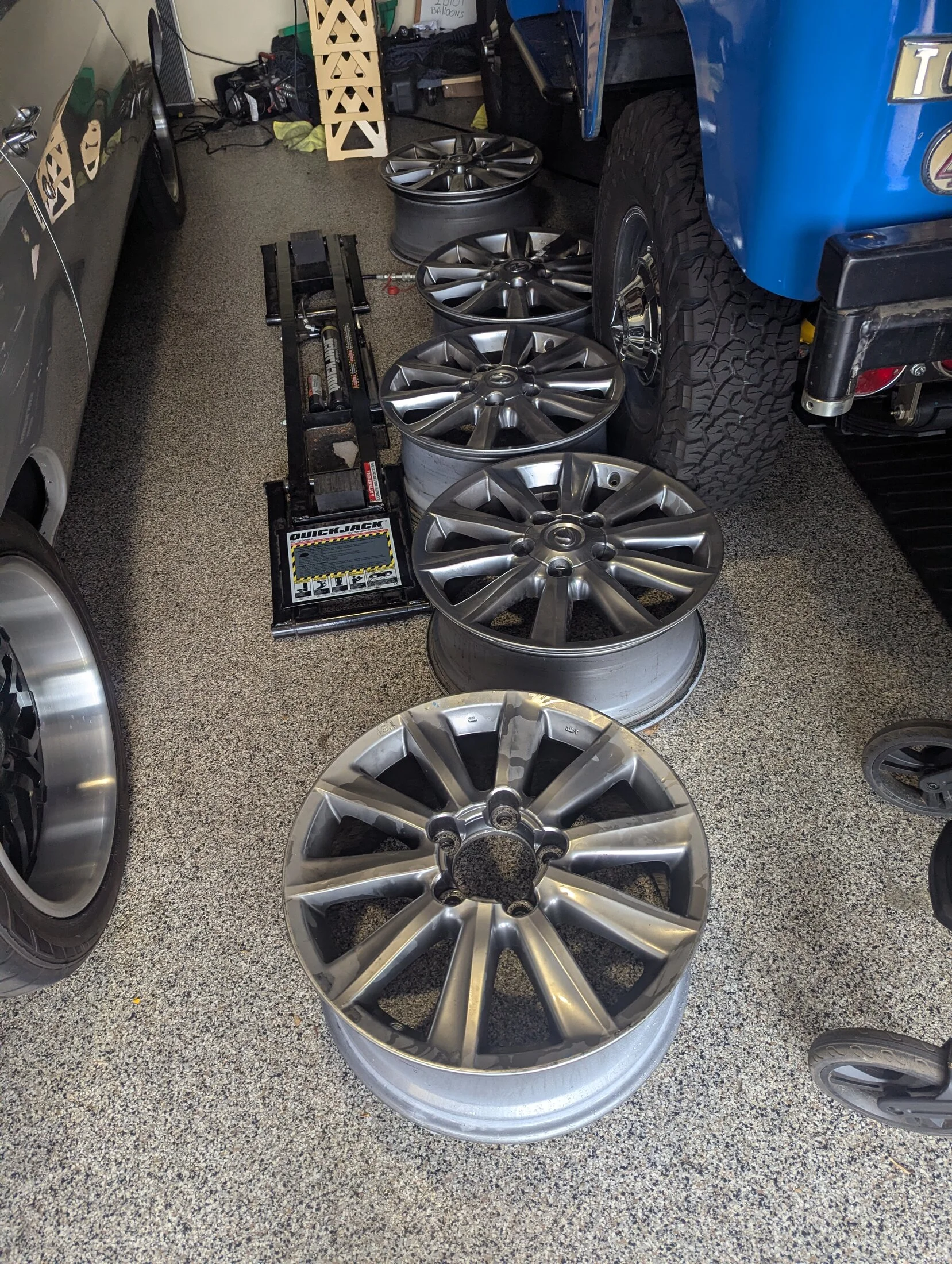

Im curious what people have paid for their TRD Tundra wheels 18. I found a set of the black/Grey for $600.
I paid 300 for what's pictured on my LX. I only bought 4 wheels and 1 had some slight rash. My spare is a tundra steel wheel
$300 is a great. Most area me are going for $500-600
5 LX OEM wheels for sale. 3 in good shape and 2 with some rash.

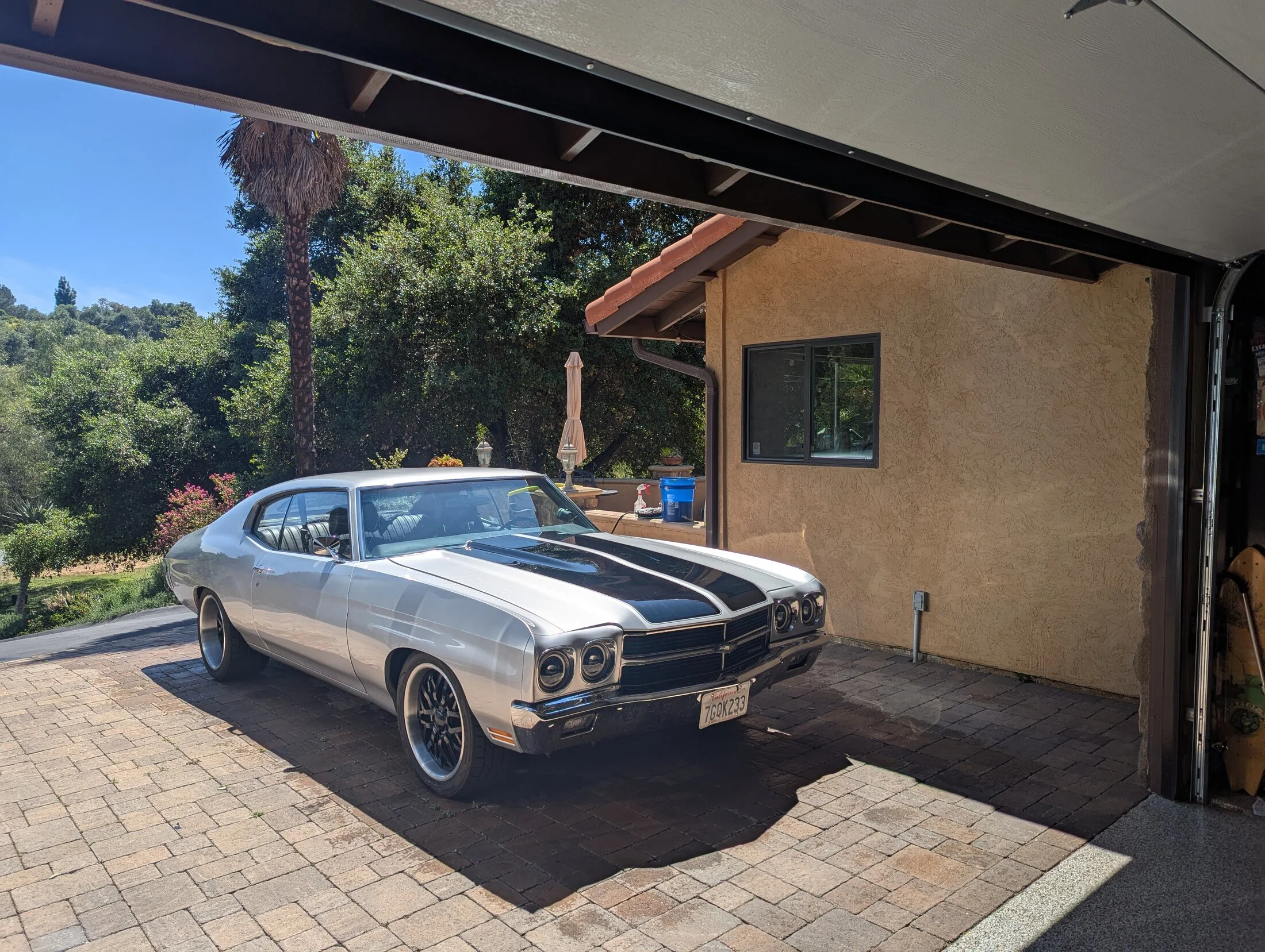

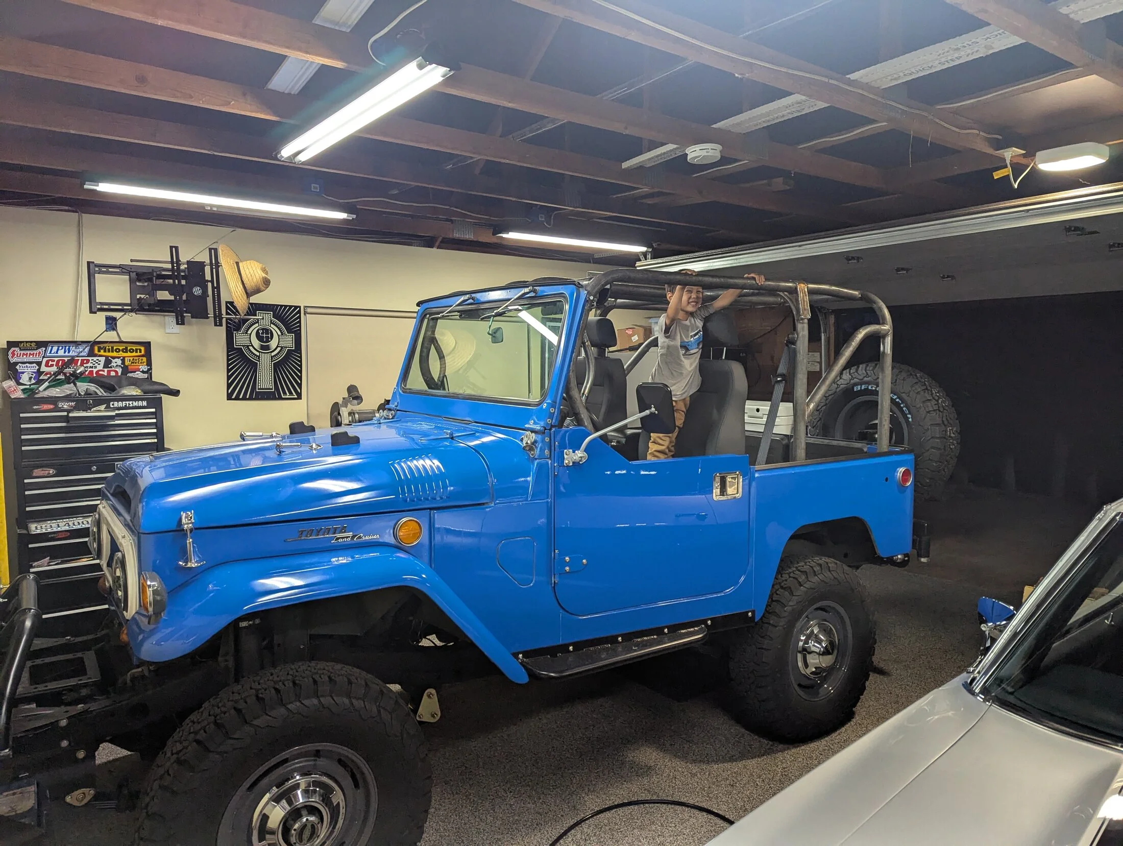

Hi @LuckyDog ! Long time no see! Hope all is well on your end. Chevelle is still here chugging along. I sold our Blue FJ40 right after we left Washington, and 11 years later it popped up 15miles from us in Encinitas. So we bought it back and I've been chipping away at it. How's your FJ40 coming along? After kid#2 we needed a better family hauler which is what sparked this LX570 purchase
I've seen this Chevelle in person, and its.... (insert drool emoji)
So cool that your old FJ came back to you.
Chevelle still looks great, happy you still have it.
Second kid, wow, I've been away.. First has to be a teen by now.
69 Firebird project went in front of the FJ. With it off to paint I'm starting to do some work on it.
I'll have to look you (and family) up the next time I get out that way. Maybe sometime this summer when I do a visual check on the 'bird body and paint progress.

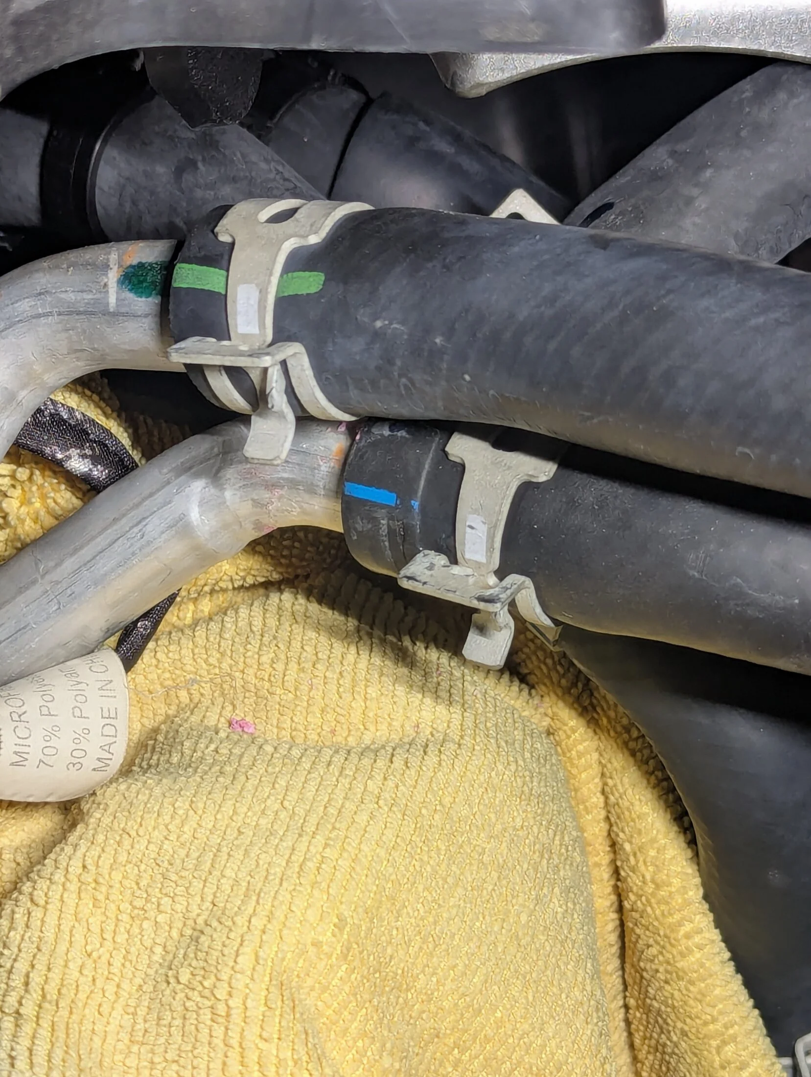

When I replaced the radiator I ordered the heater T's and hoses as well using part numbers from a thread here. I did receive the updated T's but I'm wondering if I got the wrong hoses. The lower one won't seal despite being brand new with new clamps. I noticed I have a blue paint mark vs. a orange one
Problem solved and it was my fault. When I cut the old hose off, I scratched the hard line for the rear heater. I took a Jeweler's file and knocked down the scratch, put the hose back and threw on a new spring clamp I had. It's been fine over the last day or so.
