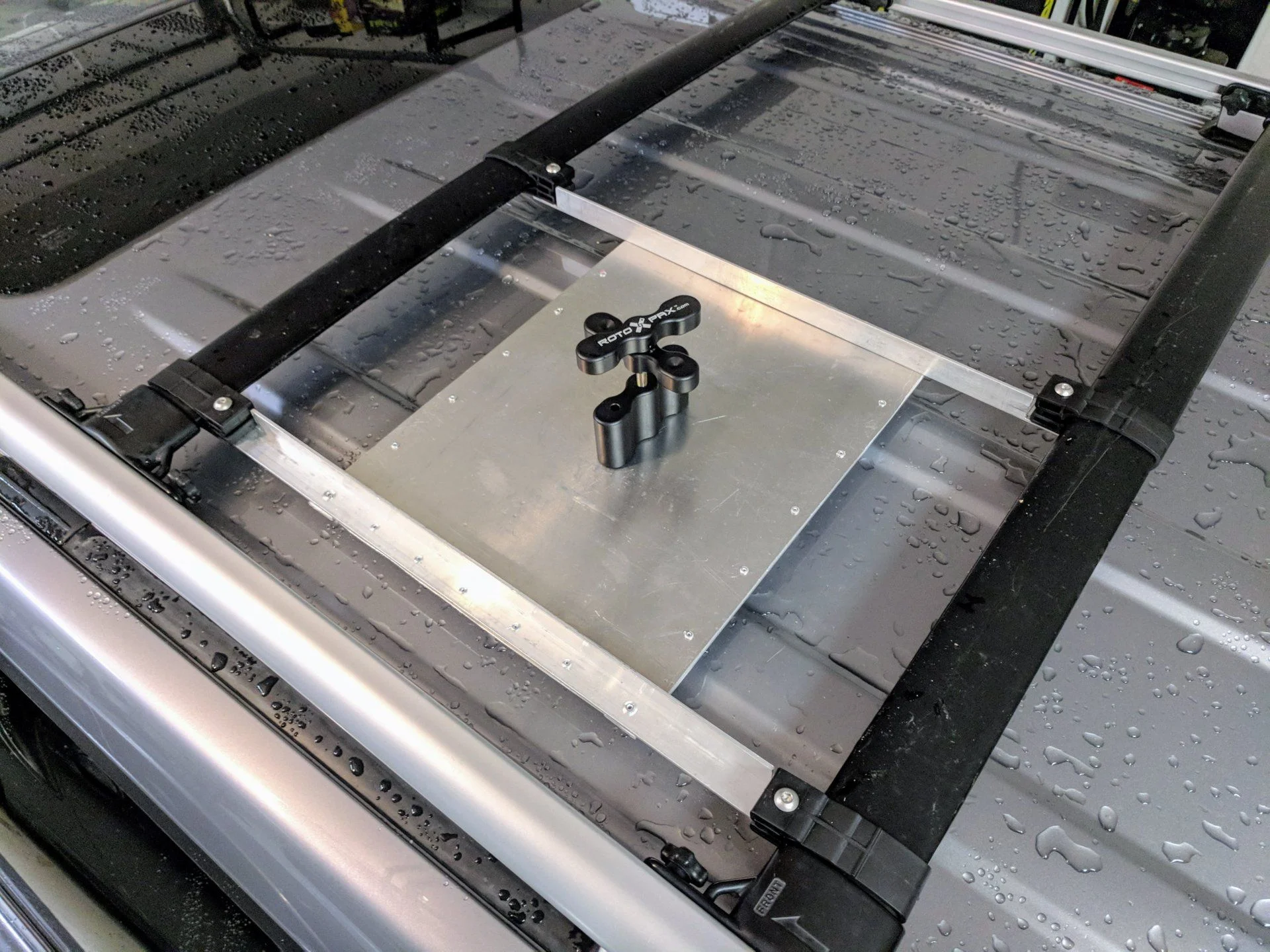

Sneak peak at a little project I did today. RotopaX storage on OE crossbars. Will write up more about it later.
As a I tow an RV, I needed a fuel canister for 2x reasons: generator to power A/C, and extra fuel margin as towing nets me 10-11 mpg. Wanted a secure exterior place to mount this.
Surprisingly, there are no RotopaX kits out there adaptable to OEM crossbars. So rolled my own:
1) Made of AL extrusions and sheet, riveted together.
2) Yakima MightyMounts 23H.
3) RotopaX RX-DLX-PM Deluxe Pack Mount

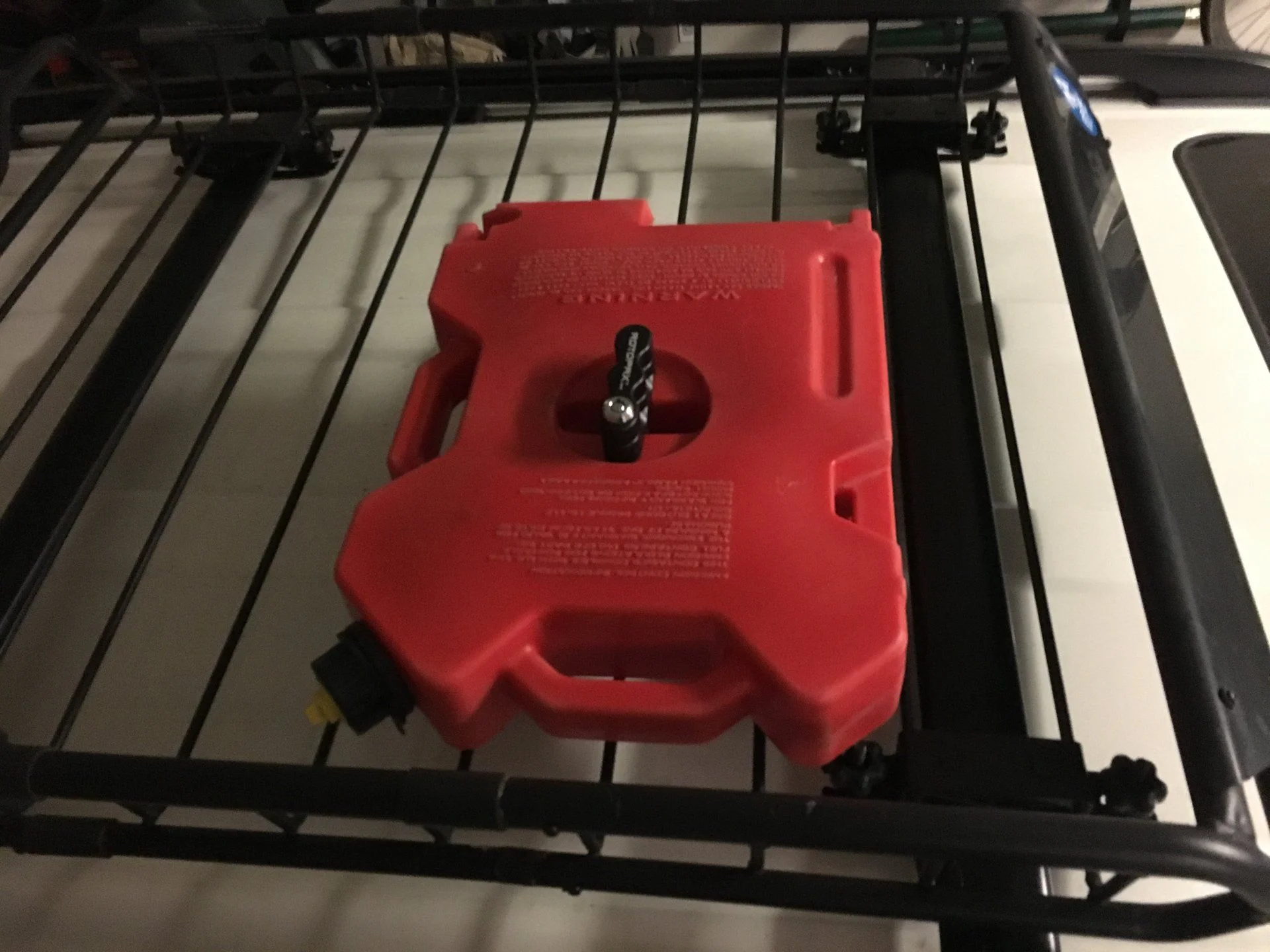

Very clean job! No lock? I just did this, attached to my cheap roof rack.
Sure a lock would be more secure. But guess I've not had issues in the camping world.
Nice and simple, but as an ex-A&P I need to warn you that the design is a little suspect. Normally you want the load going down onto the flat plate, and pushing the plate onto the angles. Yours appears to be hanging all the weight from the small rivet tails.
If the angles were flipped 180 degres the mount would be much stronger.
Keep an eye on those rivets, they will loosen.... you don’t want a can of fuel coming loose on your roof.

Fair assessment. And I absolutely agree with you.
I did debate this and flipping the angle outwards was driven by the want to keep the overall length short. By turning them in, the yakima mounts would interfere with the tank in the corners.
I looked for short machine screws to fit in the key corners of the plate where it meets the angles and flat bars. Didn't have any on hand so went with larger 3/8" rivets.
With your feedback, I will surely replace those with screws next time I'm at the hardware store. :cheers:
As an alternative, and as a failsafe, you could get a 1 inch ratchet strap and wrap it around the angles and can. Cinch it tight with the loose tail tucked under the strap. Problem solved.
