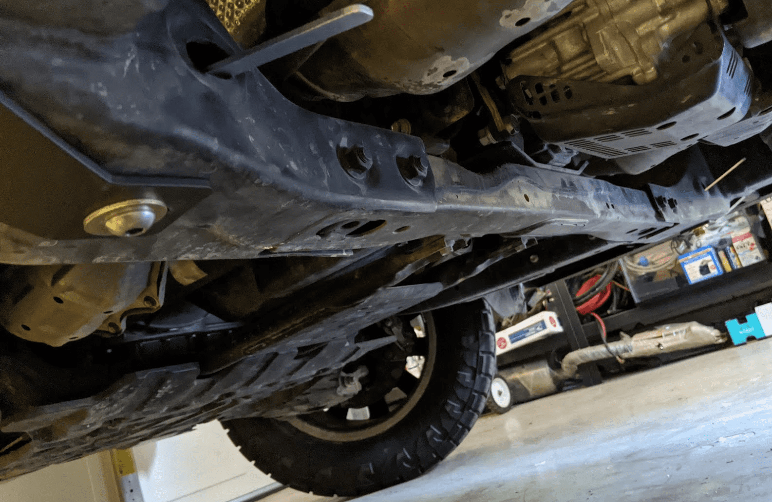

Where the slidersteps tie into the transmission cross member, Slee uses a standard hex bolt, lock washer, washer combination. It's a low point and hangs down further than I like, which could be a potential snag point. I opted for some allen button head bolts (1/2 in-13 X 1-1/4 in) to reduce the profile. Also used blue loctite in place of the lock washer.

Geez. With 35's and AHC, you can camp out under there. ⛺
I'm a little jealous.
Funny cause I just changed my oil today. There's elbow room galore to maneuver without any jacking. :cheers:

looking great! just for reference, we've been slowly going away from button head allens (or flat heads) where they could get whacked hard. The reason being that is can destroy the Allen hole and make it incredibly difficult to service. with a standard hex, generally you can get something on it no matter how buggered it is. Totally get the hang-up point though, been there. cheers!
