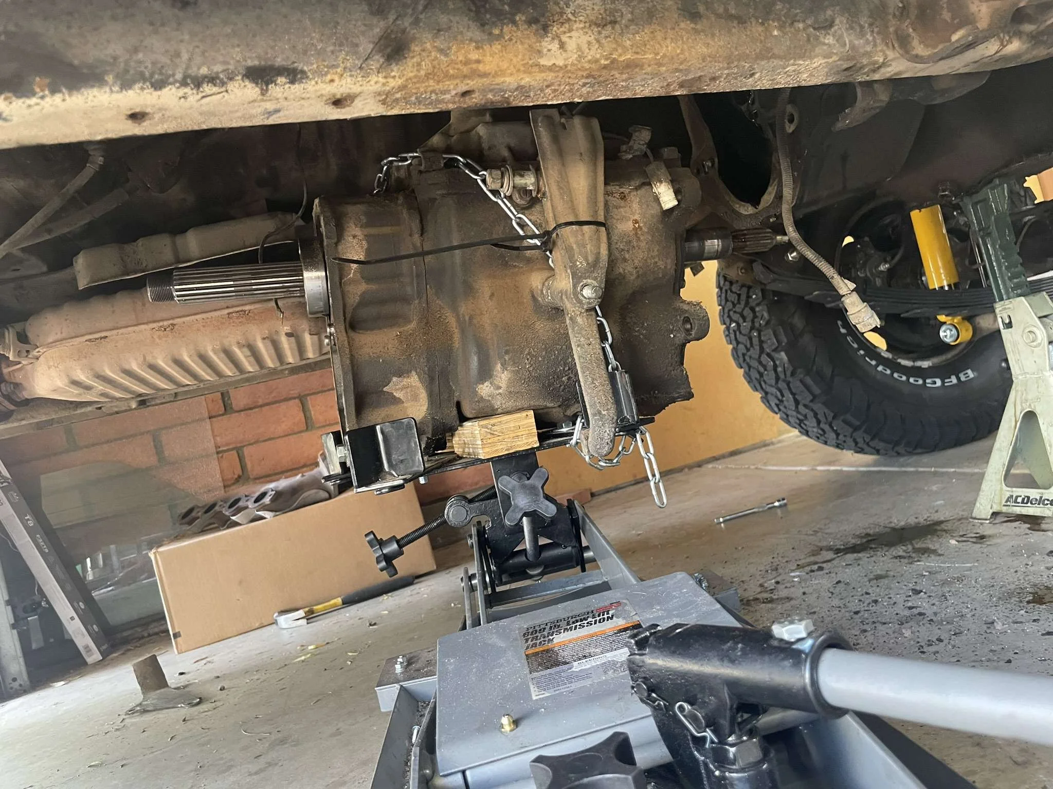

You don't really want to get the frame high enough to sit under; once it's high enough to clear the transmission on the jack, it'll be a pain to reach up and get the top stuff connected. Any higher is a real PITA.
Word of advice: bolt the transfer on before you slide the transmission under the frame.
Duly noted. Just reacting to how convenient it was to pull and replace the trans this last month on Jimmy's lift. When I am working on this rig on the ground, I am like mid crunch. I may be a wee shy of an adonis but that is tough. I'll figure it out though as I am getting pretty far ahead of myself.

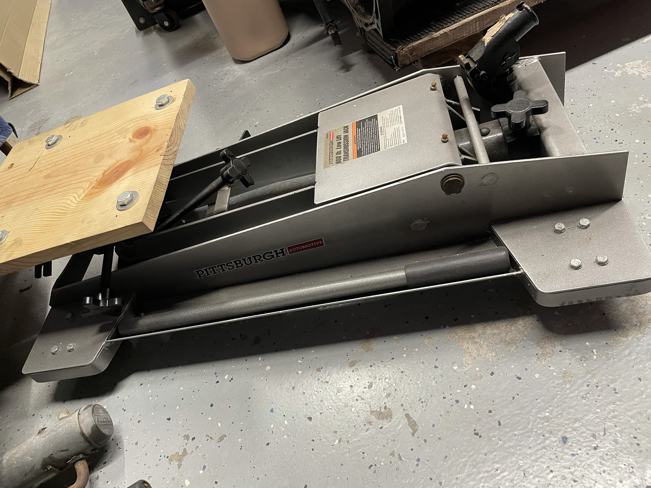

The 800 lb model is sufficient. The tilt-a-whirl adjustable base is super nice to have. I made a wood platform and ratchet strapped it all together.
View attachment 3776440View attachment 3776441
I currently have a motorcycle jack on loan, which I do have to return but it has a flat pair of skids for a bike (or flat bottomed trans) to sit on. Worked fine for the J30 plus transfer, but the flat bottom of the A440F might be even easier. Main concern is the transfer throwing things off?

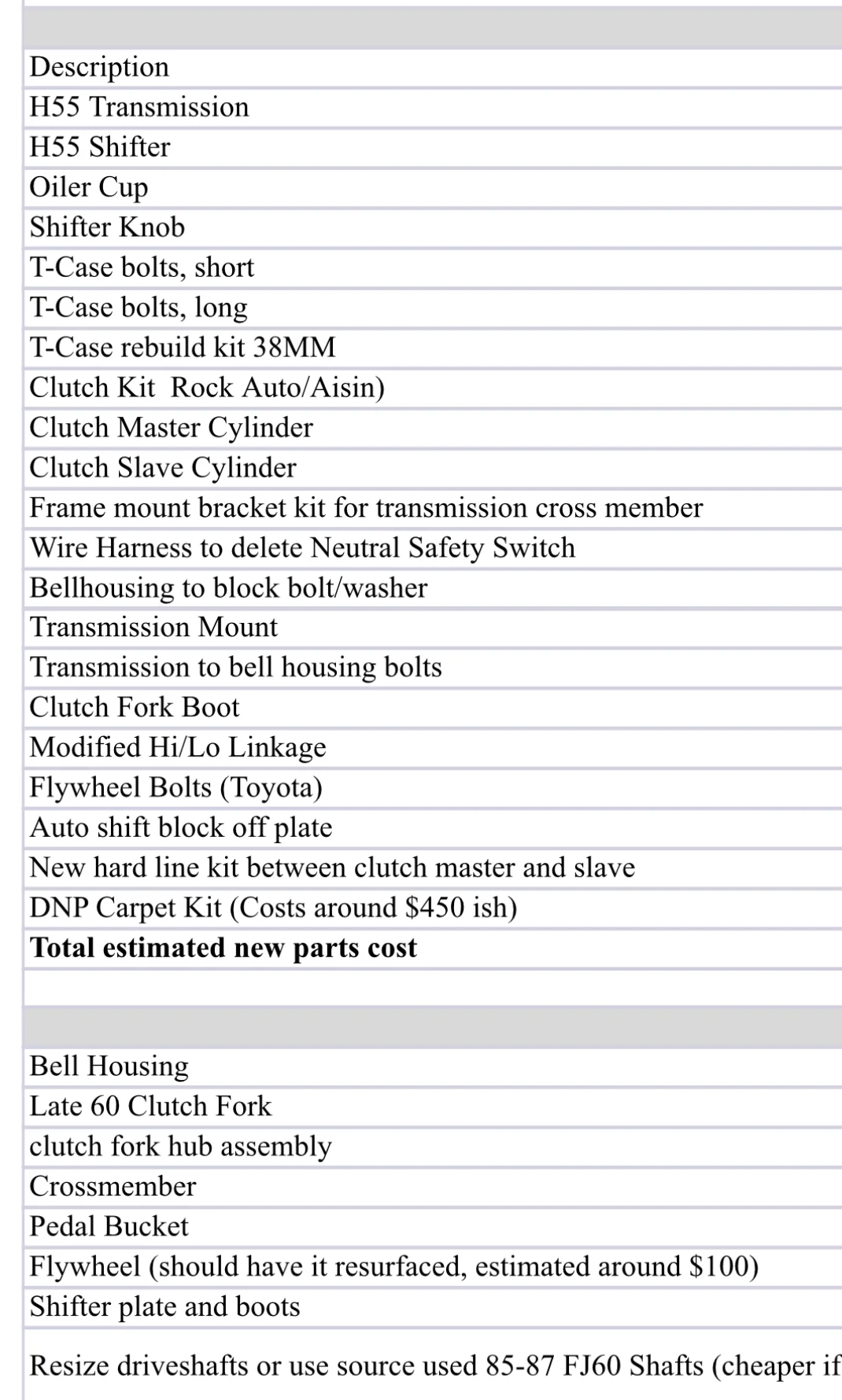

Other than the transmission, what is the hardest thing to obtain for an A440f to manual conversion?
Asking for a friend
trans isn't hard to find versus other bits
3F bellhousing cover
trans hump cover and boots
you need to decide if keeping vacuum transfer or going manual
or get a combo ready to bolt in from a few vendors
That's the exact same trans jack I used to pull my H42, made it really easy. I did have to jack the truck up a tad to get the shifter plate to clear the frame rail.

Auto to manual conversion list
Here is a list that Jimmy shared with me. It’s outdated as far as prices go and it was for a customer so I cropped it to just the list of parts.
Naturally there are some caveats here but my mando calrissian Jimmy has done enough of these swaps that I’ll take this list as gospel for the most part.
