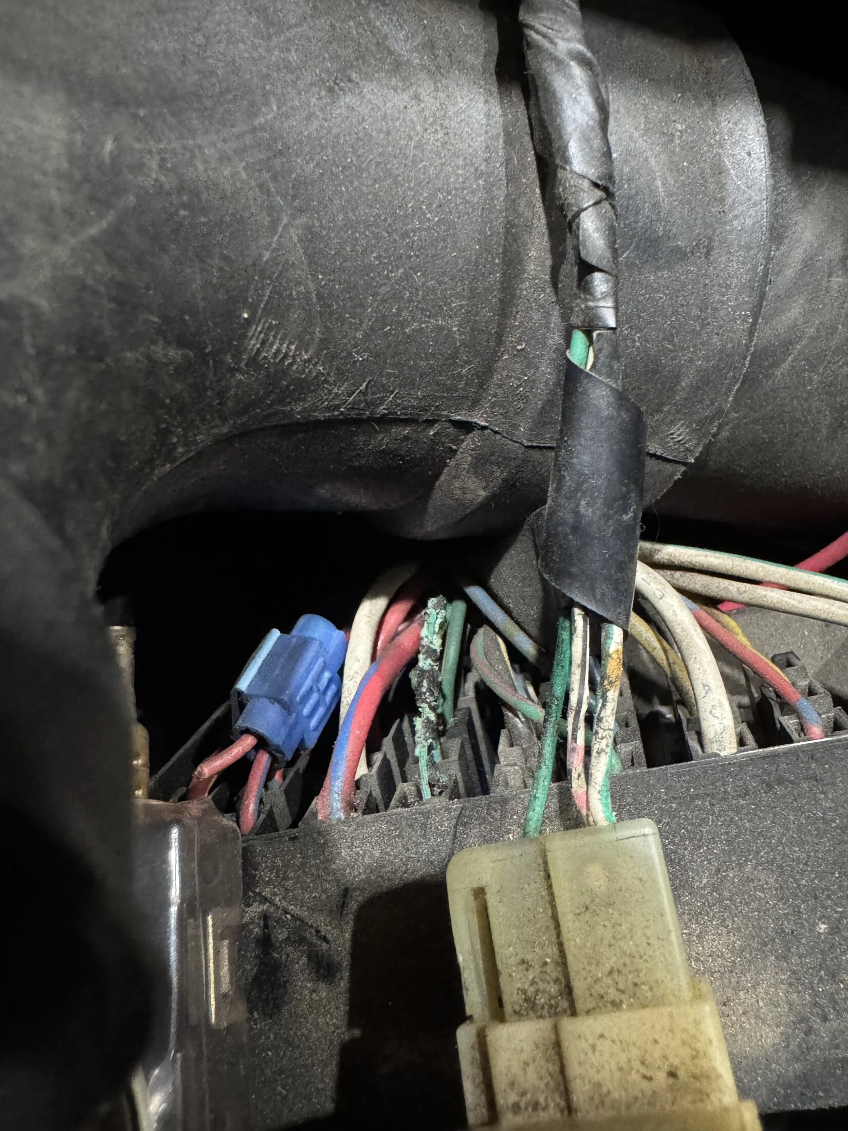

Burnt spagetti wire fun! The melting shown in the two picks doest seem to go further into the harness. just whats shown in photo. If anyone is good with electrical input appreciated. The plastic clip shown in the first and last pictures was a loose and unclipped, I have no clue where its supposed to go after looking intensively. It could have totally grounded itself.
Context: I Was going to drive the rig home today the 2.5 hours and couldnt get the headlights working. In fact I found the horn, blinkers, hazards, door beep (except when WIPER relay is pulled (WTF?) aren't working either. They were working before, although the headlights would intermittently shut off. Replaced the alternator and some split wires throughout the engine bay, including the black plug by the charcoal canister, and one by the headlights. Its only after turning the rig on after 2 weeks of work regarding steering box and basic electrical repair that all 5 of these components stooped working as well.
Engine grounds and other Grounds looks good (along with one for radio etc), fusible link looks good. no fuses blown.
Ive had melted plastic around the tailight fuse since I bought the truck. The PO (total dumbass based on the state of this rig) stuck a 30 amp fuse in there and the taillights work so i didn't dig in further. Part of me thinks this happened a while ago, and maybe has gotten worse? Or the new alternator (which IS working, rig runs fine etc) somehow exacerbated the electrical problem due to proper charging? (my last alt was going out.)
Lucky I Happened to notice these wires were cooked, along with the wires going into the tail light fuse. Weirdly though,
taillights work perfectly fine BTW
QUESTIONS :
1. How does one fix this, and where can I replace this plastic piece? Im assuming cut the wires back to the unburnt section, and find something similar at O'Reillys in terms of plastic piece? Does order of green wires matter when I reinstall?
Dash is off, gauge cluster out.
2.I also have melted plastic on the fuse panel, just in the taillight fuse. Confirmed, only some of the fuses getting voltage, but some of the ones that are getting voltage dont work and some that arent getting voltage DO work. strange. Does this mean I should replace the whole fuse panel? NLA?

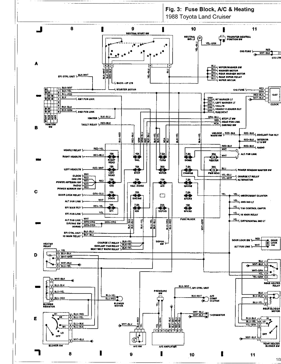

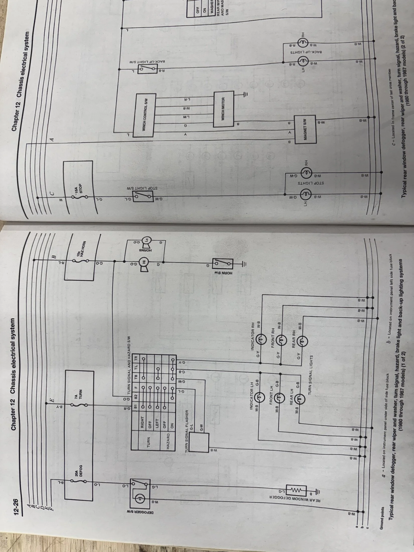

3. I cant seem to find it on the wiring diagram Im not great with electrical but the farm mechanic on my familys farm is helping me is passable at electrical stuff, so a good diagram is appreciated. (photo 5 is what I have found so far.)

What year you have would help, pretty sure it’s a 60 and not a 62 series. Here’s the link to the wiring diagram for an ‘83 60.

Based on the poor pics and long description, I’m going to say your burnt wires are in the dash behind the gauge cluster on the far left side like fuse block? The impacted circuits are wipers, lights, horn from your description and the color of burnt wires. Looking at the pics I see a red wire wrapped around sharp metal where the tilt column spring goes. There’s a vampire tap on the red/blue wire that goes to? The wiring for aftermarket radio looks like a cluster of ***s. All of these are potential issues.
First you need to pull every fuse and check them with an ohmmeter or just replace them. Ensure every fuse is the correct amp rating for the circuit. Then check all bulbs, may as well just replace them, and check the bulb sockets for corrosion.
Those wires likely burned because too large of a fuse was used and when they shorted, the wire became the fuse instead of the fuse itself.

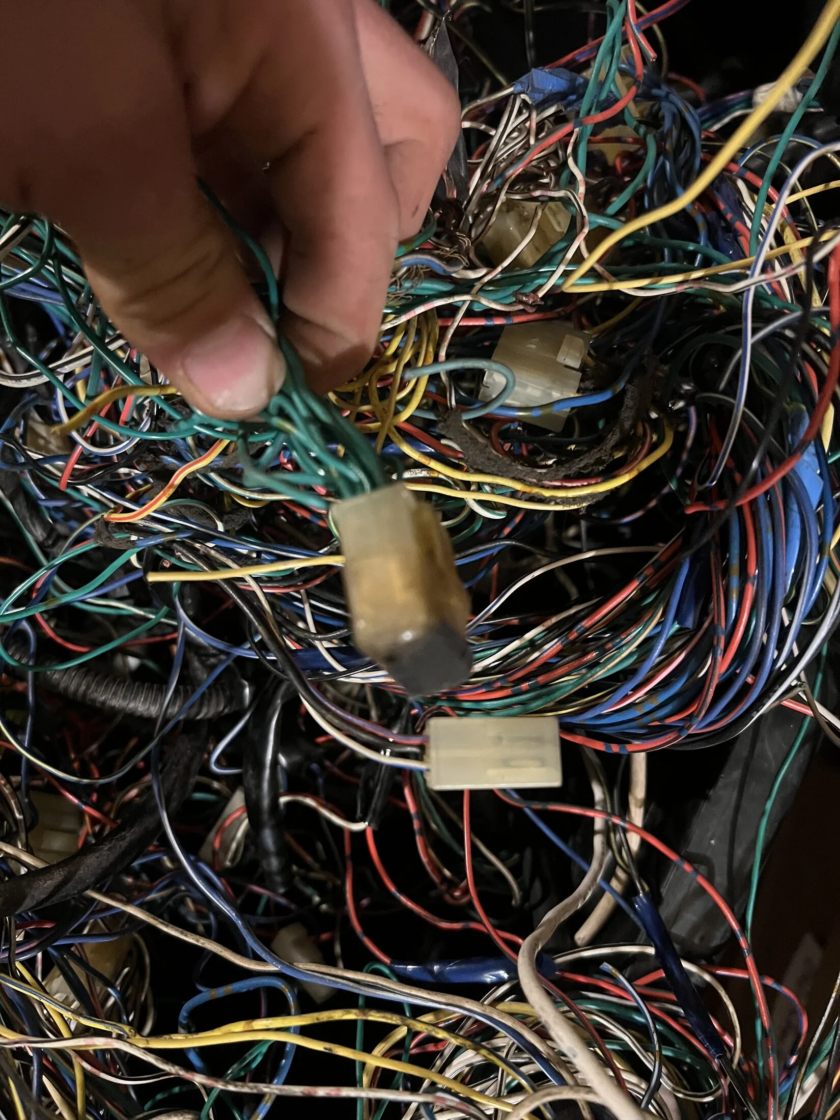

Headlights, Horn, blinkers, hazards, door beep all ground together at a common junction behind the dash. Most likely that ground junction (looks like a plug) is fried too.
The wires going into the fuse block that are fried are same circuits as at the plug. If there is a 30 amp fuse for tail or brake lights, I’d start with that circuit as those (and horn) should be 15 amp fuses.
What can happen with these old cars is ... If a higher power accessory is installed, (most commonly higher wattage headlights or a high powered music system tapped off of original wires) the increased current running through the inadequate wire size creates excessive heat at a connector interface. Over time (years perhaps) the constant cooking inside of the connector burns plastic which can deposit contaminates on the metal to metal contact.
This creates even more resistance at the connector which creates even more heat --- etc... until you get a melt down as you've experienced.
It happened to me on my FJ60. My culprit: high wattage headlights installed on original wiring harness.

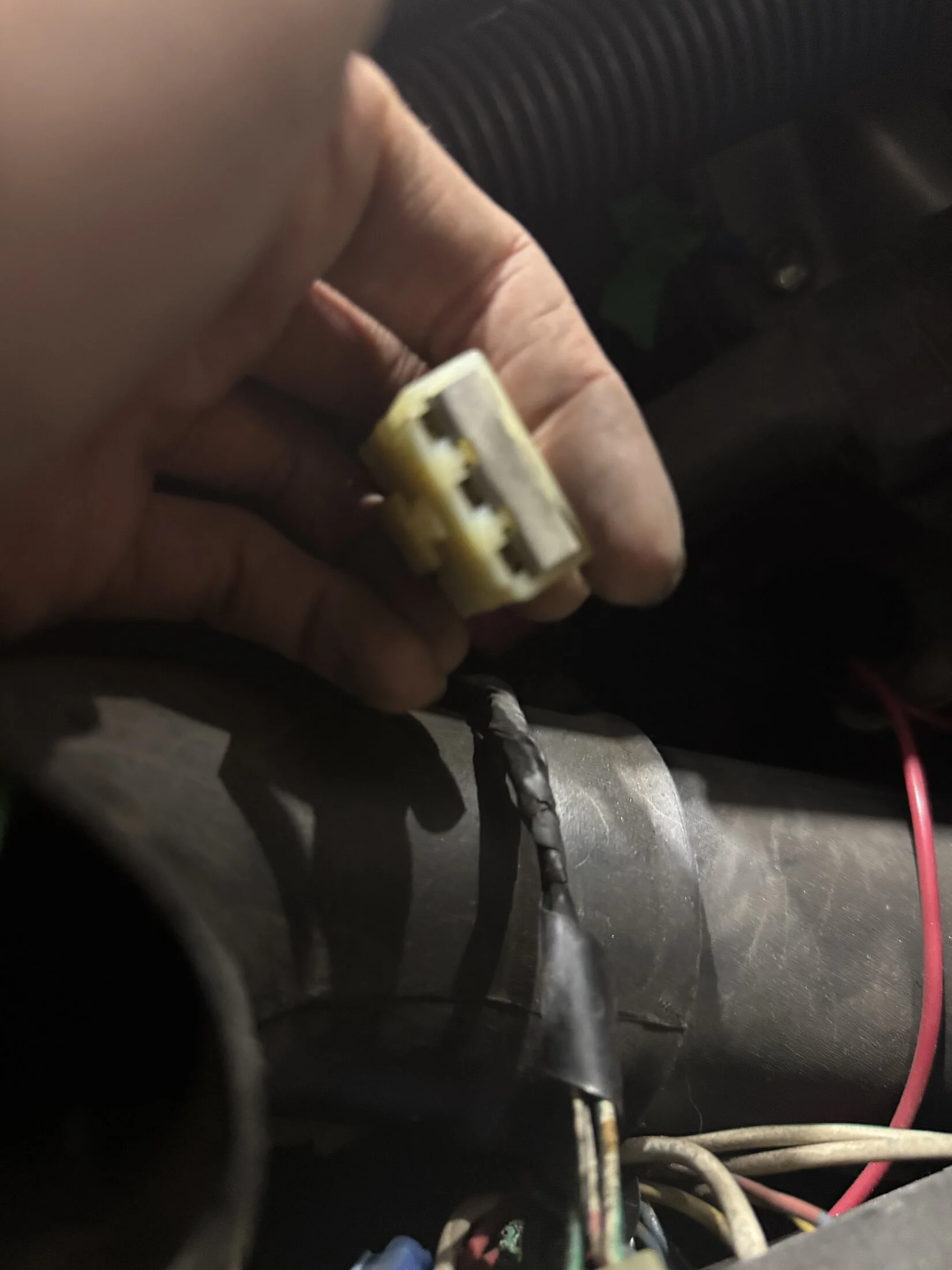

Is that the plug shown in my first and last photo? where should it ground.

Roger that. You're right on with the location. It's all behind the fuse panel, the first photo is against the back area above the steering assembly.
Aftermarket radio wiring is a bit tangled, I can clean it up.t The mechanic helping me had used existing wiring from the PO, we just threw the new radio in. Just a typical Sony Head unit, not higher powered. No fraying there that I could see.

Unfortunately that harness is likely completely toast if that’s the damage you can see. There’s probably way more that you don’t see.
And something had to cause that.
s***, gotcha.
Cut into the wiring harness outer tape, didnt look like the actual melting cancer spread. all the green wires looked okay under there.
The wires feel supple and not brittle further in the harness, hoping I got lucky.
But youre saying theres probably more melted wires somewhere or the damage is internal from it shorting out along the whole harness? Could I visually see this or test it with the brittleness of the wires/ with a multimeter?

Now that massive short alone MIGHT explain why your headlights, blinkers and hazards are not working, as the shorted wires may have melted into other circuit wires. However those could also be separate issues.
I would start by repairing ALL the damaged wires, replacing the connector block only if it's melted, installing the proper size fuse for the tail lights, then take one circuit at a time and start trouble shooting.
The suggestion about replaceing ALL the fuses is a good one. I would also spray contact cleaned or use DeOxit on all the fuse terminals.
Next I would find every where there is a ground connection to metal, remove that connection and clean the ring terminal, the bolt, and the place it threads into of all corrosion. Reassemble and coat it with liquid tape to seal it from future moisture.
Next I would make sure that ALL the light bulbs are good and the contacts for the bulbs in the sockets are cleaned. Bad gounds at the light housings can drive you nuts as electricity takes the path of least resistance and that sometimes will be through the bulb elements if the ground is bad. This shows up for example as the park lights dimmly lighting up when you press the brake pedal making you think there is a short when in reality you are missing a ground.
Make sure the flasher is actually good since both Hazards and Turn Signals do not work.
The headlight fusible link also powers the fuse that protects the Turn Signals, the Hazard Switch, and the Horn. The link may look good but be bad or intermittent. I can rebuild the fusible link if it's bad. You would need to send me the link so I can re-use the old connectors.
Check to make sure you have power on both sides of the Hazard/Horn fuse. If not then the fusible link is bad.

As for the blank connector block, does the order of the green wires matter? I cut mine off to examine it, and like I said have another with wires attached (a pig tail as they say) coming in the mail. Do you mean tape the metal section so it can’t ground, or just tape it to the meat of the harness, or both?
Junction Block
It does not matter what position the wires are in on the junction block connector. They are all being tied together anyway.

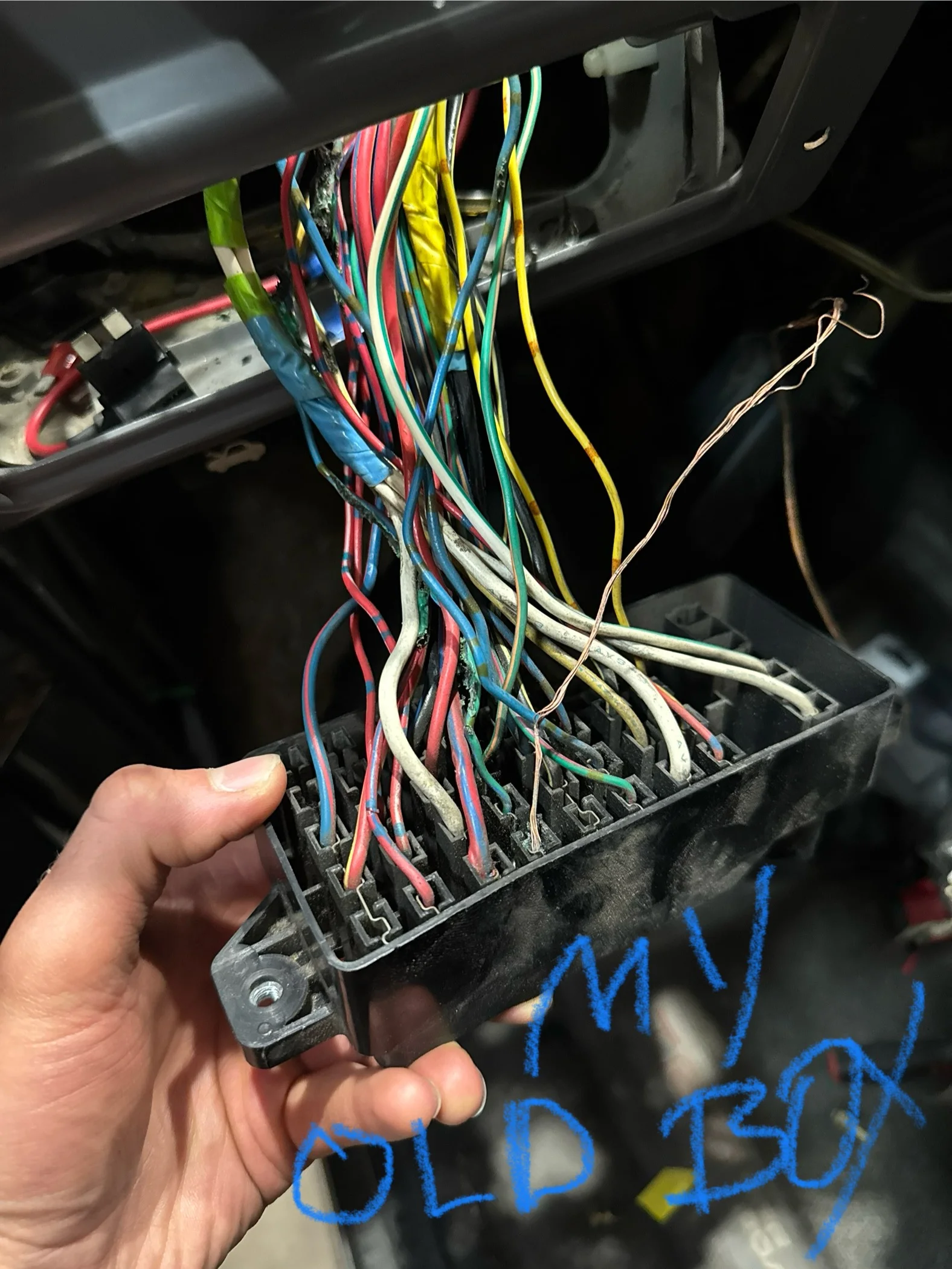

Splicing in another fuse panel
Again showing my ignorance of FJ60 wiring but are the fuse block terminals easily removable and are there replacement terminals available? If so it would be a hell of a lot easier to just remove the fuse block terminal that has the melted wire and replace with a new terminal and section of wire than to splice in a whole different fuse panel.
If you decide to splice in a used fuse panel...
