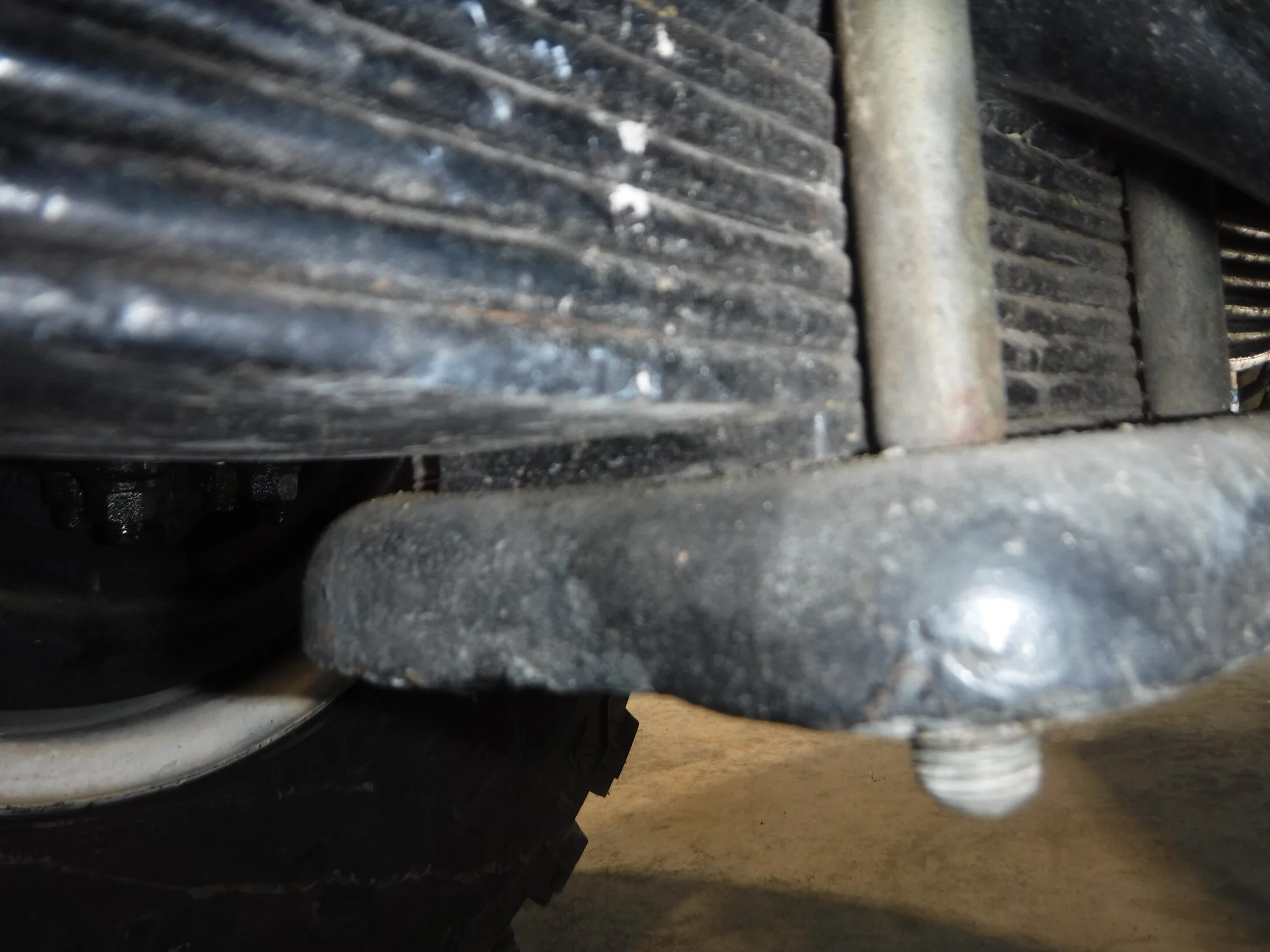

Update... Once doing it .....of course.... thats what I would have done... it was trying to visualize it.....I think I was over thinking it....
anyhoooooo.. Once we / I was done.....installing the 5 degree shims... drove like a totally different rig..... no longer felt like it was ice skating...
Thanks for all input.... he is very happy with the transformation.
.................................:clap:

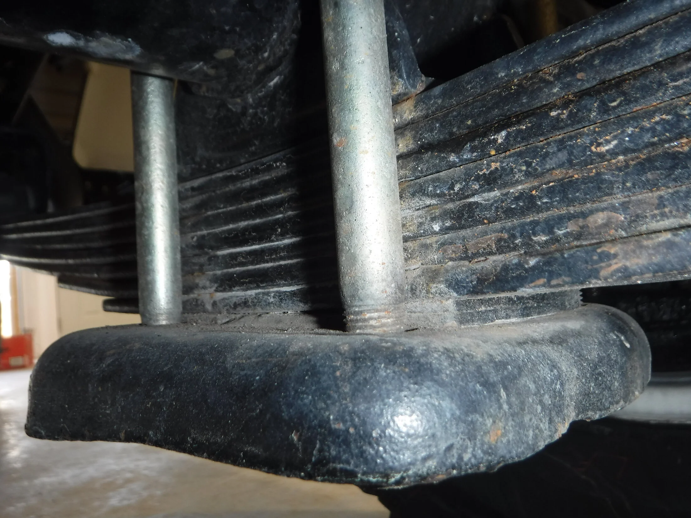

As stated, shims go fat and forward for a spring under axle.
fat forward but not like this
