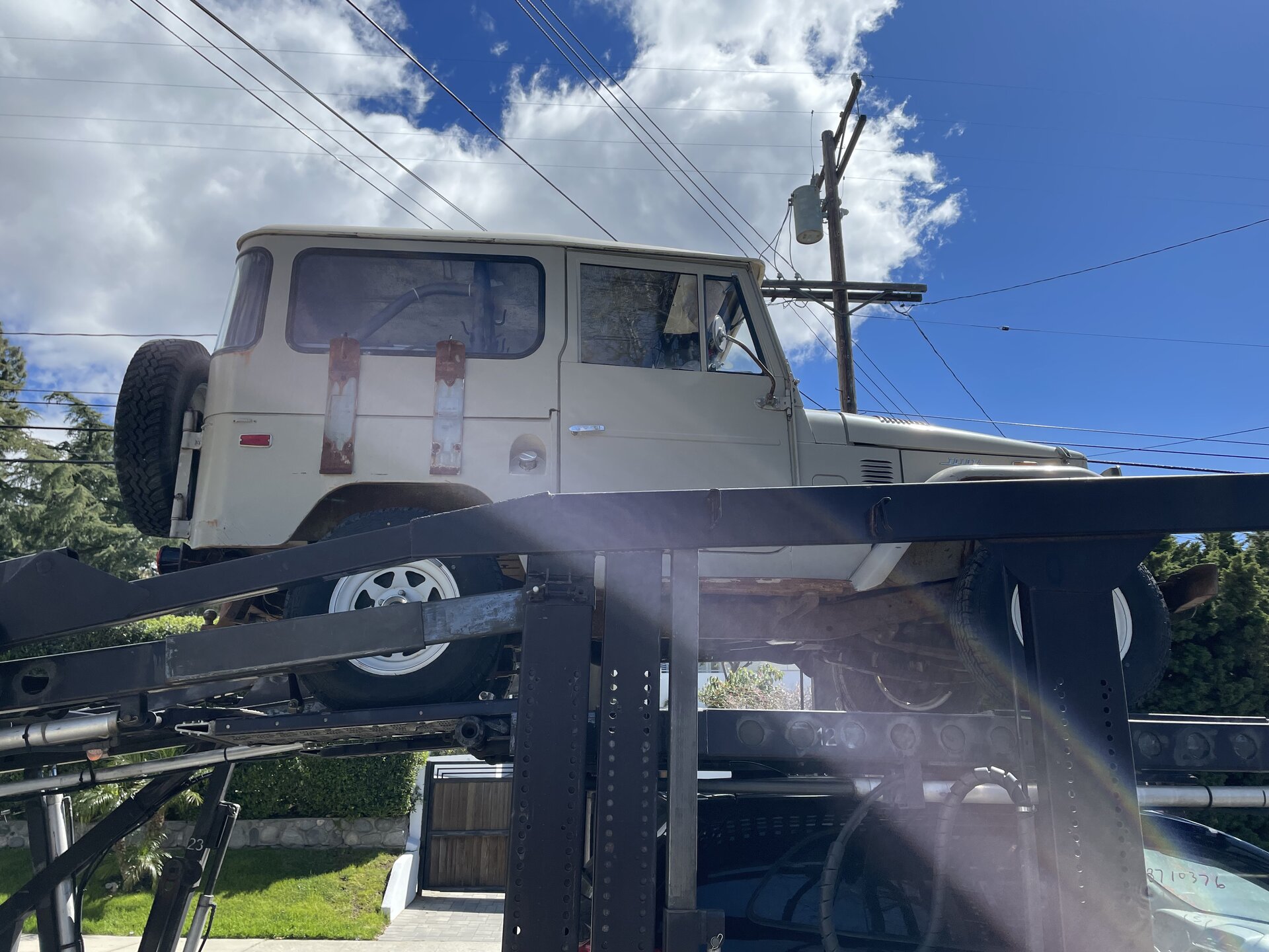

On the Magic Purple car transporter, loaded up at 1:30am local time, driver said he'd be there at 10pm. Seller is a stand-up dude for dealing with that nonsense. And no, it's not loaded up with parts or anything...nothing to see here... Should be here on Monday-ish.
Truck arrived this afternoon. A bit of an adventure having the driver back it down the ramp and off the truck, but got it figured out. As it sat on the rig:

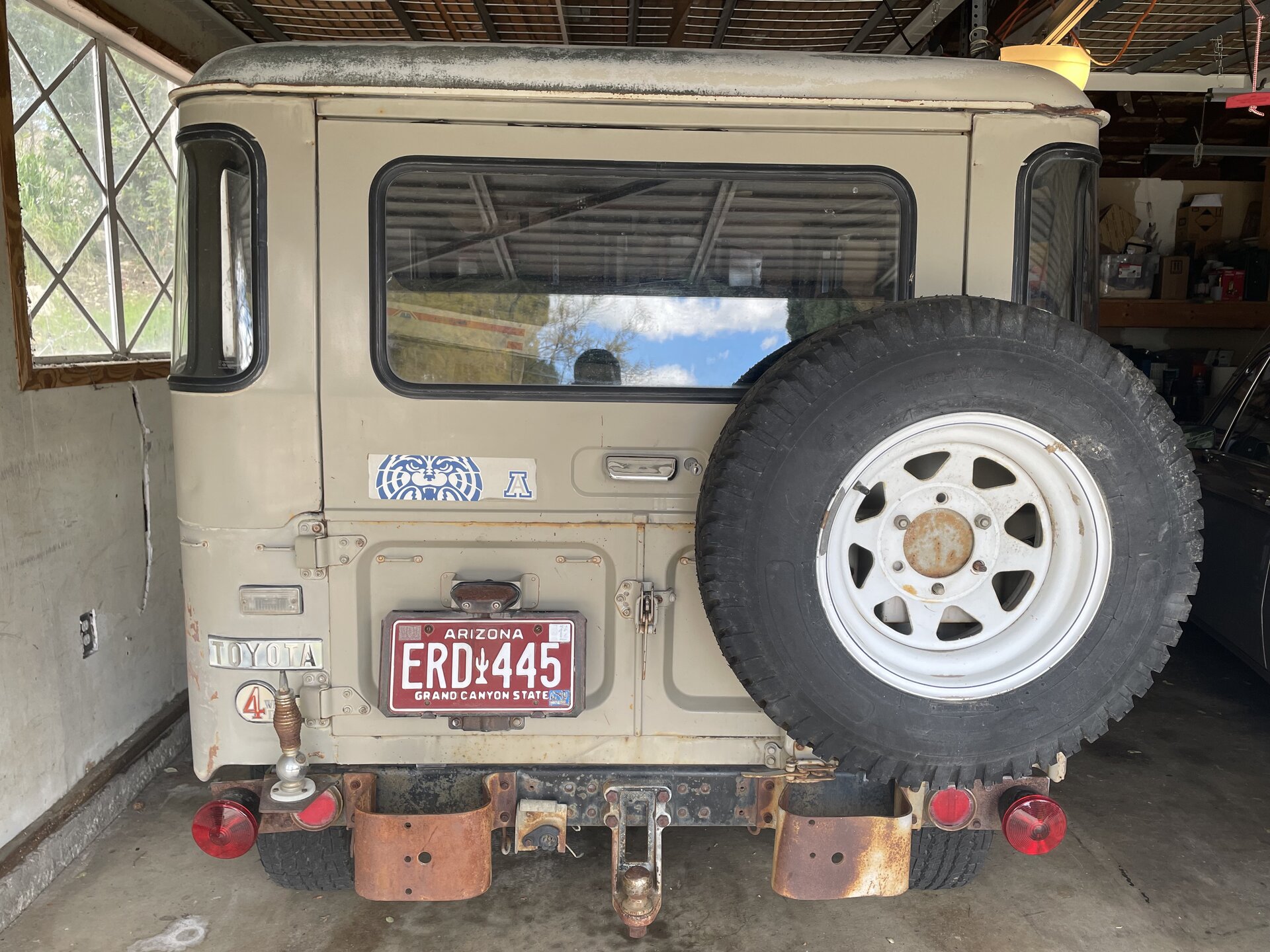

A little about the truck. Found this on FB Marketplace, the seller was in Colorado and had done quite a bit of work to bring it back to life, but with a new kiddo and family obligations, found himself needing to move along. The truck was originally from Arizona, and was used by an old school miner / prospector to get out into the desert and mine. The previous owner was a family friend to the miner, and the seller bought this after the miner had passed. He included EVERYTHING he had in the truck, including the old topo maps that were stashed up above the dashboard.
Ever since I sold Luigi, the CA-spec '77, I've been looking for a good patina project to get my hands on and just enjoy. This fits the bill exactly - not much rust on the body, what looks like good original paint, and a solid mechanical starting point. Oh, and no frame rust. The seller bought and installed a running 1968 bottom end, and reused the original 1972 top end to get the truck running. He included the original block / camshaft / etc and the 1968 head in the truck, along with a bunch of spares and other stuff. Seller told me that he got the 1968 engine from a guy who'd rebuilt it and was waiting to put it in some other project. Apparently this other guy stored his cars and other project stuff in an old missile silo, not sure where. Can't make this up.

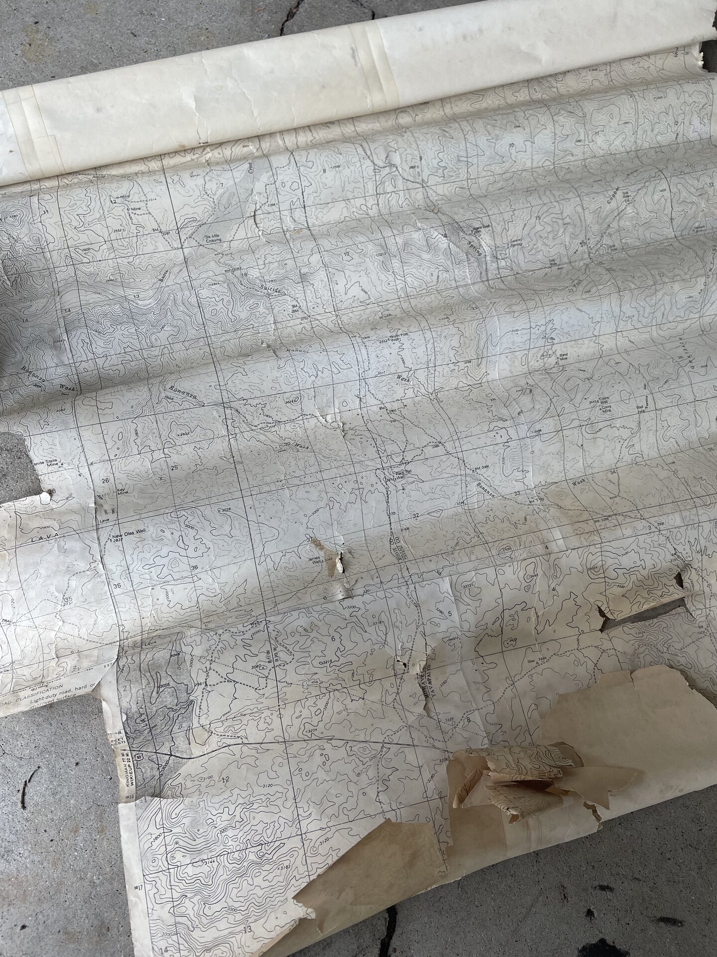

EDIT - where I just happened to unroll the topo map corresponds to the border between Mohave and Yavapai County on US 93, which Google Maps says is a place called Nothing, AZ. So awesome!
Check those maps for the "X" Lost Dutchman.
Heh! Some of the new old stock parts have the guy's name and address, will have to look up where he was. The map is pretty rad. I have no idea what to do with it other than roll it up and protect it.

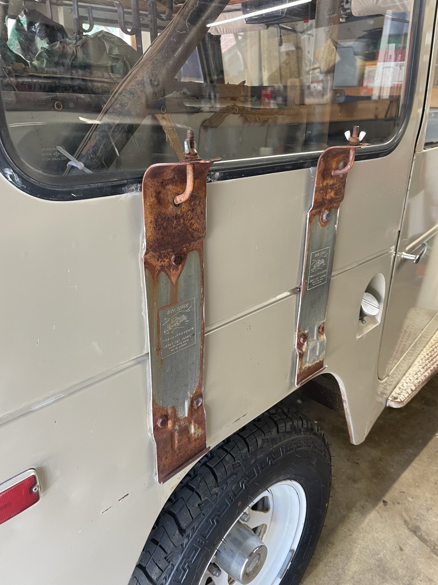

I bet that hard top has never been taken off, judging by the sweet Dick Cepek straps and guessing the miner wasn't into scenic cruises...
Yep, would guess the same. I have no interest in taking the top off, either. The miner put some industrial pile carpet between the straps and the body. I'm undecided if they stay on or come off, so I think that means they stay for now.
