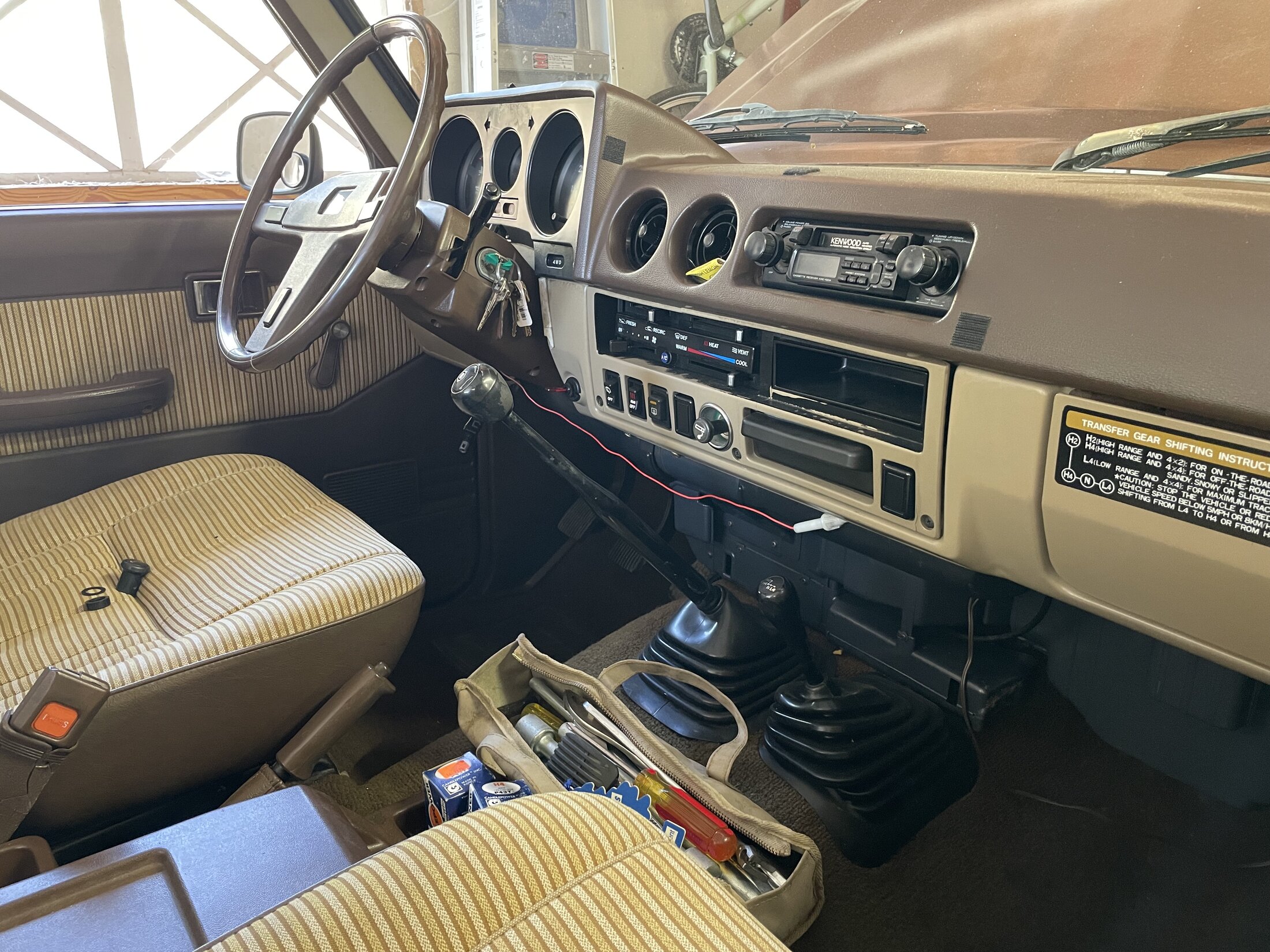

Son went with me to just "check out" this sweet 1983 FJ60 that has been sitting for.. a while. Last registered in 2000, been on non-op since. But, as far as I can tell, it's also about the most rust free and no wreck example that I've ever come across.
It was also home to 4 dead mice in the driver's rear quarter. Oh holy hell the smell. Spent the afternoon with a mask, some gloves, and a bucket of cleaning everything. I may need to get an ozone generator to get all the stink out. But the interior is sweet. 139K miles. Original paint and the clear isn't peeling. Original blue plates. No cracks in the dash. PO was the original owner's son, but he never drove it. Son is calling it Woody because we already have Stinky Pete.

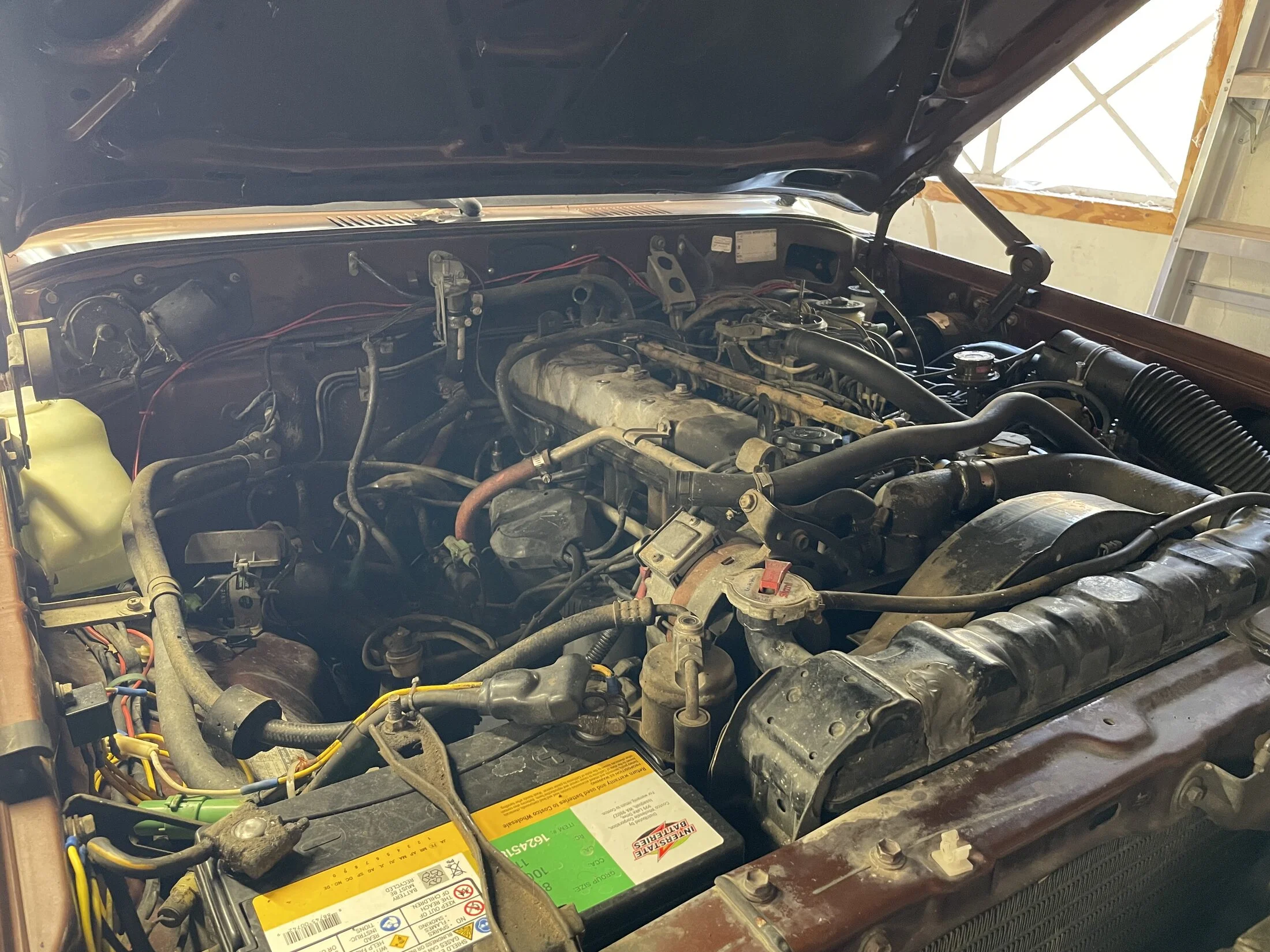

Taking a break for now. Epic amount of turds and dirt and sticks and pinecones (!!) removed from the engine bay, frame rails, fender creases up against the firewall, under the carb, on the manifold, on the head, from the brakes, around the charcoal canister... but it's done now. I don't think I've emptied the Shop Vac so many times in a day. Interior smelling fresh(er) after leaving it wide open and dryer sheeted.
Have stayed mostly N95'd up, but if I walk away from this without getting hantagonasyphillis it's a win.

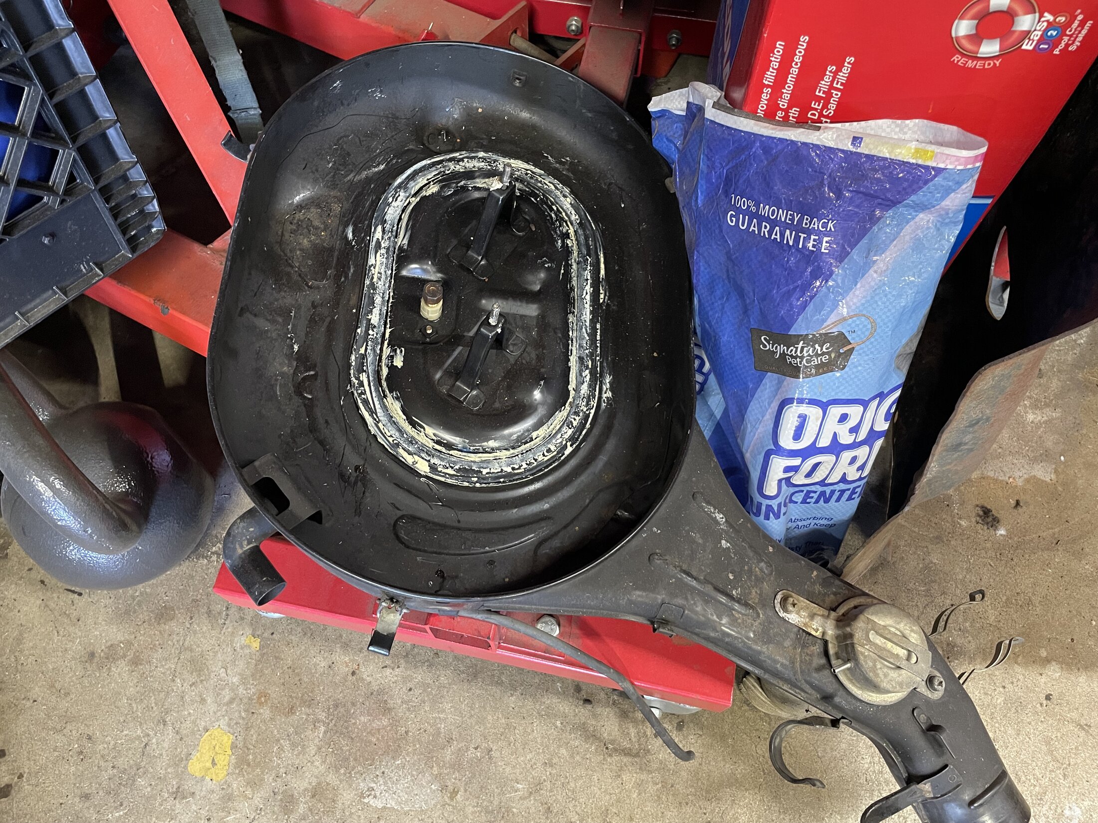

Other stuff. Removed the air cleaner, which someone slathered with white lithium grease on top and bottom. Air filter had mouse nibbles, turds, and a feather. Choke cable is broken at the knob, and the top butterfly was closed, probably explaining my high idle. I started it up after pushing it open manually (without the air cleaner and with a ton of vacuum leaks), and it idled at around 600 for a few seconds before dying, so I'm guessing that is a good sign. Tracing / replacing vacuum hoses and making a big ol' list of stuff to prioritize. Needs a valve cover gasket. Pulling PCV now.

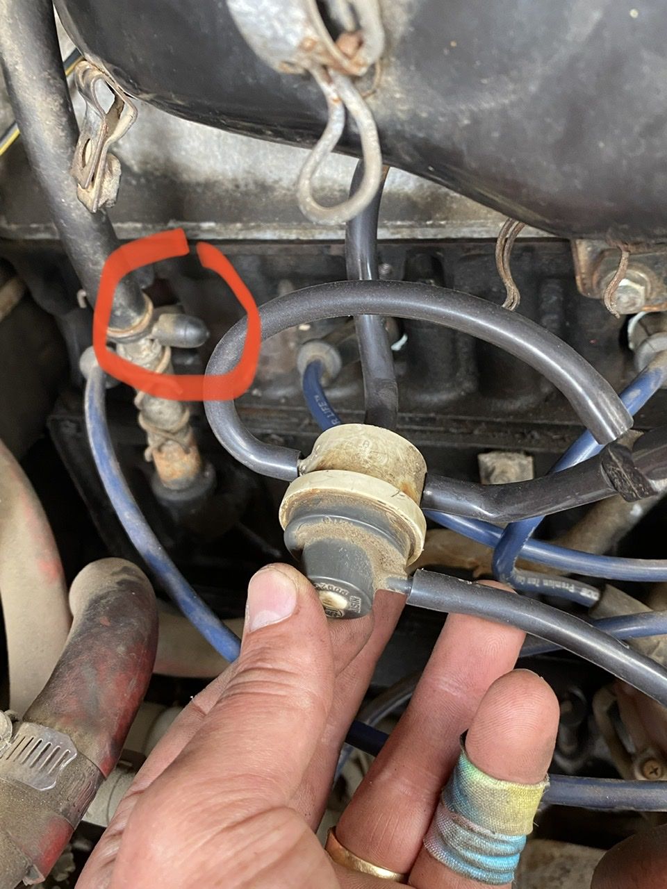

PCV is out along with the typical rock hard gasket. Still jiggled so that's not bad. Vacuum hoses seem all there and accounted for, but I need to go through the charcoal canister side and see which connects to what. Learning about the HAC valve (that's a new one for me) and the big hose at the bottom, which was connected to nothing but buried in about 2" of sh!t on the frame rail. It may just vent to atmosphere but need to research.

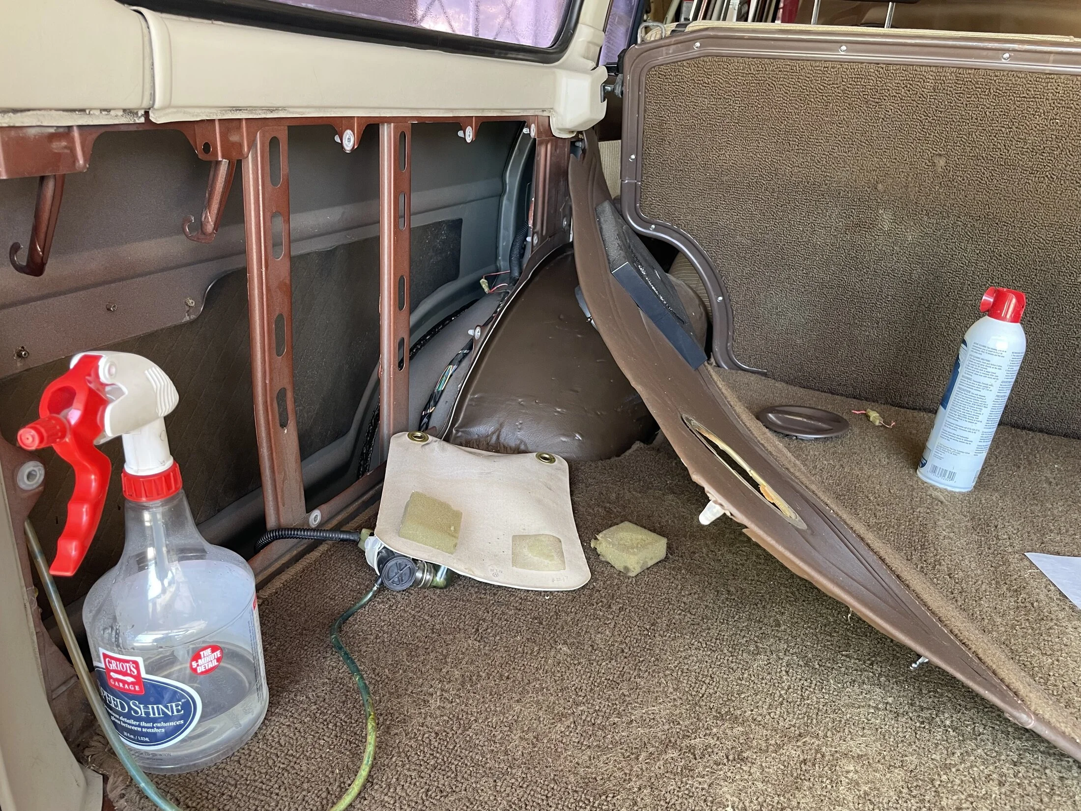

Mouse condo was down in that area behind the rear quarter. Nasty. Oh - the porthole cover for the rear washer bag is still here, so that's a nice perk. Have to replace that washer line though, I have some on the shelf somewhere.

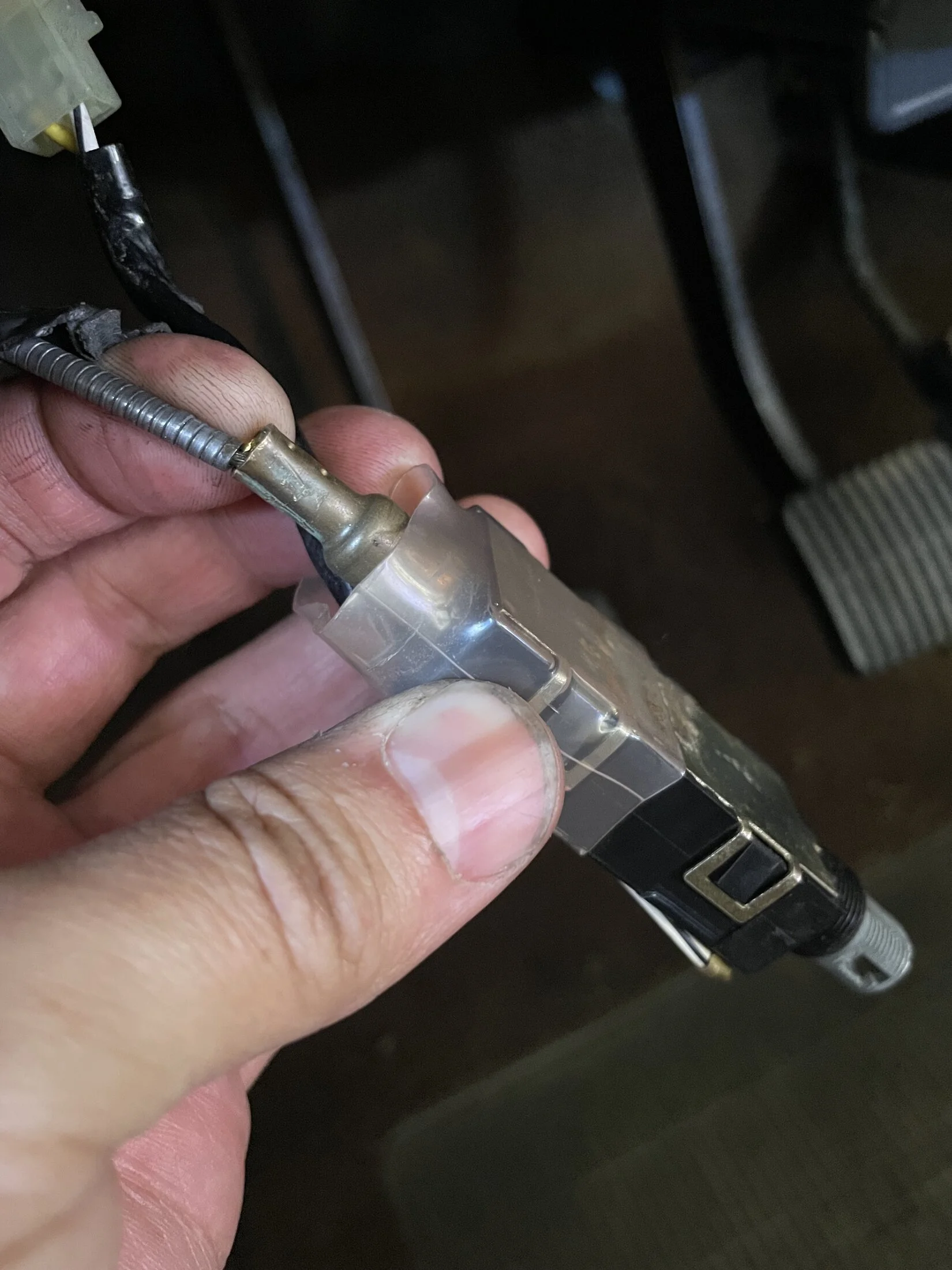

Choke cable knob. I tried to re-crimp but it didn't work. Still available new, afaik.

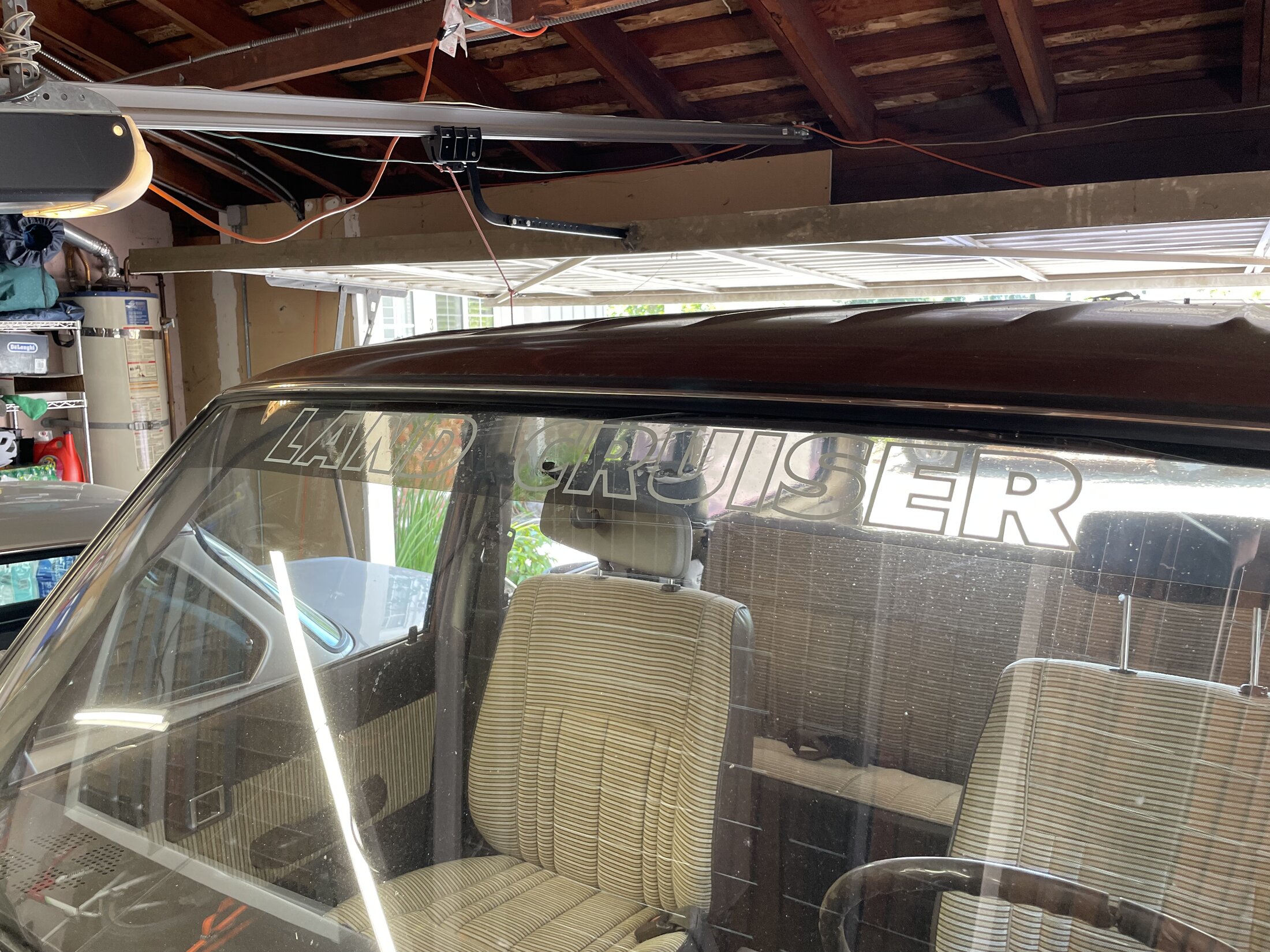

Undecided on the Land Cruiser windshield banner, but it is period correct 🤢 (damn I hate that phrase). Same with the wheels. But that tint is flaking off, will have to take that down eventually.

Tube on bottom of HAC is vented to atmosphere. The bottom of the HAC is removable to clean the crappy little cotton filter. I forgot what I used, but I replaced it with something better, or just clean it. HAC bleeds air into top of carb above 4K feet, so this is Toyota's attempt to filter that air.

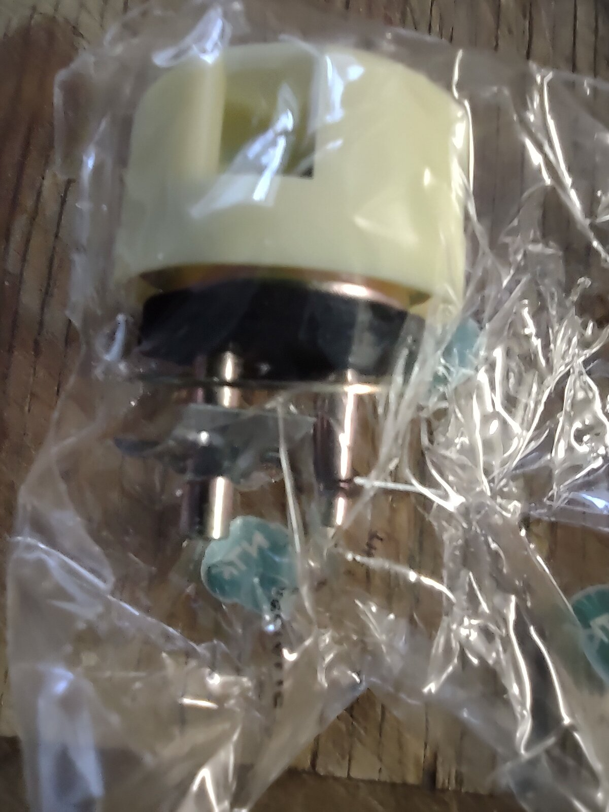

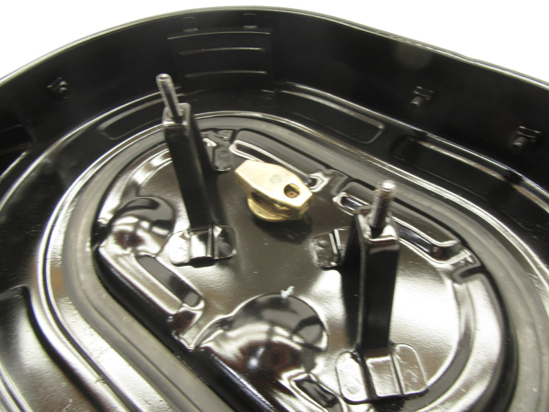

While you've got it apart, check your HIC function per Emissions FSM - people don't realize how important it is for proper idle, particularly in hot areas with crappy RFG that boils in carburetors while using A/C. It also controls your thermostatic flap in the snout of the Air Cleaner. Spoiler: I've never come across an HIC valve that is working, but you may be first :) Can be substituted with valve from another vehicle brand. I used an Isuzu HIC.
On the HIC - I can just replace as PM. Mine looked toasty / turdy. Do you know which one you used?
One thing I did think of, if you could upload a photo of the correct routing of the vacuum lines on the passenger side, both right under the air filter and at the charcoal canister? Having a hard time finding that and the PO had a T capped off, so don't really think that was correct. Anything you can share would be awesome.

I used this one
But any will work.
Second below is a pic of a 'Remanufactured' Air Cleaner from BTB. Plenty of that type of HIC on ebay.
There's very clear routing diagram for that piping in the Emissions FSM, downloadable in the 'Resources' section above tabs. As well as this
